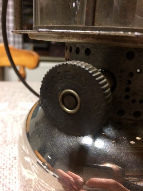

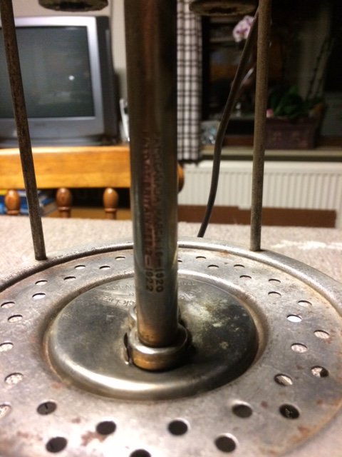

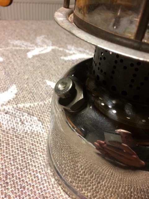

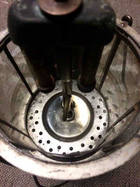

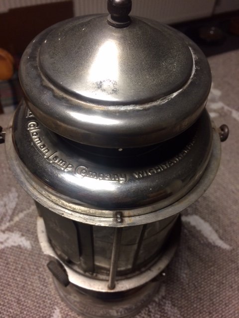

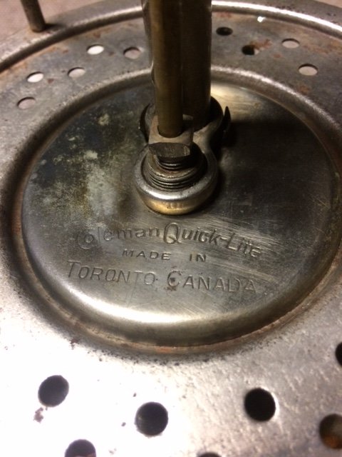

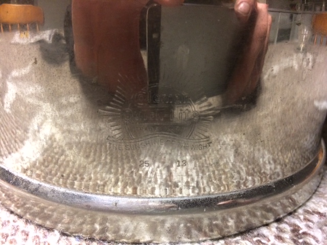

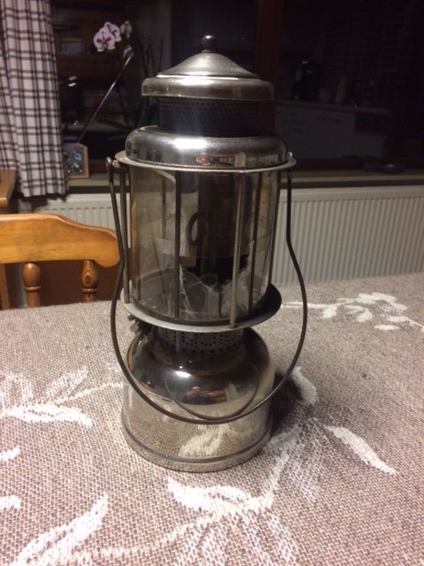

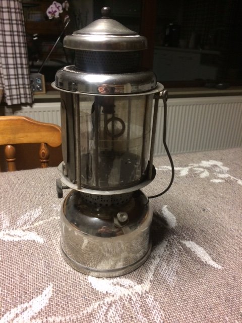

    Hello all,
    i want to show my last purchased lantern:D/its a coleman Quick LQ 25-12 made in Canada.
    as usually i was looking at the local sectionhand site to score some antiek tools or whatever8],
    and than i spot this nice lantern!! here some pic's
    all tips en tricks are welkom.

    Those lanterns were built to last and it should restore well enough!:thumbup:

    These are easy to fettle. They often work "as found" but nearly always just want a clean and maybe a new generator to work like a new lantern. With very few moving parts there is nothing to adjust so dismantle and clean out fuel feed and air tubes. Check the generator is passing fuel and it will run. ::Neil::

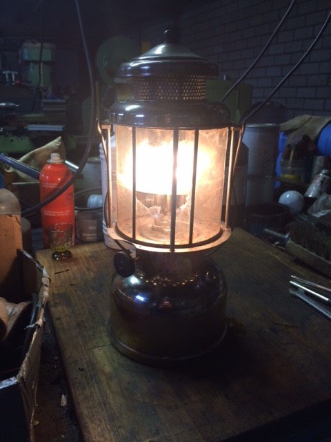

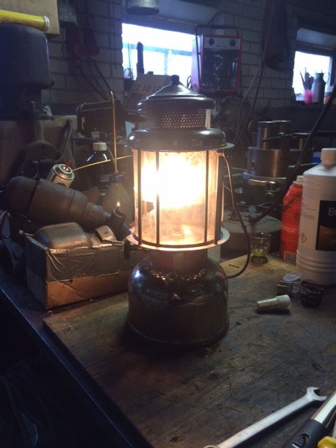

    up and running;)
