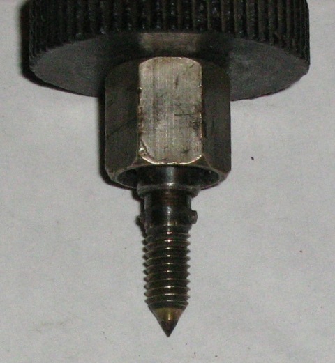

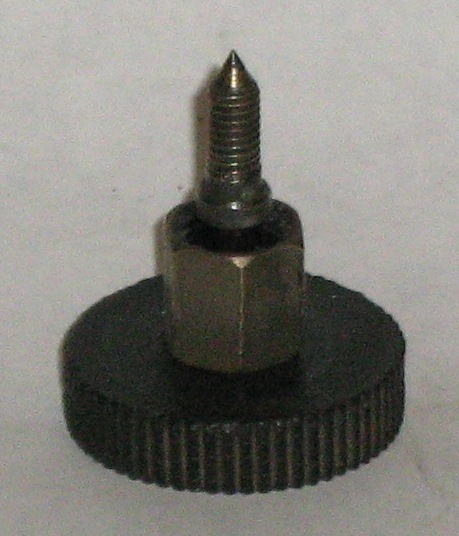

  24. Henry Plews
    2,735
    Hi Mark,
    Mmmm, that graphite is good stuff and should do the job. Are you sure you're putting it in the right place ?
    Is your valve like this ?
    Once you've screwed the valve stem out, push the nut right back to the knob wheel. Push the thick washer back a little way and then remove the pin (2nd image) which may need a little encouragement. You can then slide the washer off (if you also remove the nut, you can get the valve stem really clean). Wrap a strip of the graphite paper around the stem as tightly as you can - not easy I know and it will deform but it will compress to make a good seal when the job is done - and push it inside the nut. As long as you leave a couple of threads showing, you should be O.K.
    Slide the washer back on and insert the pin making sure that it sticks out evenly on both sides.
    Screw the valve back in tighten the nut and you're done.
    edit: I'm sure I've seen some of these valve stems with a circlip around the stem instead of a pin through it.
    Henry.

  26. MG
    MG United Kingdom Subscriber
    Feb 13, 2017
    965
    hampshire UK
    Hi Henry,
    Ah that's where i'm going wrong then ( i have looked but couldn't find any info or a how too ) i was wrapping the graphite around the stem which is longer than yours, pushing it inside the valve with some overhanging and then doing the nut up so obviously that's why it wouldn't seal properly, haha what a fool i am! :oops: mind you the previous owner said he used the lamp and it had no packing whatsoever when i unscrewed the stem so it must have been leaking like a sieve! :shock:
    Your a star, thanks Henry :thumbup:

  28. Henry Plews
    2,735
    @Tony Press , Thank you. @MG, the valve I showed is shorter than yours because it's from a Quick Light table lamp. They work the same way.
    No need for embarrassment, what may seem obvious to some is not necessarily obvious to others. Anyway, you know now, so you have a little more knowledge to tuck under your belt.

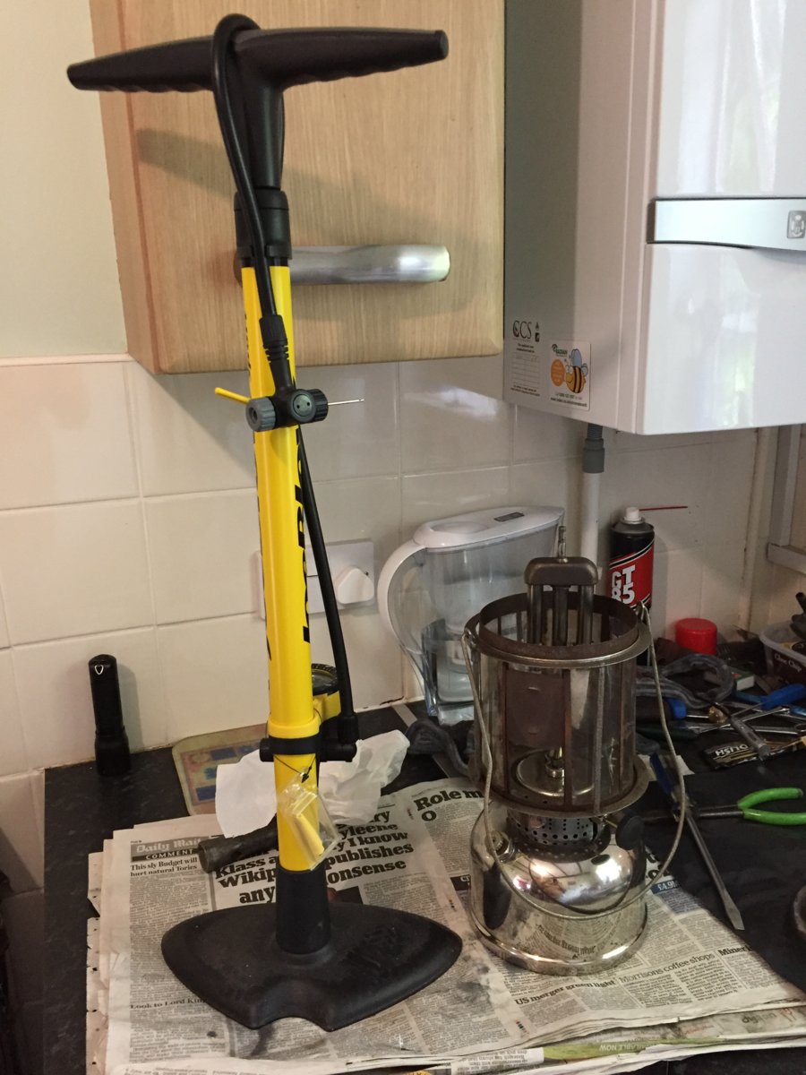

    I made another schoolboy error, there was some of the old string in there but i took it out and after three more loads i managed to fill the gland nut and stop the leak :) its surprising how much that graphite sheet will compact if you haven't done it before,
    Well i got the lamp back together, filled with fuel, pumped it up, took it outside and it won't light, i think there is enough pressure in there and i'm using Naptha based panel wipe if that's ok?
    Any idea how many pumps of this is enough pressure to make it work? i started at 5 and now i'm at 15 so far and all through the tidy up the jet has been clear.
