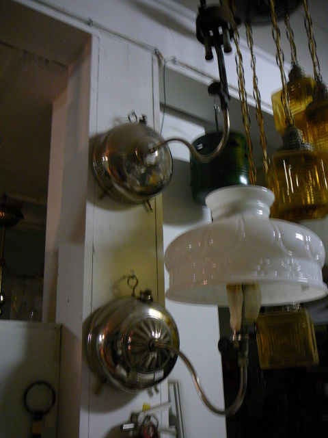

  14. Flygt
    Nov 8, 2012
    175
    I wasn't sure if I had a photo but here's a 102K that I saw in a local collection recently, the shade is a current reproduction and I don't know the date of this lamp. BQ lamps as in the top of the photo are fairly common here, but I've only seen a couple of the 102K with fluted fount.
