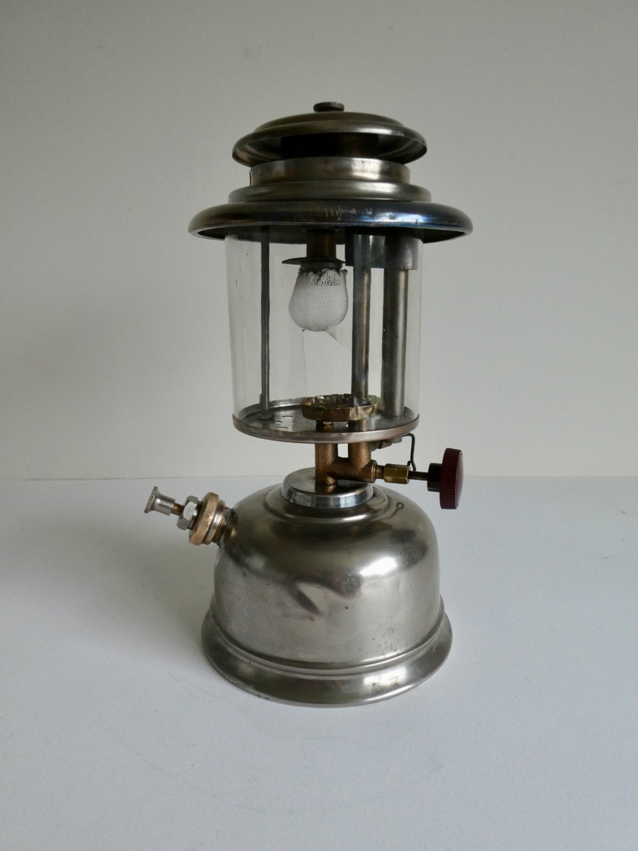

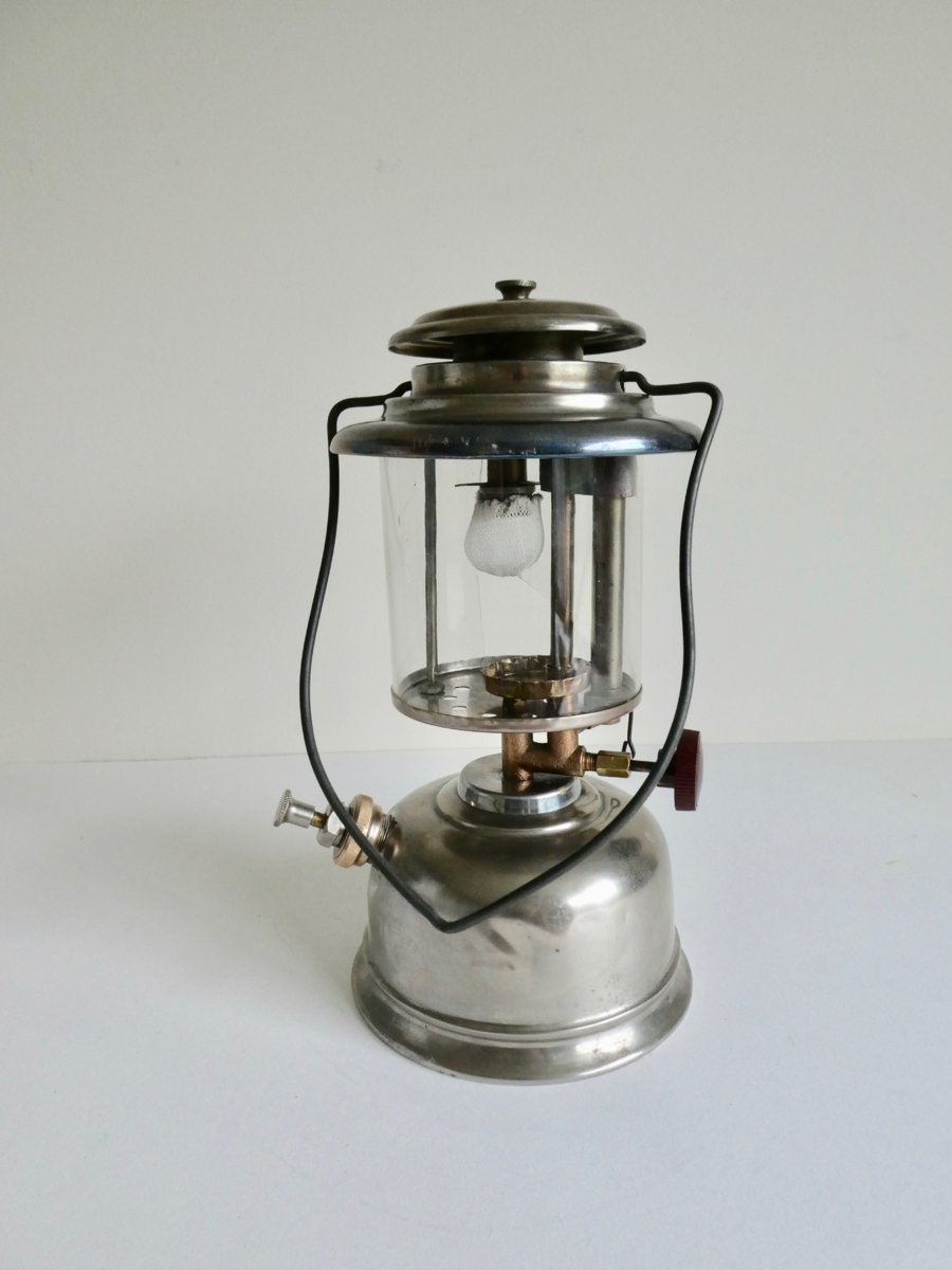

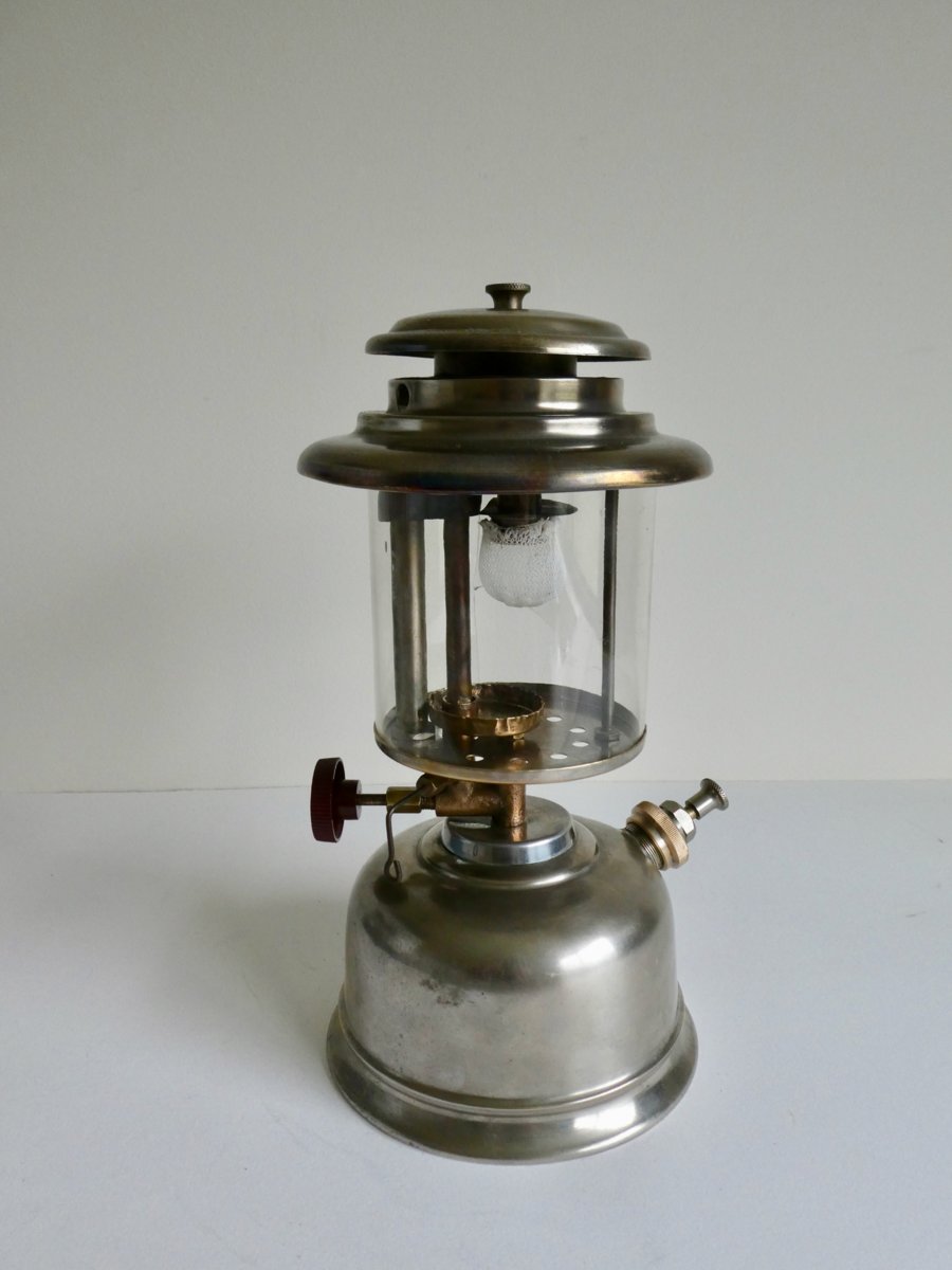

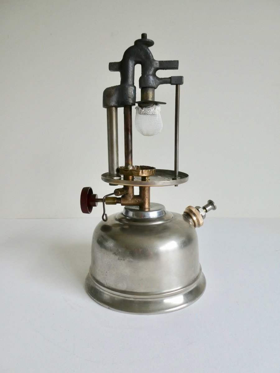

    Here is my Collins Bros "Radiant".

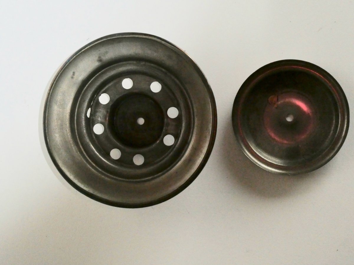

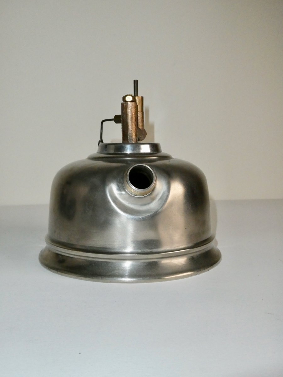

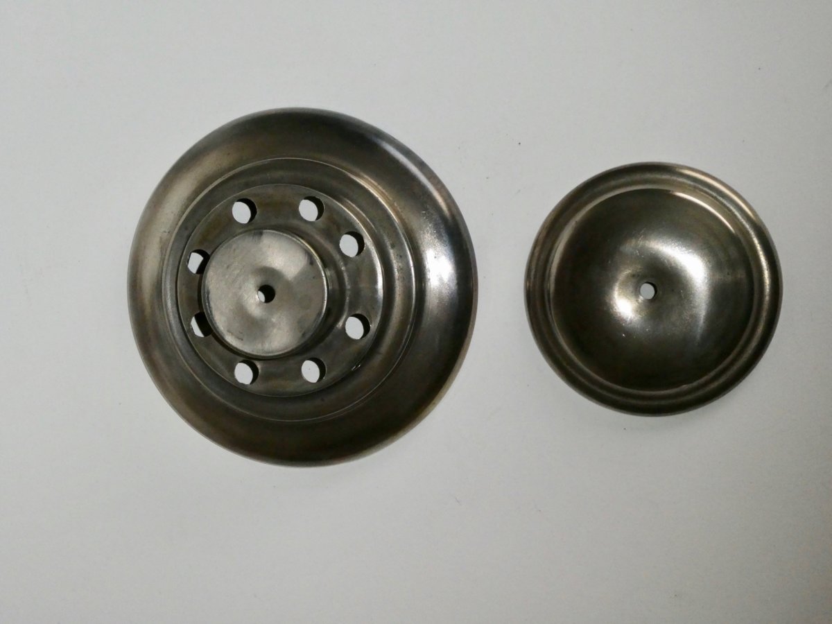

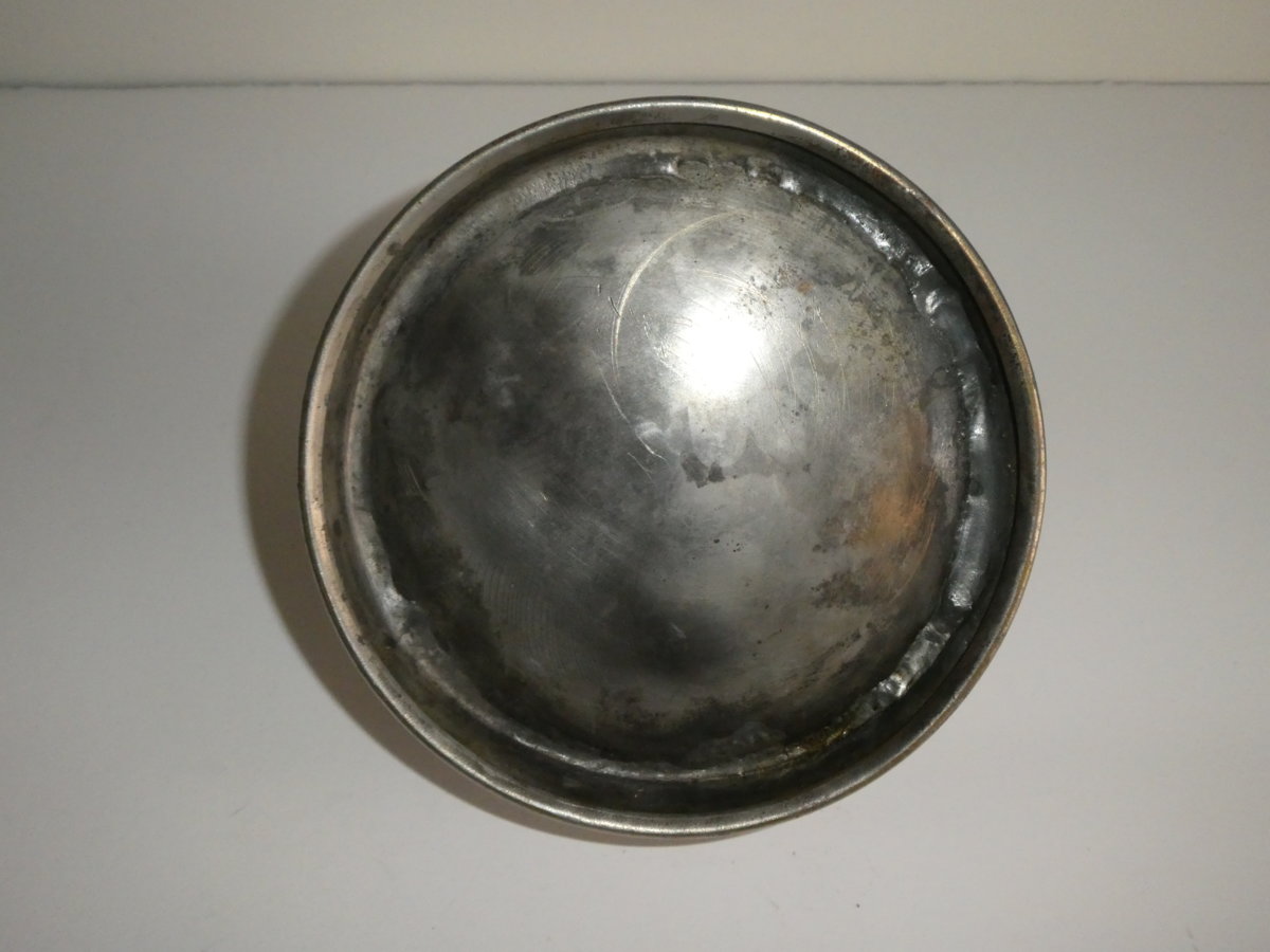

    This is a Kerosene lantern. It is similar to the other "Radiant" lanterns listed here on CPL, but has a few differences (see discussion here). The major differences are the hood (vent) and the tank. Collins Bros Radiant lanterns have quite a number of variations (pump parts, spirit cup, control wheel) which indicate that they were most likely put together with whatever could be sourced or manufactured at the time (?early 1940s).
    Neil McRae has compiled the latest information on the Collins Bros. "Radiant" in his "Pressure Lamp Catalogue" (with much input from Matt Purtell). This information shows a direct link between Australian Gloria pressure lamp manufacture and the Collins Bros Radiant. McRae writes that the Collins Bros. "Radiant" and "Radiant Star" were "...the last product made by Gloria".

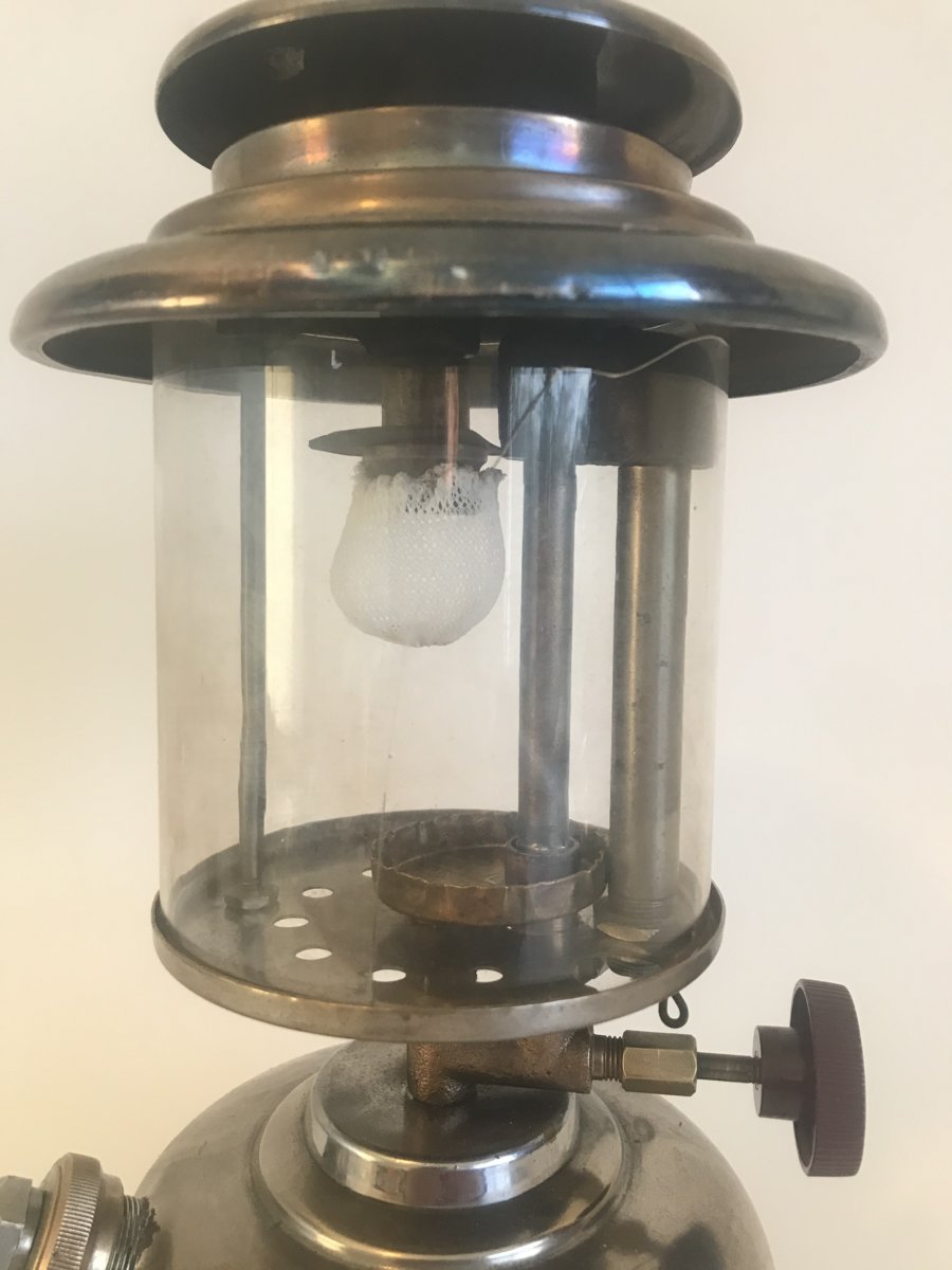

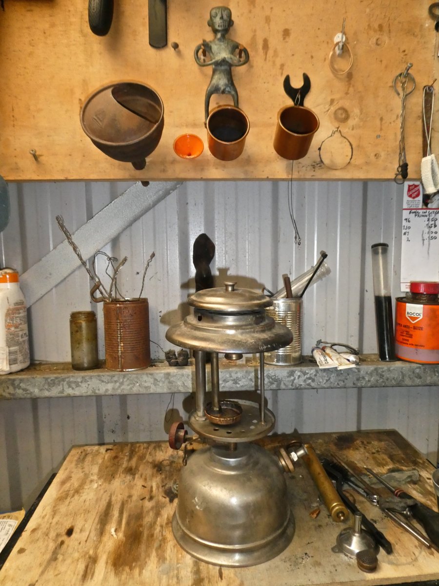

    Here it is with the bail from a Gloria lantern.

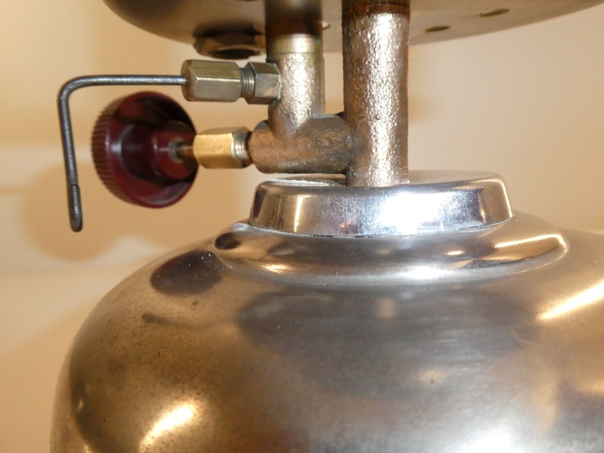

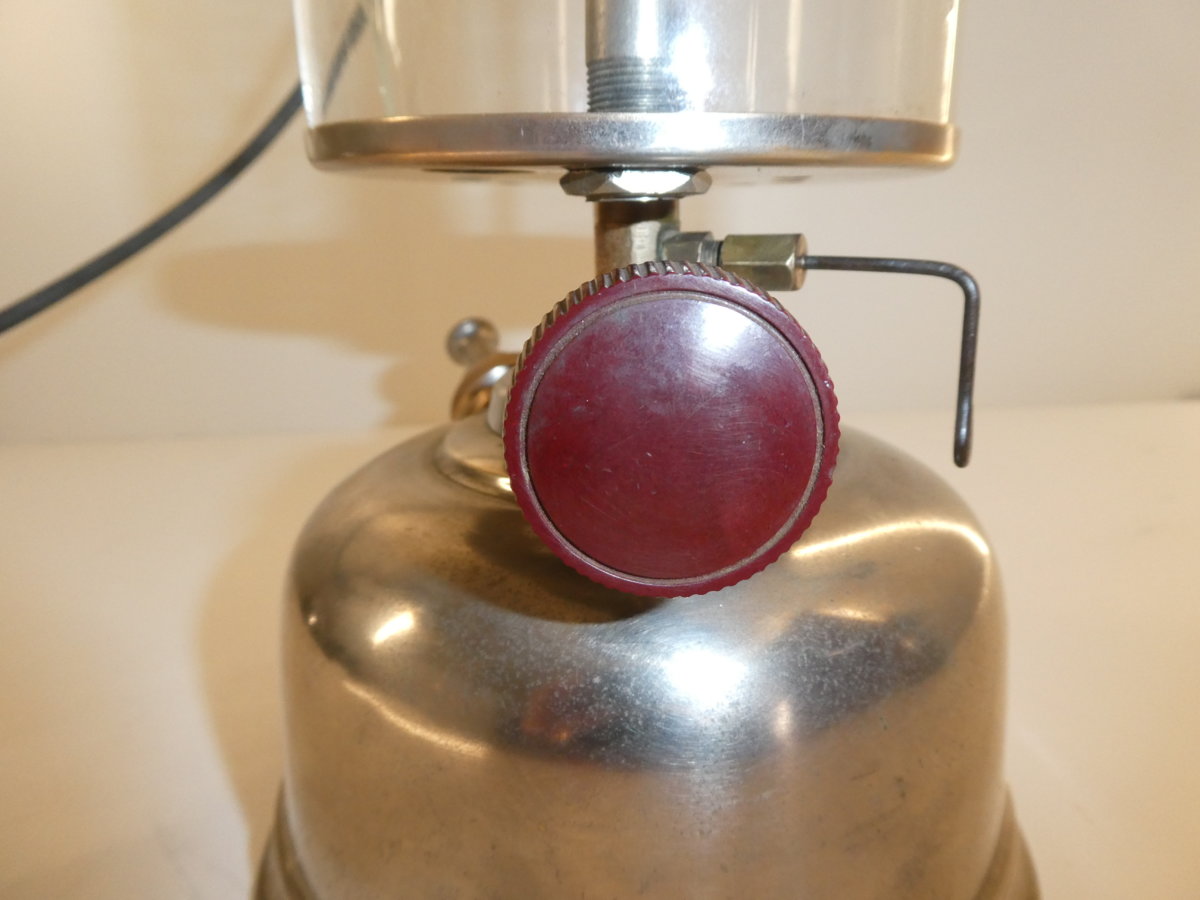

    The control wheel looks like a radio wheel.

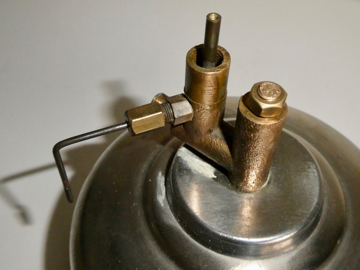

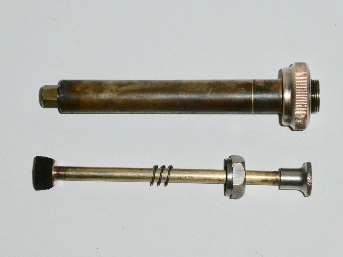

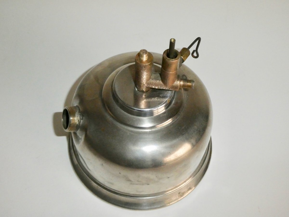

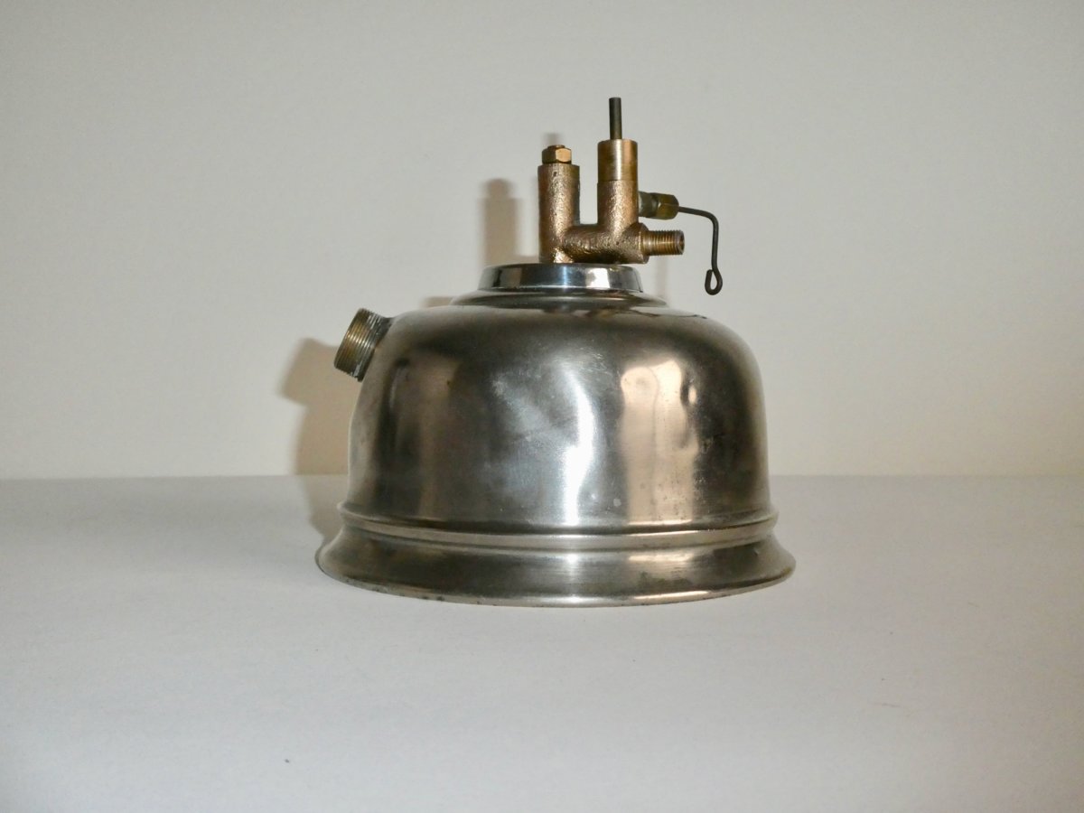

    Note the pricker rod and pricker - quite a fine piece of engineering. The vapouriser (generator) is made of heavy brass tube.

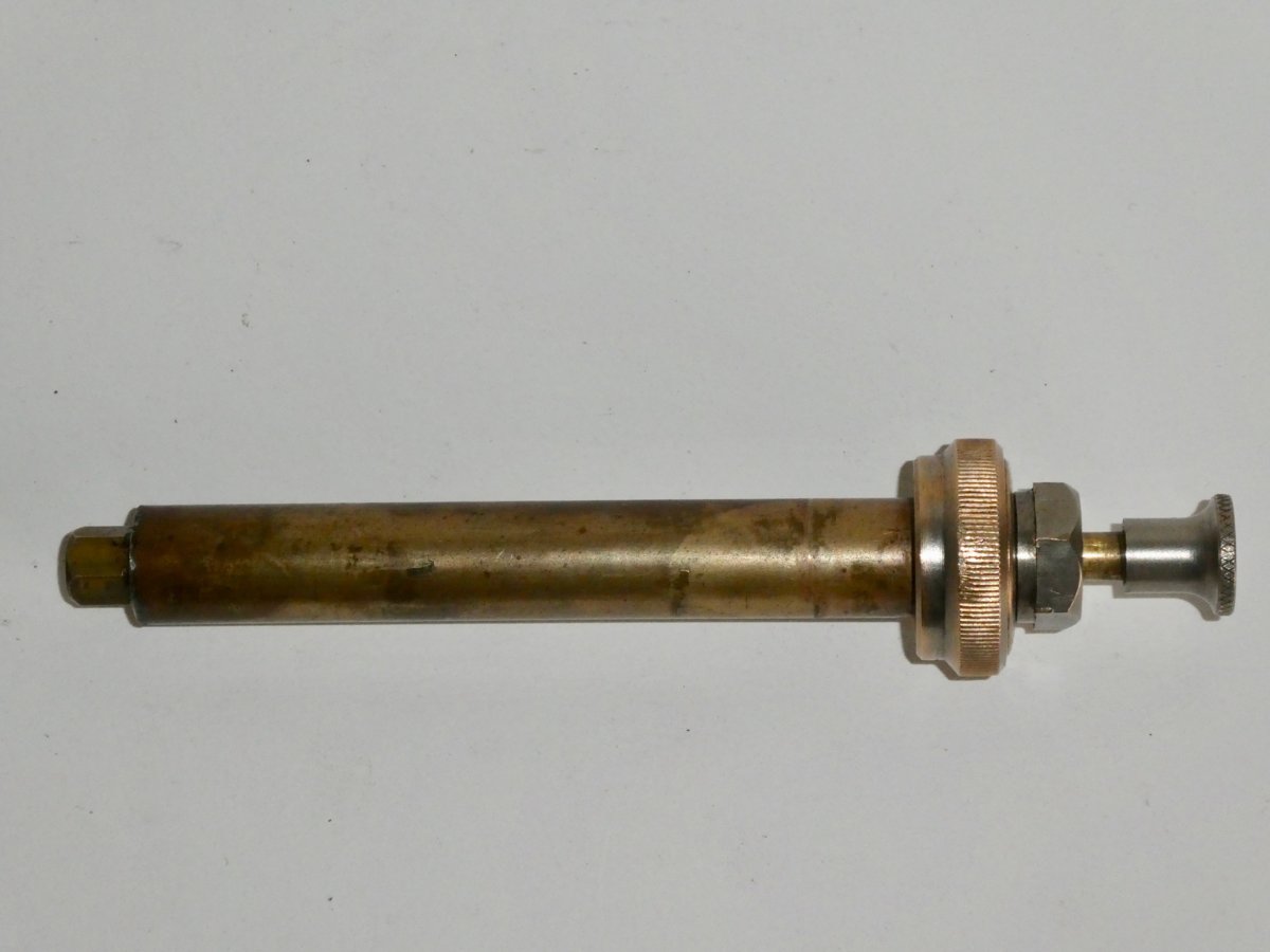

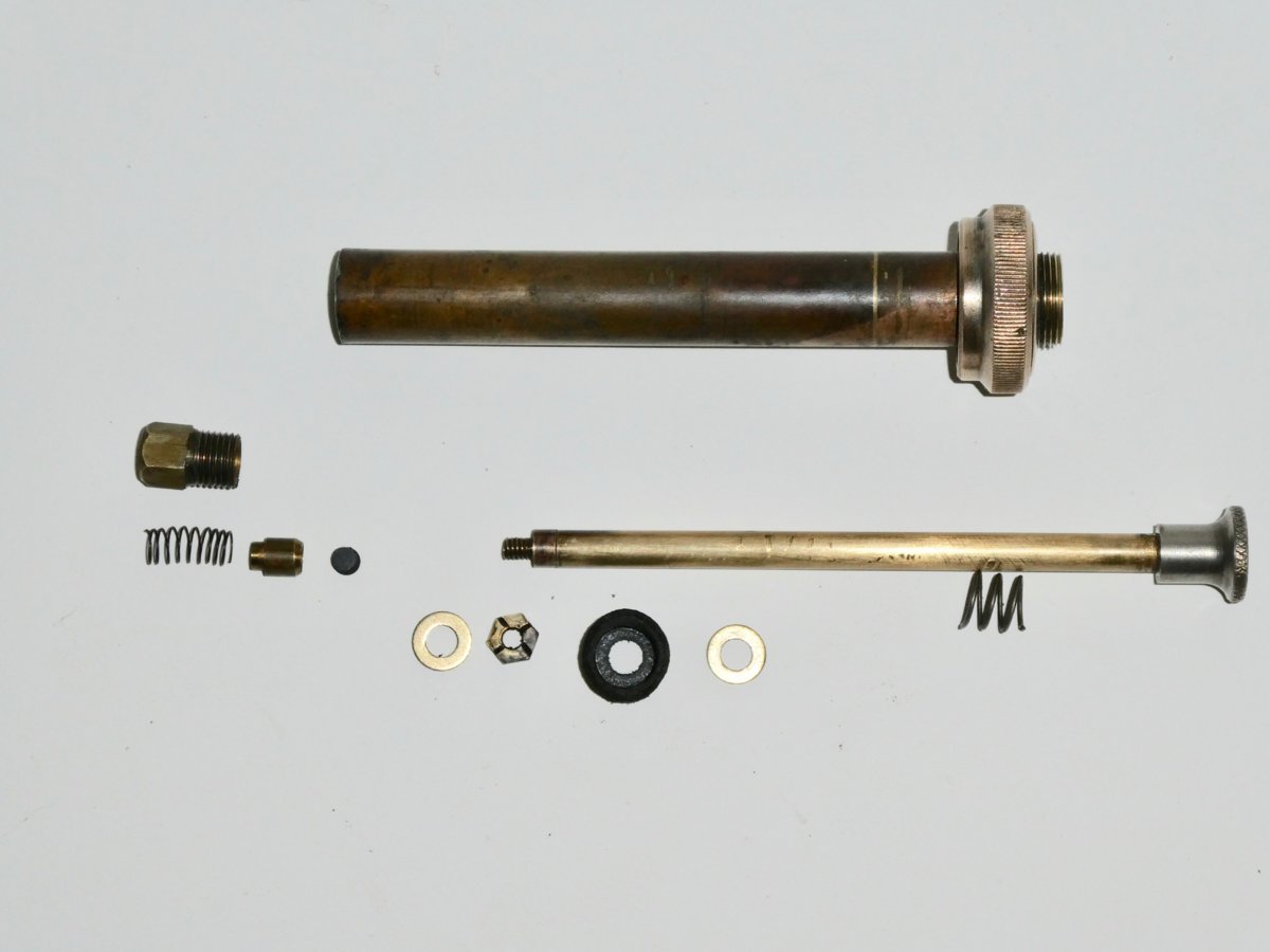

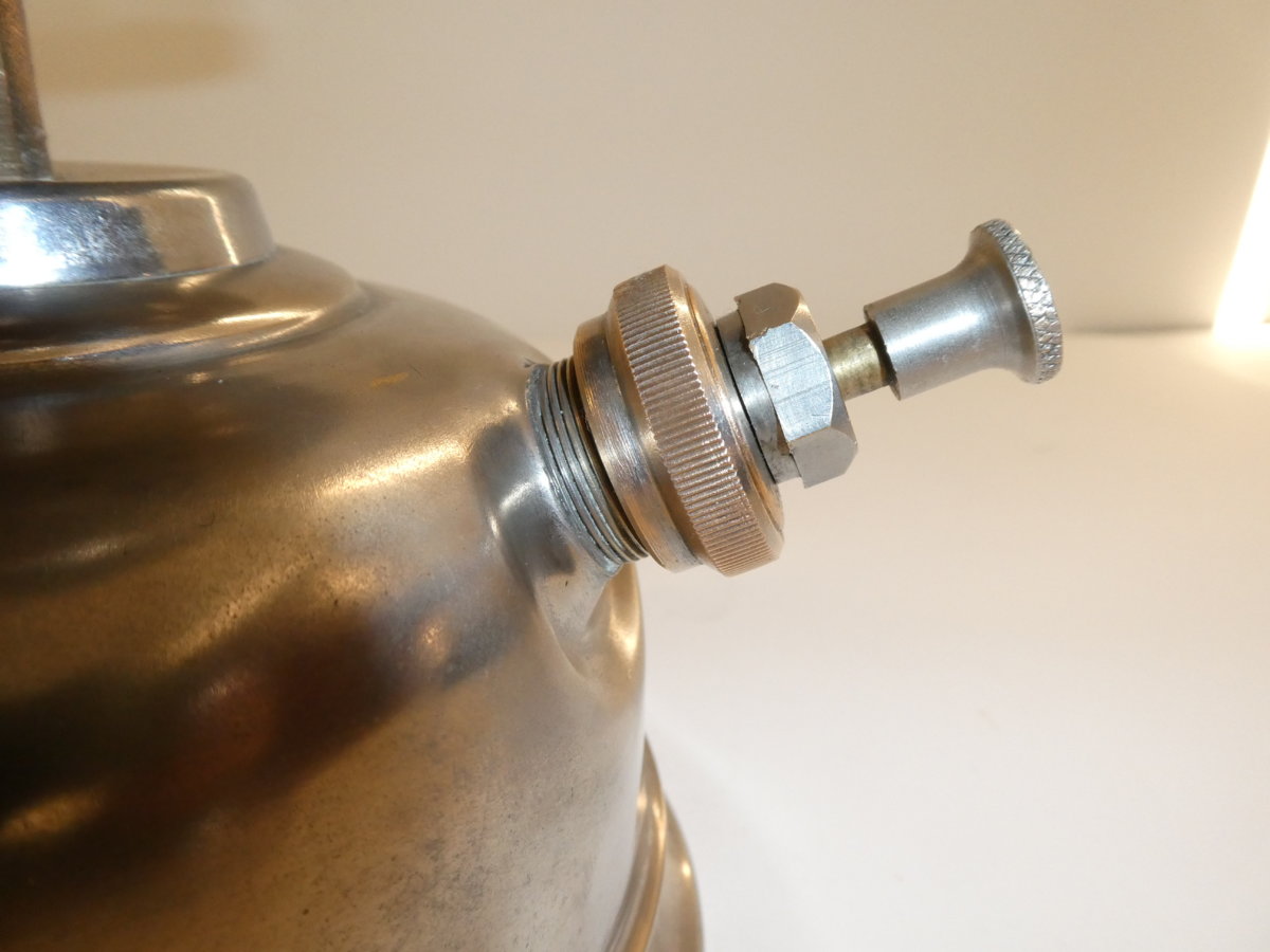

    The pump is a 'Tilley-like' pump.

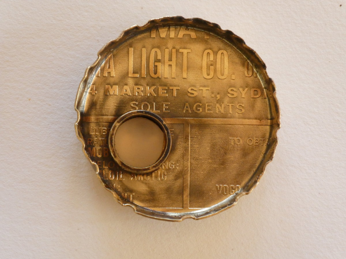

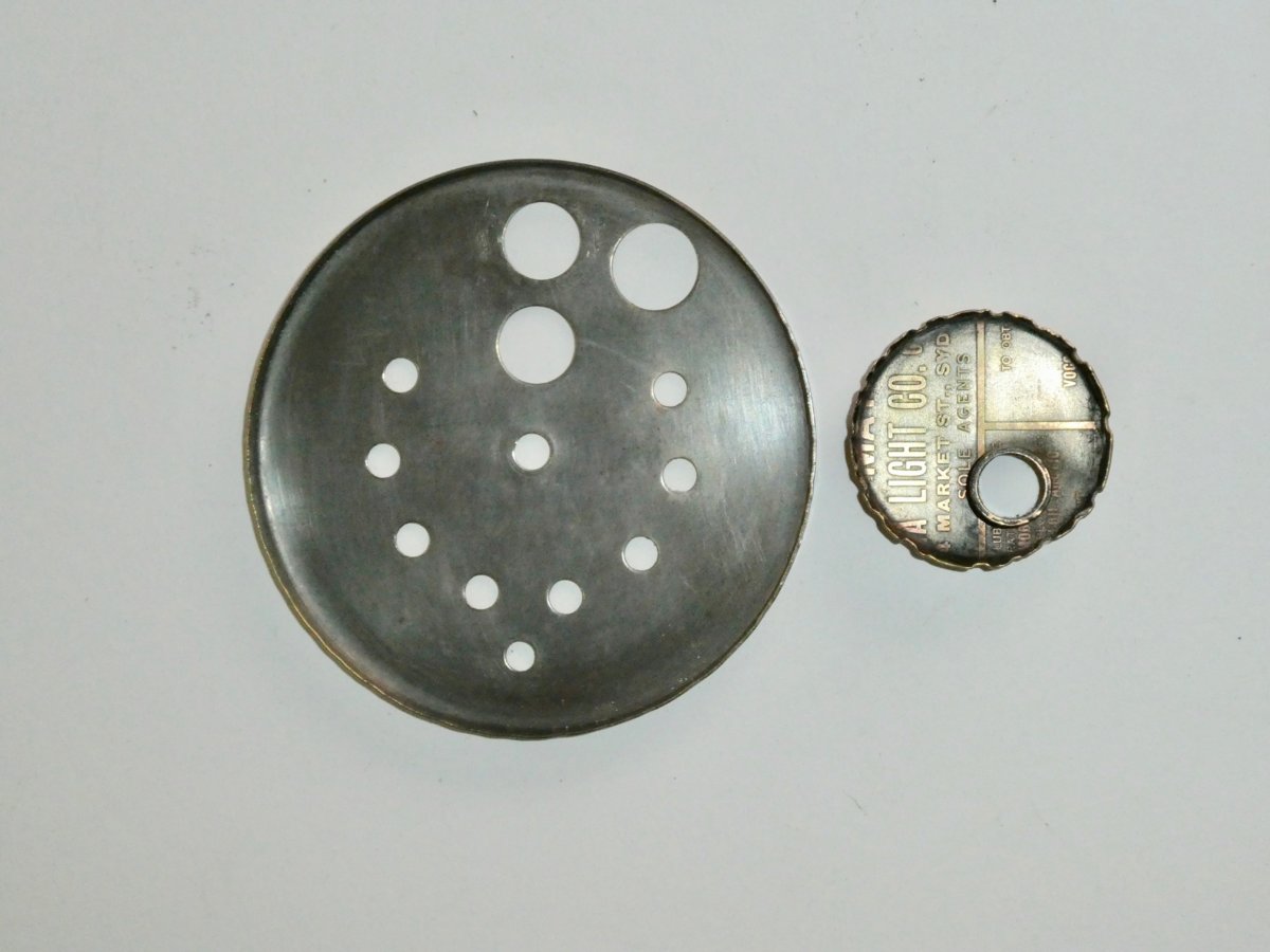

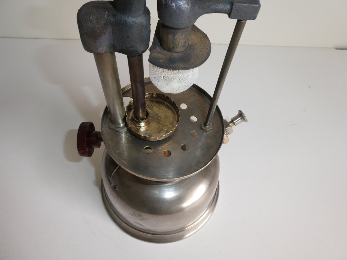

    The spirit cup has been pressed from a Gloria "Matador" electric lighting system name plate (see here).

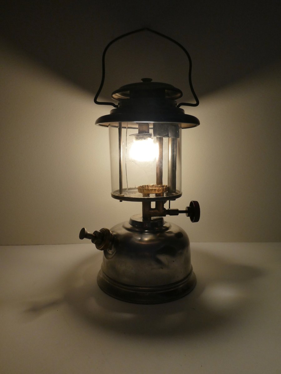

    Here it is up and running.

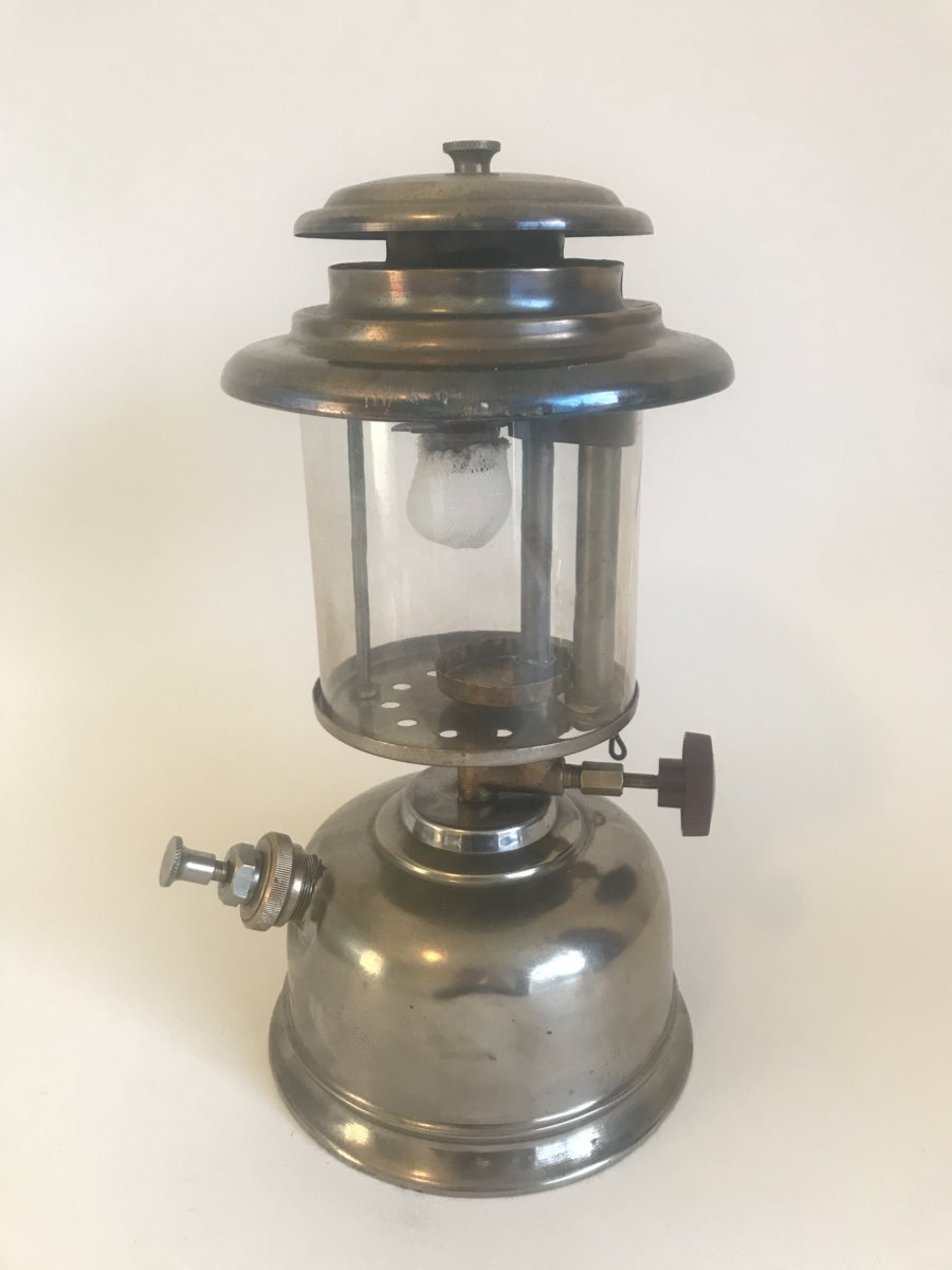

    As it came.

    Well fettled and it's running great, Tony.
    Thanks for sharing.
    8,909
    A robust lantern and well fettled!:thumbup::clap::clap::thumbup:

    Hi tony,
    Beautifull lantern.
    Very good job of restore :thumbup:
    Congratulation.

    Very nice restoration and a fine rundown on all the info. Pictures are great.:D/
