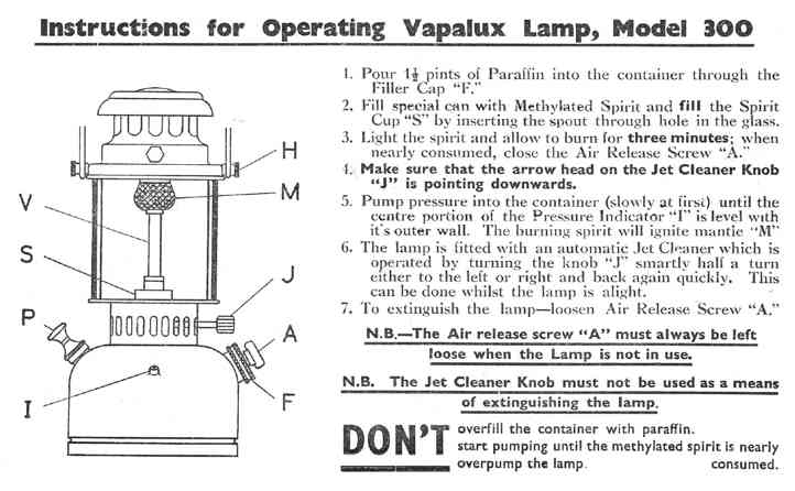

    Vapalux 300 certainly did exist. W&B issued instructions for it. ::Neil::

    Well there you go Neil: a clear illustration how even owners and collectors can mix things up.
    Without any doubt an unintended and honest mistake, but confusing for those that seek information. This can happen to all of us, hence the caution to be critical of what we contribute.
    Regards, Mike

    I'm confused. I took it that @M.Meijer is saying the Bialaddin 300 does not exist, not the Vapalux 300? @Mackburner

  10. Mackburner
    6,056
    Hmmm 50 odd years I've been doing this and someone comes along and proves me wrong. Well spotted. Doesn't do much for my ego but as ever it's the truth we seek and I don't mind being proved wrong at all. Been calling these Bialaddin 300 for a long time and never bothered to check it. It's right enough though because I can't find any reference to a Bialaddin 300 anywhere. The first Bialaddin lanterns sold were Vapalux 300 lanterns but with the new multihole hood and actually Vapalux model 300X but marked as Bialaddin 300X. So they were sort of 300s but marked as 300X and we need to add the X in the reference gallery.
    This is good useful input. Made me go look for the evidence and check the PLC where I found another mistake because I had models 305 listed as 305X and they never had an X. So thanks for this it is another small advance in our quest for truth and I am very grateful. ::Neil::
