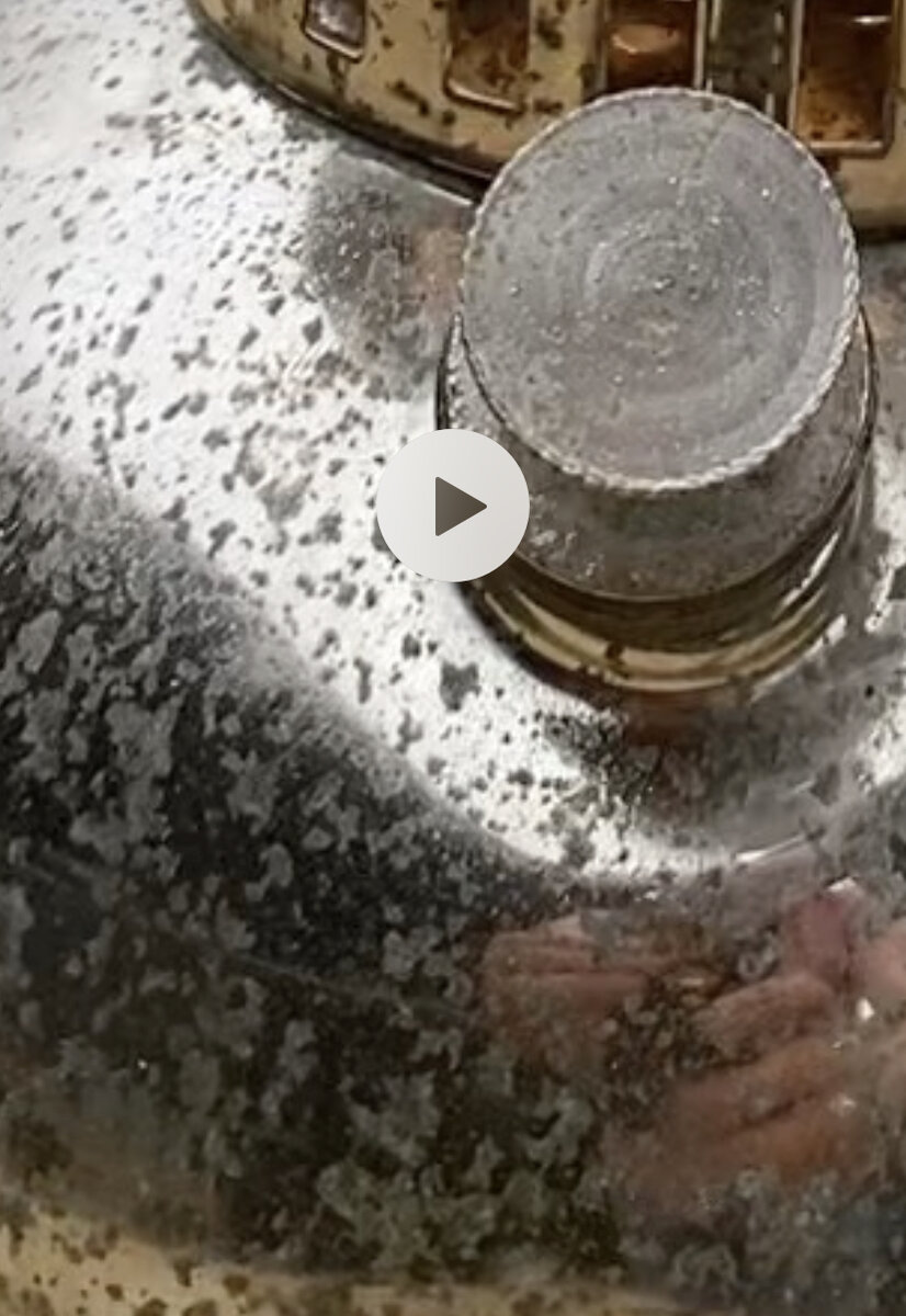

    I have an Optimus 1350/350CP which is quite corroded. Is there hope of maling it shine? i’d like to make it shiny, but what will i have to apply? Citric acid?
    i have seen people rub The lamp, so that the brass is exposed. Is that a possability?
    advice? Thanks!

    Hello Atle,
    I think the spots may be deeper than the plating.
    A short dip in citric acid may help. But not for more than three or four minutes. Then use a fine polishing compound and let’s see what you get.
    It is very easy to polish through the plating so go slowly and check often.

  4. ColinG
    3,863
    It doesn't look like brass. I have a steel made, nickel plated Coleman that came to me in that state and yours 'looks' the same to me. Try a magnet to see if it is ferrous.

  7. Matti Kucer
    Matti Kucer Sweden Subscriber
    Mar 4, 2018
    293
    Sweden
    Hi!
    If You check the metal when the fuel lid is off then You will see unplated brass there. They are supposed to be made of plated brass.
    The 1551 tanks where made in steel.
    Regards

  11. MYN
    2,163
    Despite all the pitting corrosion, do you see any traces of red rust?
    If its made of steel, you'd surely see some. If its brass, there won't be any.
    You need not polish it all the way down to bare yellow brass. That is very tedious.
    Some gentle polishing(with Autosol, Mothers, Never-dull, anything) would usually make the blemishes and corrosion inconspicuous and restore back a lot of shine.

  13. Nils Stephenson
    2,891
    If there is a label on the lamp that says 1350, then it is brass. The 1350 was nickel plated brass on the tank and globe cage. The hood was chrome plated. I would expect polishing the nickel off the tank would be a big job. Doing it chemically or by electrolysis would be easier and quicker.

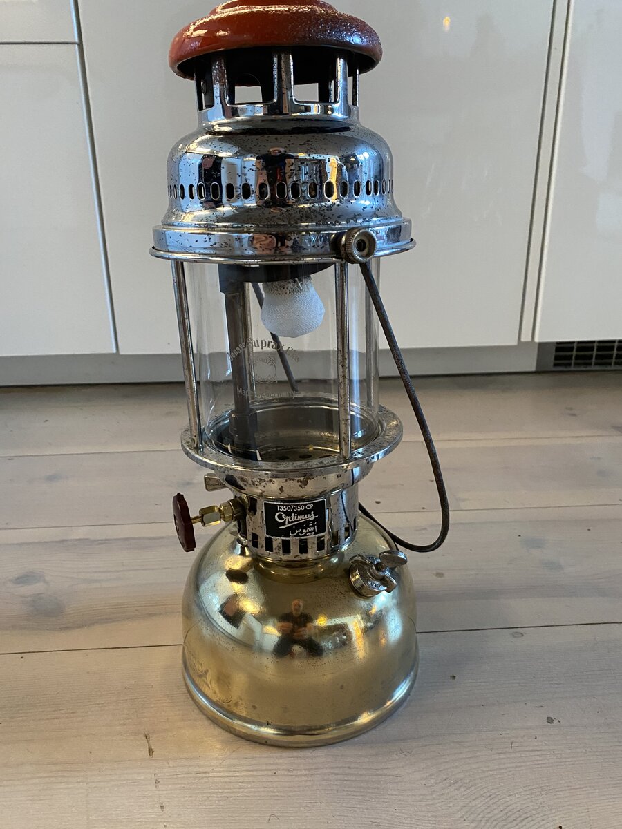

  19. Atle Hundsnes Norway
    Oct 12, 2021
    15
    Norway
    So i painted The top, and bubbles appeard when The temperature rose. I’ll have to Get A new top. Else the lamp looks good, i think. FC7E3B08-45C2-4DE4-B4E5-8686B546C124.jpeg
  20. ROBBO55
    2,689
    Looks like you have yourself a working lantern :thumbup:
  21. Atle Hundsnes Norway
    Oct 12, 2021
    15
    Norway
    It’s working, allright. After much effort and some New parts. The hardest was The pre- heater, which now is workig. i’m quite pleased with The brass- look. I didn’t waNT it to be too shiny, The contrast would be too much.
  22. Fireexit1
    1,691
    Hi Atle, looks like it will give good service. The top is enamelled "emaljert" to work with high temperatures. Paint will not work. Maybe remove the paint and live with the old enamel finish ?
