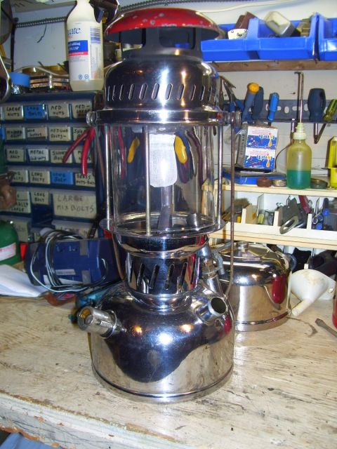

    I have a made in Germany Day Lite 500CP?
    The non return valve on the pump loses air.
    I tried to clean it with no success.
    Is there a replacement part for this model is Europe? The nitrile seal under the spring is very hard to remove.I don t want to damage the NRV.
    This is the lantern.
    Day Lite (made in Germany)
    Any info on this lantern would be welcomed,
    Thank you
    Agostino

    There are no Daylite replacements for sale in europe. But I guess that similair 500cp lantern parts will fit ? I guess it is the standard px type ?
    Also most pressure freaks over here make their own seals.

    Nearly every piece from the Petromax 500 will fit

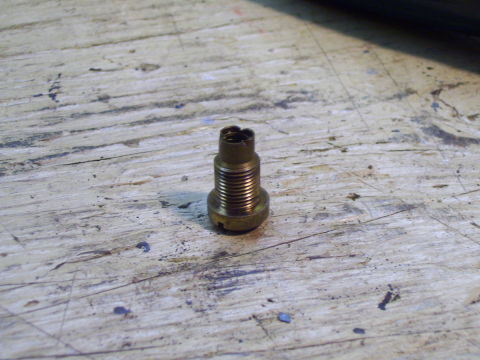

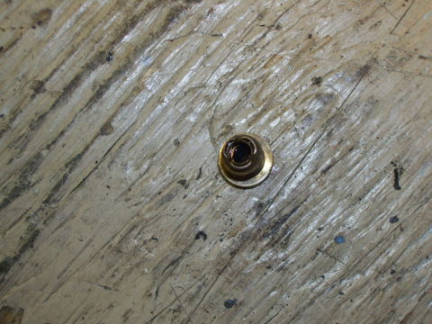

    here is pic's of what i have , haven't looked at it in a while so don't remember details off hand. day lite lantern parts

    I installed a petromax NRV with no effort.
    Petromax parts fit this model perfectly.
    Thank you for your help.
    Agostino

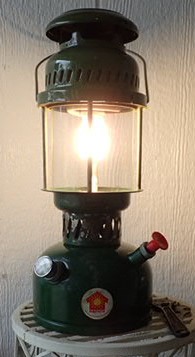

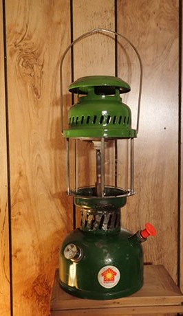

    I just got a green Day Lite. Does anyone have a clue about when it was made?
  7. Mackburner
    5,966
    1954 to 1970. I will send you the Instructions. ::Neil::

  9. Reinhard Germany
    Oct 15, 2018
    262
    This lamp was manufactured by Meyer&Miss in Hamburg Bergedorf.
    This ist the last version.
    You can see it on the refined manometer.
    Patent No DE000001556064A
    Most parts are not compatible with Petromax parts.
    Regards Reinhard

    It's a great lantern. Had to change the pricker and tighten the generator nut. New mantle, fuel, and pre-heat. Fired right up.
