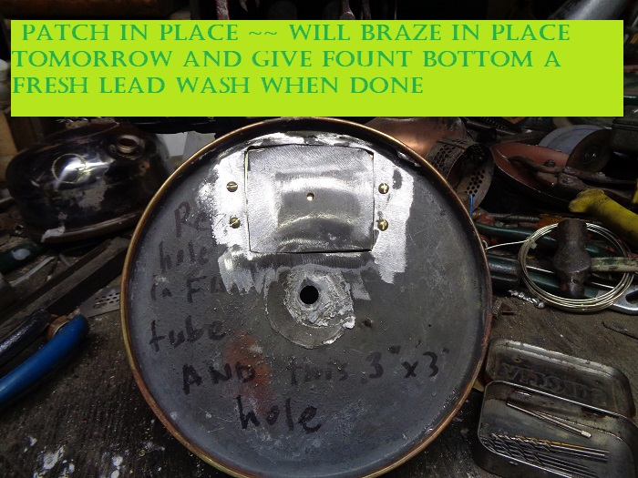

    one of my collector guys was able to secure a coleman 316 arc,but it had been electrified and had couple switch holes and the bottom cut up so the electrician could reach in to make conections~~ was rough but saveable
    ahn3161.jpg this was one of the holes patched with brass plug ad silver solder
    this was the hole cut in the bottom to wire it~~~~~ you can see the back plate inside used to strengthen the brass plug to patch a hole~~
    I cut a cardbard template so I could cut the [patch from a donor CQ bottom
    template marked on donor fount bottom~~~
    put a brass back plate into keep the patch secure while brazing in ~~~
    ahn3161.jpg ahns3162.jpg ahns3163.jpg ahns3164.jpg ahns3165.jpg ahns3166.jpg ahns3167.jpg
    patch in place before brazing ~~~
    ahn3161.jpg ahns3162.jpg ahns3163.jpg ahns3164.jpg ahns3165.jpg ahns3166.jpg ahns3167.jpg ahns3168.jpg
    Brazed in and fresh lead wash on the entire bottom~~ just have to level the swirl around the bottom nut~~~~ then will be ready for a replate !!! ~~~ about 9 hours work so far!

    funny you should say that~~~ we originally thought I would have to remove the entire bottom and replace with a CQ donor bottom! , but why do a heart transplant when a bypass would do! ;-)
