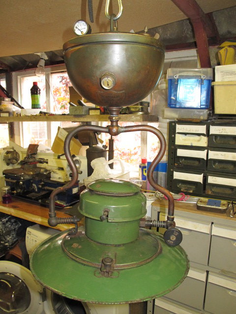

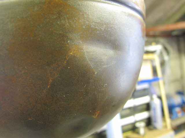

    Hi after collecting lamps for a while every now and again one turns up that you really want to run but how do you fix it well this was one of those lamps
    Nice old blanchard that leaked air like a sieve as fast as i pumped air in.!!

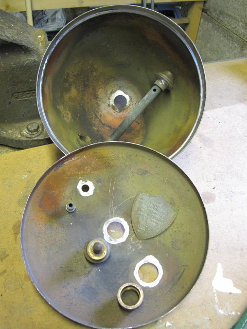

    First it was a total desolder and not so easy as quite a few bits were screwed and then soldered into place.

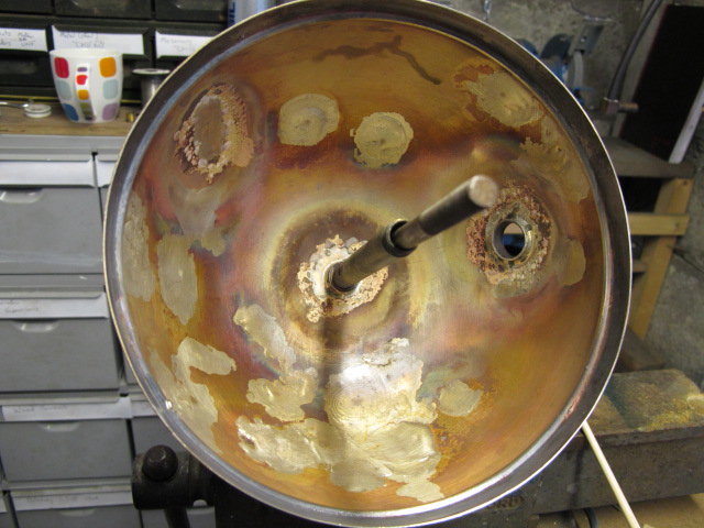

    Then finally started to solder all the fine stress cracks up internally this took quite a long time doing a few then cleaning up only to find more!!
    1346445327-IMG_2431_1.JPG 1346445337-IMG_2435_1.JPG 1346445348-IMG_2440_1.JPG 1346445360-IMG_2444_1.JPG 1346445371-IMG_2447_1.JPG 1346445397-IMG_2449_1.JPG
    After all the inside was complete silver soldered up i had to resolder the thing together this was not so easy either without getting soft solder inside the tank anyway it was done but i never took the pics i will do on the other one i have here waiting for surgery!!
    As you can see now holds pressure and burns again seen here on display at ashover last year

    Thanks Christer i never did get around to polishing it, it still has a somewhat crazed appearance outside but i just gave it a good rub with scotchbrite and this leaves like a satin type finish now well dull as i did this over a year ago now
    i will take a few pics and post so you can see it is not like a new lamp but then it runs at 95 years old and will most likely do so for a few decades yet at least i like to think so
