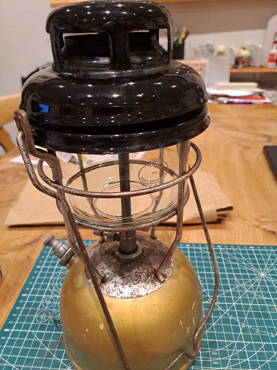

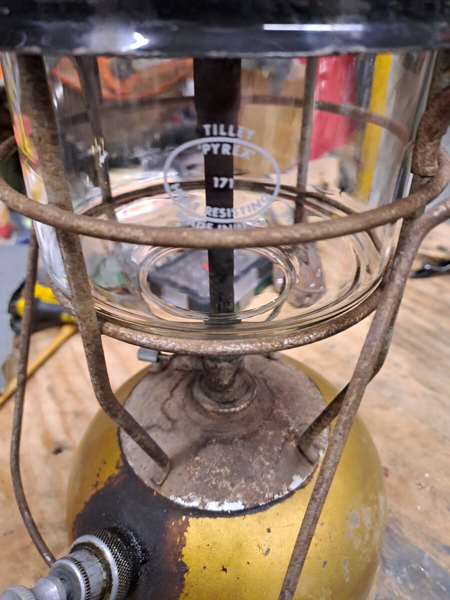

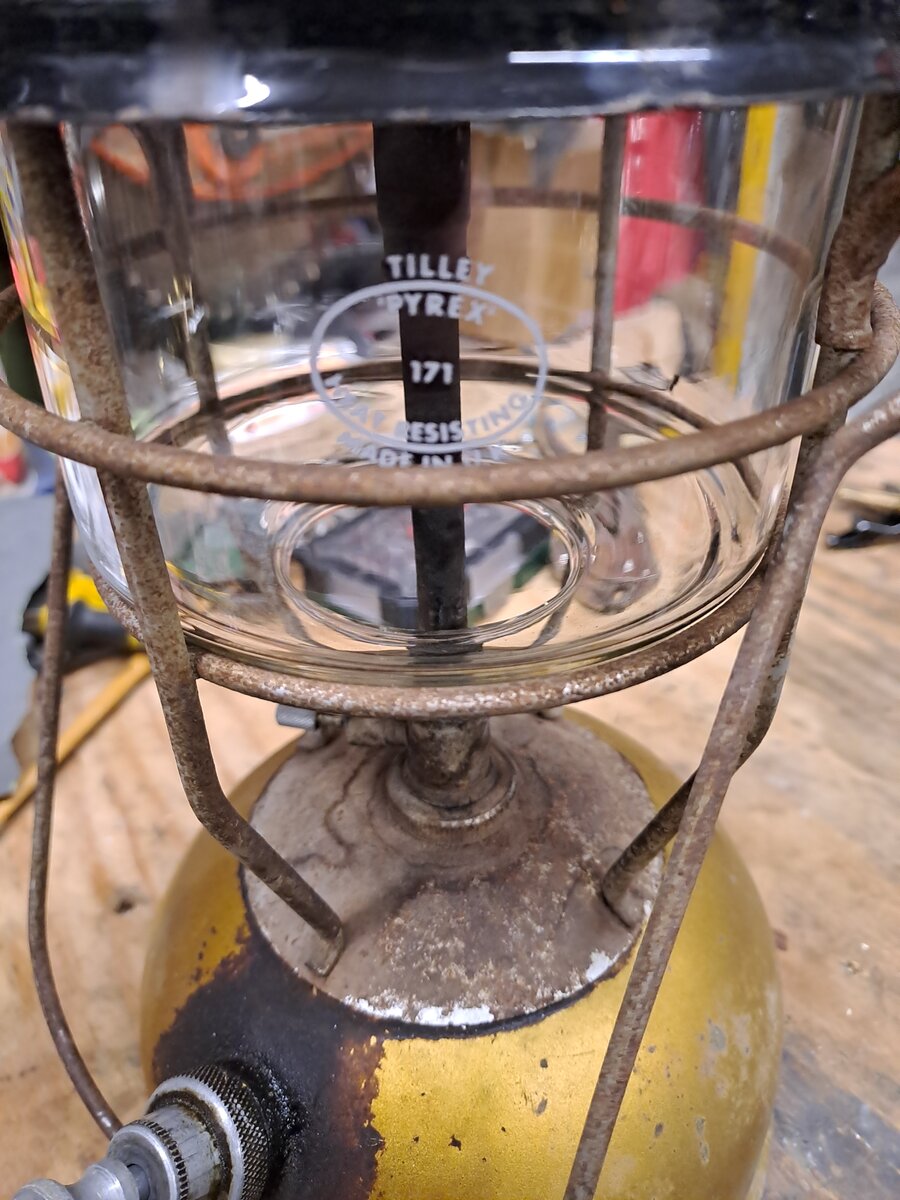

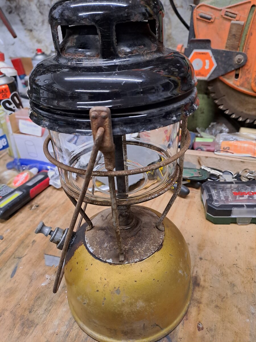

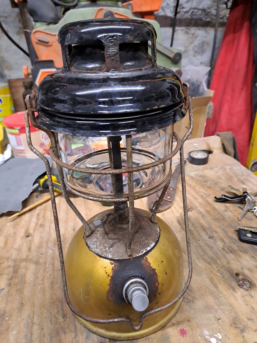

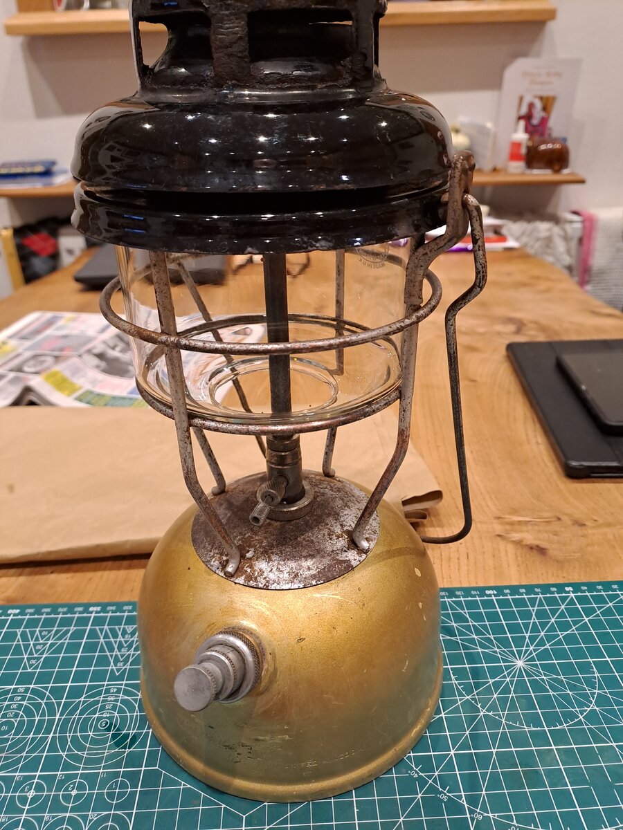

    Hello again. I couldn't help but bid on another lamp to rescue. Looked horrid in the pics but I could see some potential. I could just about make out the date on the bottom in the sellers pics. Dec 65. I could also see it was a made in UK glass and it looks absolutely brand new. I've given it a quick clean in some soapy water and it really does seem ok. It has a brass cock and ally pump and a pretty clean looking vaporizer. Hardly any carbon on the needle. The burner was a bit seized and the knurled nuts took some getting undone but everything else looks good. Top 2 pics are after a clean 20240229_190926.jpg 20240229_190919.jpg 20240229_173947.jpg 20240229_174006.jpg 20240229_173930.jpg 20240229_173922.jpg 20240229_173945.jpg

    It should clean up nicely. :thumbup:
    1965 the brass cock is more than likely original and has the flat valve seal with a brass holder rather than the later one piece seal.

    West Yorkshire
