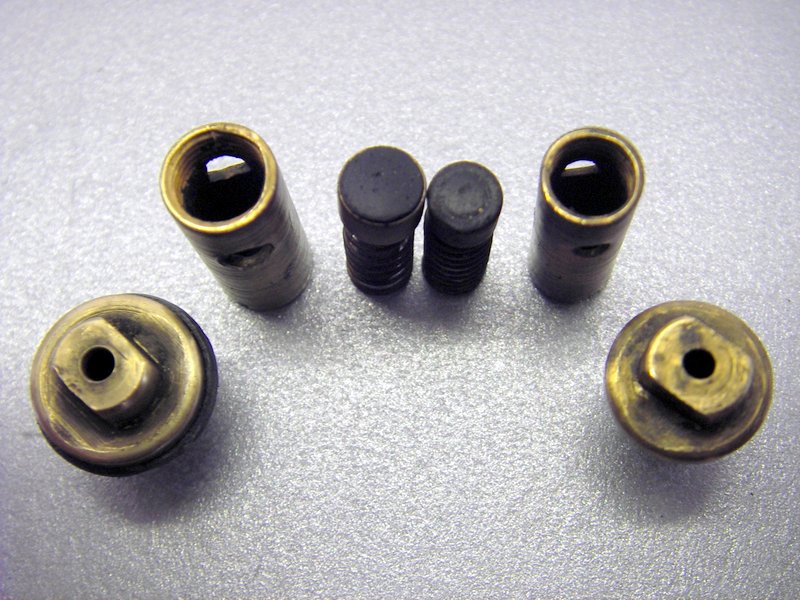

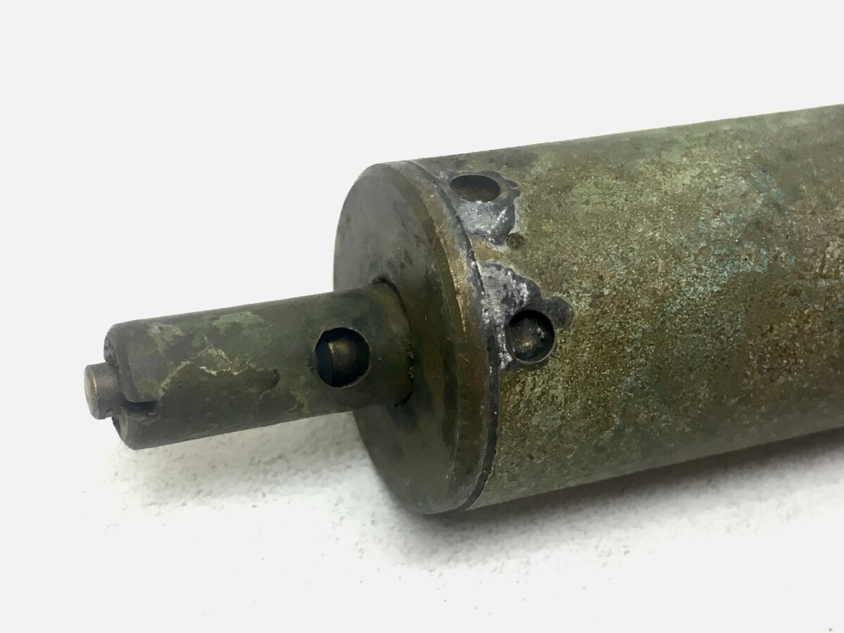

    No joy with removing it via pliers so desoldered the end of the tube (in for a penny). The end is not a thin lid like I've seen on the BernieDawg YouTube video but a proper thick cap. Solid construction!
    There are even holes at the end of the tube for the solder to go in and a channel for the solder to run through on the end cap.
    Consequently even though the bottom cap would rotate, I couldn't pull it off. I had to stick the heavy duty NRV removal tool (basically a thick metal rod with a slot on the end) down the pump tube and give a couple of good whacks with a hammer before it popped off.

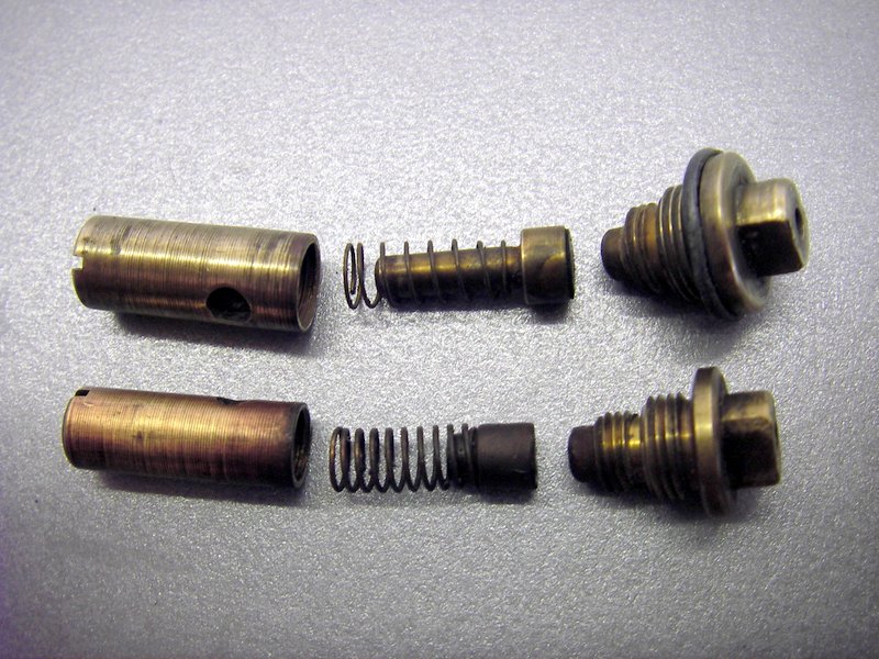

    Anyway I drilled through the NRV, left it soaking in penetrating oil overnight before using a cheap screw extractor and it's finally out.
    The relief is palpable. I didn't think it would ever come out!
    I also rescued a lot of solder from inside the font and will take the opportunity to give the interior a good clean. A lot of brown particulate residue was in it.
    I have a couple of replacement NRV valves from Base Camp so will be fitting one when it's all back together again.

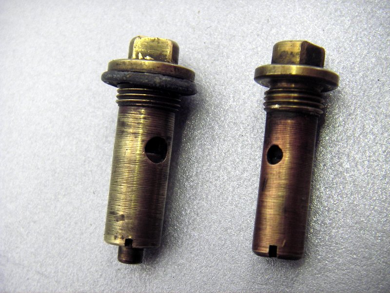

    Are you sure they are the correct ones? The NRV for the 1050 is a larger diameter than the 'normal' one.
  8. Wai
    Wai United Kingdom Subscriber
    Sep 12, 2020
    19
    London, UK
    Yes, Mike was aware of the size difference and he sent me the correct ones. I've just tried it and it fits.

    The end cap needed some effort to get back on. I used too much force and caused hairline crack in the tube. I sealed this with some solder as I was soldering back the bottom.
    Resoldering the tube back to the font took a couple of tries as the angle was initially too horizontal and I could not screw in the NRV as it was hitting the fuel intake tube in the center of the font.
    I repositioned it probably too vertical but its fine.
