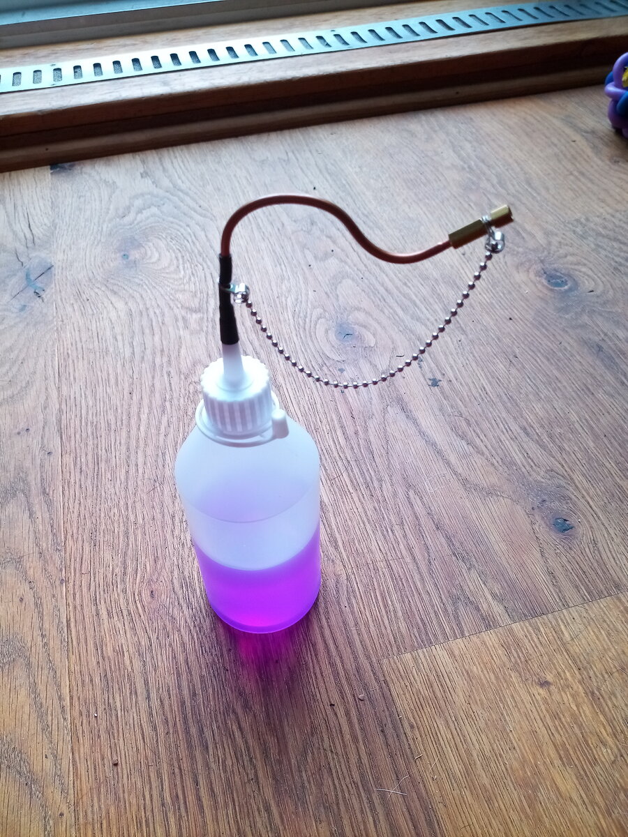

    @Norman made me this...
    ...and it works brilliantly for all my hard to fill pre-heater cups.

    @ColinG Nice one. Looks to be an upside down system right?

    Yep, that's right.
