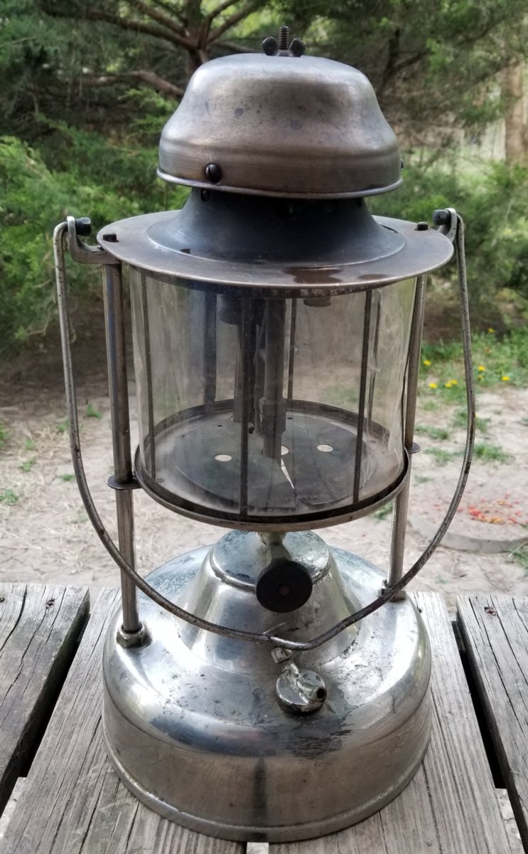

    Greetings and thank you for adding me. I have here a recent find that I have questions about. Is there a model number associated with this lamp? About how many were made?
    I have played with some Colemans, aside from that I really know nothing about pressure lanterns. What are the chances of getting this lantern fired up? All of the valves feel tight enough I don't want to force them and the feul cap is also not moving easily. I just wiped it down after digging it out of a building packed with junk.
    Thank you!

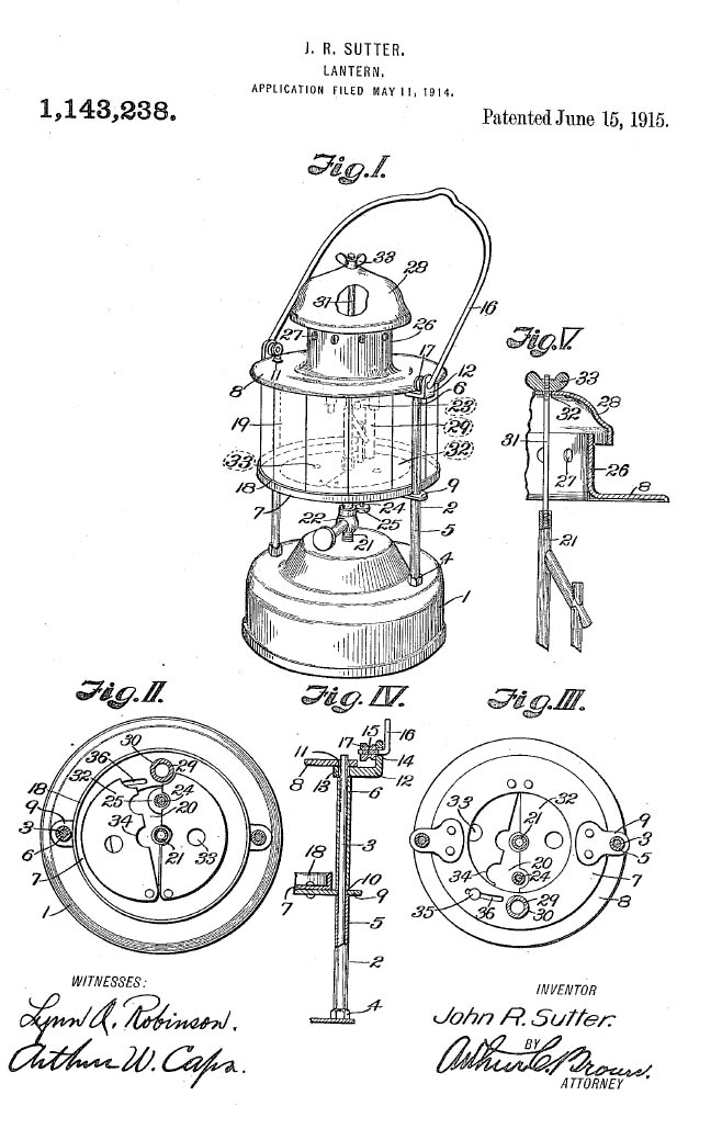

    According to Neil and his Pressure lamp catalogue, this is a model D.
    The patent he mention there (US1143238) is from 1915, and concern this lantern.
    I added it to our patent section, and you can see it here.
    I'm sure Neil will chip in when he reads this.
    ( @Mackburner )
    It's not always lamps and lanterns look very similar in patent illustrations, but yours aren't too far from the real deal:

    That is a scarce lantern and it's well worth restoring.

    That is a rare thing and a truly great find. I only know of one other so it needs treating with some care. It will be about WW1 vintage so is a true antique and I don't think many were made so it will always be a rare lantern and I wish it was here. The burners on these can be a problem if the pricker tip is damaged. I have two of those burners here from table lamps and I have yet to work out how to fettle the damn prickers. It should run OK though after a good clean inside and out. The filler inlet valve can be awkward. This one looks to be the same as used on early AGM lamps and I make a cycle pump adaptor by taking a brass Schrader valve, burning off the rubber and cutting an M3 thread. It's not a perfect fit in the threaded inlet but good enough to pressurise the lamp.
    I don't have a correct model number for this lantern. I know what Economy made from various adverts and lamps with collectors but they don't give model numbers so I gave the unknown ones a letter designation in the Pressure Lamp Catalogue. A to C are table lamps and this lantern is model D and the first one Economy made. ::Neil::

    That's a wonderful find.
    Patience, penetrating oil and carefully applied heat will be your friends.
    Looking forward to seeing the lantern working.
    Ask for guidance when you have a problem.

    Thank you all for your encouragement. I have my birthday 200A I think I will tear into first. I have a mechanical background, and can probably do this....it being as rare as it is makes it a little intimidating for a first project. I am sure I will have questions before starting this project.
    It seems really nice. The nickel on the fount is pretty good, The top looks like the plating is burned off, the mica is really nice with just 1 panel with minimal damage.
