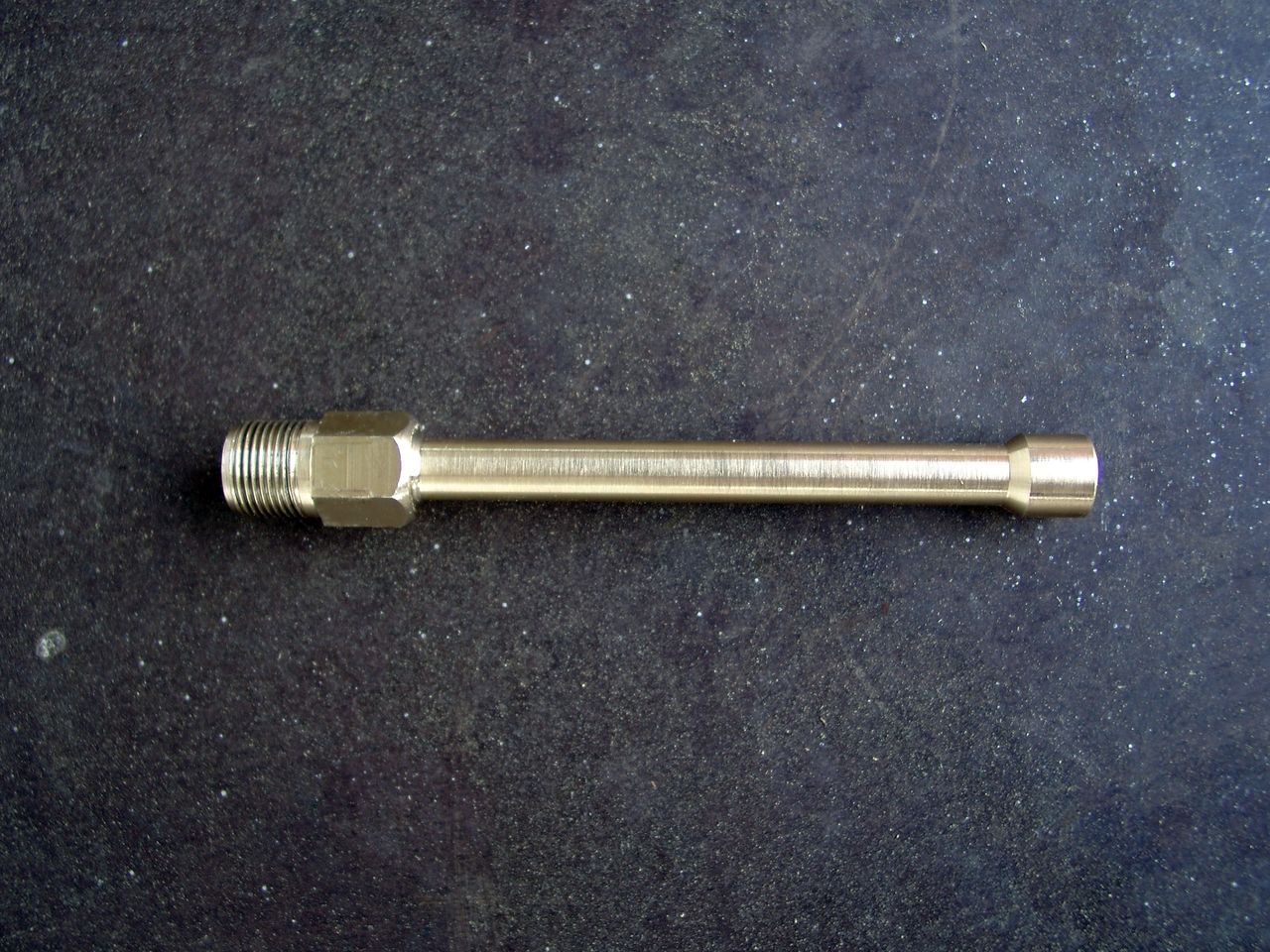

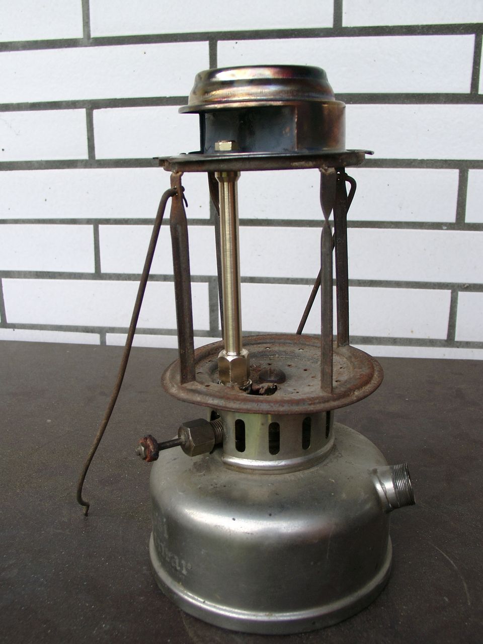

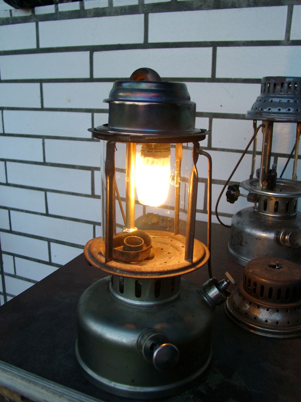

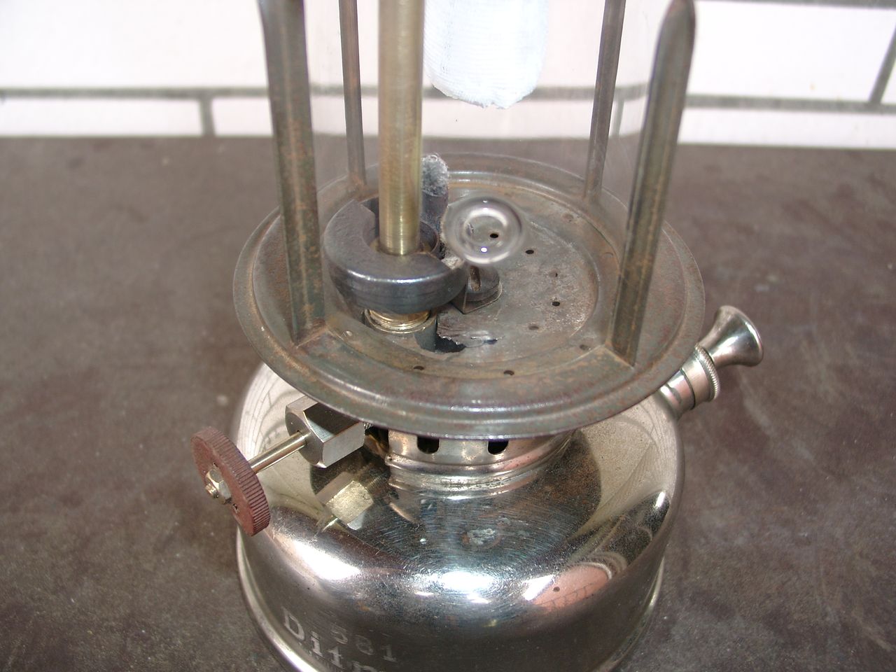

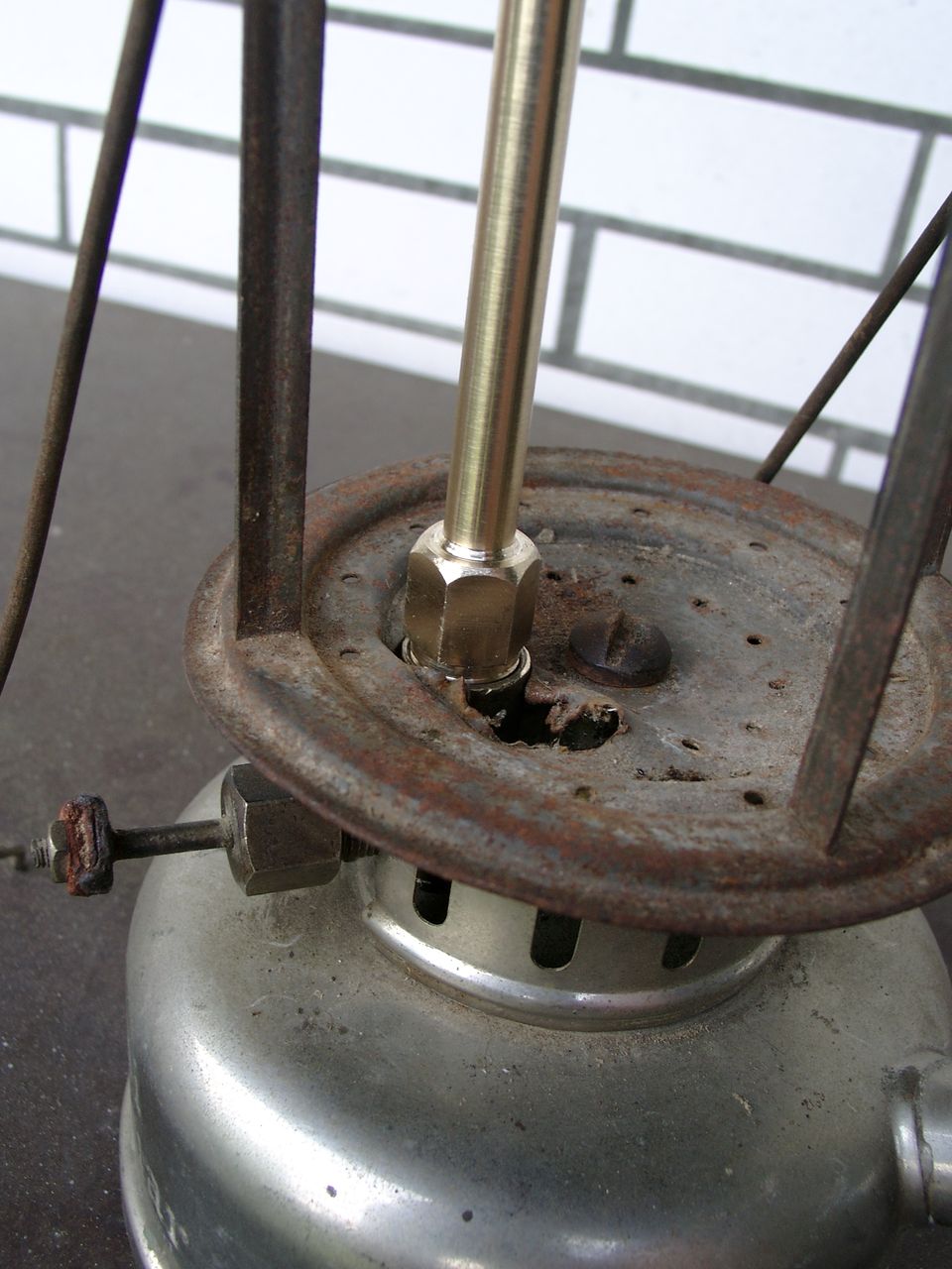

    ...even nicer now that it is complete,
    I also found the reason why it was not working properly. Still there were some leakages at the jet and the vaporizer seal. Now that it's fixed it runs properly on Aspen4.
    1463330572-05150001a.jpg 1463330593-05150002a.jpg 1463330612-05150003a.jpg 1463330624-05150004a.jpg 1463330634-05150005a.jpg
    It can hardly be seen that it has a "homebrew vaporizer" and uses a today's Chinese inner chimney, burner, jet and needle (Petromax 150HK type). Now it would even be possible to use it as a "workhorse" because the critical spares (jet & needle) are easy to get and replace.
    For those who wish to reproduce the vaporizer here's a small drawing of it:
