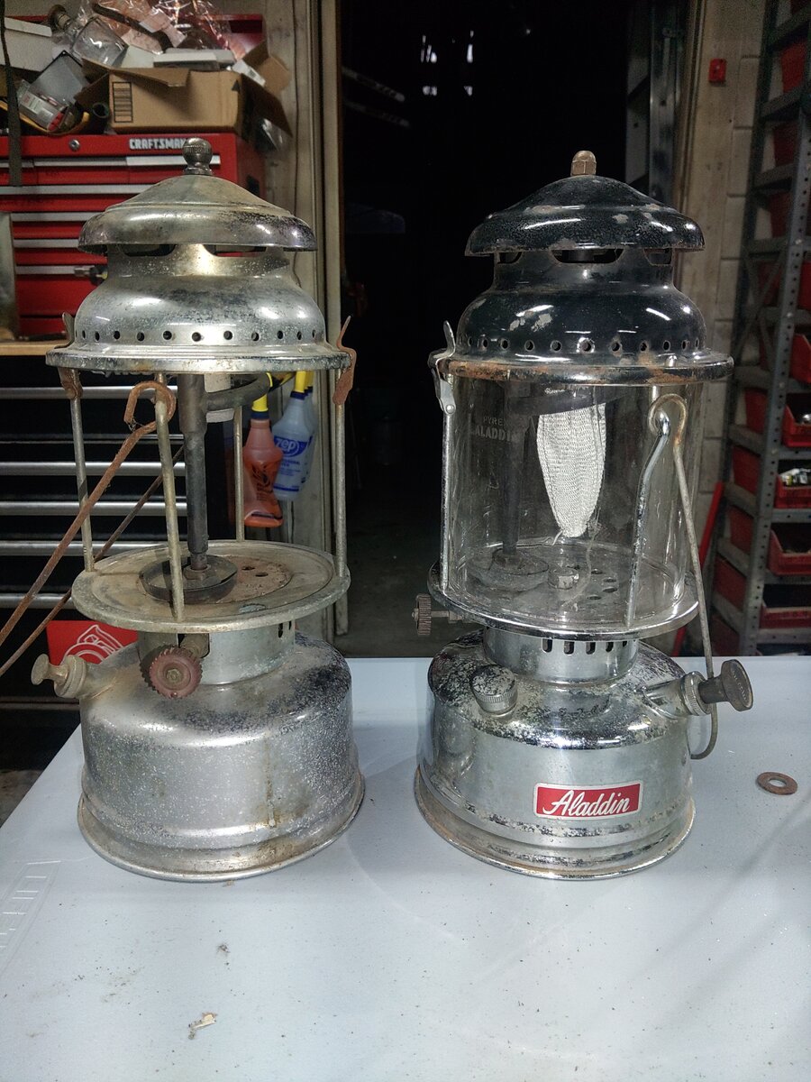

    Added photos of lanterns
    IMG_COM_202501261808136070.jpg IMG_COM_202501261808138441.jpg IMG_COM_202501261808139192.jpg

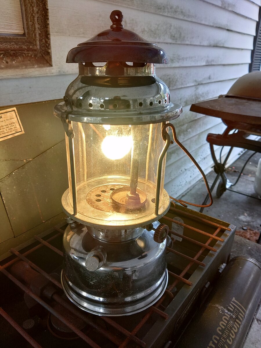

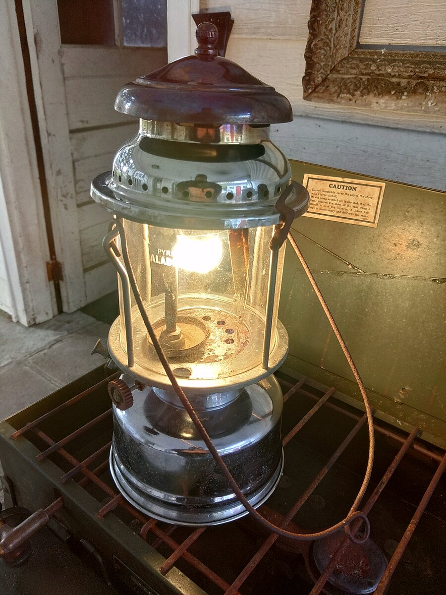

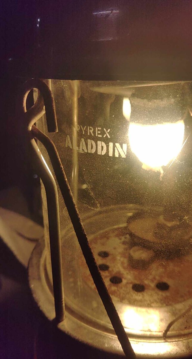

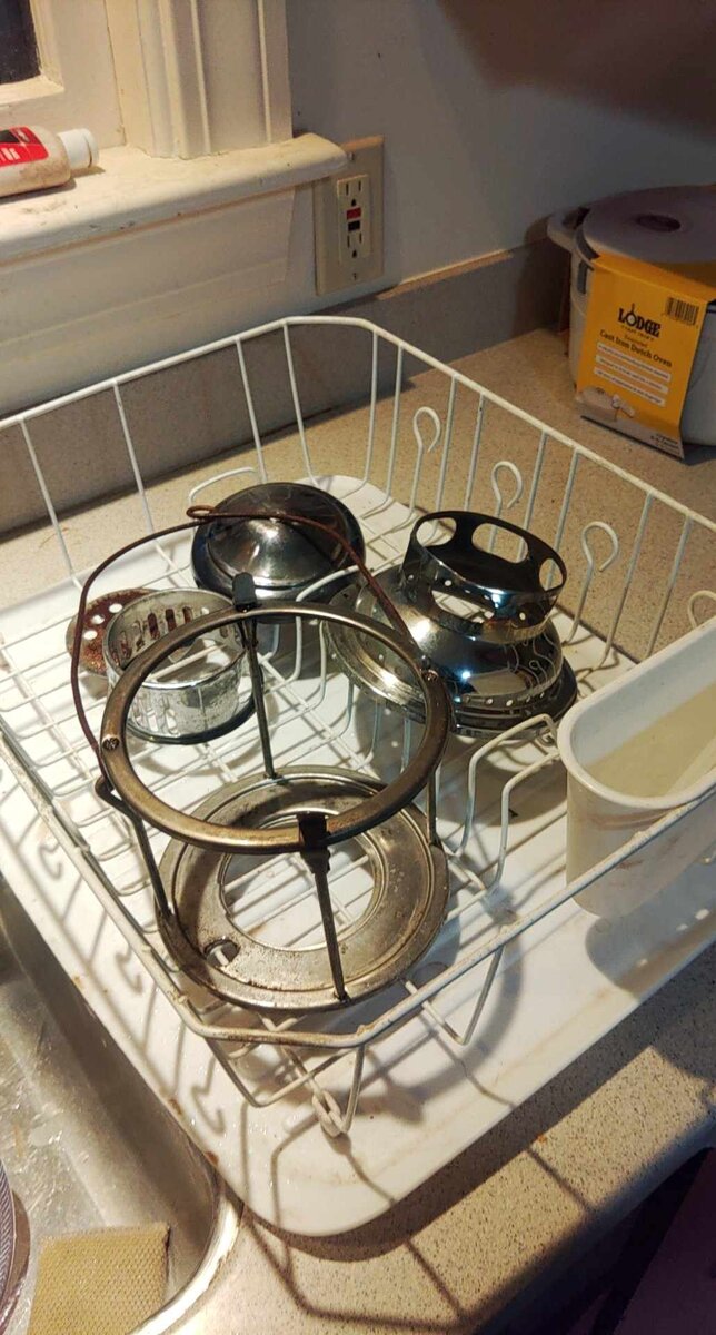

    received_963844335686232.jpeg KIMG5908.JPG received_865619718928328.jpeg received_1336934537433099.jpeg received_9682445905100174.jpeg Received them today!
    Checked them both out and unfortunately the newer one was stress cracked. The older looking one took a little fettling and came to life fairly easily... A quick clean with oven cleaner in the kitchen sink cleaned up the tank as well as the cage hood and collar. Replaced the pump cup with one from my stock. Borrowed the filler cap off of my Primus 1020 for now I'll make a new cap gasket for it. I also would like to get a better pricker that will work. Also need to tighten up the packing nut for the pricker control as it leaks some fuel but it does run.

    New NRV today, tightened up the packing nut for the tip cleaner control shaft it is no longer leaking, and a new Optimus #4 mantle. I just need to sort out a tip cleaner now along with making a new cap gasket. I'm very happy she's running nicely. KIMG5927.JPG KIMG5928.JPG

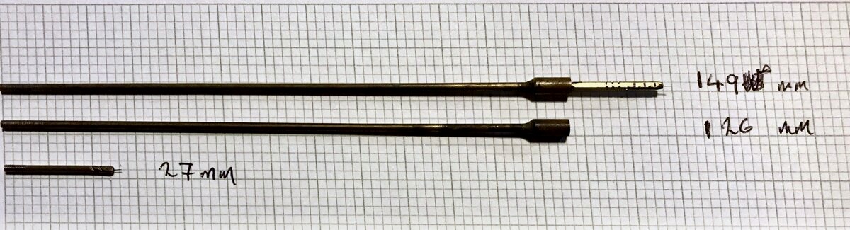

    Here are some photos of the needle and needle rod.
    The nut at the bottom of the needle rod is used to adjust the total length of the rod+needle to get the right clearance through the nipple and its jet.
    If you use a Radius needle check that it fits the jet of the Aladdin nipple.
