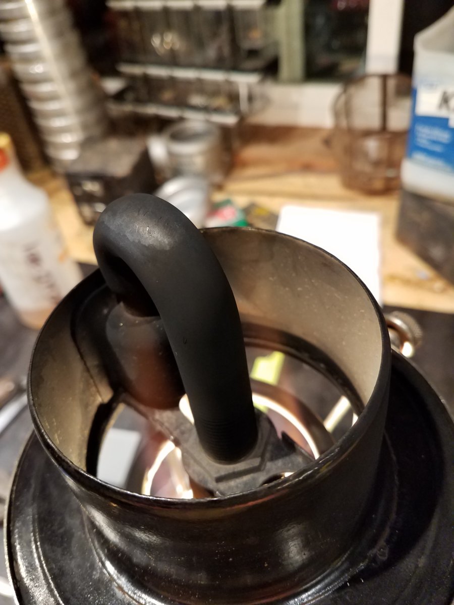

    I got the Picostar (pertromax) up and running but now there seem to be an excess of flame from the mantle. I used a Larger mantle on it and it was kind of dim, and there seemed to be a lot of excess flame. I switched to a Coleman 21, because that's what I had. and it burned noce and bright but the excess flame was still there. I don't know if it is an "excess" but I certainly think so. My experience is mainly with American Lamps burning Naptha. I probably should have had the lights down but at the time it seemed clear enough. Thoughts?

    A 21 is way too small; a 111 would be the right size. You have a halo of flame around the mantle which is a bad thing as it overheats the J-tube and can cause mixture to burn inside it. Running with less pressure will help a little. What larger mantle did you use before?

    I have a similar issue with my Efar and someone suggested adjusting the distance between the jet and the J tube but mine is non adjustable, i have fitted an adjustable top from an old Anchor lantern but have not got around to testing it yet.

    Mine now has a screw and clamp to the side of the J tube to allow adjustment, hopefully it solves the issue, the entrance of the Anchor J tube above the jet is larger than the Efars but the tube itself looks the same size, not sure if that makes a difference, i have also fitted a new jet and cleaning needle to be on the safe side.

    The Halo on the outside of the mantle is usually a rich mixture problem. If the gap between the jet and J tube is correct I would suspect the jet is worn (oversize ).

    It's actually a new orifice, It came in the little bag of parts from bright lite. I did adjust the j tube a bit as it seemed to be burning rich, That will be my next thing I will fiddle with after I get some correct mantles

    I put a Coleman 111 mantle on it (about the size of one of my socks) this seemed to help a lot, I adjusted the air gap to the 14.2 MM and it burns much brighter and appears to have a better mix. However I still do see some halo flames above it with the vent off. I heard that the pricker length should be adjusted, although I can't imagine how this would be the issue.
