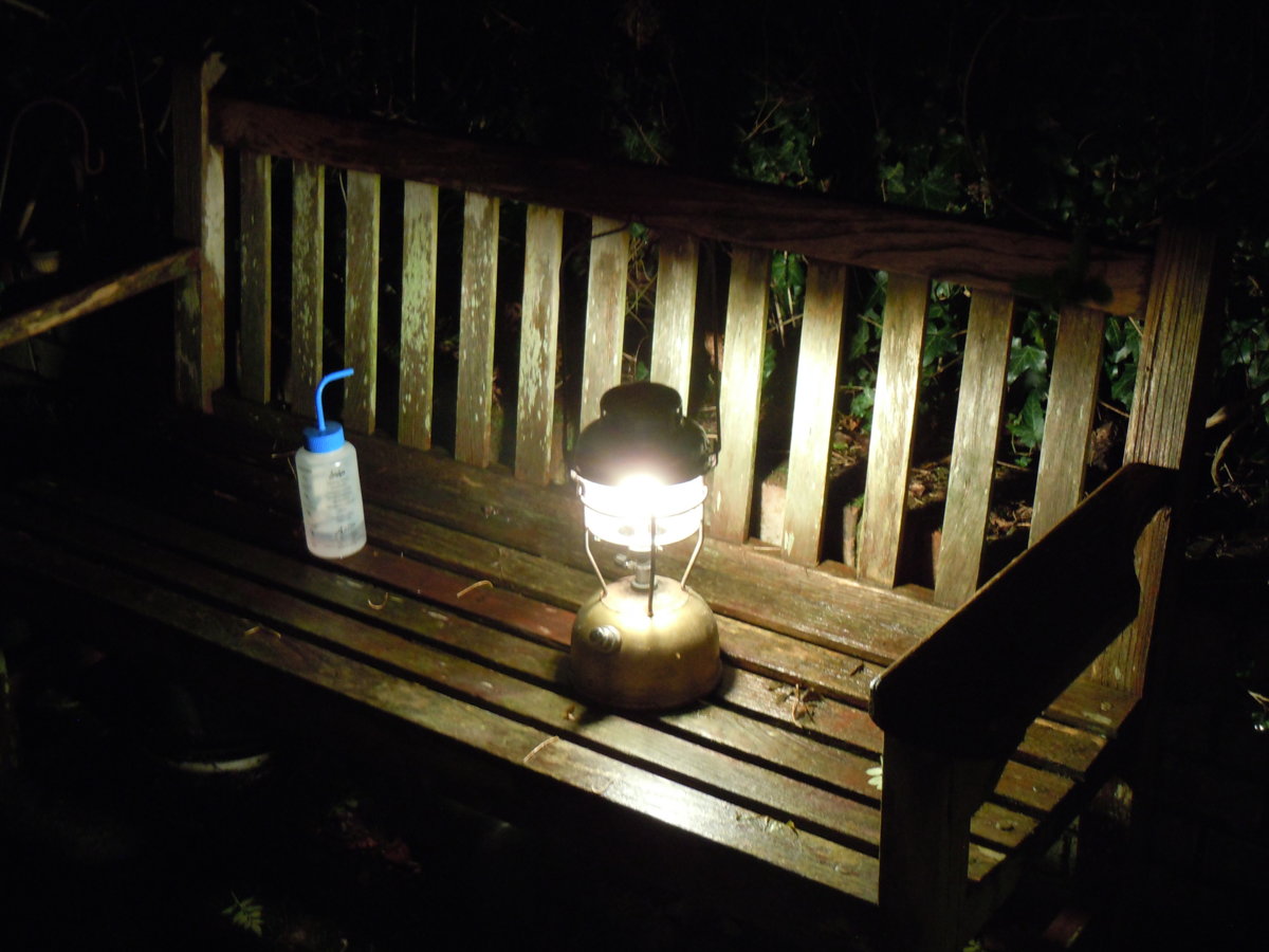

    You reminded me to light it again tonight.
    This one is an X246B (boo-hiss!! they don't like those much here)
    It is from 1964, the first year of production.
    I have had no end of trouble with new and old 606 vapourisers for it. Here it is with a replacement Korean one.

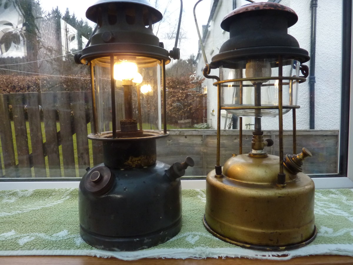

    Have 'hopefully' attached an image ( I aint no computer geek) these two lamps were in my deceased father in laws shed he had a cabin from the late 1940s to the 1980s where the family spent holidays, I think the lamps probably date from the late 40s. Neither worked straight off, the vapalux just popped and popped non stop, a vapouriser from another vapalux put that right, the Tilley also needed a new vapouriser,other than that it was just new washers and pump seals, of the four pressure lamps I have the old Tilley gives the best light output,I also have a Tilley from the 1970s, works fine but the build quality is obviously inferior. Happy fettling everybody.
    PS Not sure whether I should be sending images thumbnail or full size.

    Full size images show the image without having to click to view.
    The Tilley is from 1946 to 50, earlier the cage had lugs, not ears, later would be the dome tank and not the pork pie you have. Light and enjoy

    Thanks for the info KAB, that would tie in with my father in law buying his holiday hut.
    To bring up a completely different subject I often see photos of highly polished lamps with brass tanks, can anybody tell me which models were made in brass, why, and is it the brass tanks which are prone to cracking, all my lamps appear to have steel tanks?
  19. JEFF JOHNSON
    7,562
    Your Tilley lantern which is shown in the photograph has a brass tank, but the cage is made from steel, the hood is also made from brass except for the cowl.
    Your Vapalux lantern appears to be a brass one, but the handle is made from steel of course.

    I stand corrected Jeff, of the four lamps I have only the old vapalux in the photo above seems to have a steel tank. I can only assume they were not produced in bare brass like primus stoves because of the additional cleaning and polishing that would be involved.
