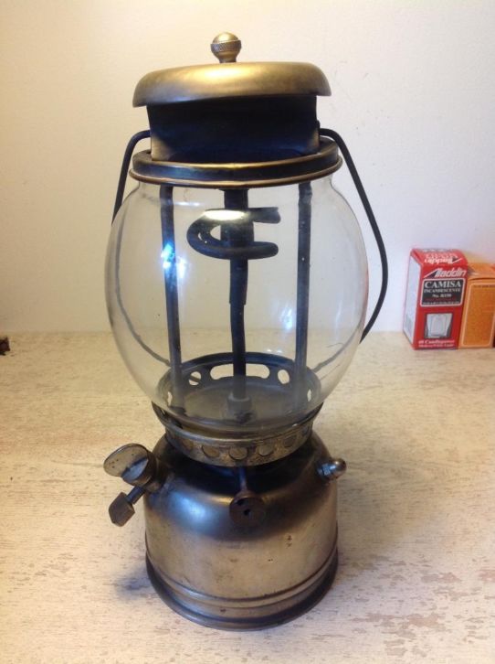

    I was in Barcelona, Spain, for vacation and at the flea market I bought these two lanterns for a good price.
    Neil says they are Focus, from Badalona (near Barcelona). Nice and rare lanterns. Both are very similar but not identycal as you can see. They are in the condition I found them. Almost complete, even with the working pricker one of them.
    Juan

    I agree, John. First time I see such generator. Here there are some other images, low quality because taken with the phone camera.
    Juan

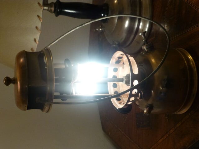

  9. Juan Argentina
    Dec 2, 2010
    702
    Mendoza. Argentina.
    Well, I could finally have one of them working but I have now to work again on it because I have a likeage on the pricker knob.
    This lantern seems to be made or at least finished by hand. Many pieces were finished using a file.
    The pricker rod works directly on the excentric, which is much bigger than a px type one. Hand finish here too. The pricker needle was to short but a Volcan one do the job very well.
    Another curiosity is that the generator nut is soldered to the generator itself so you cant adjust easily and you have to turn it clockwise to the right position.
    On the tank shoulder there is a device which seems a security valve but it does nothing: there is a lead gasket under it. Perhaps it was to fit a pressure gauge there.
    I don't know what to do with the second one as I haven't got the nozzles.
    I hope to solve the leakage during the week and to think about the globe...
    Finally, I forgot to upload an image of the top: pieces are soldered by silver.
    Juan

  11. Juan Argentina
    Dec 2, 2010
    702
    Mendoza. Argentina.
    Ok. Now it is working without any leakage and the tank keeps the pressure well.
    It is not as bright as you can see on the pictures and it doesn't burn even: one of the nozzles burns more than the other one.
    But is in working order.
    Juan
