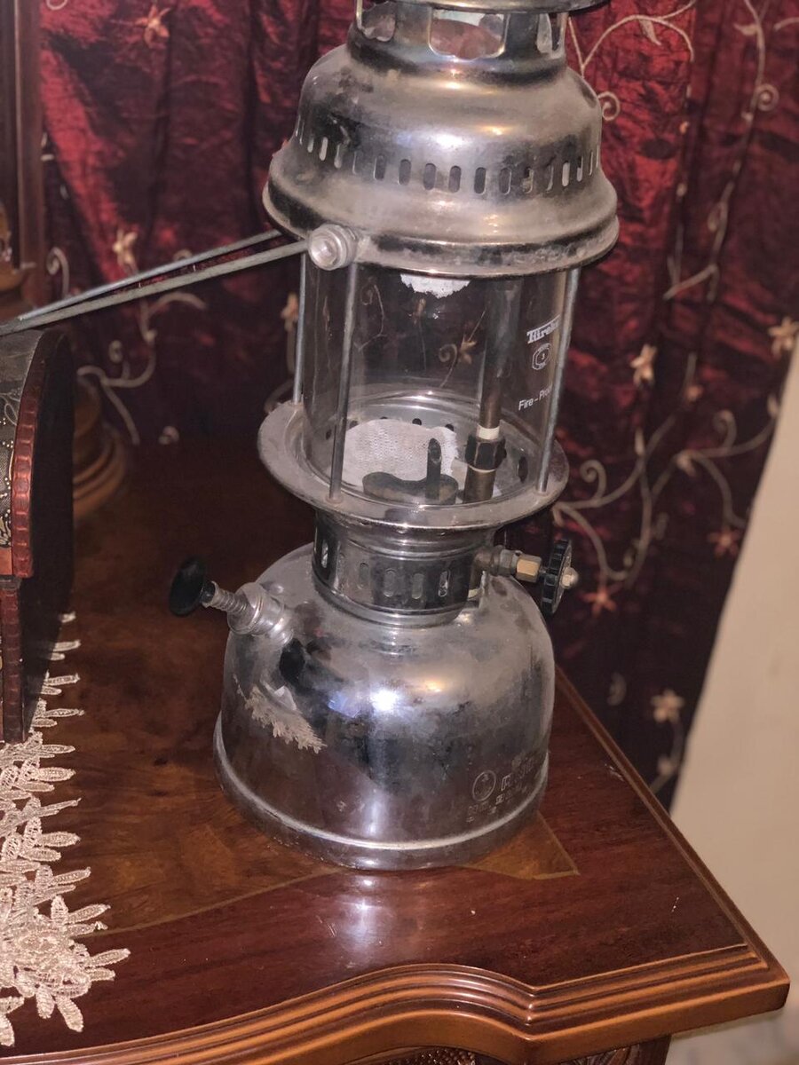

    Hi everyone, well I've just found a lantern on a local website, me being a fan of kerosene stoves, I decided to look out of the window a bit. It is my first post under this forum and my first lantern of this type also. While the lantern I am asking to define may be a very common and easy question to many of you, I am struggling to know about it. I have a bit of time to buy it that's why need your help with some information about it (Not sure all its parts are genuine, the seller is saying it is a Petromax). Please refer to the below picture with many thanks in advance. Regards, Migwar
    IMG-20210803-WA0038.jpg IMG-20210803-WA0046.jpg IMG-20210803-WA0047.jpg IMG-20210803-WA0050.jpg IMG-20210803-WA0051.jpg IMG-20210803-WA0053.jpg

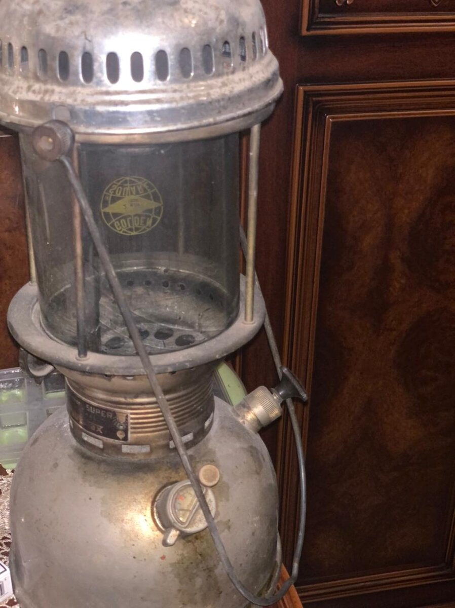

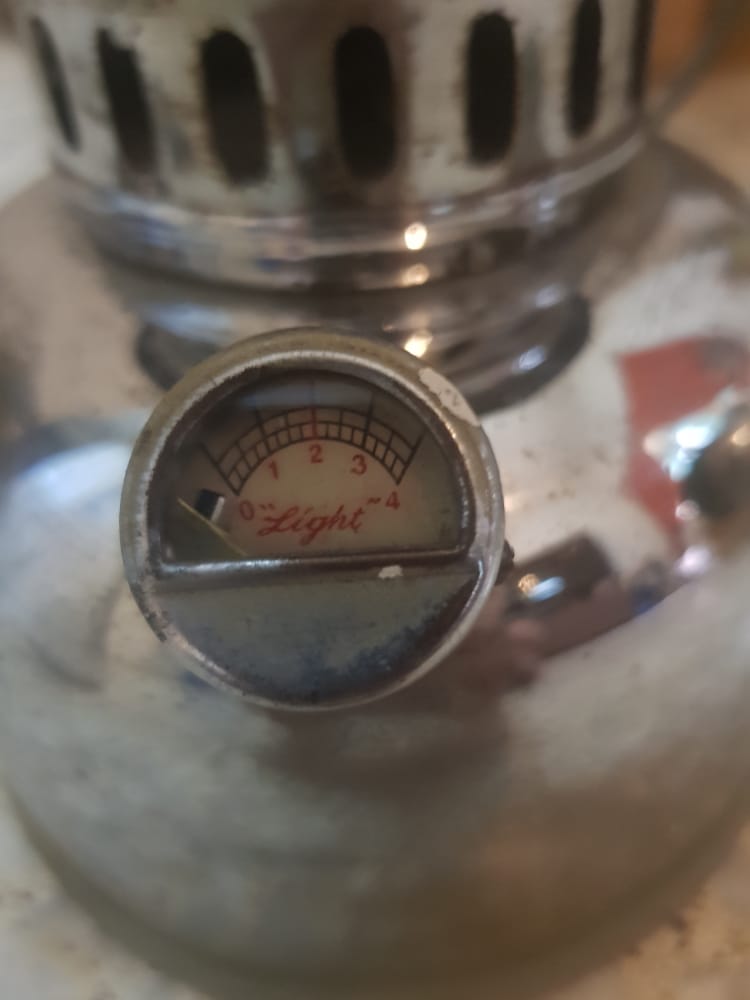

    Well reading, is knowing. The typeplate says Light which means its brand name is Light and not Petromax.
    The globe is marked (badly) with Petromax but that doesn't mean the lantern is a petromax.
    Other big give away: the lantern has rust. Now a Petromax is made of brass so can't rust like the steel Light brand.
    So all in all: DON'T BUY IT !

    Hi / Marhaba @Migwar and welcome. It looks like one of these Light-Brand or maybe a 350CP version.
    Chinese lanterns can be quite good but the glass is often weak and of course can get broken. The Petromax glass happens to fit.
    It could be descibed as a Petromax Copy or Clone, but it is not a genuine petromax. The glass is very interesting. Can you translate what it says ?

    Well, many thanks for the quick and prompt replies, this is exceptional. The glass is saying:" original German Pertromax glass" in fact the guy told me, that I can get the 6 of them that he has (His grandfather's storage). The lantern with the glasses "6" will be for 14 dollars.

    I do not know what 14 dollars is worth in the Lebanon. Here people would buy it out of curiosity and the fun of fixing it, but that it is the price of a packet of cigarettes. One thing it is not is a genuine Petromax. The tank / fount will probably say made in China on it.

    That's a Light brand lantern from China. Although its a Petromax-styled 'clone', I'd say its still one of the better-made ones from China. They're no longer made and worth getting besides a genuine German-made Petromax. If you get it restored, they'd run just as well and bright as the Petromax.
    The glass globe is not original to the Light lantern. I'm not sure if that's a customized Petromax globe from Schott with Arabic inscription on it.

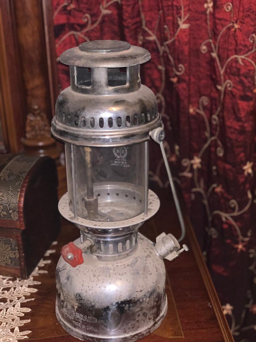

    Got some more options, I think I am exhausting this thread now. Anyone can see any prosperous piece to be maintained? Sorry for the bad quality from the source ( I know that one cannot say from distance what is working and what is not), the question is about inspiration for the lanterns as they are. Below are the pictures and I have to chose one (just in case... here the price is higher). (Thanks @MYN for your comment). Regards IMG-20210803-WA0149.jpg IMG-20210803-WA0150.jpg IMG-20210803-WA0140.jpg IMG-20210803-WA0141.jpg IMG-20210803-WA0146.jpg IMG-20210803-WA0147.jpg IMG-20210803-WA0148.jpg IMG-20210803-WA0142.jpg IMG-20210803-WA0145.jpg

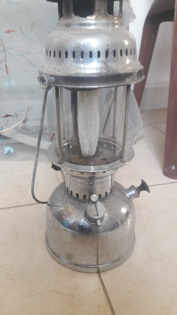

    I think the one with the upside-down Golden Square globe is a Petromax. If you go for 1 only, I'd choose that one.

    I think that the 2nd picture is a Petromax, but I also think that the top cap from the 7th might belong to it. A better picture of the 2nd one would be helpful. Also you might want a better glass (globe) for it ?

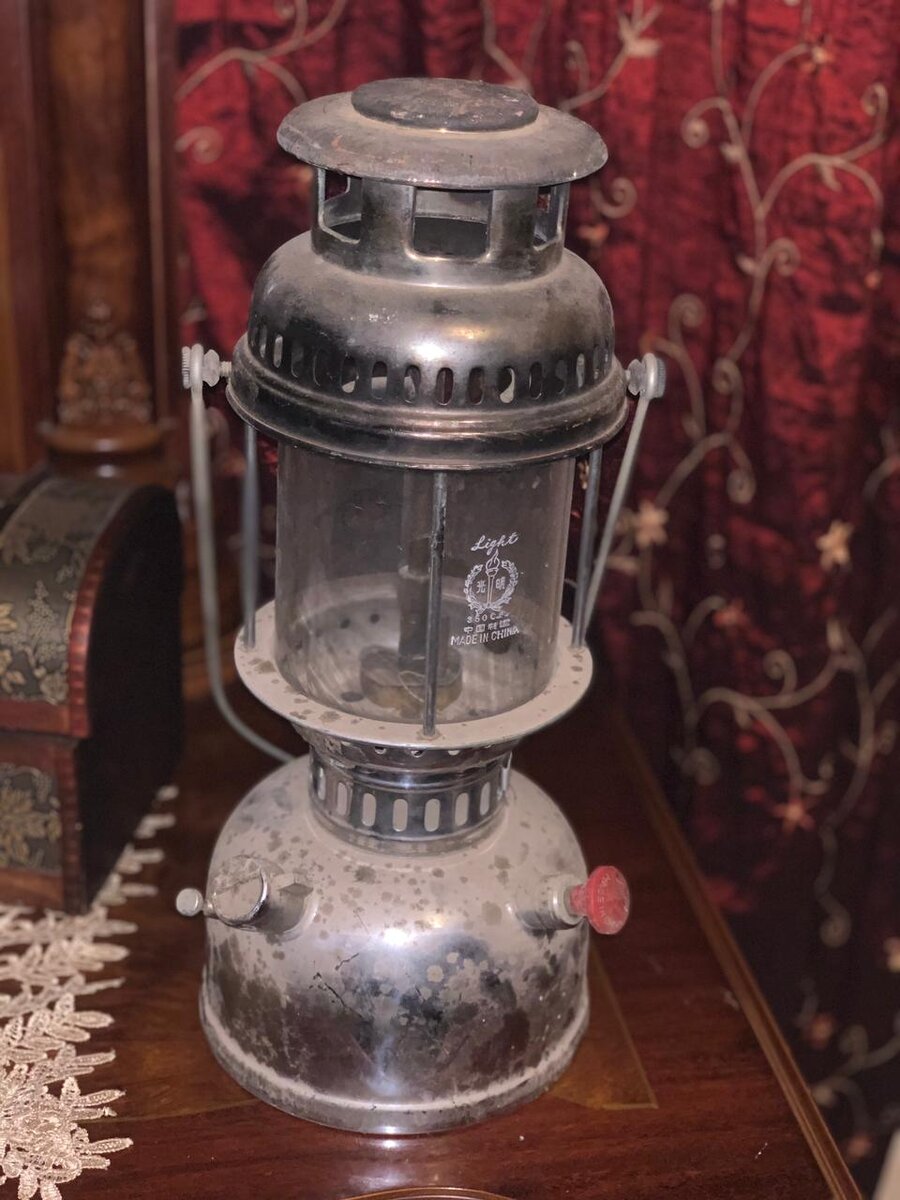

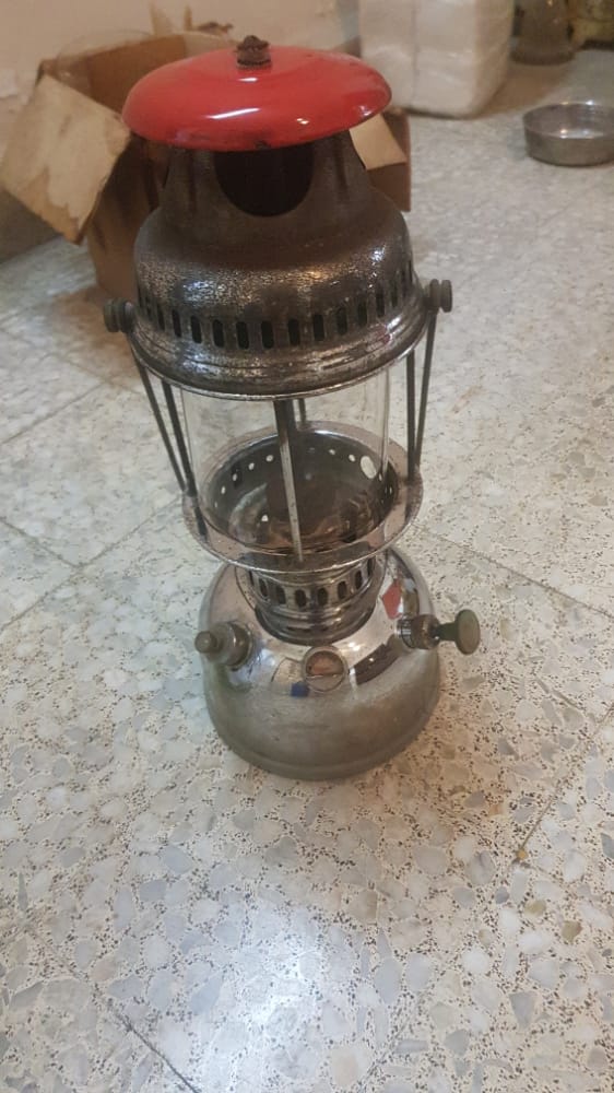

    The second third and fourth are petromax lanterns. But I can't see if it is one lantern viewed from more sides or different lanterns.
    Because like said the one with the golden globe upside down, is a Petromax like the name plate says ! But on the third picture I miss the golden globe glass mark and it looks like the glass is darker with soot.

  20. Henry Plews
    2,023

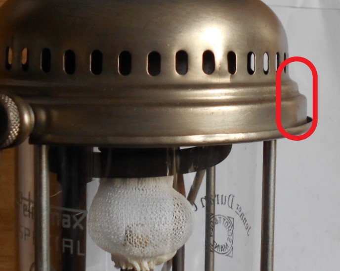

    NO ! Sorry but I have to disagree. Look again at the profile, this image is of a genuine Petromax hood, note the steps.
    This shape is typical of Chinese and Indian copies
    The lanterns in images 2 and 4 are definitely Petromax and image 3 is most probably also Petromax.
    I believe the correct top for the Petromax is on the lantern shown in the original post but it has lost its original cowl and one from a smaller (250 cp ?) lantern has been fixed on with two bolts.
    Original Petromax, note the rounded corners. Chinese copies have square corners.

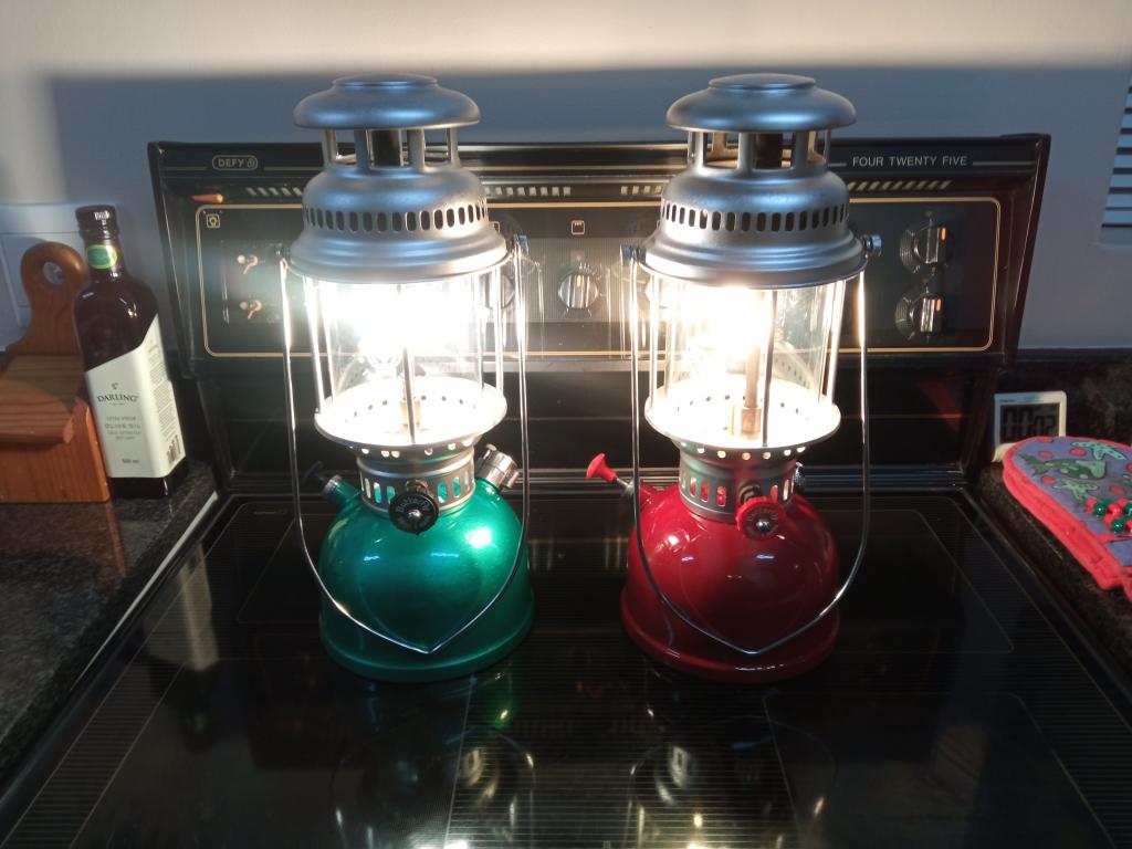

    2,013
    @WimVe , If you are a collector but not really a user, that would be correct. But from a purely practical point of view, all those lanterns, if they are complete, can be made to work and provide light which is what they were intended for. I'm probably not the only one on this forum that derives great satisfaction from fettling, refurbishing, repainting and using common non-collectible lamps.
    As an example, I got the below two Butterfly lanterns in a job lot. They were probably lit only once and then stood for years in a garage at the seaside. They were totally brown with surface rust through the cheap chrome plating. After ignoring them in my shed for a few years I de-rusted them and gave them a decent coat of paint. They are no longer original but they are bright, reliable workhorse lanterns that can give many years of valuable service, and much pleasure to the user. 1628098876051.jpg
