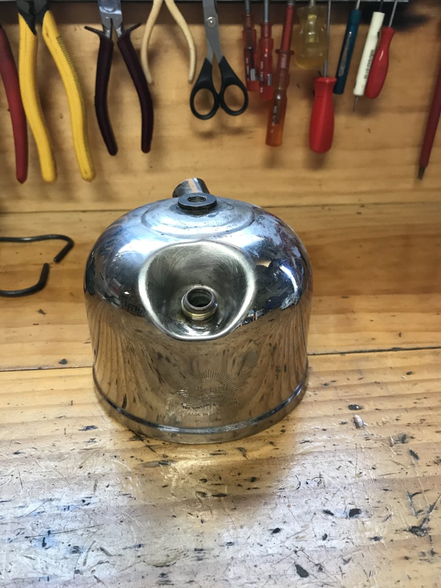

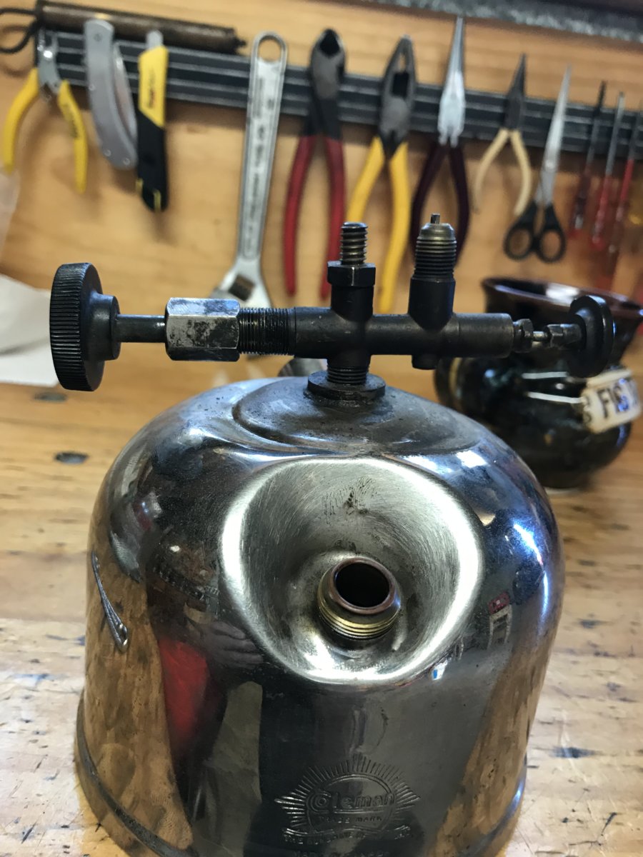

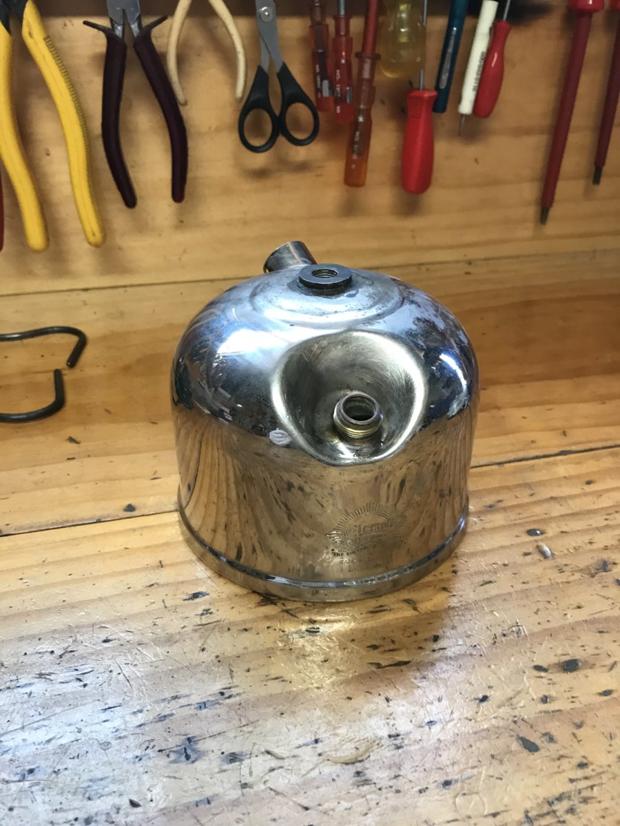

    At present I’m fettling a Coleman 242K lantern. Unfortunately, in this lamp’s case, it has had the fount pushed in at the top. This is an all too common a malady.
    The following pictures tell the story .......
    The pushed in fount’s top
    I used the freezing method to rectify the damaged fount. This time with pictures to be able to share the method with you all.

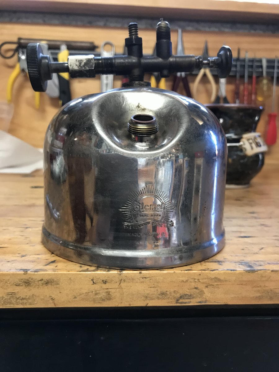

    The following is the result of the freezing method .....
    Result
    The pictures speak for themselves. The dent was successfully removed.
