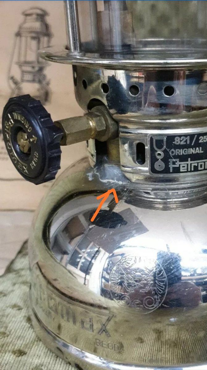

    Hi there,
    I found leaking point on fount of petromax. Someone welded by lead but not perfect.
    Pls help to advise how to take out screw and repair, i don't want to weld outside this point.
    Note: pls look picture on the arrow highlight. Leak under screw.
    Regards,

    @X246A hi x246A,
    We have 2 things.
    - between fount and vaporiser have one lead washer No.90 (spare part list). It is easy to take out and replace new one. I have many lamp and i did many time.
    - under lead washer, fount have one screw (or nut) where install (or connect) vaporiser to fount. It is permenant and could not take out easilly. Problem is this screw, kerosene leaked under screw, not leak at lead washer. I mean vaporiser and lead washer is fixed and tight.
    I see someone take out this screw and replplace new, but it is not spare part list, it include on fount.
    I want to take out carefully make sure that not damaged to can resuse this component
    Pls advise

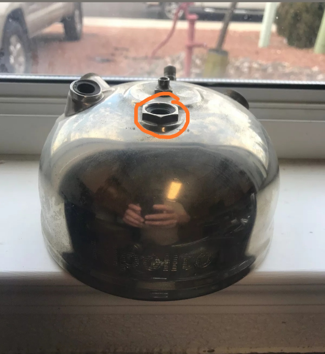

  5. txminhcoke Vietnam
    Sep 20, 2019
    39
    vietnam
    Hi Jeremy,
    I could not take out my lampe, so i attached another fount to look easier
    Hope can fix problem

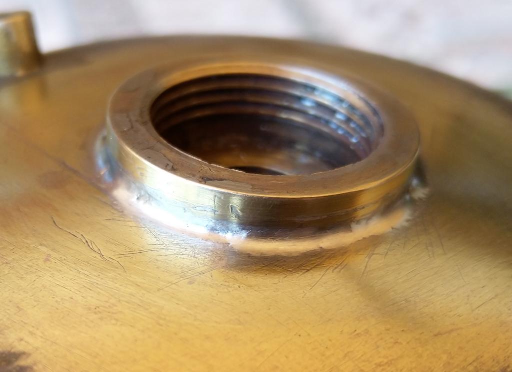

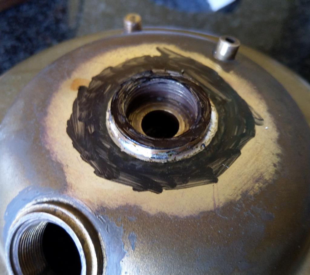

    All this talk of soldering made me want to do some...
    It was a hideous SA Railways repair with a huge dam of solder around the bung.
    Removed the old solder, carefully scoured away the solder wetting off the brass, masked it and resoldered with minimum solder, an electronic iron and a small gas flame.
