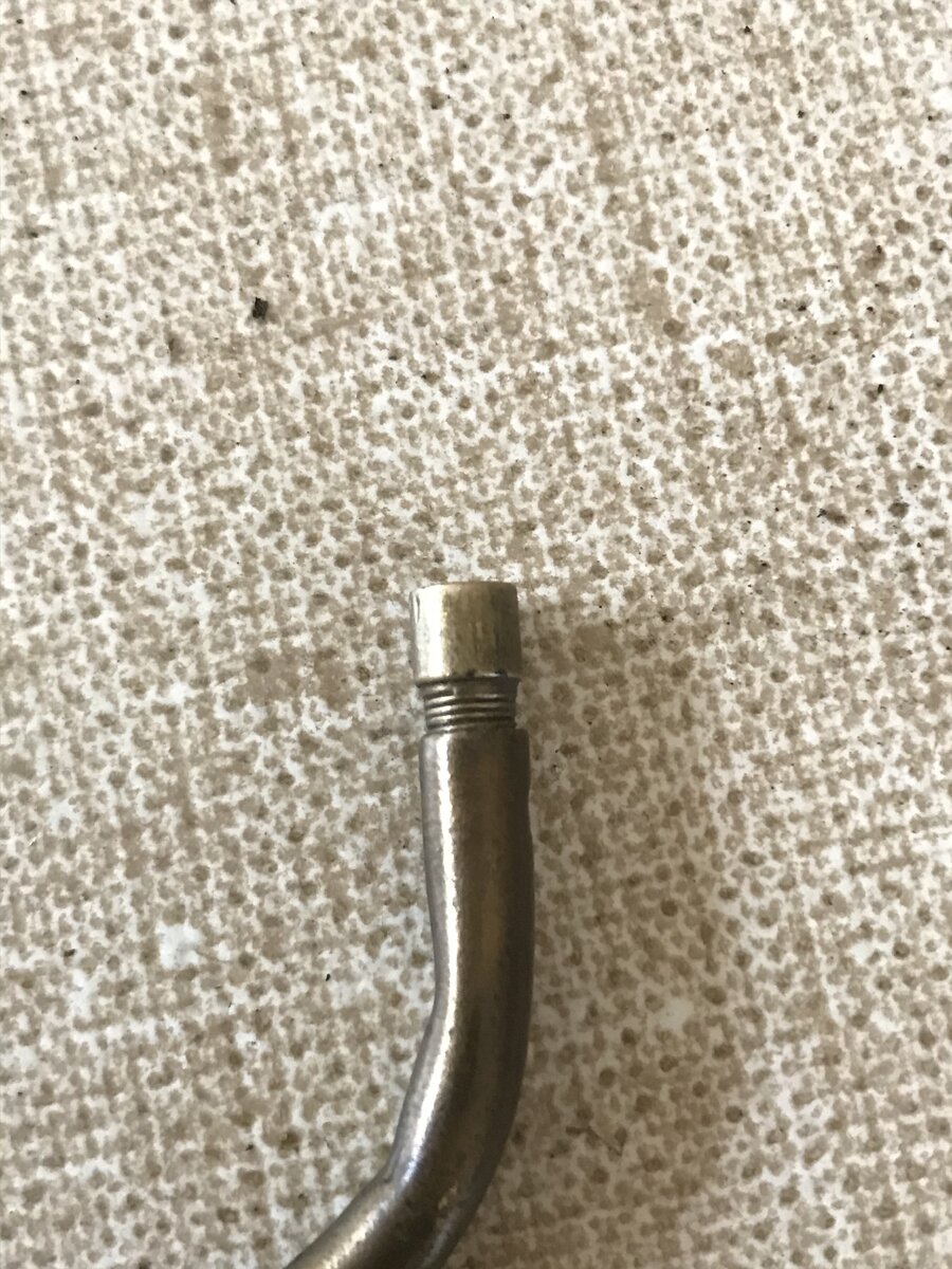

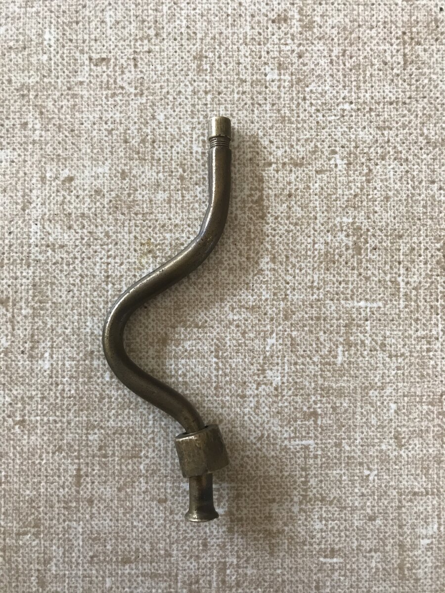

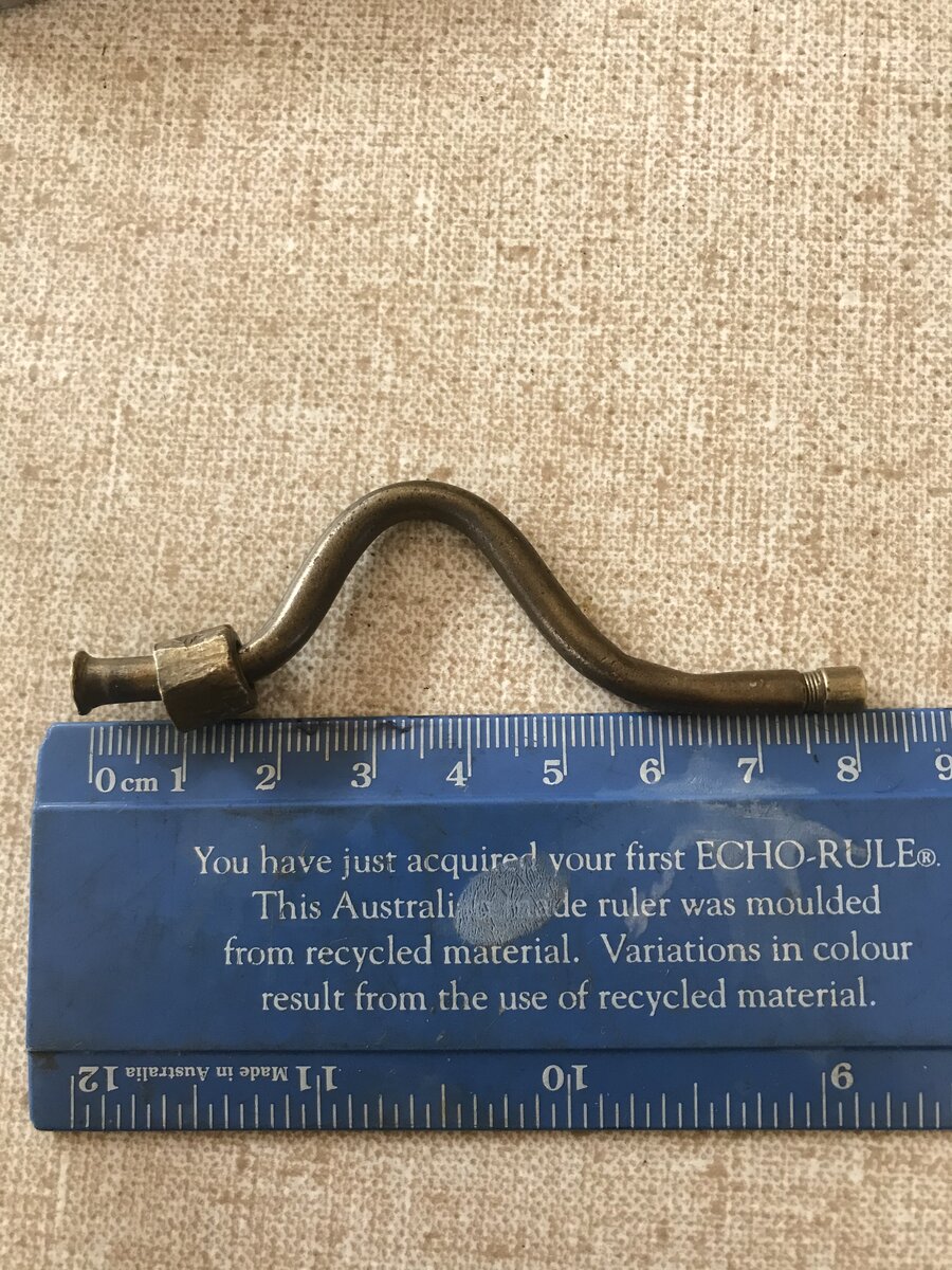

    Can anyone identify this generator. It’s only 8cm or 3 3/16” in height.

    Any chance that it may be homemade?
  5. Mackburner
    6,802
    Could it be a Coleman Q77 bent and shortened to fit an Enterprise? ::Neil::

    Gas tip doesn’t look Colemanish to me
  7. Mackburner
    6,802

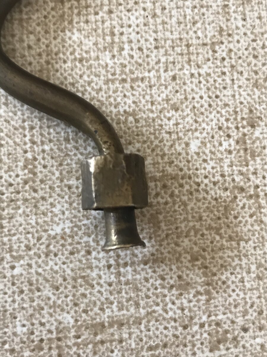

    No it doesn't I agree but AGM also made the same type as their L35. Some of the bends look to have sharp indents which suggest maybe a fettle done with a straight gen held in a vice? It was just a thought as just about any straight 1/8" brass gen tube could be fitted with the fitter nut from the intended lamp. ::Neil.

    The Evening Star
  9. Mackburner
    6,802
    Wrong fitter type. ES and Kildark have male threaded ends in the same style as an Akron. ::Neil::

    Neil may be correct. The generator came with a loose assortment of parts, some of which were Enterprise-made parts. It could be that this generator was made or modified to fit an Enterprise burner.
    I shall see later in the week whether it actually does fit the burner.
