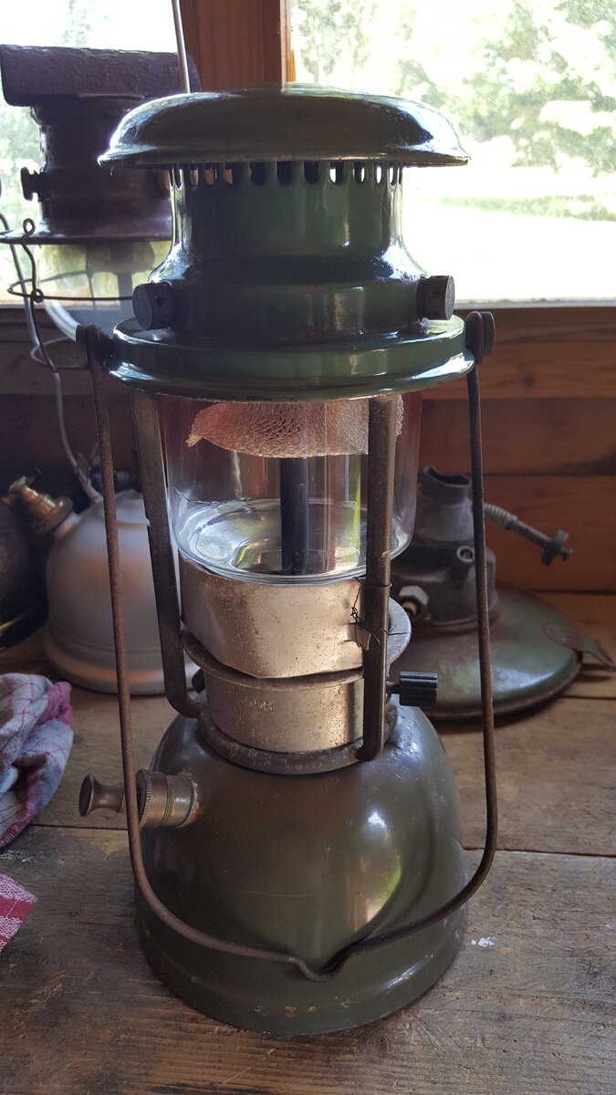

    Bugger
    Maybe I will use a dremel tool to grind off some of the aluminium so the globe will slide down all the way. Not sure yet.

  6. Pancholoco1911 United States
    Nov 26, 2019
    95
    I think we got the same lantern and the globe I have in mine right now is marked Bialaddin V60 and fits very tight.

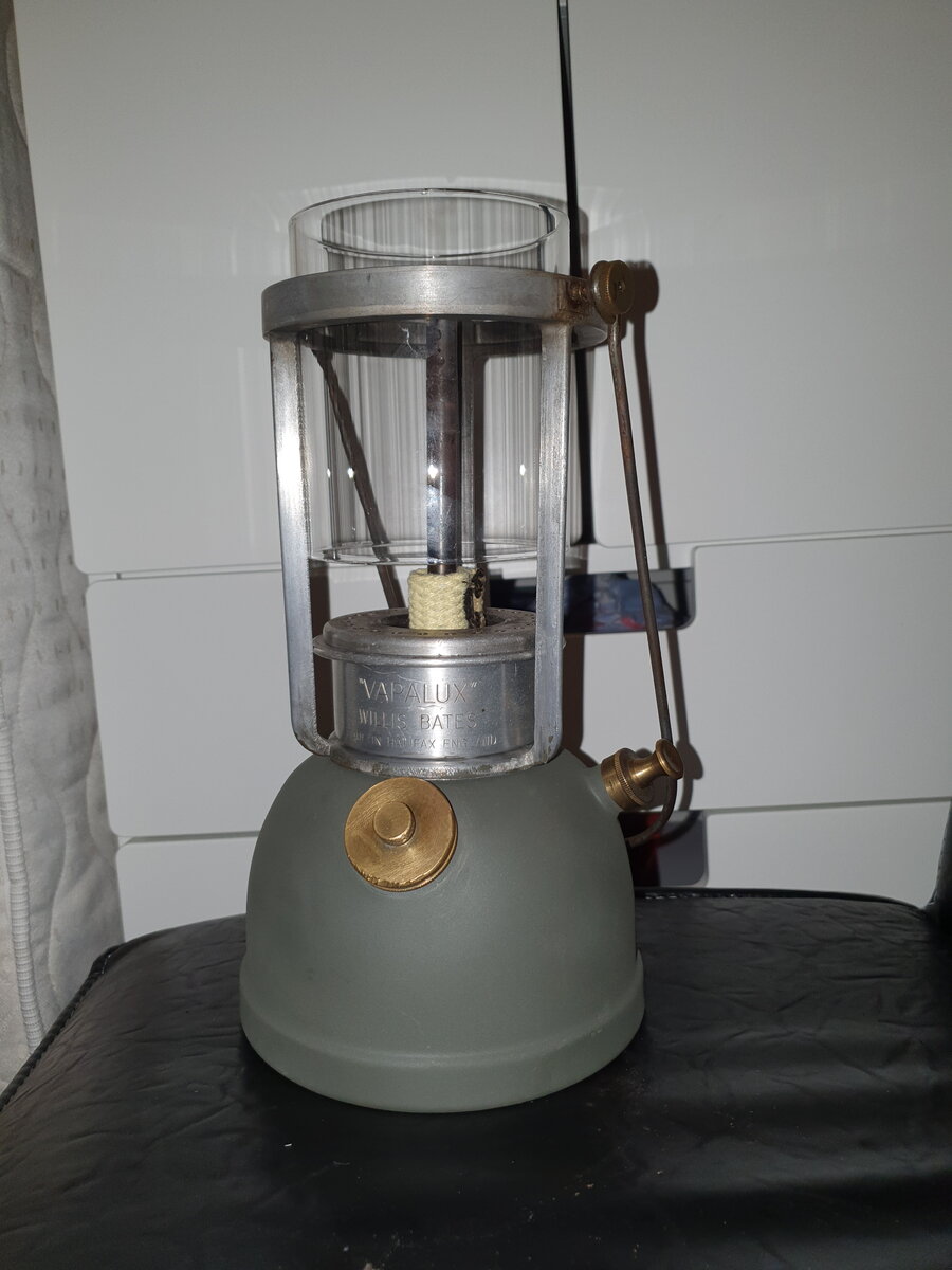

  8. Alex Smith
    Jun 18, 2019
    637
    Midlands, UK
    @Emiel I've had a similar problem, with UK Military frames (300/M1). A glass I thought would fit, didn't it was too tight on the fame. I ended up ordering a "Vapalux" glass, which fitted fine.

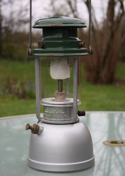

  11. James K
    James K Subscriber
    Nov 10, 2017
    240
    I have just fettled an m1, and it has a short glass, although it is unbranded and unlikely to be the original.

  13. Alex Smith
    Jun 18, 2019
    637
    Midlands, UK
    @James K Not sure your glass is correct for a M1. Here is mine as a comparison, they have a long glass:

  14. James K
    James K Subscriber
    Nov 10, 2017
    240
    @Alex Smith
    I think you are right, after looking through the reference library they all have a long glass, and a pre heater dish.
    I shall enjoy mine as is for now, i was lucky enough to have been given it.
  15. X246A
    1,081
    Norfolk, England
    @James K
    Looks like an innovative home fix to make a lantern work with the parts available at the time. A nice find and gift to receive.
