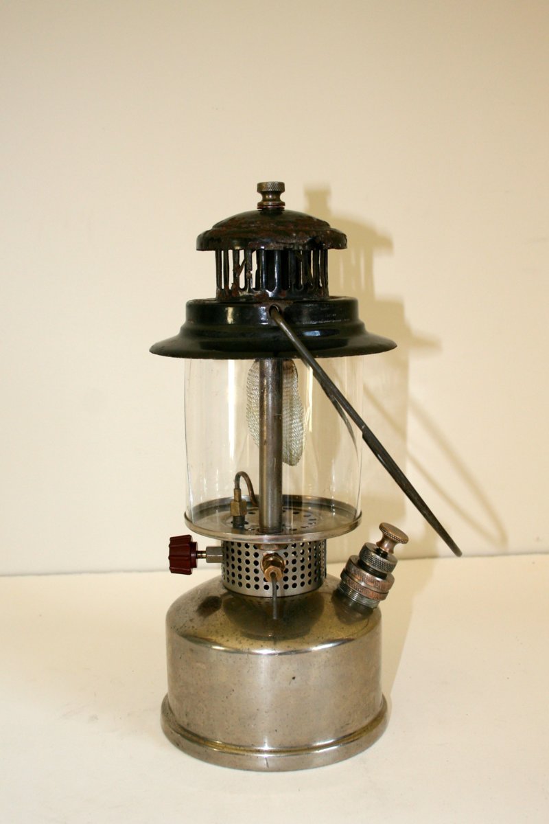

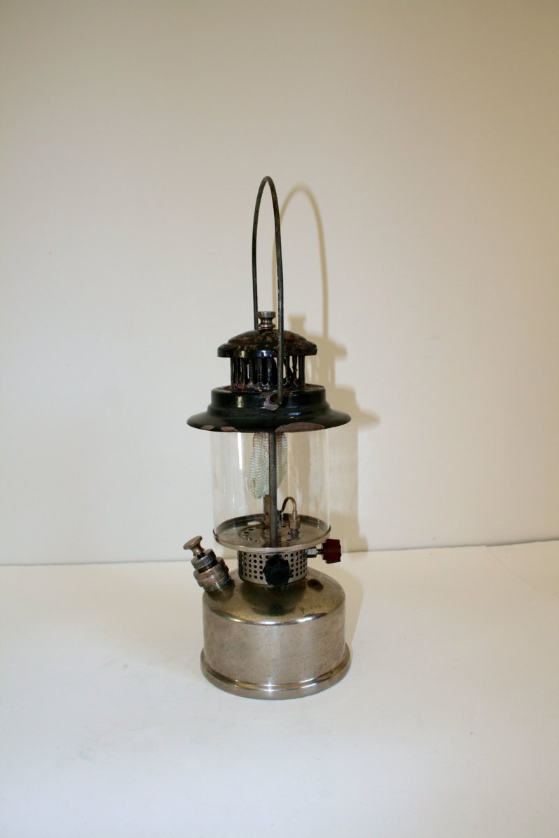

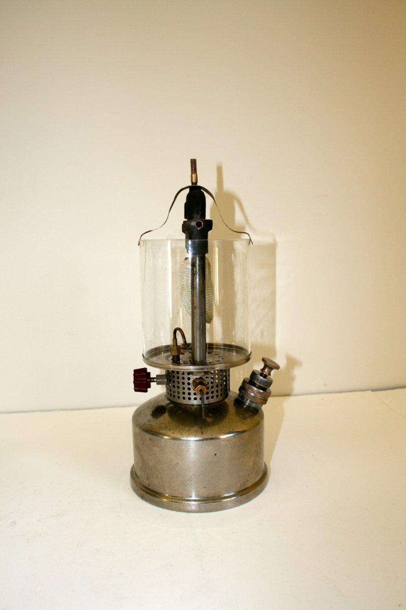

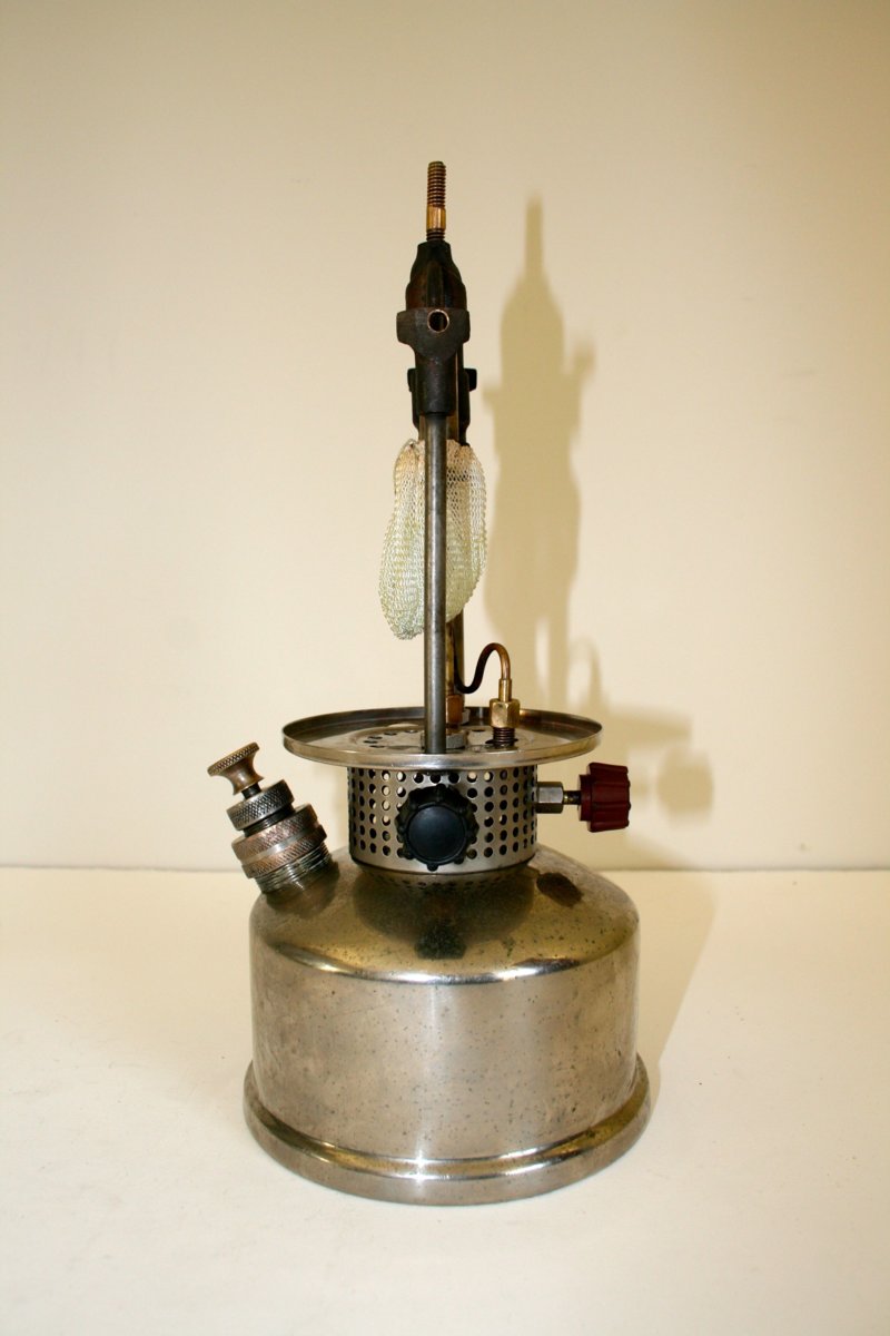

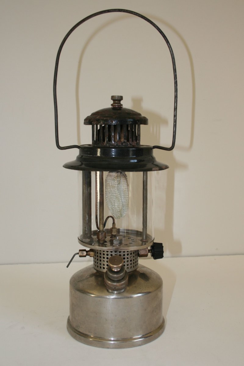

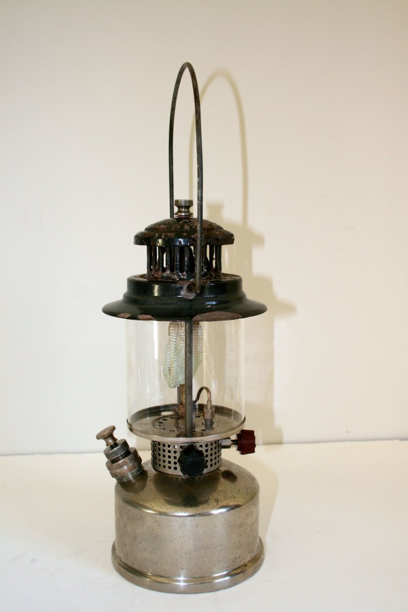

    Here is my Gloria 379. From Australian advertising material this lantern was produced around 1937/38. It is likely the last style of lantern made by Gloria in Australia. It does not have any markers name, but I have seen @Lamp_Doctor's lantern which is identical and carries a Gloria name badge.
    This lantern uses the same fuel and burner system as the Gloria Table Lamp shown here.

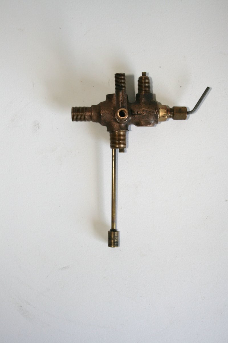

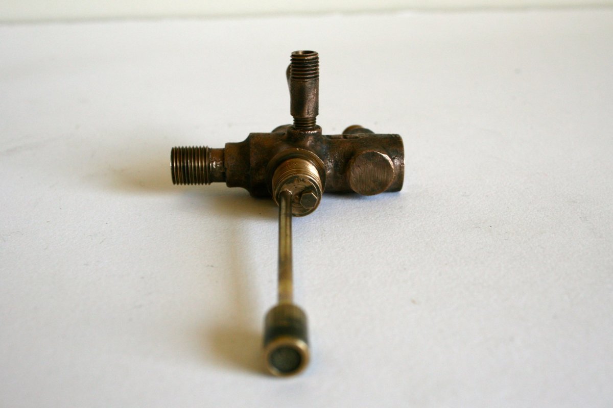

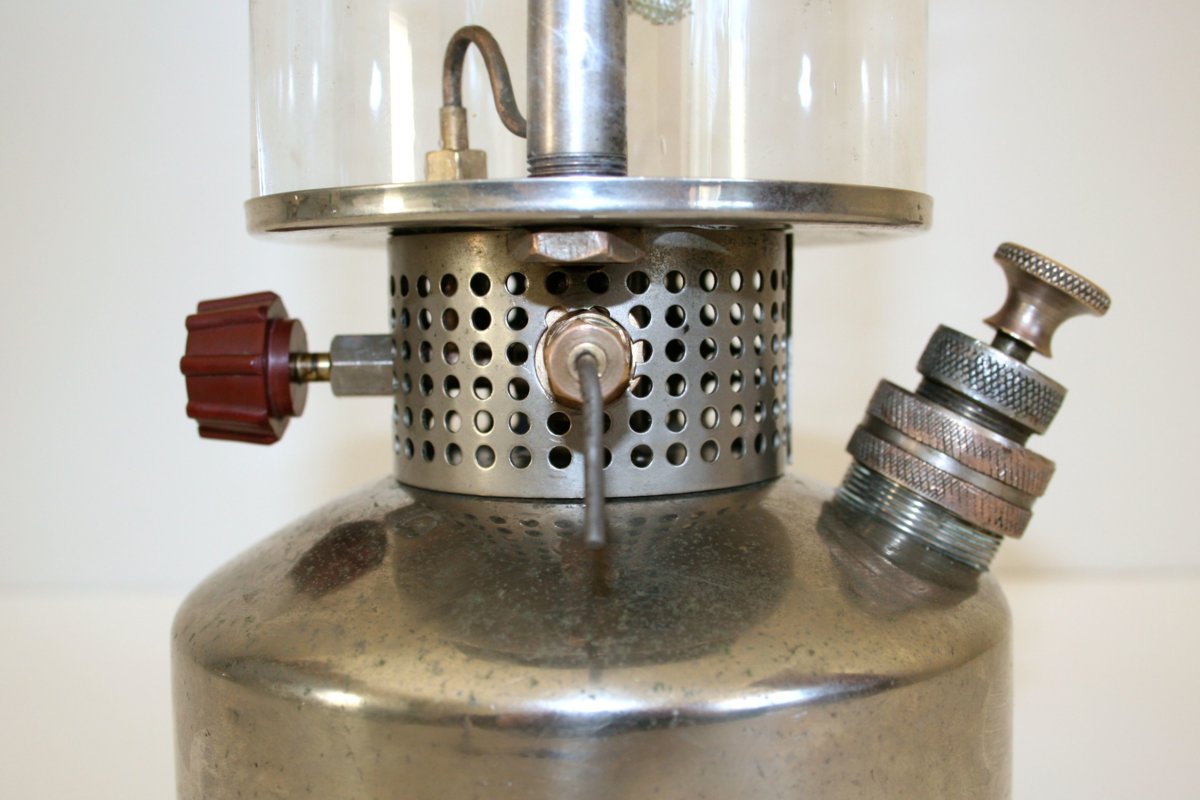

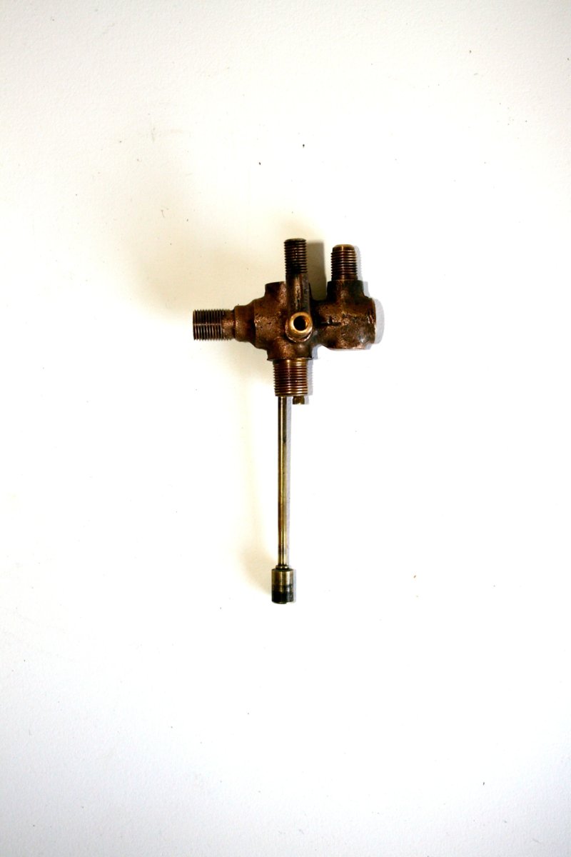

    The fuel pickup and control block:
    Note the little nipple under the fuel control block. It is the allows the pre-heater to function.

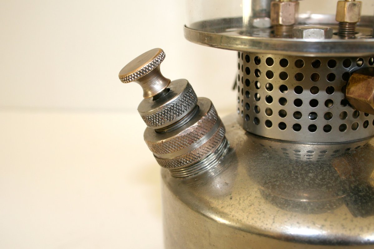

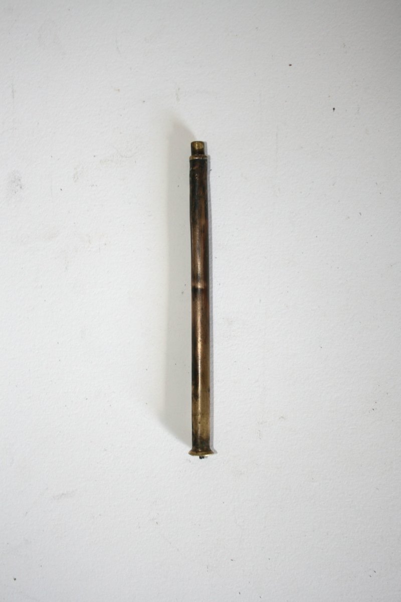

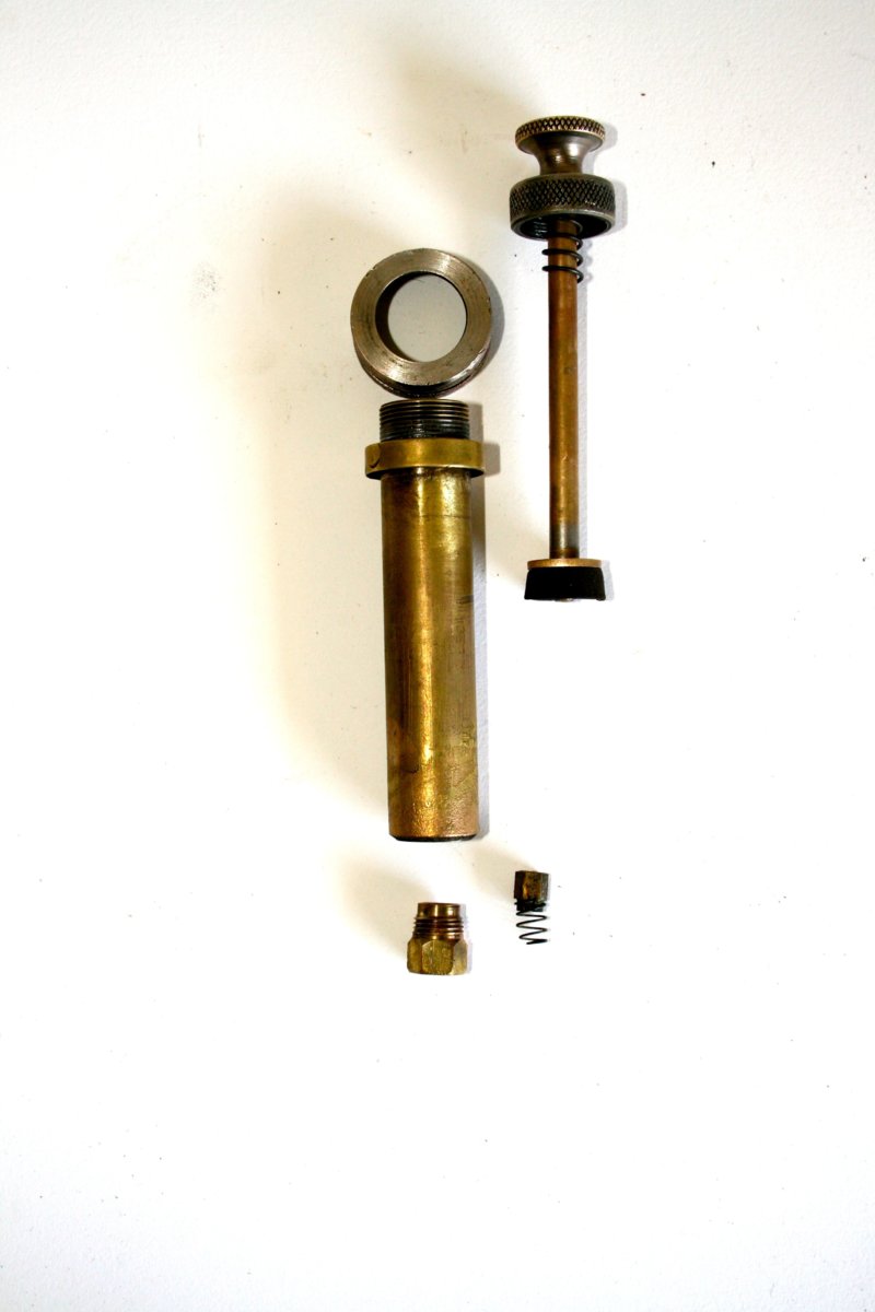

    The pump is shorter than on the Table Lamp, but the same design.

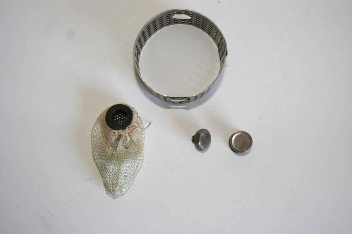

    I left the original mantle on (it shattered after lighting, unfortunately).

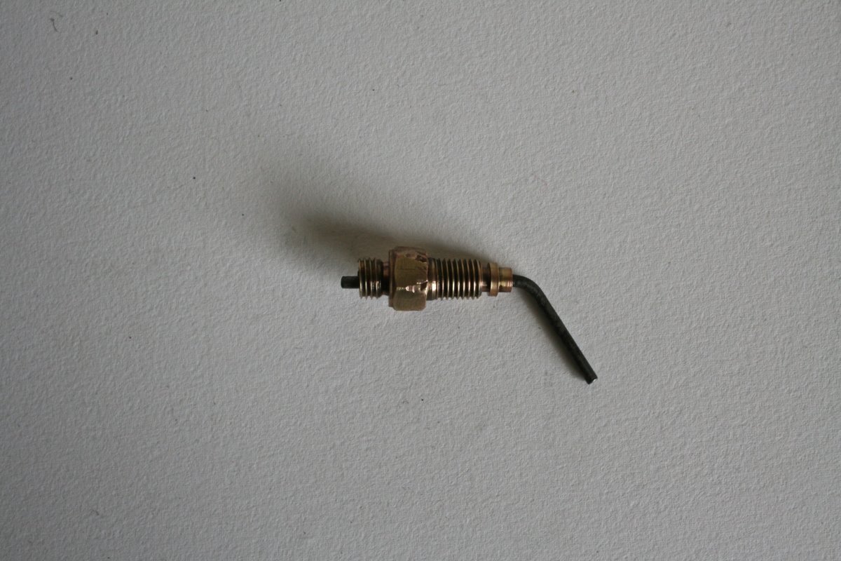

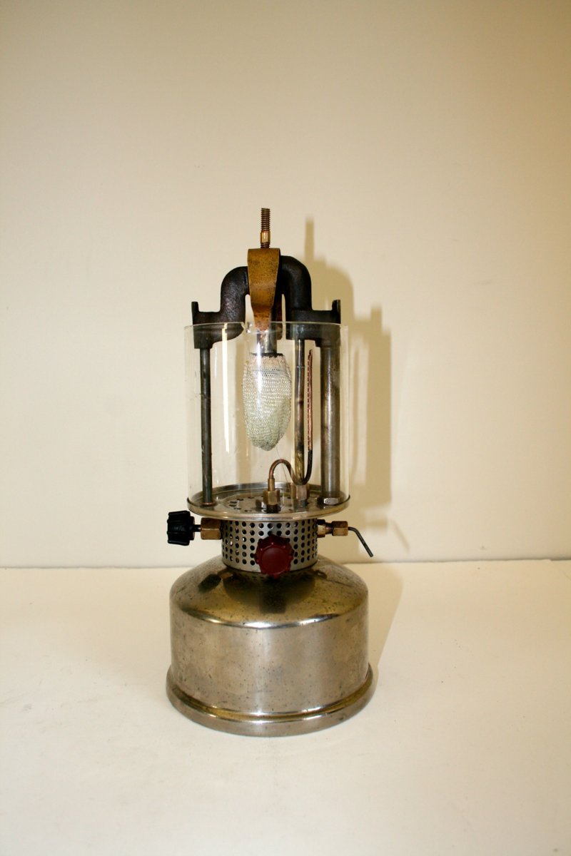

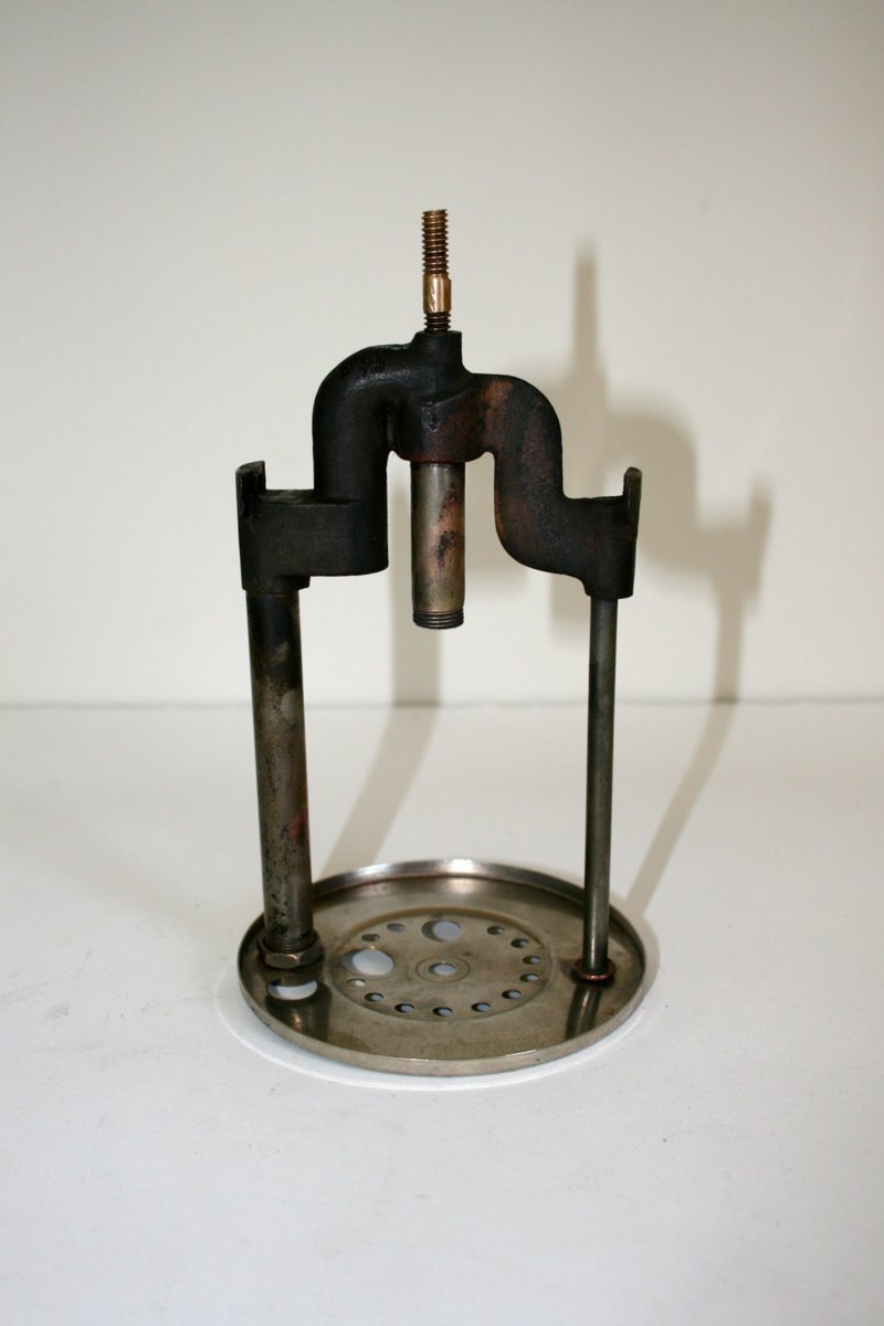

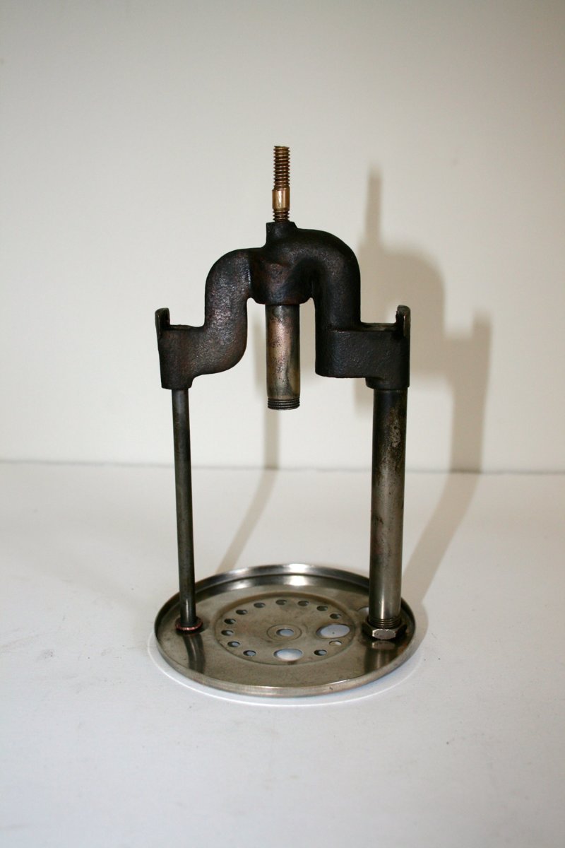

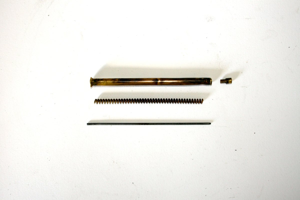

    The vapouriser (generator) was fairly beaten up, and the pricker missing. The spring is brass:
    The preheater etc:

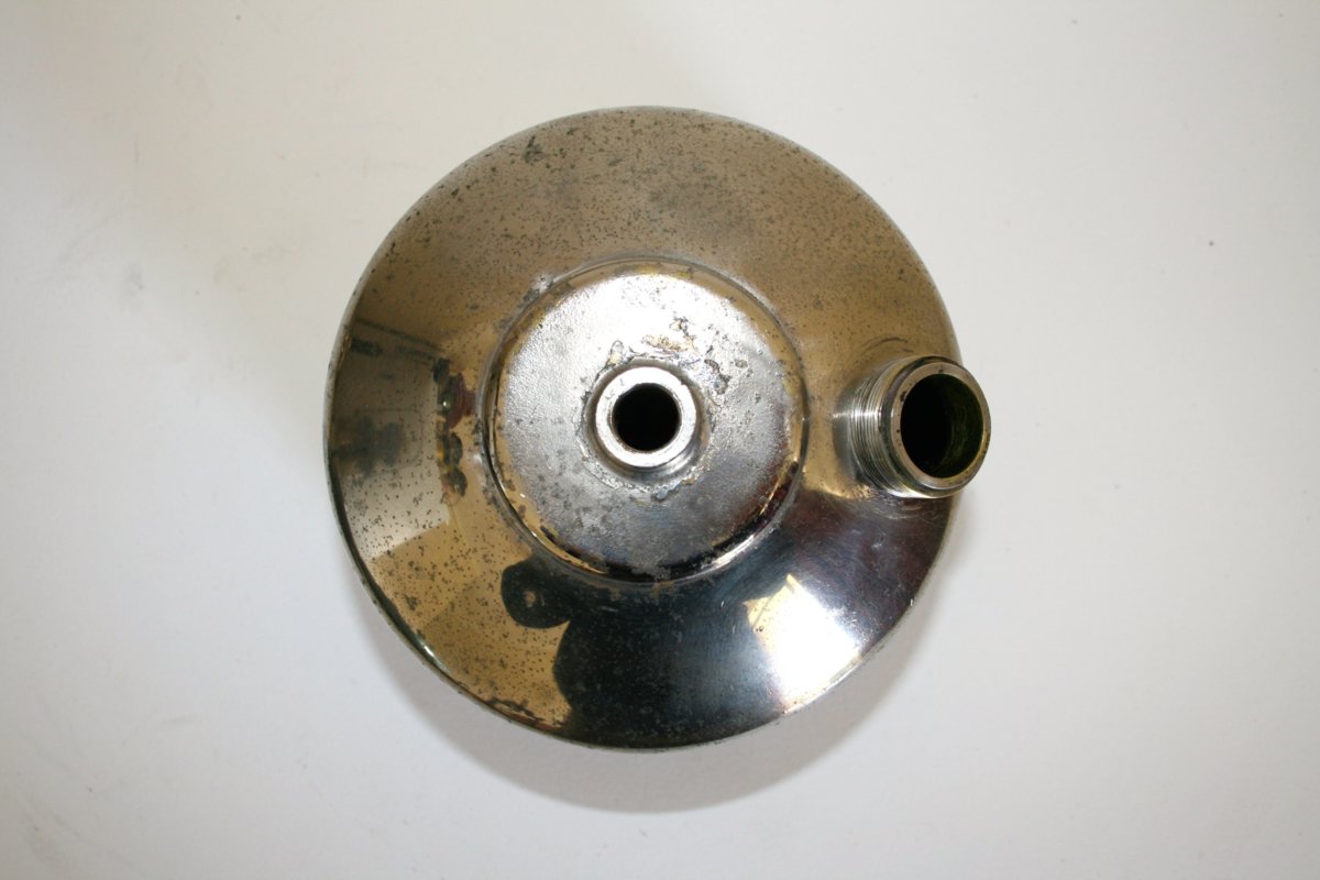

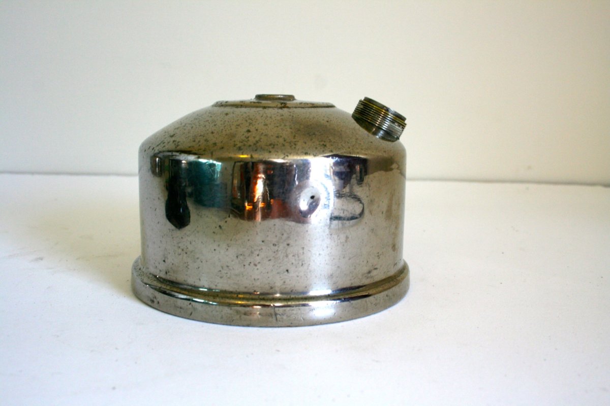

    All brass tank, nickel plated:
    The bottom of the tank appears to have been tinned or coated with solder.

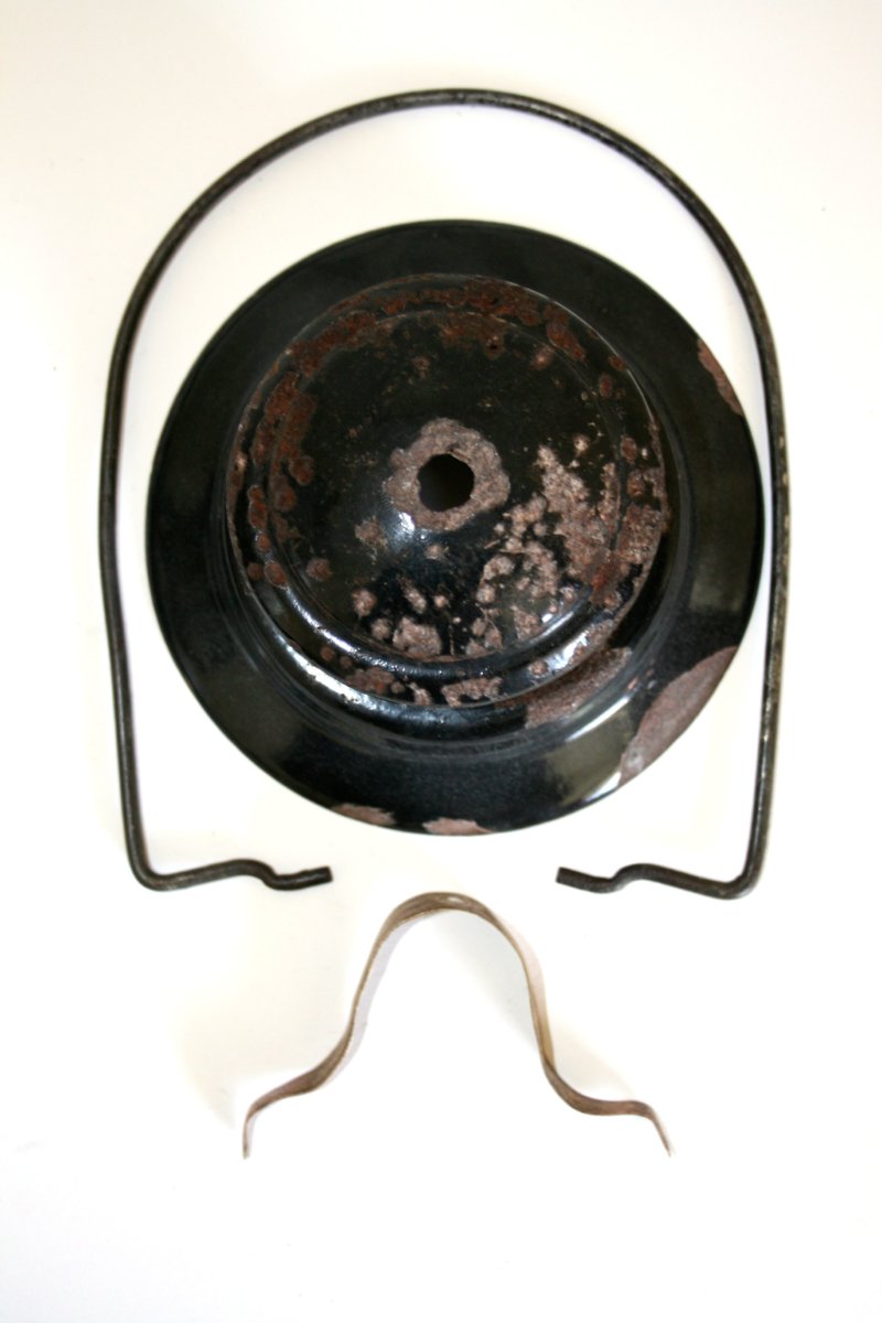

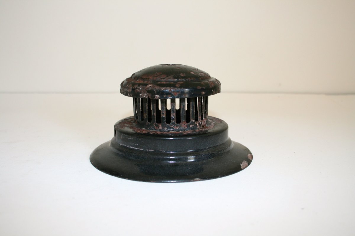

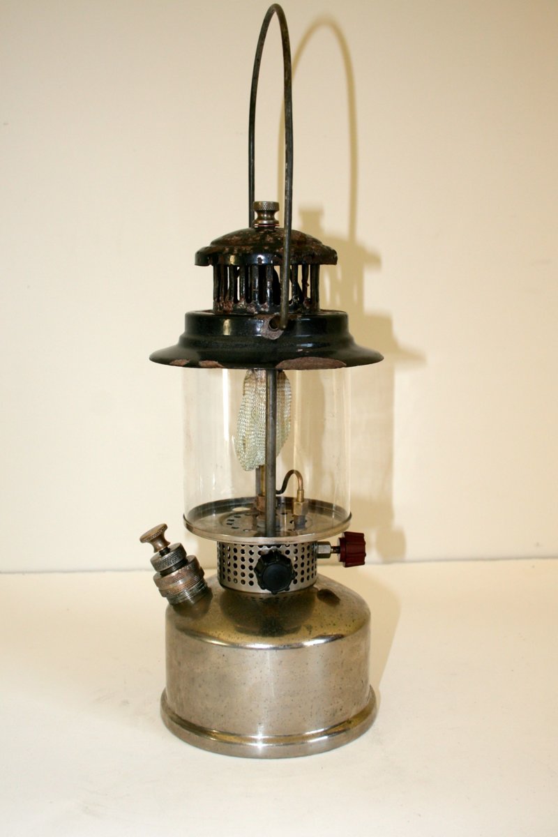

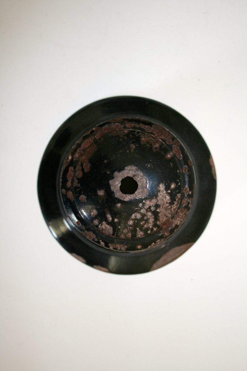

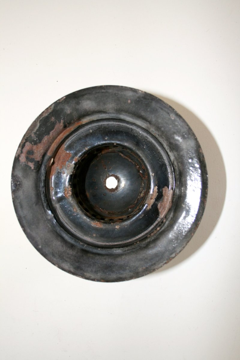

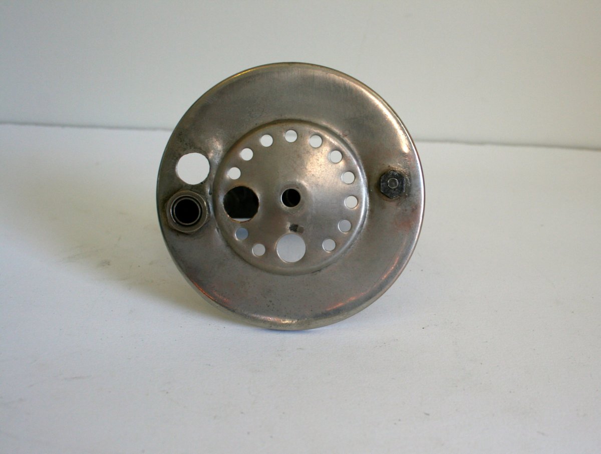

    The hood (vent) was pretty rusty.
    Note the brass clip for the glass.

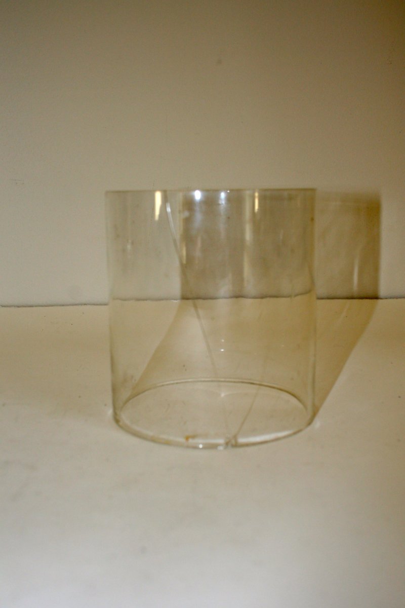

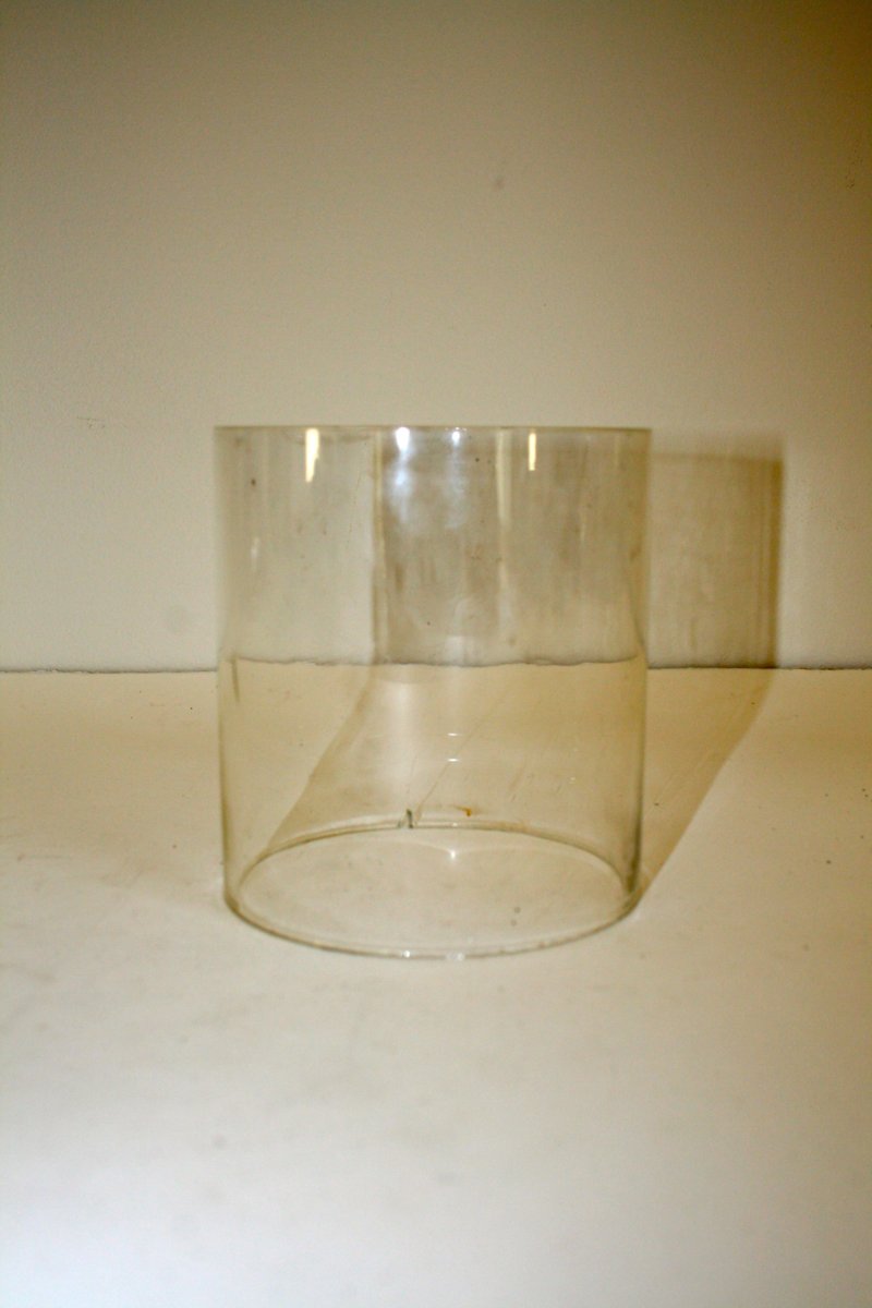

    The glass was cracked.

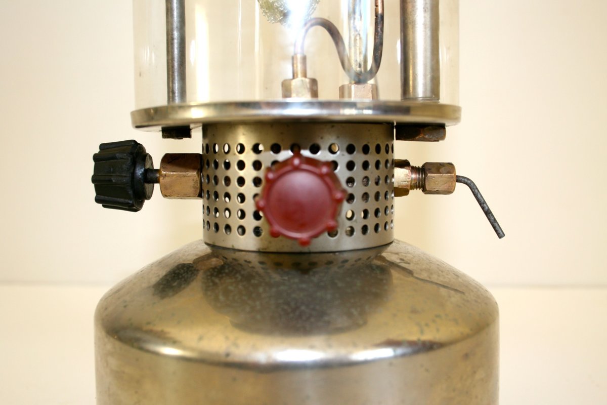

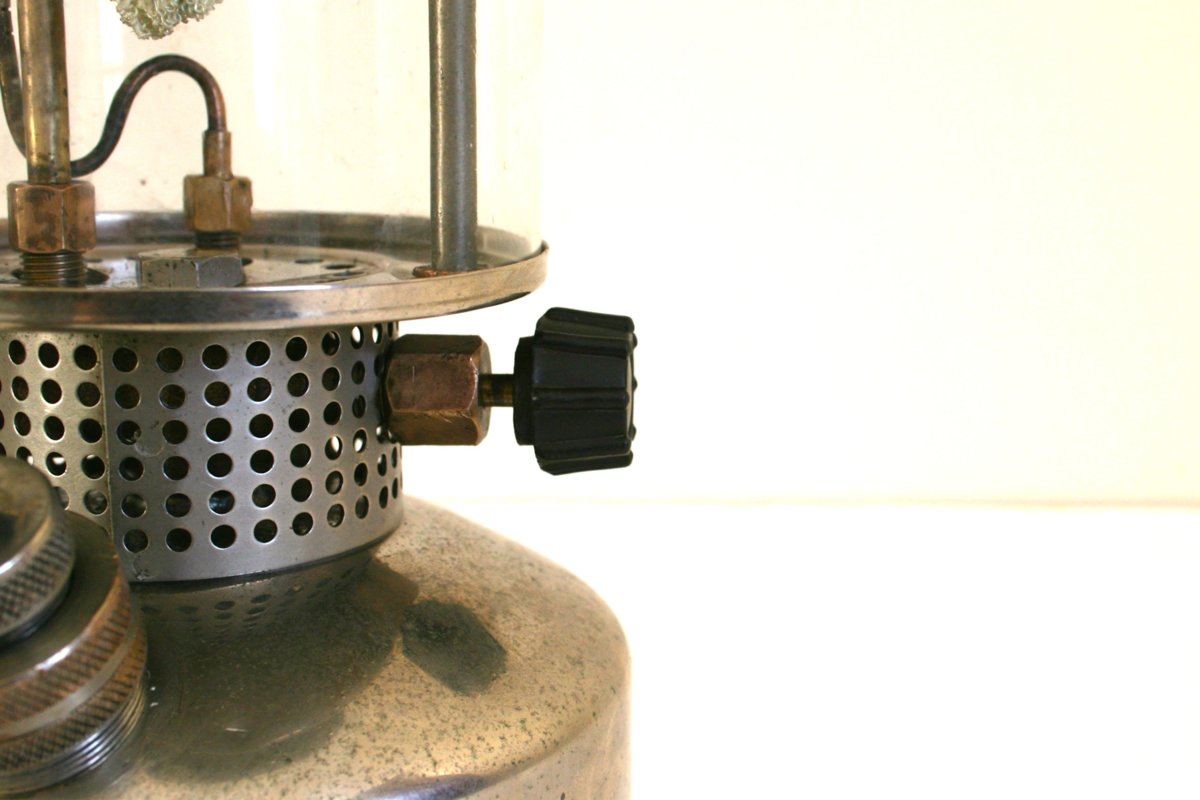

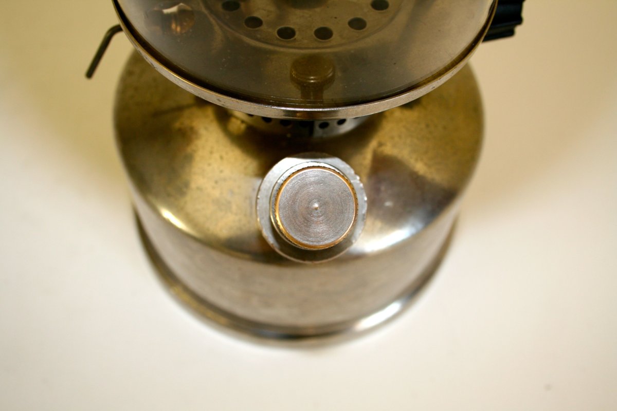

    The red knob controls the pre-heater.
    The black knob controls the fuel flow to the vapouriser.
    The brass clip for the glass.

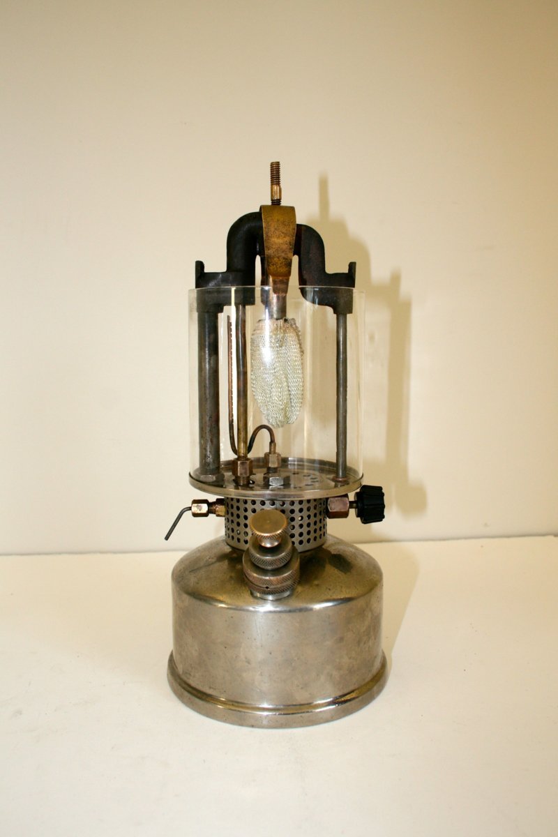

    Up and running.
    For some reason some of my photos have doubled up as thumbnails...
    I'll do some fettling notes later.
    This is a sturdy lantern, and a high quality build.

    @MYN

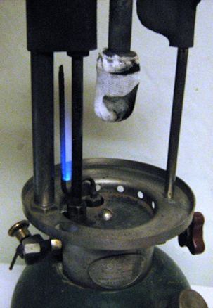

    The red control wheel, from what I gather, releases a tiny jet of gasoline vapour into the perforated brass tube. This is lit and it heats the generator. It is closed off manually when the lantern is lit.
    See the tiny jet in the photo of the fuel control block (above).
    Edit: crossed with @Henry Plews
  18. Henry Plews
    3,051
    @MYN With fuel and pressure in the tank, when the red valve is opened, petrol vapour passes through the nipple shown in images 9 to 12 to the pre-heater tube where it exits from the small slits giving pin-points of flame. These are not easy to capture on camera but here's an image of my example.

    The globe size on this lantern is:
    L: ~113mm
    OD: ~103mm
