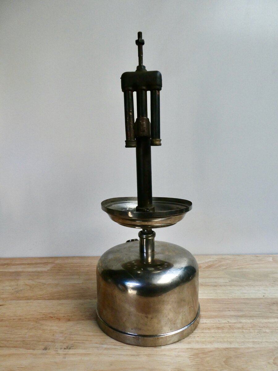

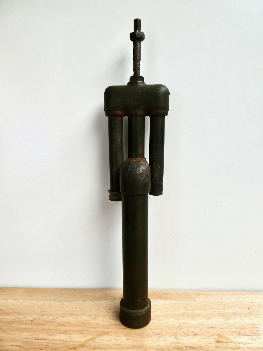

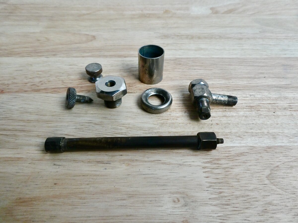

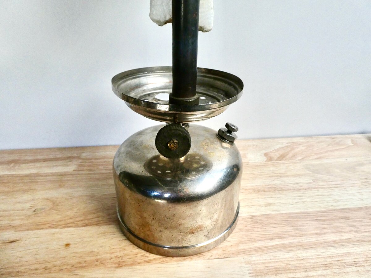

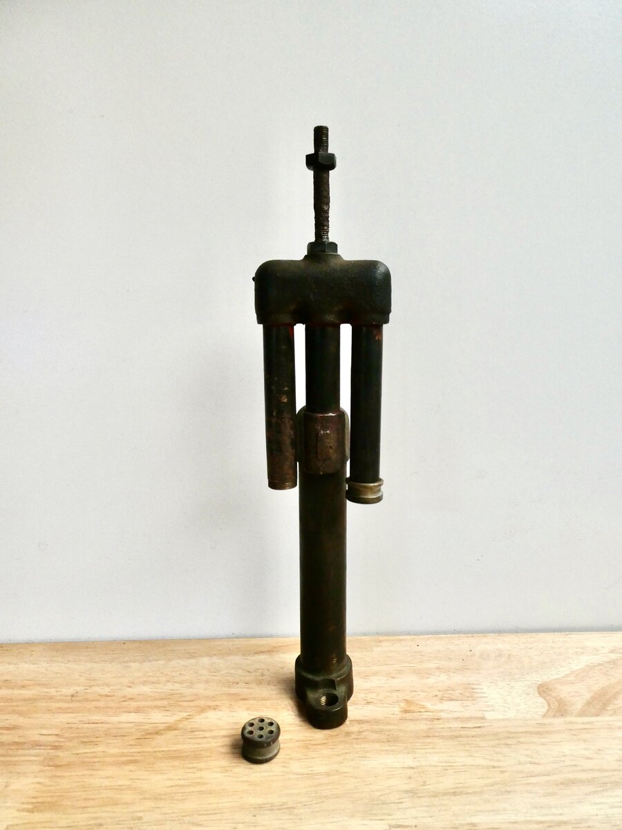

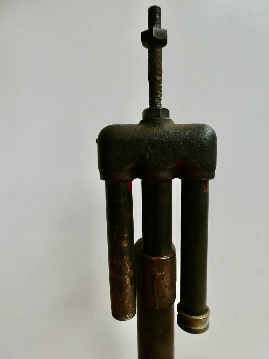

    This is my Gloria No. 12 Hurricane Lantern. It was found in Tasmania.
    Looking through the various advertisements and catalogues, I think this is the third variation of the Gloria No. 12 lantern. @Mackburner now considers this to be Variation C of the Gloria No. 12.
    This lantern appears in a 1916 Gloria (Chicago USA) Catalogue as Oxo-Gas Lantern No. 12 for kerosene or gasoline (see below). The burner on this 1912 lantern appears to have been used on three variations until at least the early 1930s. The advertisements are not very helpful for dating the lantern variations as the illustrations do not necessarily conform to the variations (see below).
    Australian advertising for Gloria hurricane lanterns of this style date from around the mid-1910s through to 1931. A similar lantern with a different burner configuration was made by Gloria in Australia probably in the late 1920s to early 1930s, possibly later (see here).

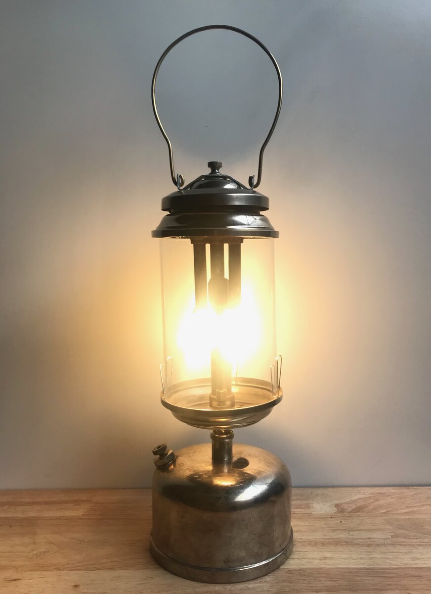

    The lantern is described variously as 300 or 400 cp. It is a very bright lantern.

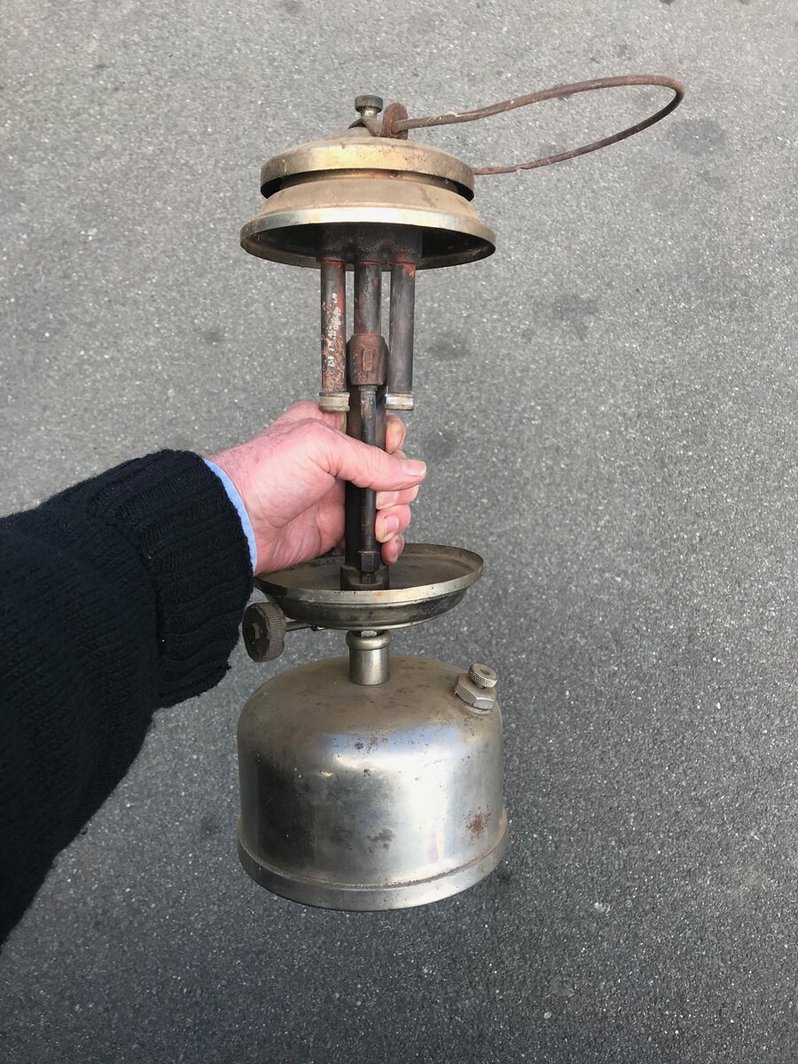

    Up and running

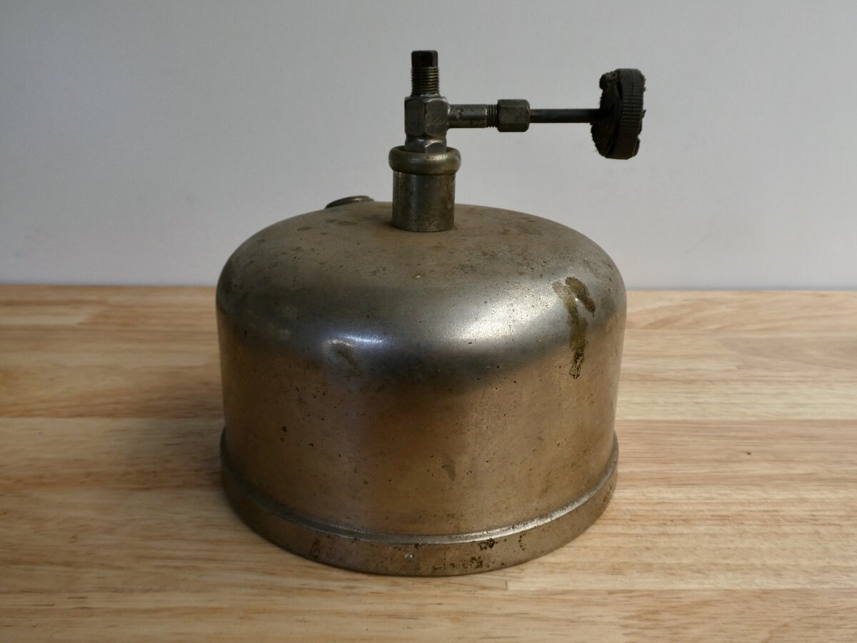

    As is came

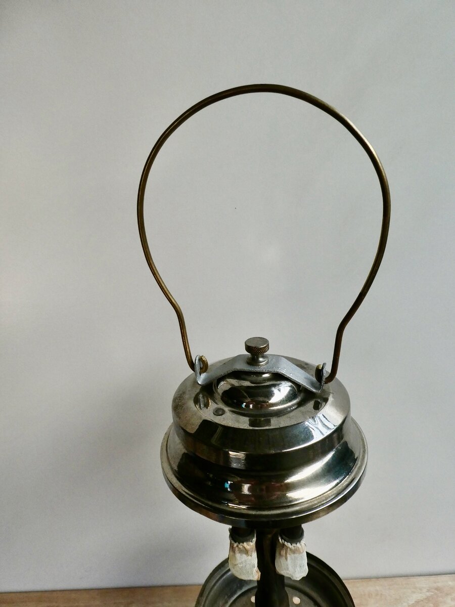

    Some fettling

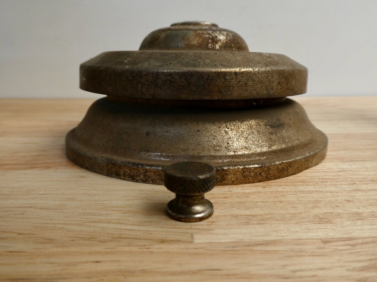

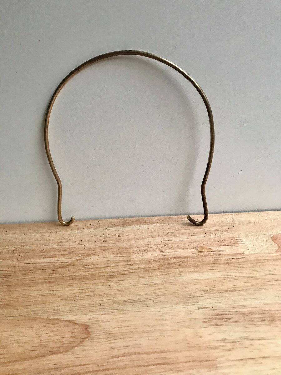

    The steel bail (handle) had been damaged, probably by some cutting device, and with the rust it was easilt broken and unsafe to use as a handle. I made a replacement out of brass rod.
    A wrecked Aladdin 1A tank was the exact circumference of the rounded handle, so I used it to form the brass.
    The finished handle.

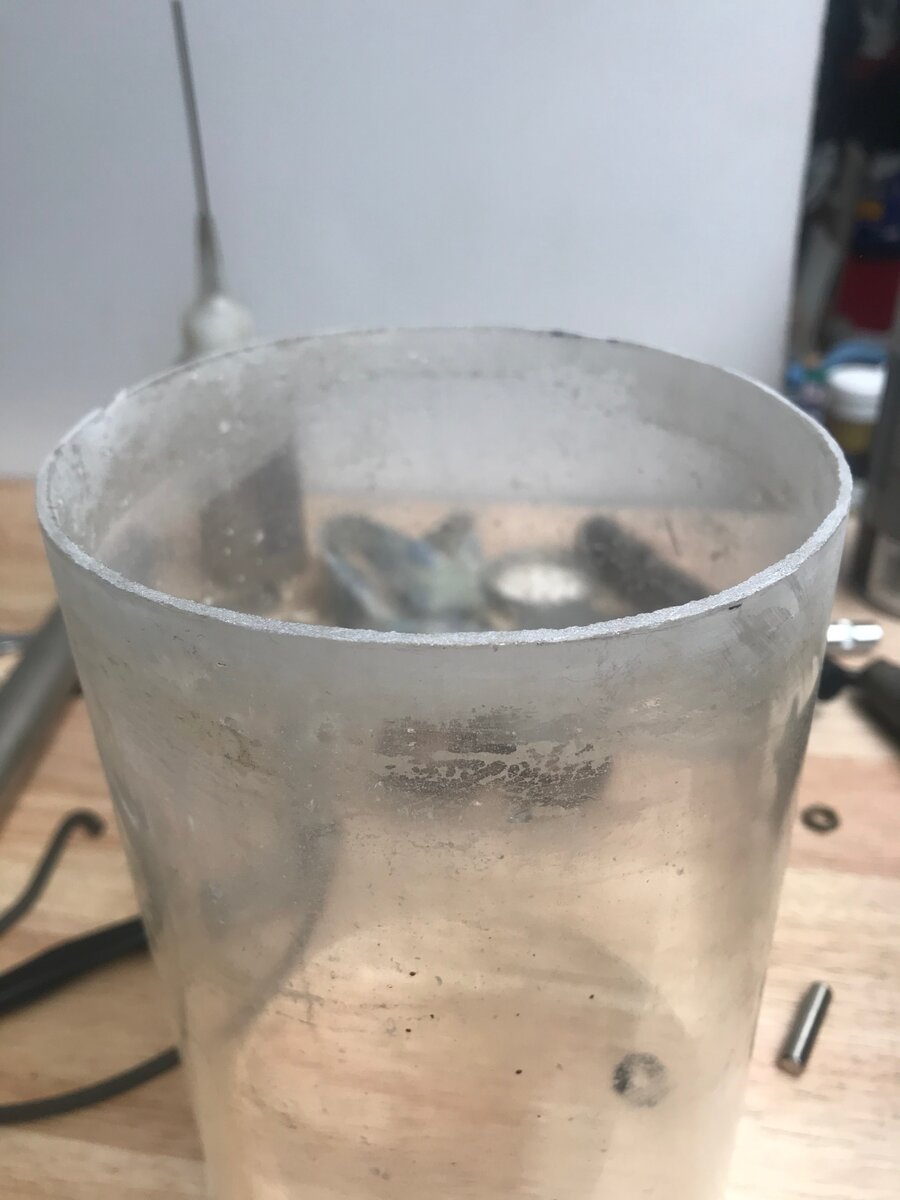

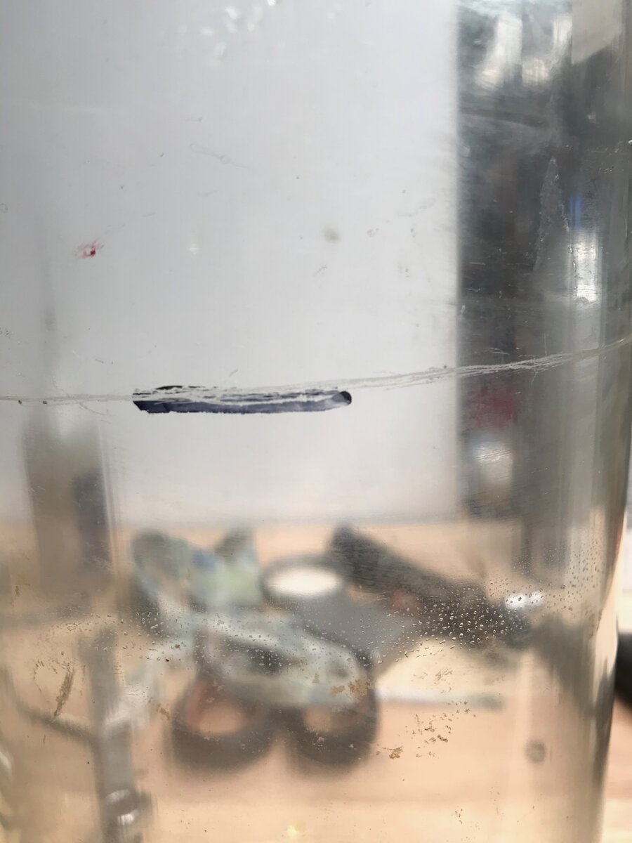

    Temporary glass chimney
    I had a glass cylinder that was somewhat too narrow, but I was able to cut it to length with a Dremel diamond wheel and bodge it into service using bent paperclips.
    The rest of the fettling was simply cleaning, de-rusting and painting the handle holder, and polishing.

    I like this lantern very much and it is very bright! Ive had it running on pure kerosene, and on 40:60 gasoline and kerosene.

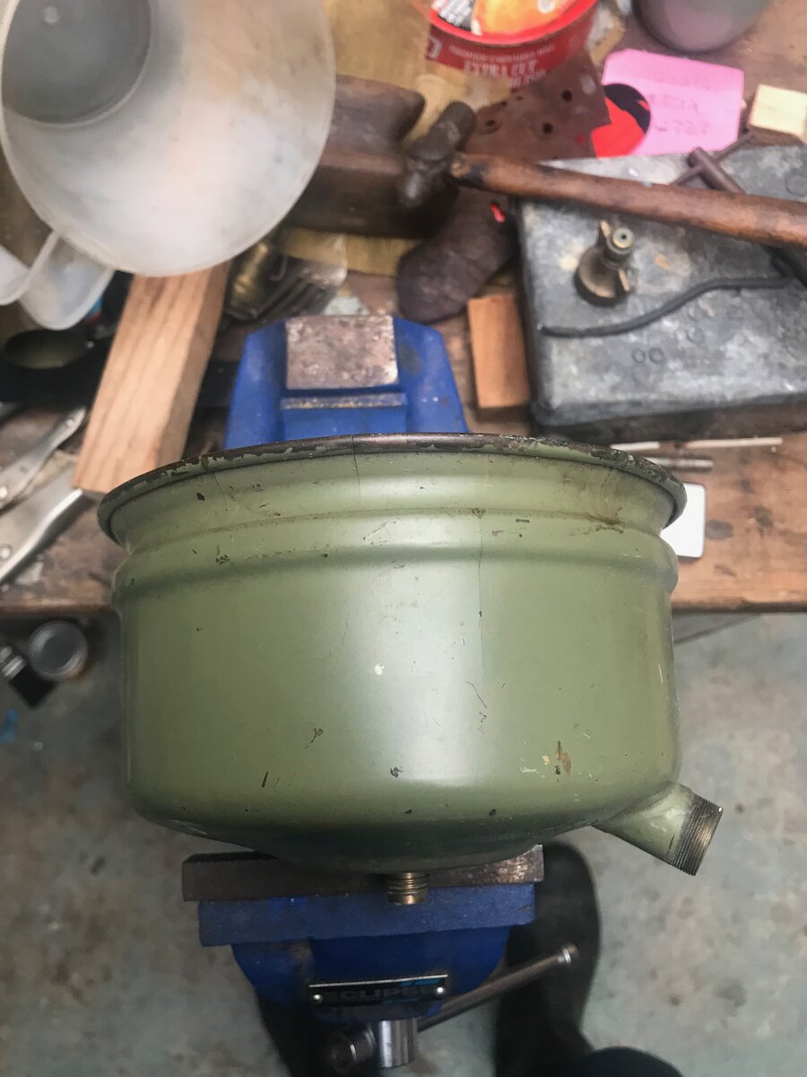

  10. Tony Press
    9,630

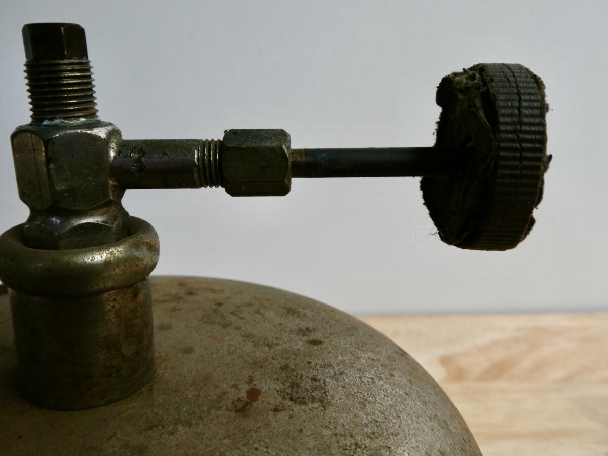

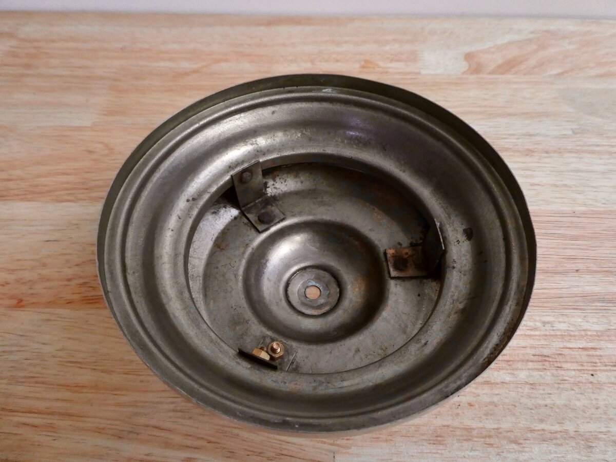

    I note that I did not include a photo of the base of the tank, so here it is.
    I note also that the person from whom I received this lantern told me that he found it at a rubbish tip in Tasmania many years ago.
