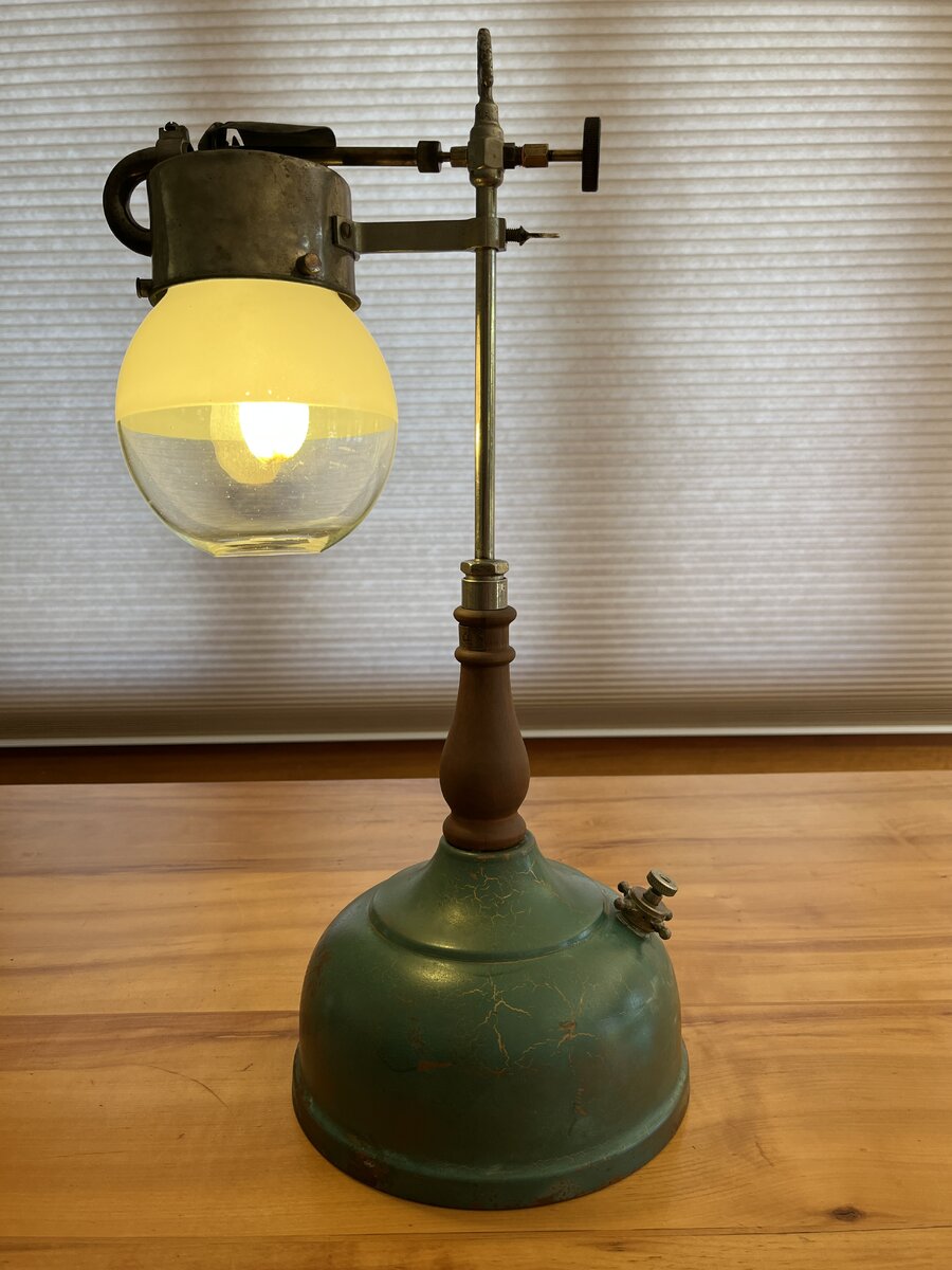

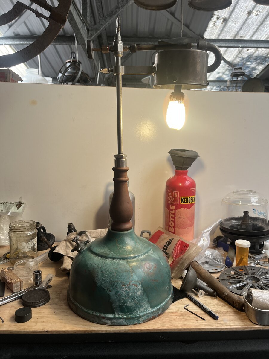

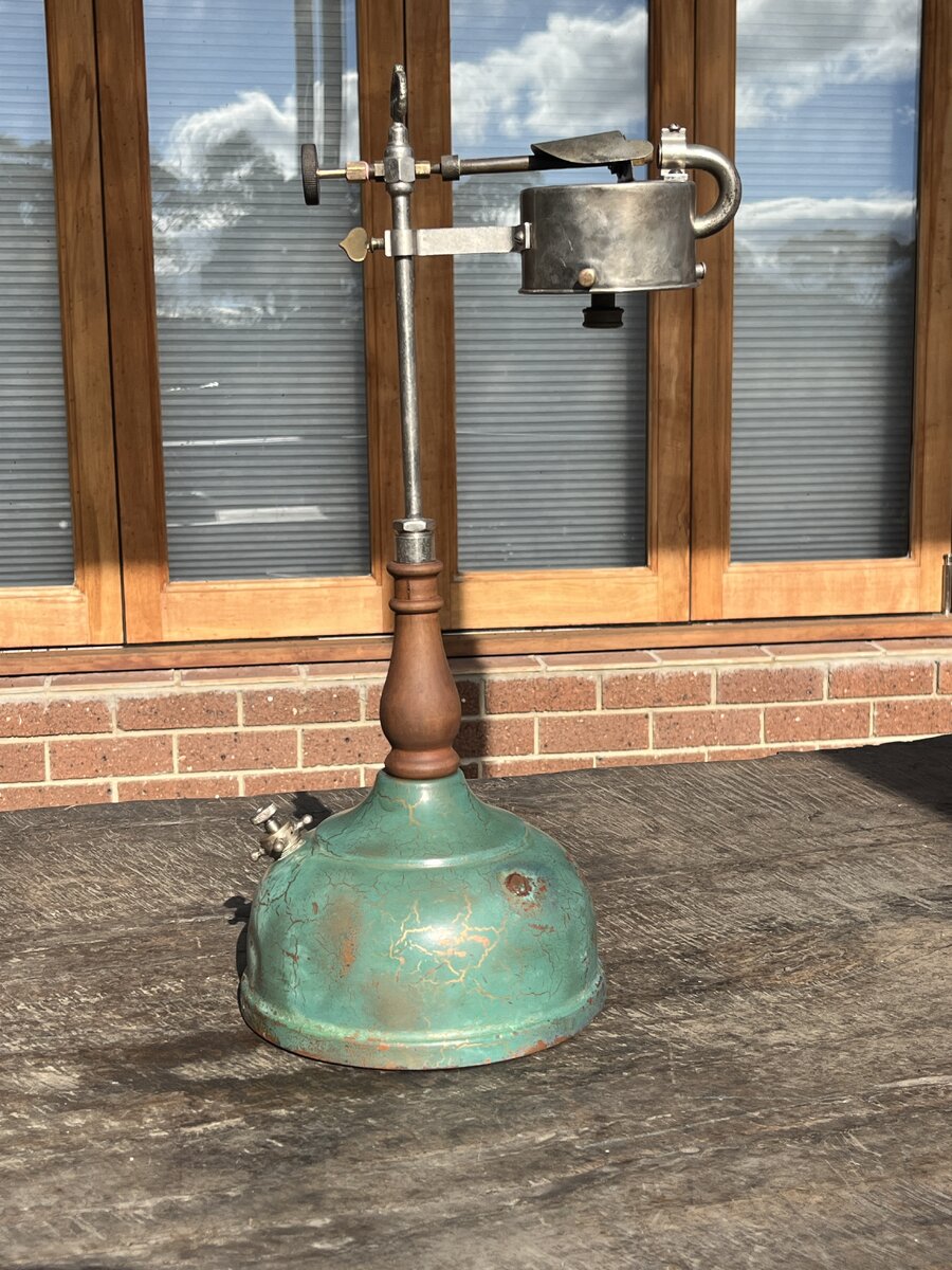

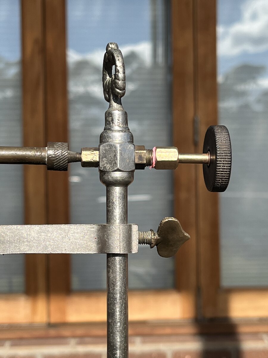

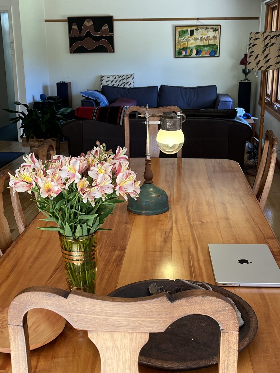

    This is another Australian Gloria table lamp using the hollow wire No. 20 burner with inverted plumbing, and an Akron-style tank.
    It is similar, though not the same, as this other Australian Gloria:
    Gloria Table Lamp (Australia; listed as AO in PLC)

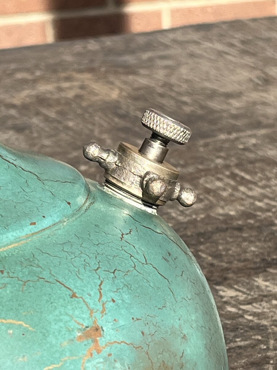

    Note also the crackle-painted copper tank like that on the heater of @Marko57:
    GLORIA HEATER (Australia) Original blue paint.

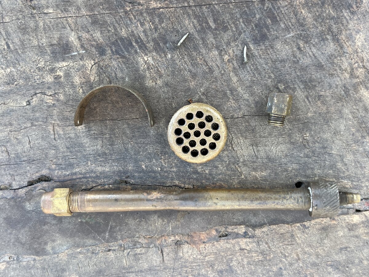

    No stampings on the No. 20 shroud.
    The generator is badly beaten but I will refurbish it. I am using an Old Coleman Parts modern replacement generator below.

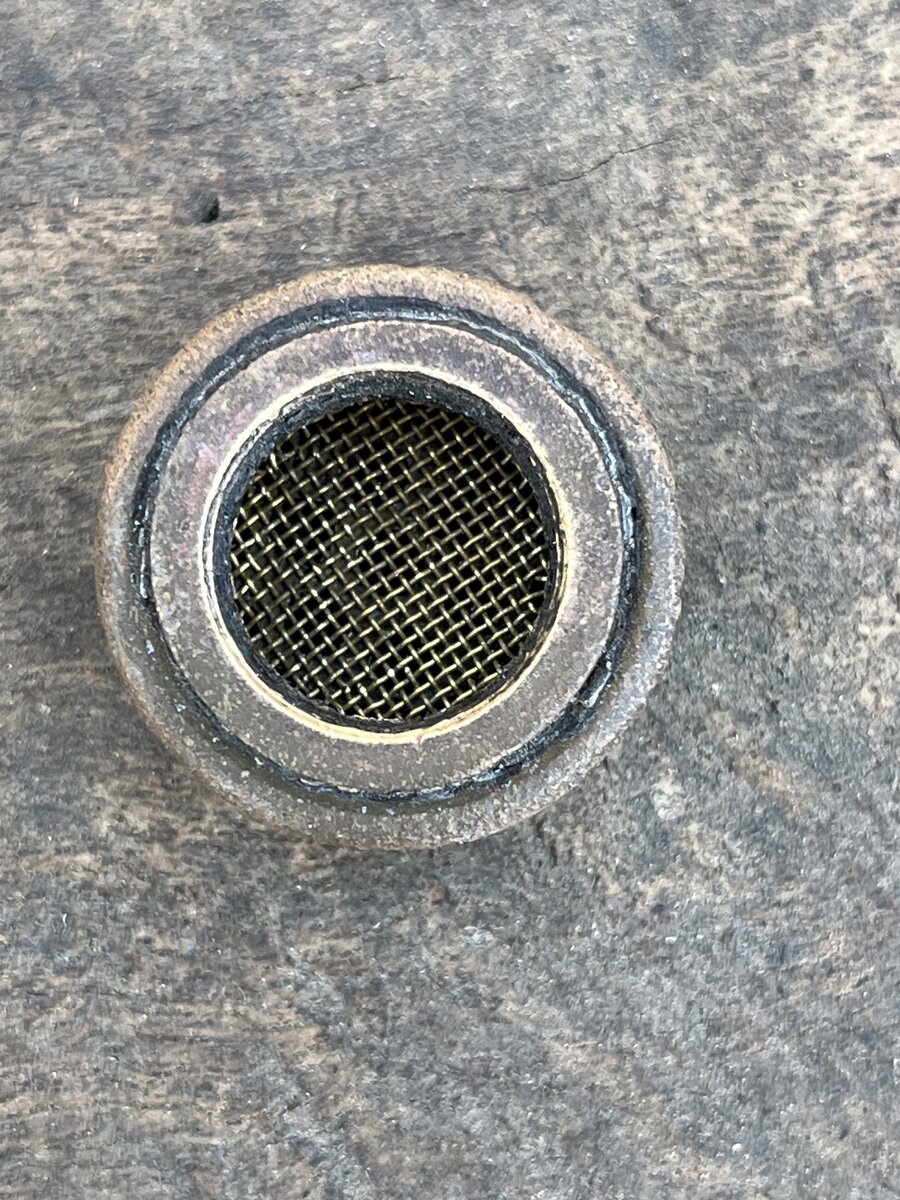

    I put brass gauze in the burner cap.

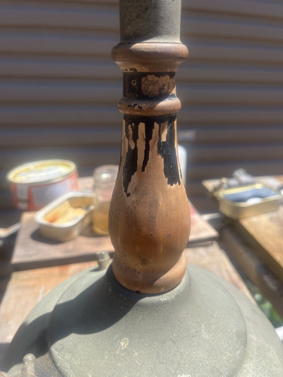

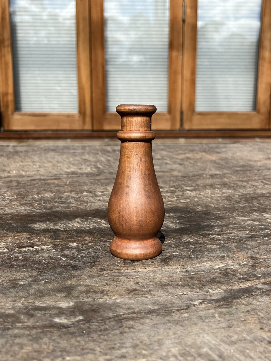

    The handle had been sanded back to bare wood. I treated it with Jarrrah-stained Tung oil, and filled the hollow centre with linseed oil for 24 hours to treat the wood.

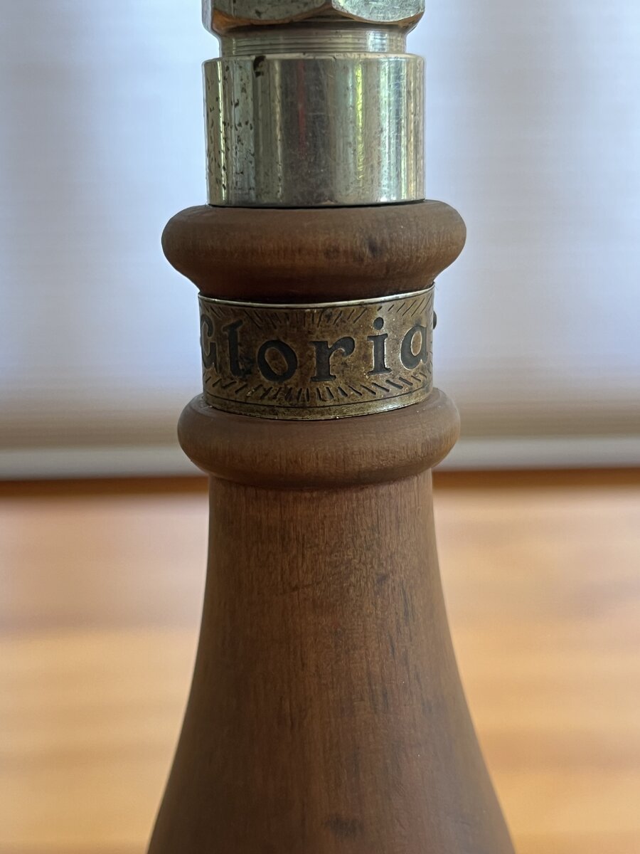

    “Gloria”

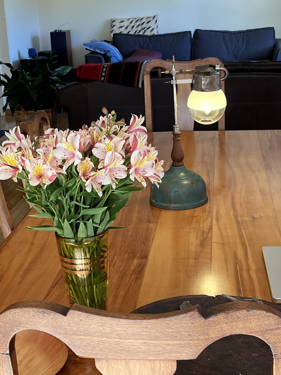

    Up and running
    [Note: the fuel containers in the background are empty and clean]

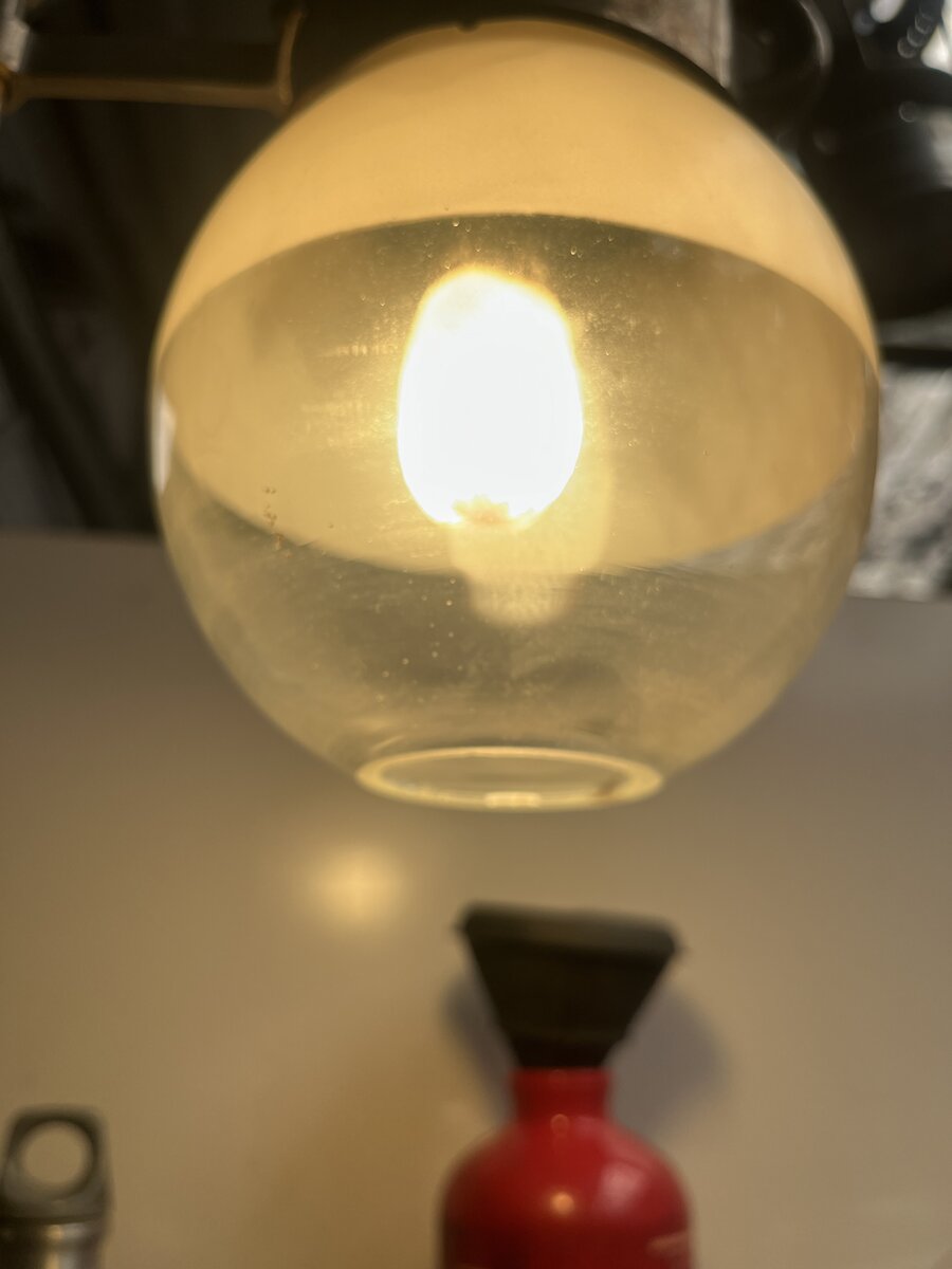

    The glass is most likely a Gloria glass.
    Butterfly 400/600cp mantle.
    I acquired this lamp from Collin Mills.

    The paint job on the tank is very beautiful.:clap:
    The wood finish looks natural, but was it originally dirty?
  6. Tony Press
    11,061
    @Camp numao
    It would have been painted originally, but it came to me with the paint sanded back to bare wood.
  7. Camp numao Japan
    Jan 13, 2024
    292
    Japan
    I actually prefer a finish that shows the wood grain as it gives a warmer feel.
    Thanks for letting me know.

    I’m working on another Australian Gloria lamp that has the same handle. I was originally painted black:
