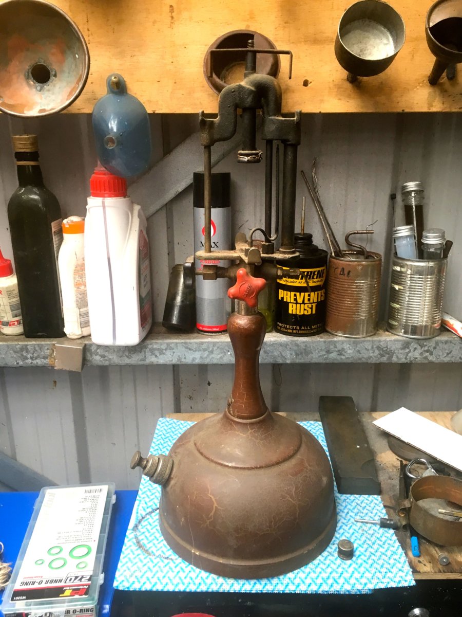

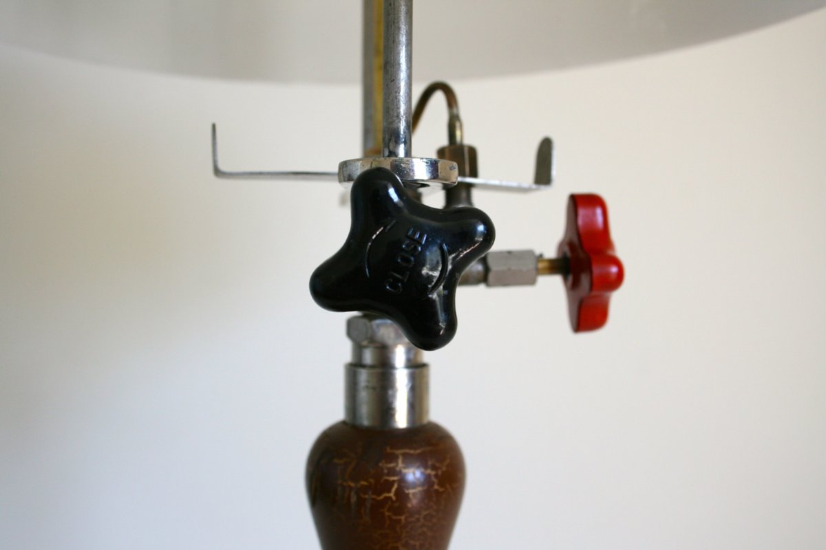

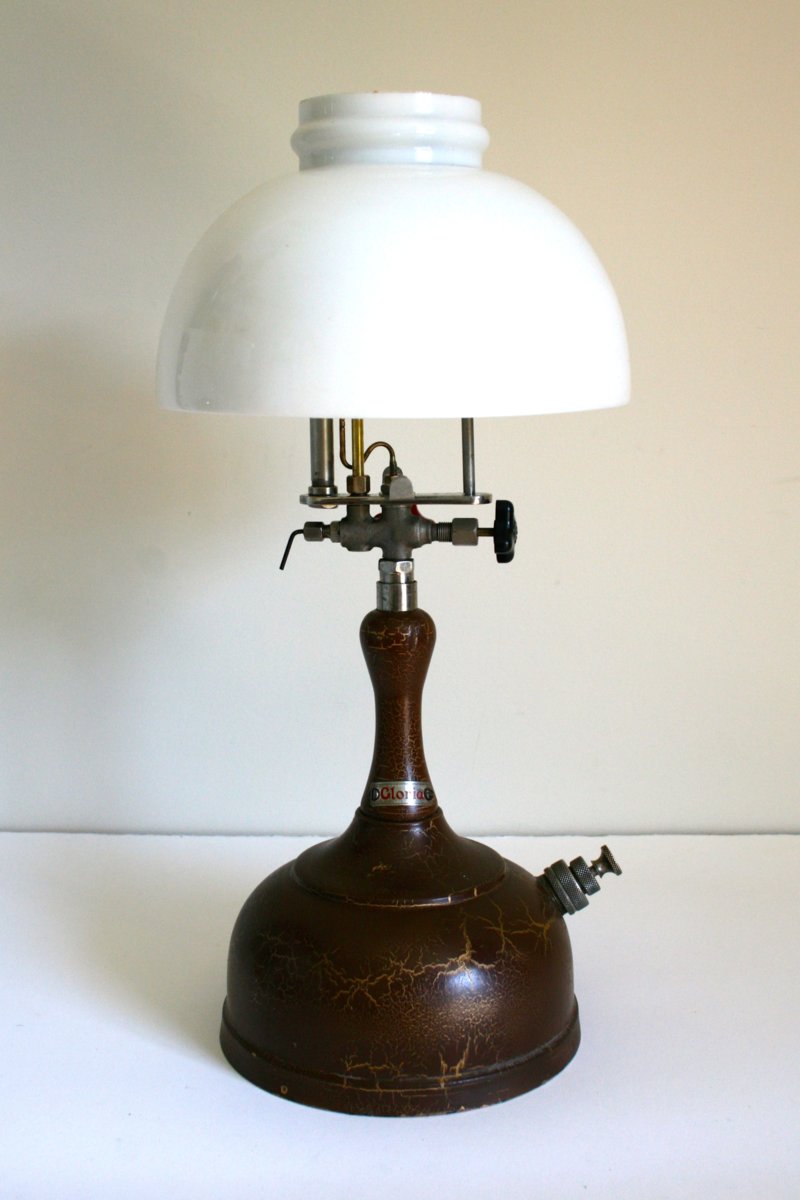

    Here is a Gloria Table Lamp, made in Australia around 1937. It is gasoline.

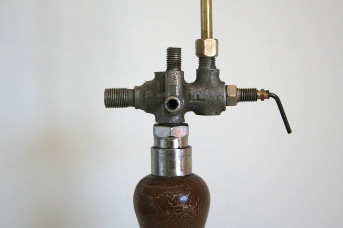

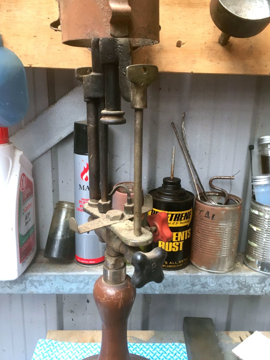

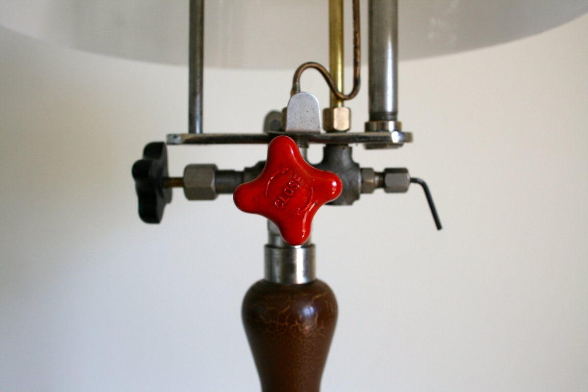

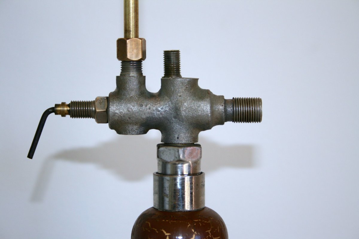

    This is the control for the pre-heater.
    Fuel control.

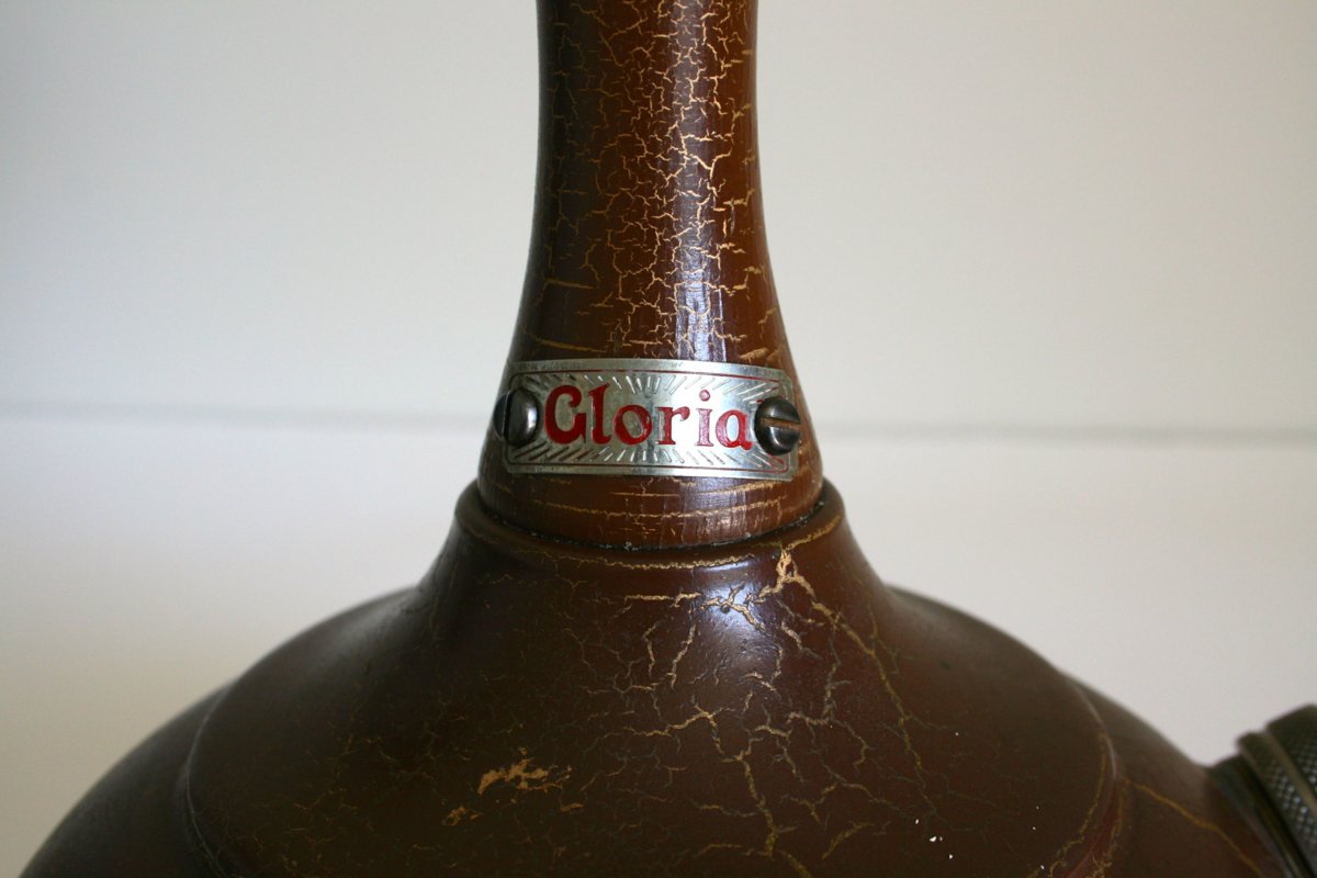

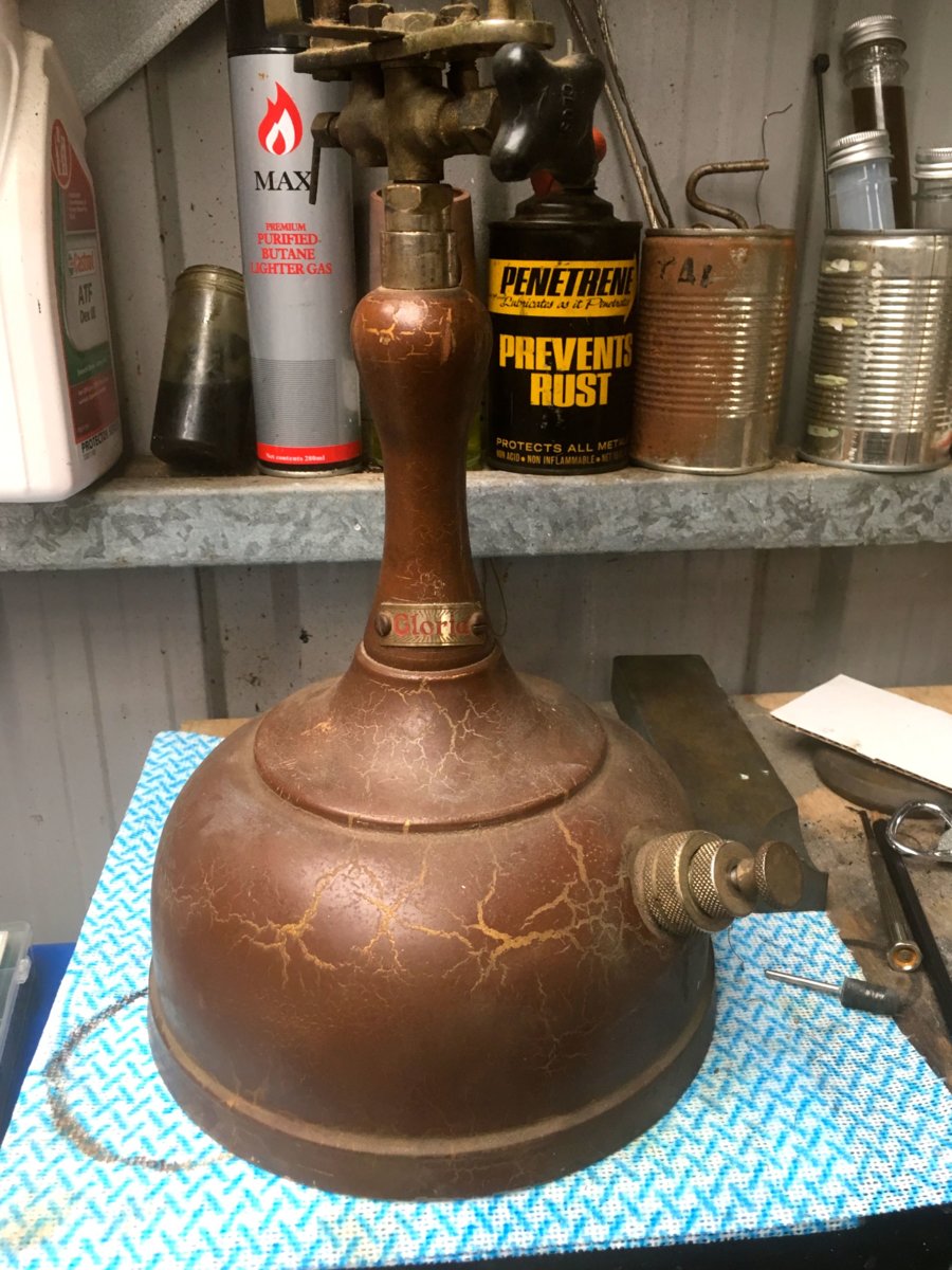

    The tank is all brass.
    The vapouriser (generator) is made of heavier brass than a Coleman.

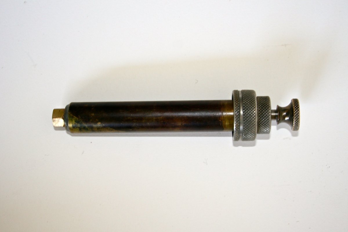

    It has a "Tilley-type" pump with an NRV at the end of the removable pump.

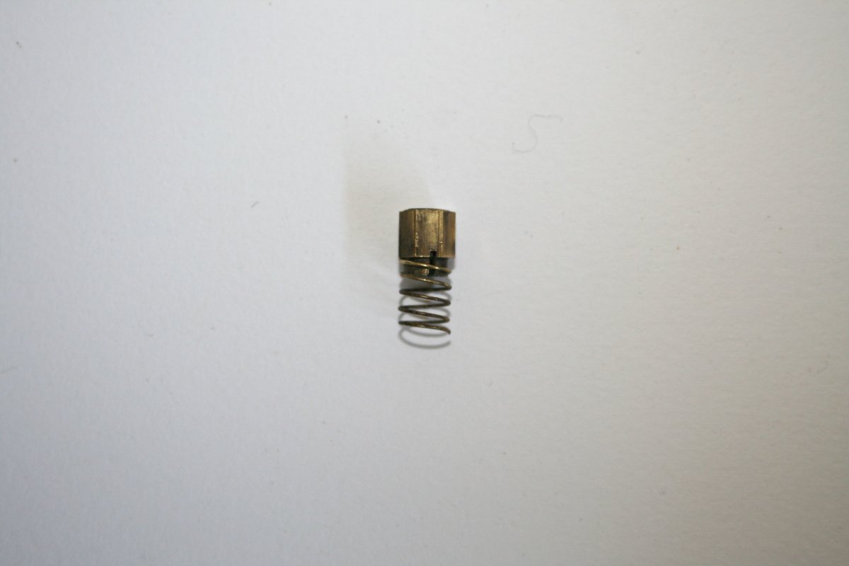

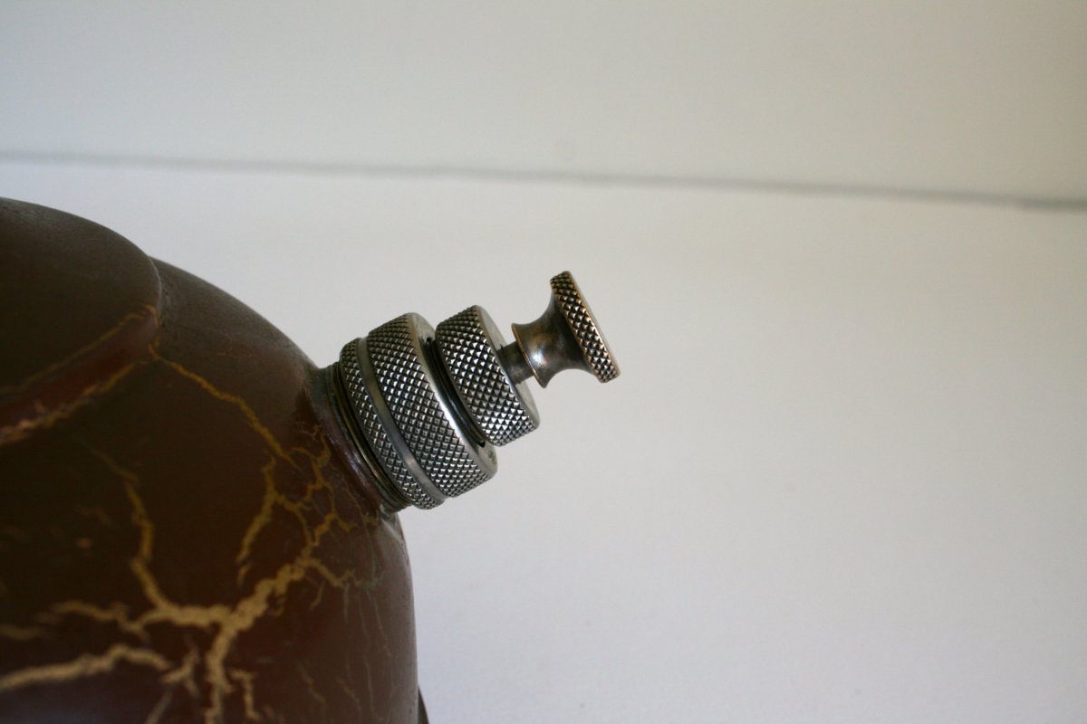

    Some detail of the NRV in which the spring clips into two opposite slots. It takes a 3/16 diameter pip cut from 2mm viton.

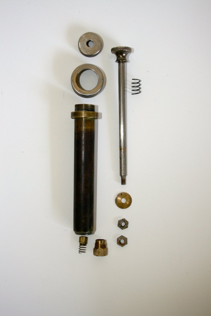

    The inside of the vapouriser: a steel spring with a cloth shroud.

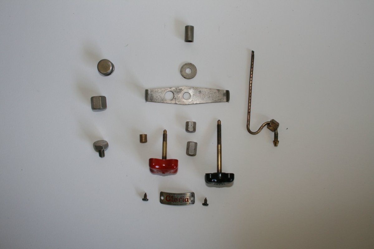

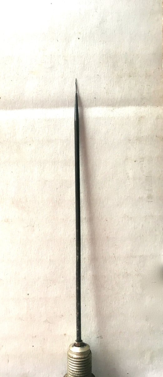

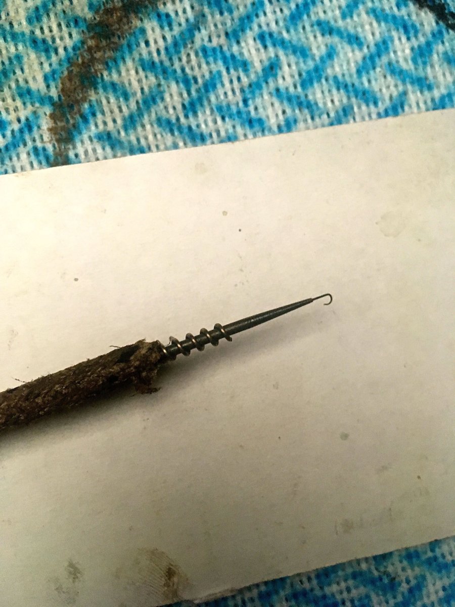

    The pricker and brightness control rod/needle. Note the tapered needle (that I had to straighten - see below). I did not take it off the lamp.

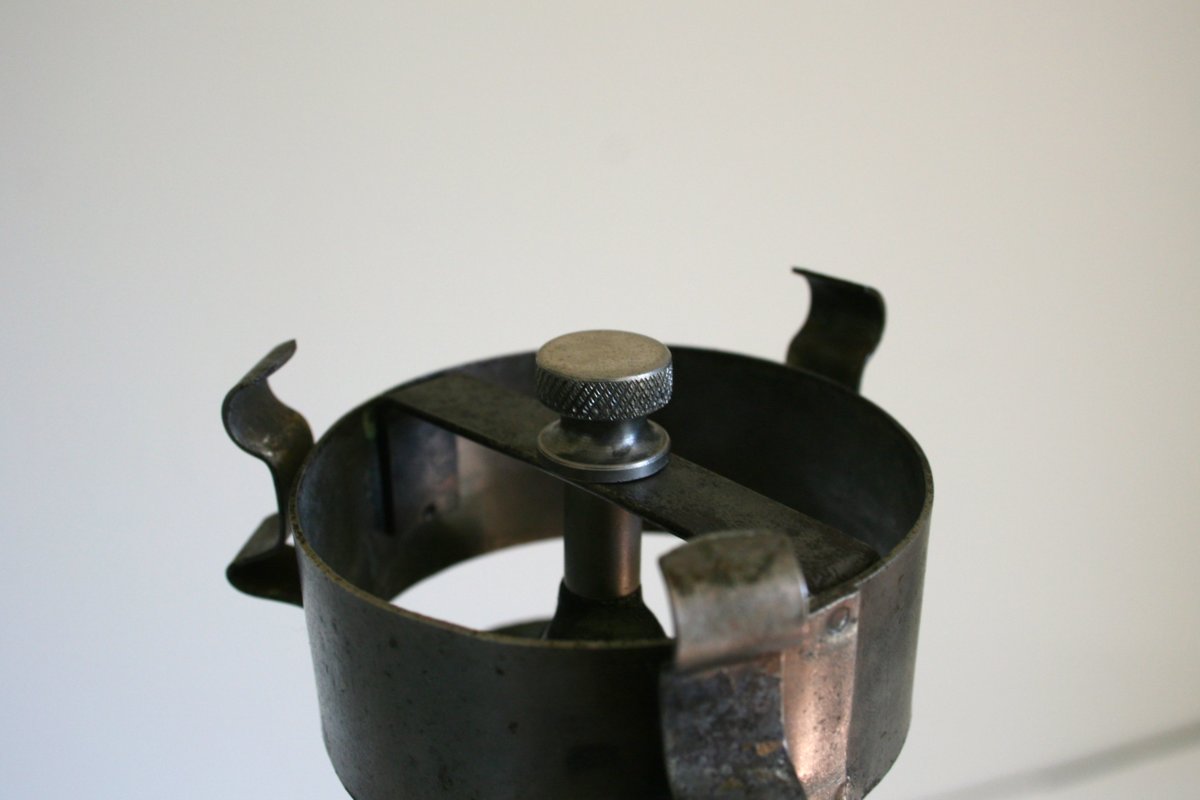

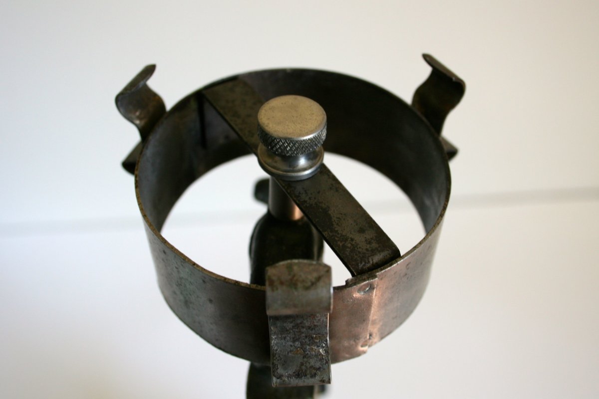

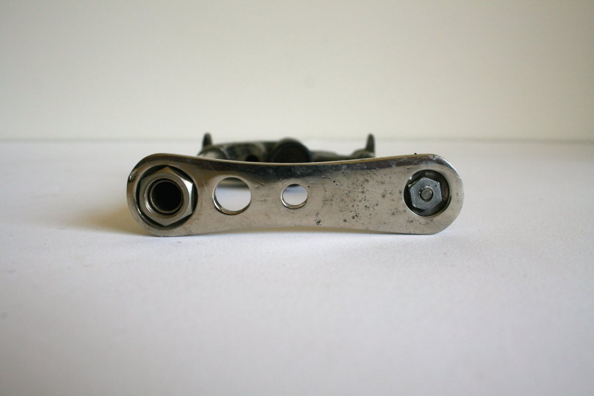

    Note the two part shade holder. Heavy nickelled steel. The burner is the same as on an Australian Gloria 379 from the same period.

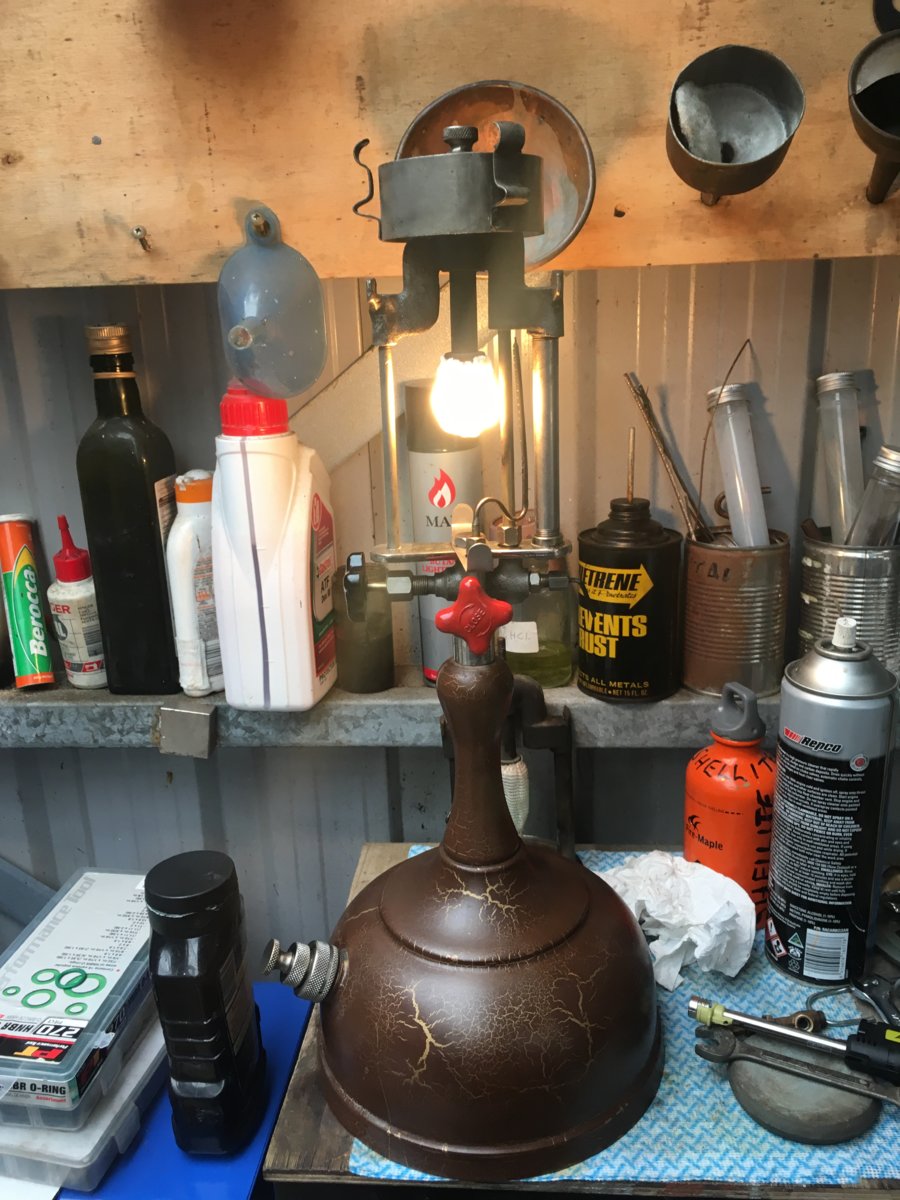

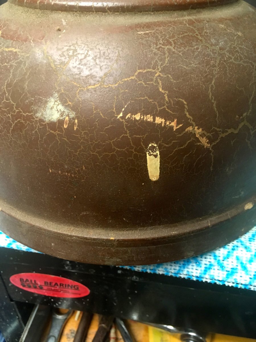

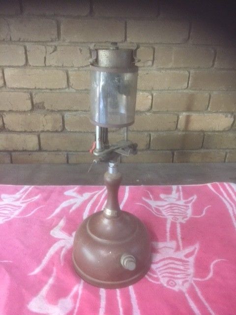

    As it came:
    Testing the burner.
    First test mantle.

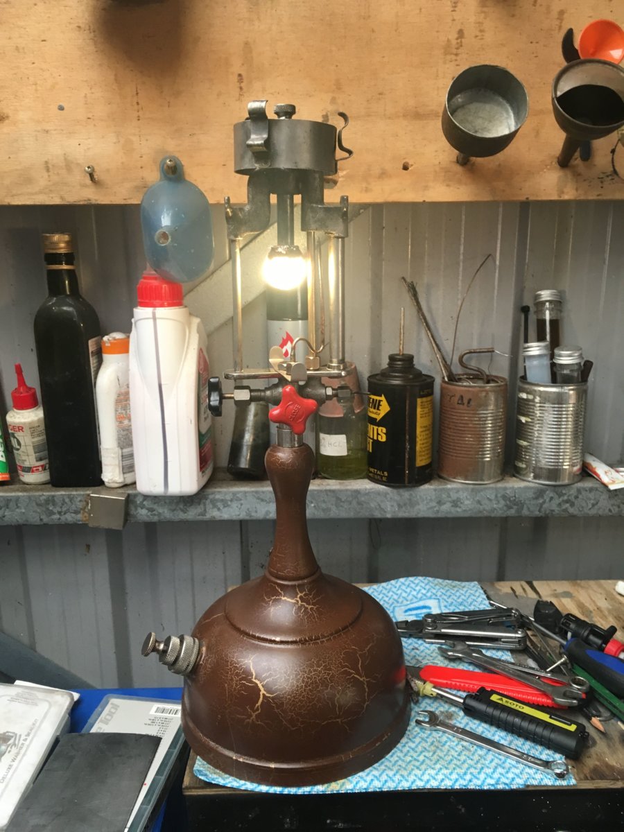

    This, by the way, was the pricker/brightness control!

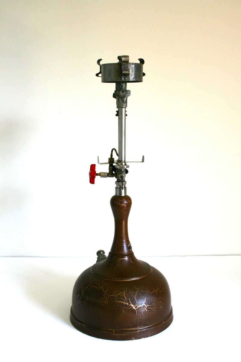

    Finally got the preheater to work after much carburettor cleaner! Austramax mantle.

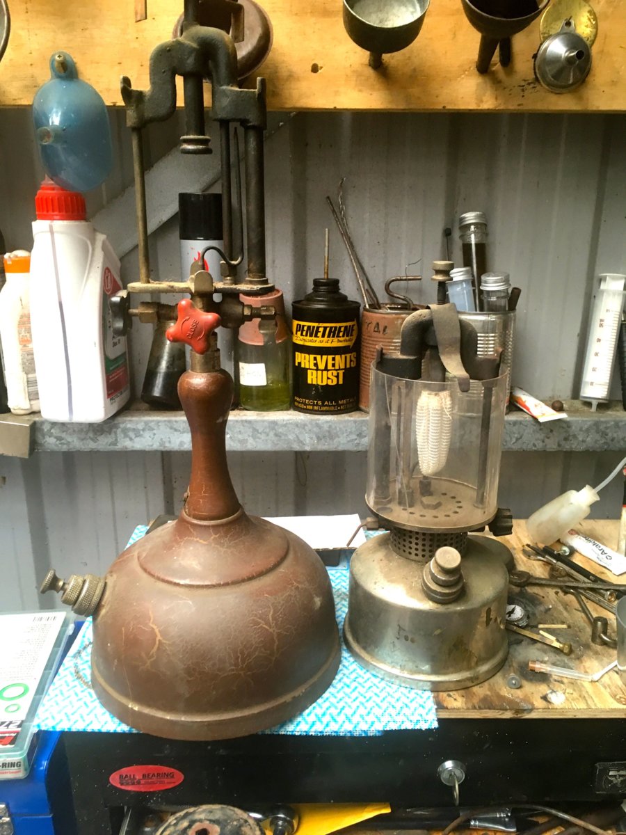

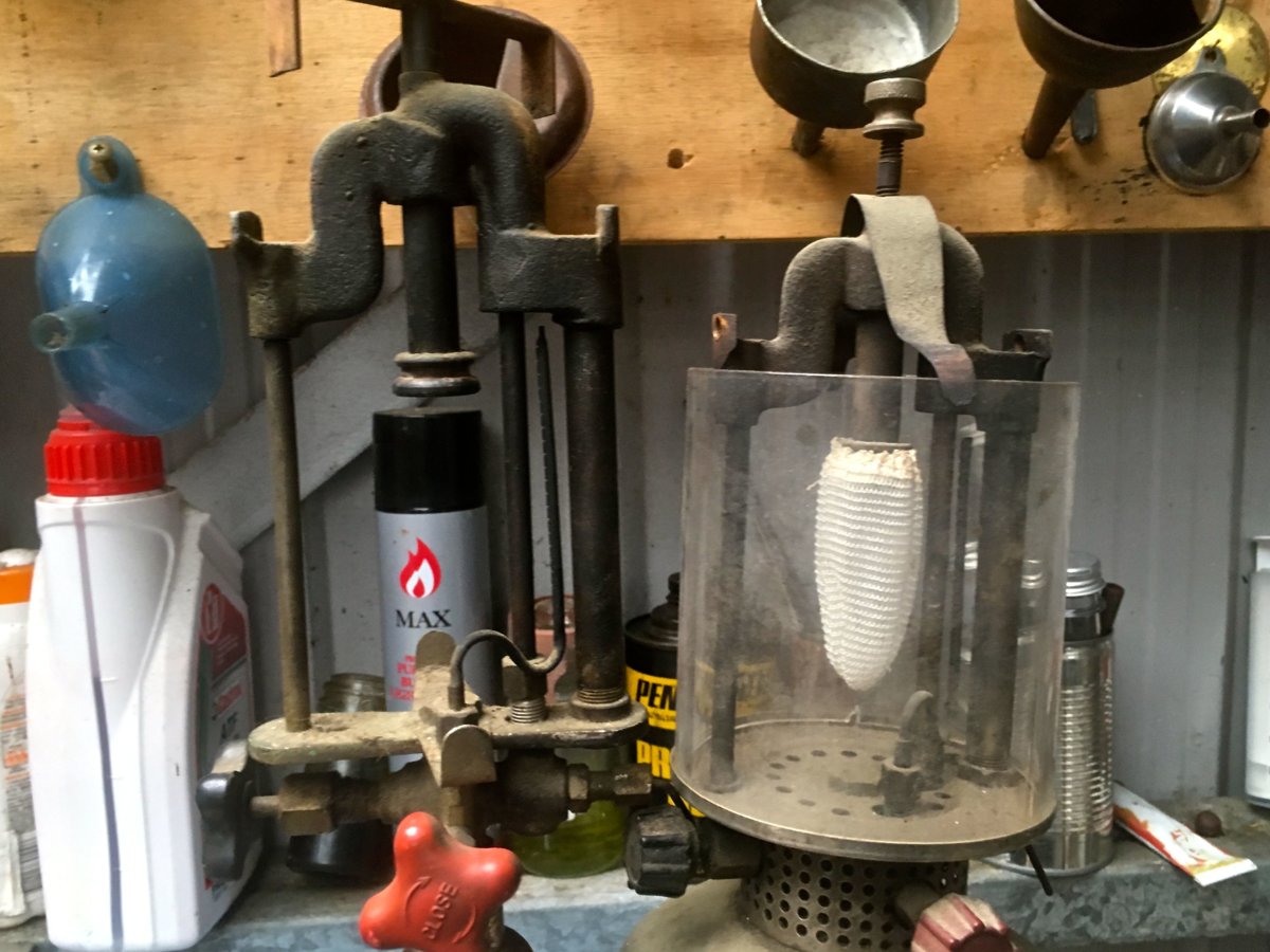

    Here's the lamp next to its contemporary Gloria 379 lantern: same burner.
    My reason for giving it a circa 1937 date, is that the burner first appeared around this time with the Gloria 379 gasoline lantern, and Gloria stopped producing pressure lanterns somewhere around 1938.

    A fine restoration accompanied by detailed images (as always). I like the crackle finish on the fount, it has certainly stood the test of time. What stops the weight of the shade from pushing the outer ring of the carrier, down over the cross-piece ?
    Henry.
    16,777
    Well fettled and it's a splendid old lamp!:thumbup::clap::clap::thumbup:
  5. Tony Press
    11,087
    @Henry Plews
    Henry,

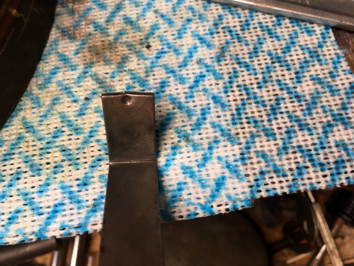

    The centre piece has been punched at both ends like this:
    Even though it sits tightly against the outer ring, I feel it would not be something to rely on with a glass shade.
    I'm thinking about making the centre piece permanently affixed to the outer ring.

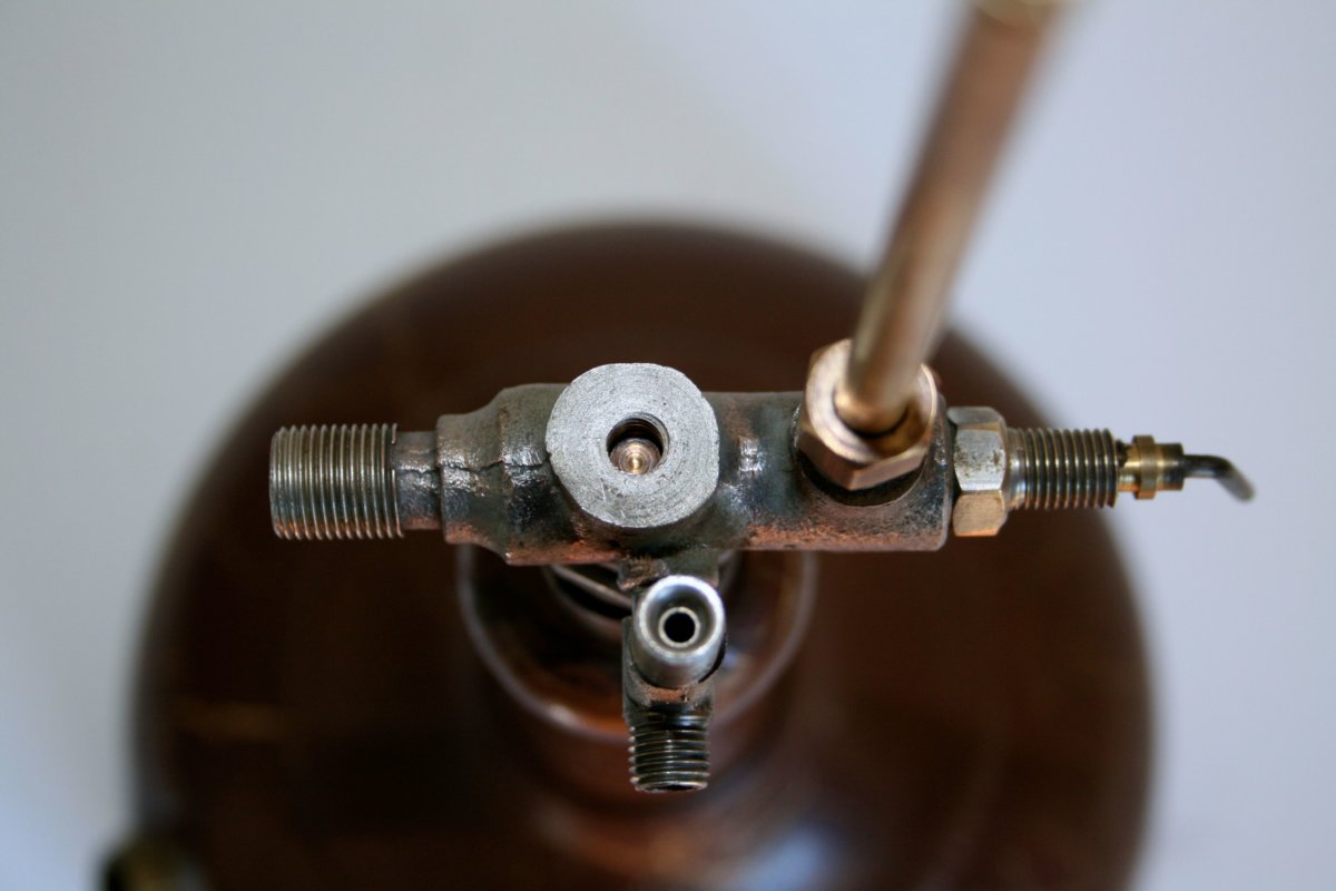

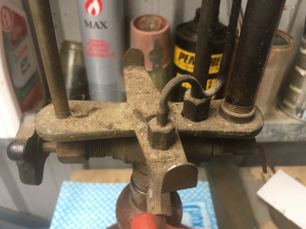

    I think I've worked out how the pre-heater functions... but I'm not sure.
    This is the control assembly from a Gloria 379, but it is the same as on this table lamp.
    Note the small nut on the bottom of the cast brass. It's a nipple with a jet that has a hole that takes a fine pricker (eg a Coleman 236 pricker).
    It has a "passage" directly to the red control wheel shown in the above photos.

    The reason you are quite right to not rely on this shade holder to hold a glass shade is because they are designed to hold a parchment shade.
    If I was you, I know I'm not, rather than alter the original design, I would simply look for a substitute shade holder that can support the weight of a glass shade. I'm sure you have some Coleman shade holders that will do the trick, if not, they are easily obtainable.
  9. Henry Plews
    3,059
    @Tony Press
    I had wondered if that was the method employed. As @Matty says, "designed to hold a parchment shade", thus no need to weld the two pieces together.
    Henry.

    Matty is right... what I need is parchment shade.

    In the photos above of the lamp lit, you will see the the pricker is in a raised position.
    Gloria describes the pricker mechanism as both a pricker and a brightness regulator.
    The reason I had it in a raised position when taking the photos above was because their were flames outside the mantle, and I could get a bright light using the pricker.
    My thought at the time was that the jet was enlarged.
    Yesterday I did some fiddling around with the nipple, cleaned the threads and mating surfaces, and re-set the nipple in the top of the vapouriser with a touch of high temperature Loctite.
    It’s now running perfectly with the pricker in the fully down position. (Photo in daylight in shed):
    :content:

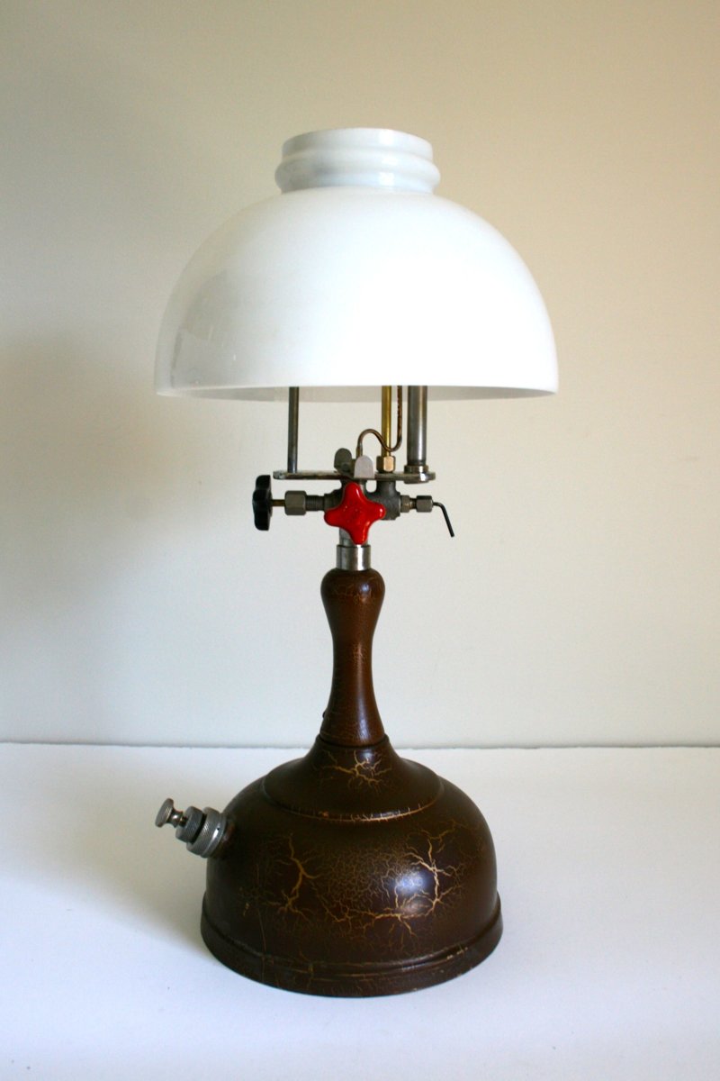

    @Henry Plews
    Thanks Henry, yes it does seem to be in great shape. I haven't received the lamp yet.
    @Tony Press
    I wasn't trying to rain on your parade. I was simply meaning to show the mica globe as it should be. I'm a bit baffled as now I look back through this topic, I can't see the posts discussing the mica globe.
