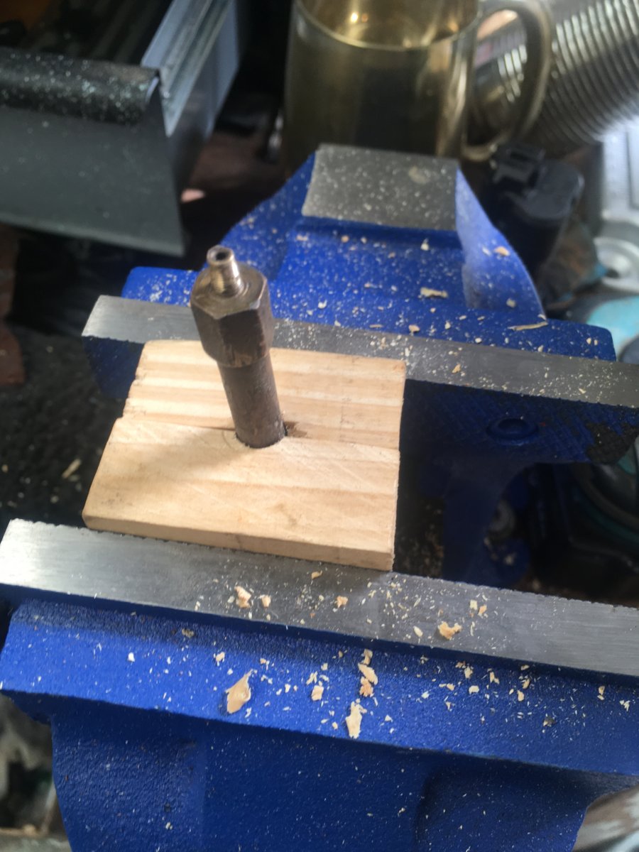

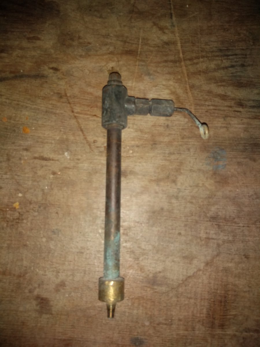

    Hi. Should I service this vaporizer? What is inside it? 15470807092548397651540805010721.jpg
    6,373
    Juan
    If your pricker is working, I would service this vapouriser by soaking it for 24 hours in acetone, then soaking it in Coleman fuel. If the vapouriser will then not allow the passage of fuel, you might have to replace the packing (which is most likely asbestos). The asbestos packing can be replaced with fibreglass.

  6. Mackburner
    6,265
    Typically these have a steel rod inside the generator with asbestos string wound round it. Sometimes you may find a small staple shoved at the end to stop the packing cigar rising up the tube. The packing does clog with carbon and often requires burning out or replacing. Simplest solution is to re pack with a fine brass wire mesh but I normally make a new cigar with a wire rod and new asbestos string. ::Neil::

    Yes, I guessed that a spring or something similar should be inside it but there is something carbon clogged. When I try to blow through the bottom hole, the air passes but hardly.
    So: if I completely remove the whatever is inside by any way I will not destroy the vaporizer. Is correct? In this case brass mesh is easiest to find for me.
    Thank you very much.

  8. Tony Press
    6,373
    Juan

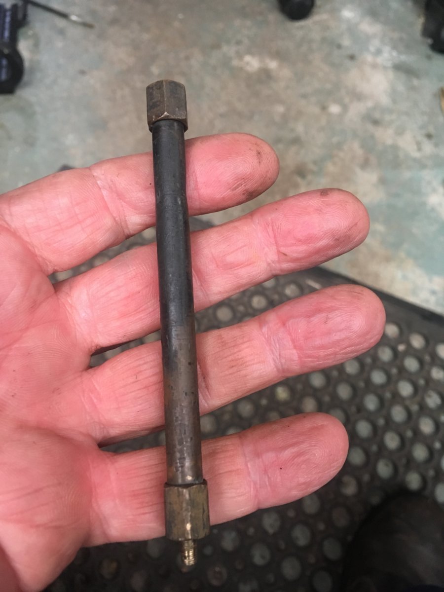

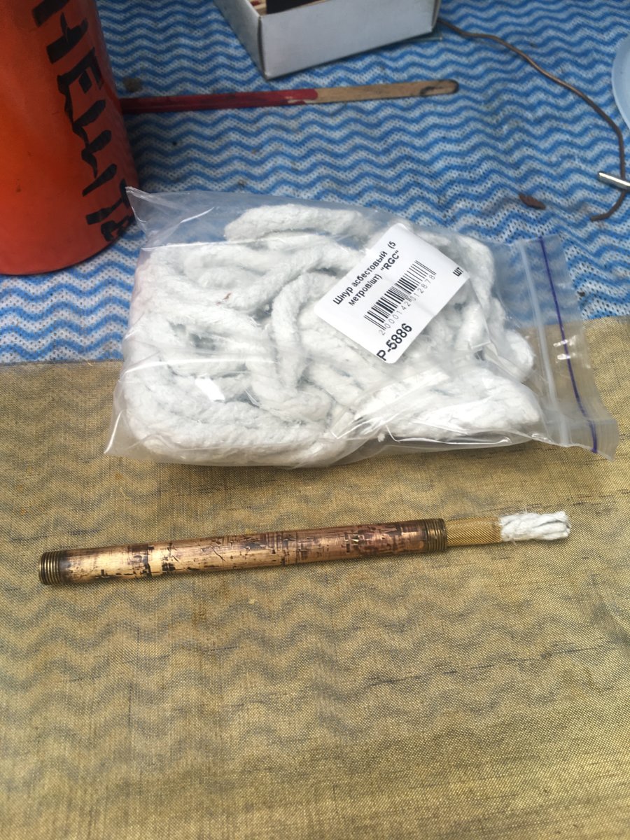

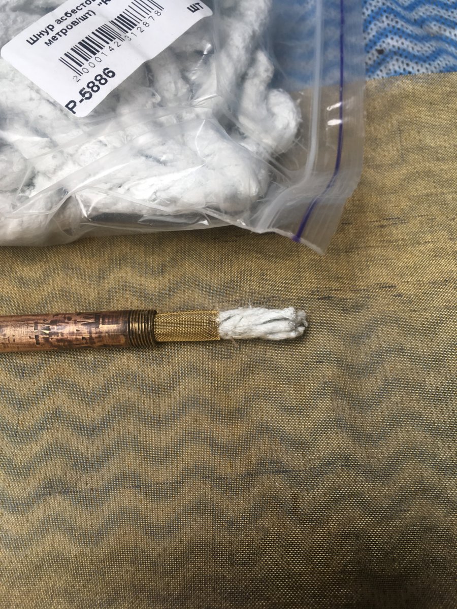

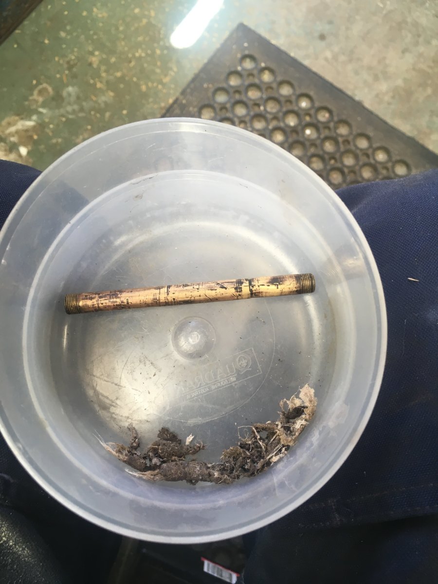

    I just replaced the packing in this Gloria generator:
    Old packing.
    New packing.
  9. Juan
    Dec 2, 2010
    841
    Excelent! How did you get the old asbestos?
  10. Mackburner
    6,265
    You won't damage the generator at all. They are always just a metal tube where the liquid is vaporised. The packing is a filter and an aid to vaporisation. As there is a pricker the filter is less important but the heat transfer is vital for smooth running. I often give up on being carefull and just run a drill down the tube to clear it and then use asbestos to re pack. But with a pricker, because the filter is less important, inserting a wire mesh will do the heat transfer job and is an easier fix. ::Neil::

  15. AussiePete
    2,742
    I'm glad that you have shown the dissembled generator. I have one to refurbish and now, from you pictures, I know that it's possible to take apart fully. To date, I have only managed to get one end. I was starting to think that the other end was silver solder or something. It seems that I have to be a bit more brutal with the persuasion.
    O' my generator was/is fitted to a Gloria table lamp.

  18. Tony Press
    6,373
    I cannot even try to imagine what “safe asbestos” could be.
    I treat it like “unsafe asbestos”.

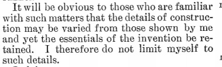

    What you said is exactly correct in some circumstances but not others where we have evidence of a patent being more than just an idea, it was produced because we have physical examples of the item.
    Nearly all inventors that had an item patented mentioned in their patent text that those familiar with manufacturing didn't necessarily have to manufacture the patent to the exact drawings of the original patent. Coleman certainly put such a message in a couple of his patents at least. The following is one such an example.
    So, having established that patentee's allowed for variations of their patent to be manufactured, the original patent was still the standard. The only way you would be able to manufacture the patent as drawn by the inventor or as modified by you, would be through a license agreement with the patent holder. In other words, you couldn't just change a few things and that nullified the original patent - it did not.

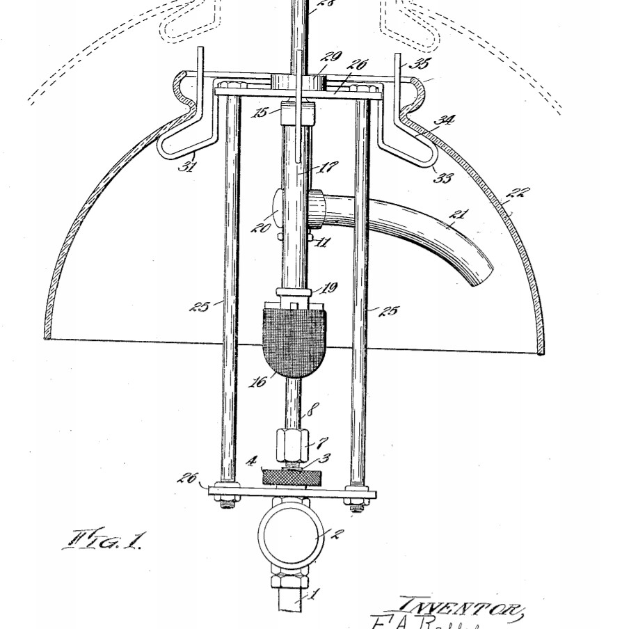

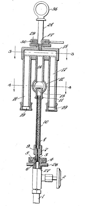

    When we find patents, it is difficult to know if the patent is the original or a variation of the original. The following patent is what I believe to be a variation of the original patent and of course, as long as you paid a license fee or royalties you were quite within your rights to alter the original patent then patent your version. However, your version of the patent did not nullify the original patent and you would have to continue to pay royalties depending on what arrangement you made with the original patentee.
    You may or may not be familiar with this patent.
    Many of those that have found the above patent may well believe it is an original idea that was patented. Those that are familiar with OXOGas or the KK lamp burners would know this is a variation of them.
    So why did inventors go to the trouble of altering the original patent? Why not just use the original patent as drawn and save the cost of re-engineering and applying and paying to register a patent. Those costs would have been considerable.
    I think the most obvious reason companies altered original patents were to make a burner that suited their current generators, cowlings and shade holders as examples. I also suppose that there was the possibility that other companies might like your version of the original patent and they would pay you royalties to use your version in their lamps.
    For the reasons above, I think we need to be very careful of what we think is an original patent. I'd caution against thinking that AGM patents that have been found are the originals. I would also caution against thinking that Doran was the original inventor of the common burner Gloria and others used on so many lamps such as the 'Gloria Model B'
    Back to the generator. I am happy to believe I have found the original patent for the generator that Gloria and so many others used. The generator as seen in this topic is a variation of the original and came quite a bit later.
  24. Mackburner
    6,265
    Yes that is US patent 1337620 applied for 6th September 1919 and can only be a later variation since Gloria were using that generator type from at least 1914 ish. Odd patent too when by 1919 I doubt anyone wanted to think about making new types of torch lighting burners with the possible exception of folk like Thomas and Kaufamannwho were making kero lamps but they were using a similar generator from 1916 anyway. Seems to me that patent is more to do with supporting the burner and shade than re-inventing a generator. The original patent for the Gloria generator has to be at least 5 years older that this one and probably dated around 1910 to 1913 or even earlier perhaps. The above patent cites US pat 1142815 and that is a Kaufmann patent applied for 10th June 1914 but that is just for generation support and not a generator patent. However it does reveal something interesting. Pat 1337620 is in US patent class 431/107 and that is a classification the Guild did not search. The Kaufmann generator is shown in US pat 1144684 Appl 24th October 1914 which is pretty much the same as the Gloria OXO-Gas generator but I suspect that is also a bit late. I don't know of the original patent for the Gloria generator. ::Neil::
