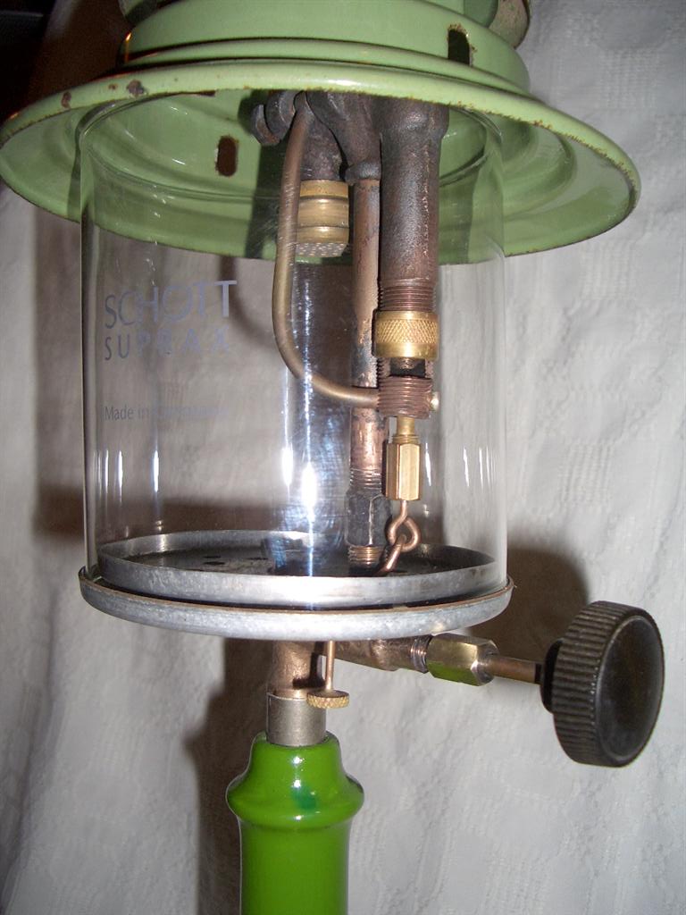

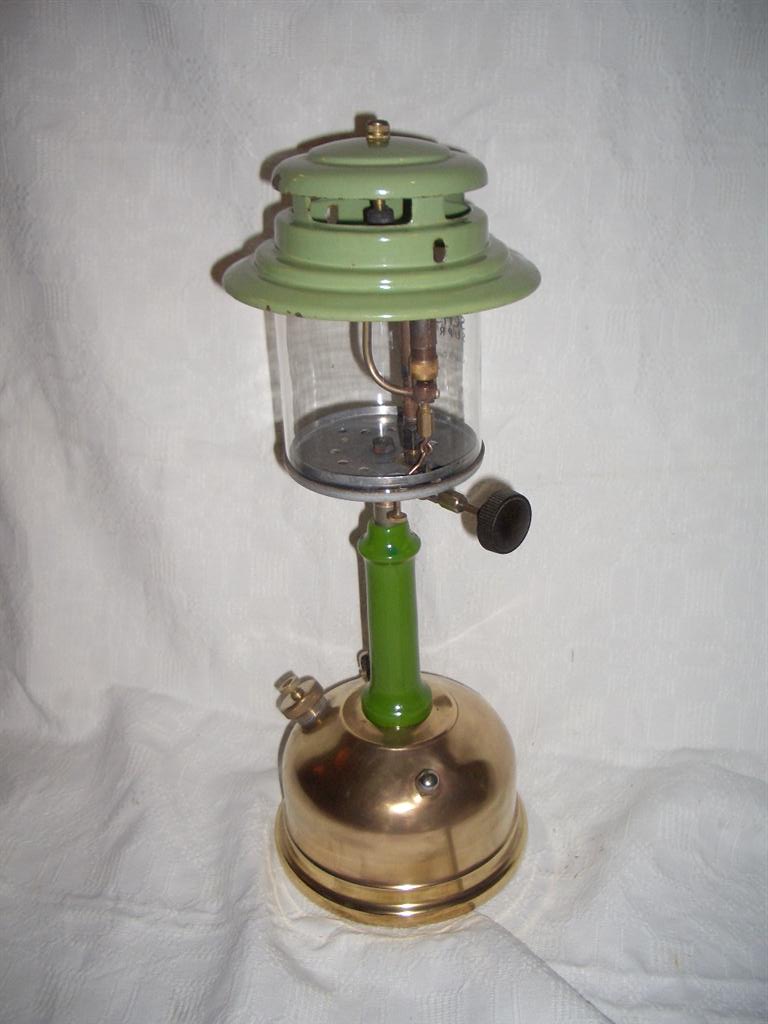

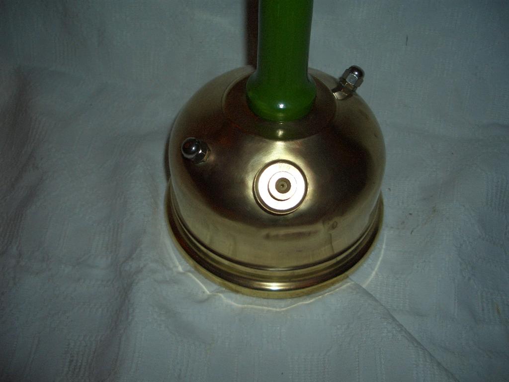

    Here is anoter table lamp, very similar to Neil's.

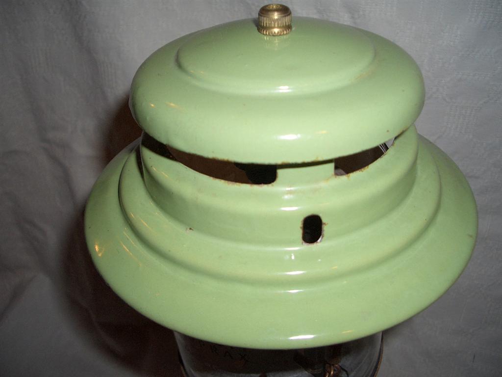

    It has the same awful green handle, same fount and burner but, as you can see, another top. This seems to come from a lantern, it has slots for a handle.
    Another difference is the plate that fix the glass. This lamp has two plates, one in zink plated steel and the other in aluminium. A strange design.
    The control wheel is the same but to mee it looks like coming from an old radio.
    This company really mixed parts together.
    Bo

    We still don't know who made these. The fount is Kayen and the handle and burner are AGM from the 1920s. That hood looks like an AshFlash.
    Because these lamps are factory made hybrids anyway it is hard to decide what was origial and what is aftermarket modification. I can't imagine two base plates as original so I guess the whole globe cage and hood are not but it looks OK. ::Neil::

    As I’ve been doing a bit of work sorting through some of these Quirk’s Victory lamps and lanterns, I can confirm the view of @Mackburner that the hood on the lamp is from an Ash Flash, or more likely in this case, the version of the same lantern sold in Australia as “Campway”. See here:
    Campway Sundowner MkII Model 4100 (Hong Kong)

    The @Bo Ryman Quirk’s lamp is not a “frankie”, even though it may have a ring-in vent and glass.
    1. The tank, fuel control, and burner, and probably one of the globe rests, are all standard Quirk’s fittings that come on these “Goulburn Specials”.
    I expect the glass and vent were fitted either by Albert White, who seems to have once owned the lamp (and another one I have, not yet posted), or by TW Sands, Brandt Bros or a previous owner.
