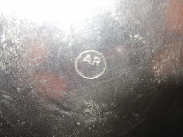

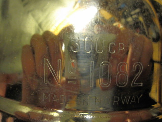

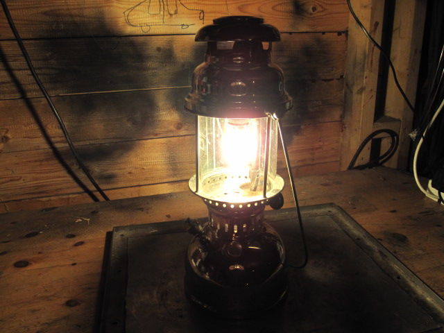

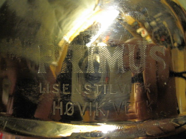

    Here is my HV 1082 marked AR ( 1952 ). Have a few dents here and there but it's a great lamp. Bjørn
    1359758776-IMG_1638_opt.jpg 1359758790-IMG_1642_opt.jpg 1359758800-IMG_1637_opt.jpg 1359758817-IMG_1641_opt.jpg 1359758832-IMG_1647_opt.jpg 1359758847-IMG_1648_opt.jpg 1359758860-IMG_1660_opt.jpg
    12,370
    Hello Bjorn, it's a fine lantern and it's bright! :thumbup:

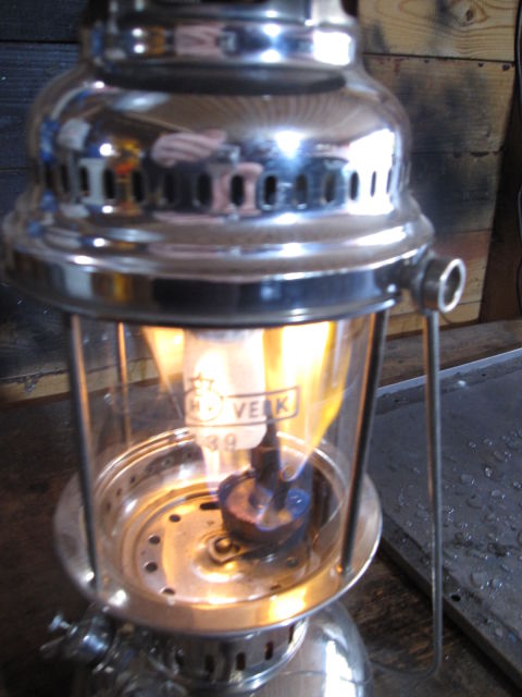

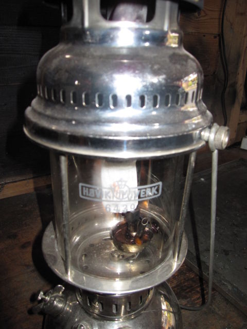

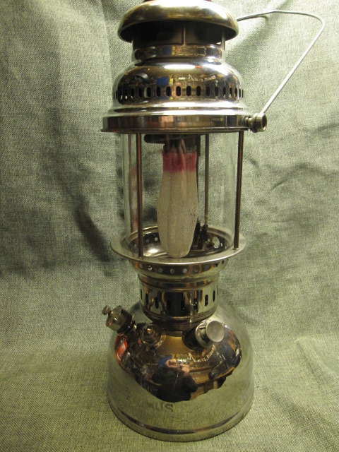

    Some information from a member of this forum enabled me to aquire a few a of these Høvik Verk 6439 glass chimneys for the HV 1082.Thank you. And I must say orginal glass looks better.
    This is one of my favourite lamps. Never any problem. Never a black mantle.Maybe my lucky lamp..
    Brgds Bjørn
