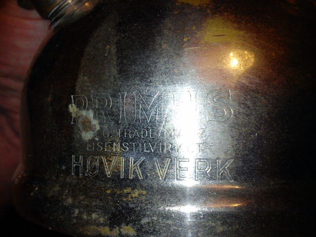

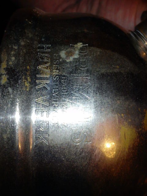

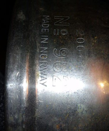

    Thank you George for your fast answer. It pusseled me for a long time. I am a shamed I was only thinking in competition, when it was the precious deed of good neigbough-hood instead. My lamp is born in the year of AR, 1952, and made on licens in Norge, a 982 type, 200 cp. Would love to show you the pictures but im a hopeless attaching pictures. I realy like them Høvik-stoves you got there by the way. Nice.
    Merry christmas
    Claus C
  4. Claus C
    Dec 18, 2012
    1,788
    I hope I didnt mess up the site. Got a little help from my son. In the kingdom of blind - the one-eyed is king.
