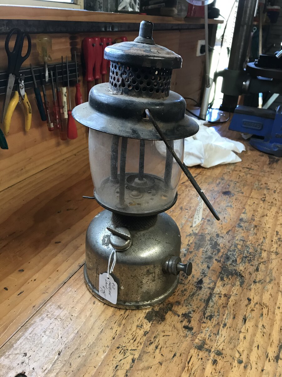

    A week or two ago, whilst rummaging through an antique store in Toowoomba Queensland, I found this made in Brisbane HANDI lantern.
    The asking price was AU$78 however the proprietor was kind enough to let it go for AU$60. The proprietor didn’t know the history of the lantern other than it had been in her store for about 9 months.
    The lantern has been fitted with a glass globe marked “HANDI” and by all appearances its original to the lantern.
    The lantern was found in a dirty condition however, on a closer inspection the lantern's fount and burner air tubes are nickel plated, black enamelled hood and what appears to be the correct fuel cap marked with “HANDI” on one side and “Brisbane” on the other. The valve control wheel is black and is stamped “HANDI”.

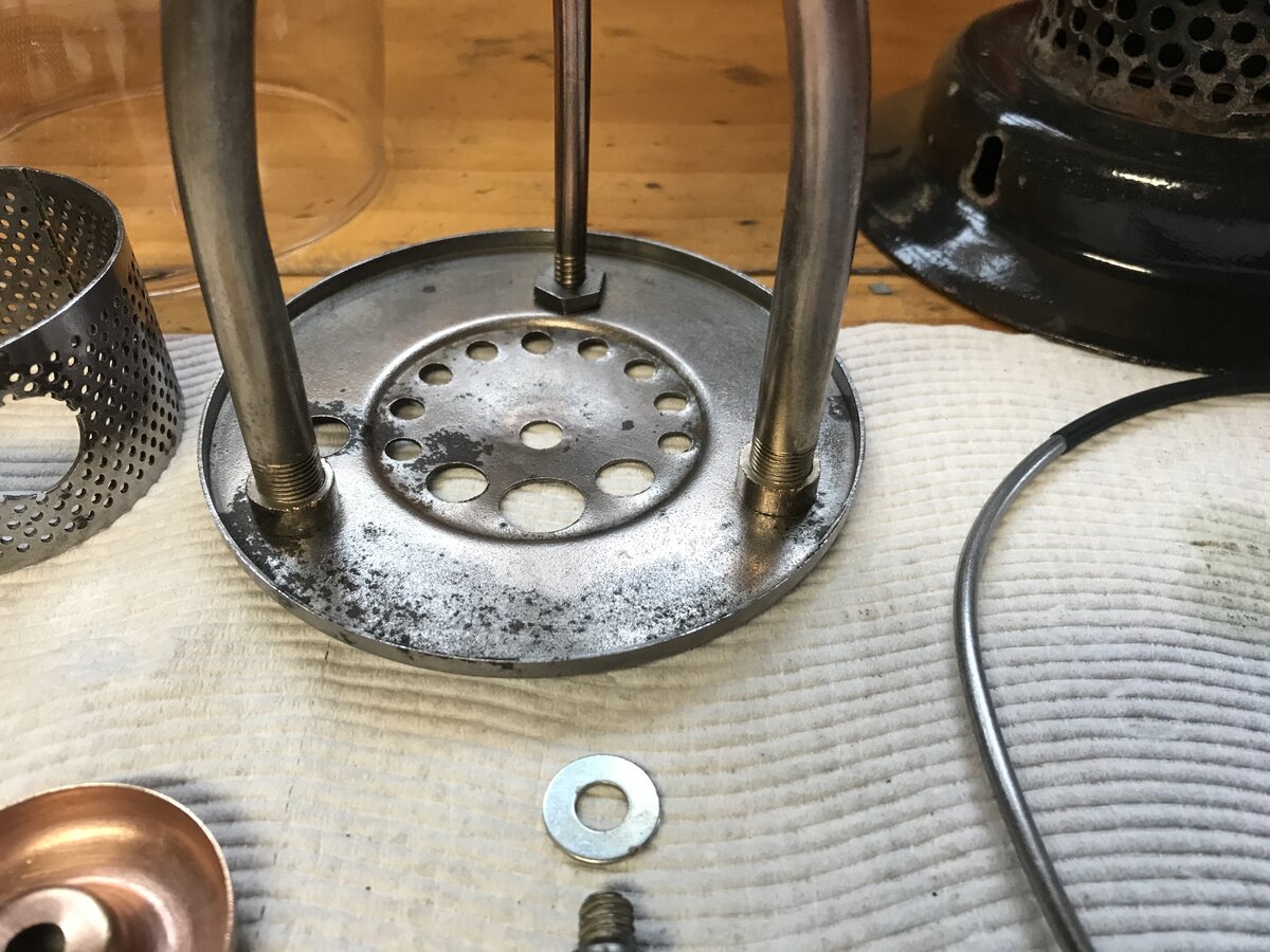

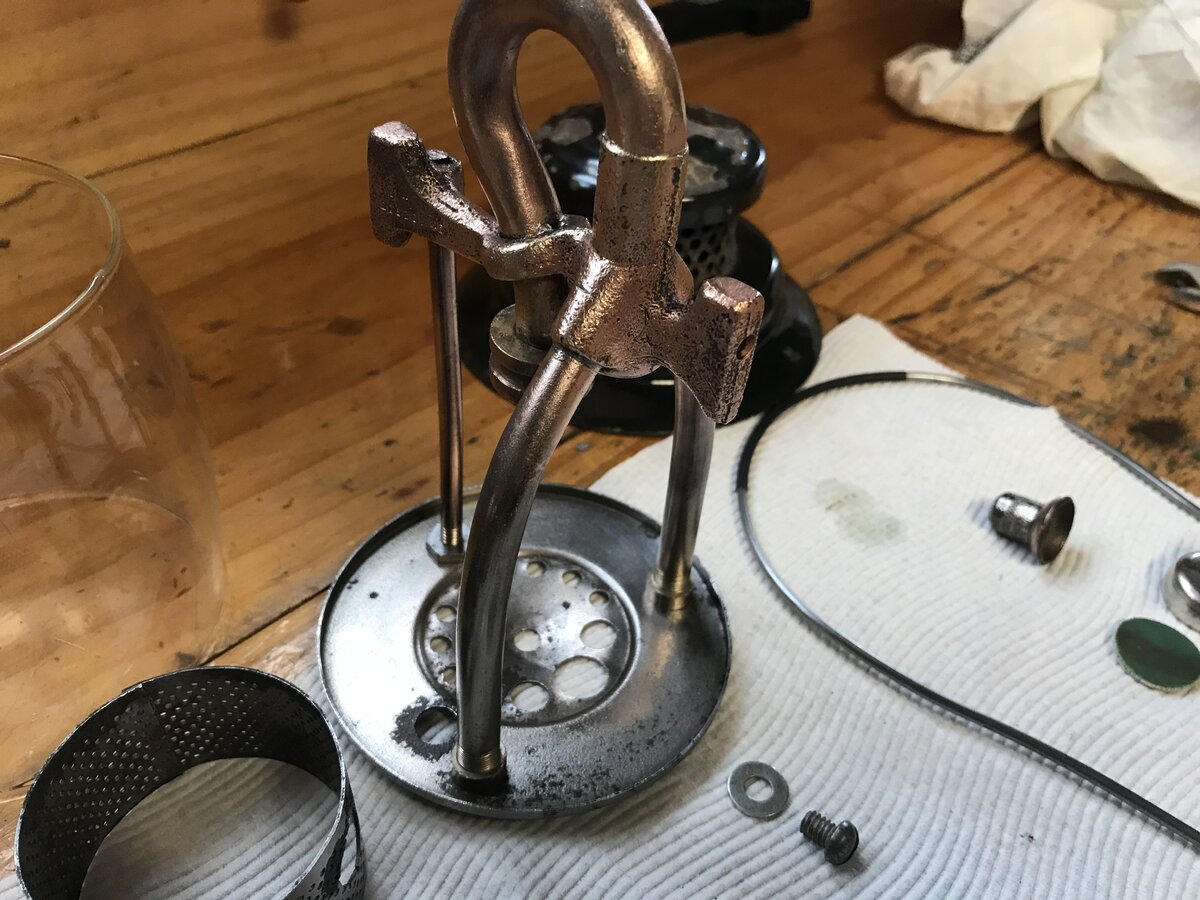

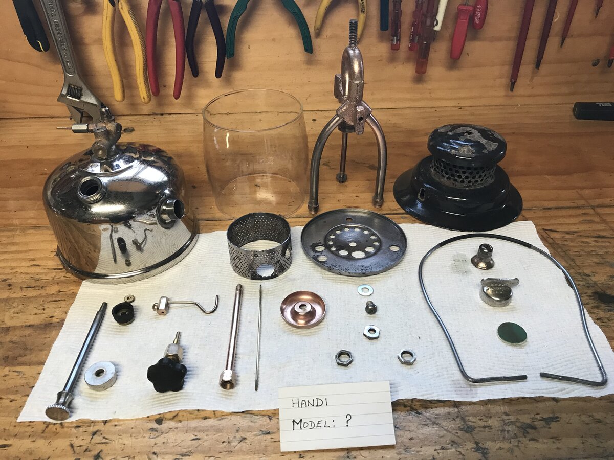

    The Fettle

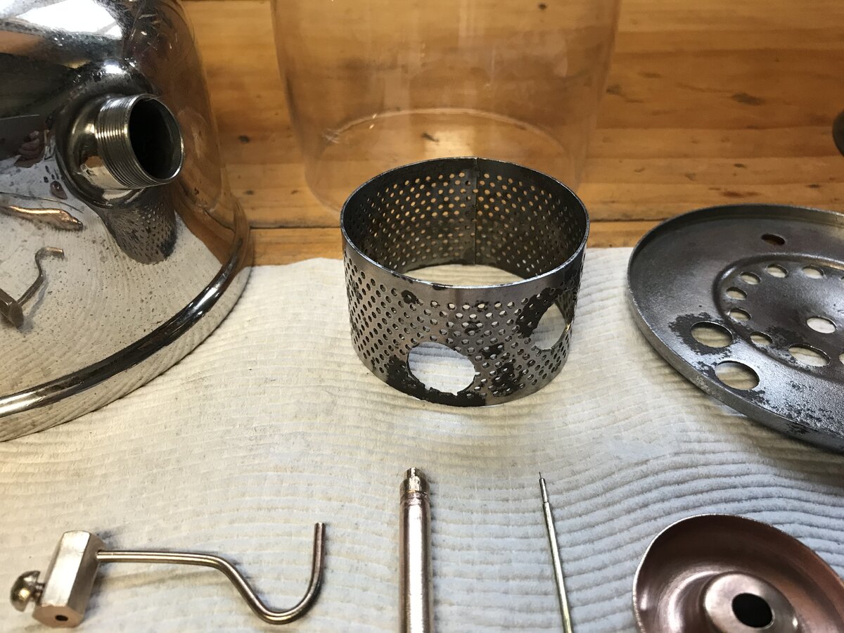

    The lantern was dismantled into its various components and cleaned. Excepting the glass globe and fount, all parts were immersed into vinegar bath for about 1 hour, removed, rinsed and brass brushed clean. The generator was dismantled and heat / quenched three times removing built up carbon deposits.
    The parts were then rinsed in clean water and put into a sonic cleaner to remove any rubbish and dirt from inside of the generator, jet, burner and other related parts.

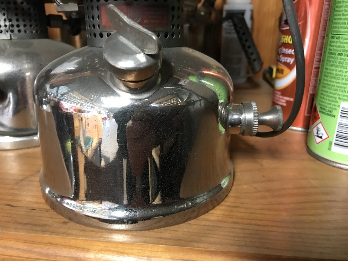

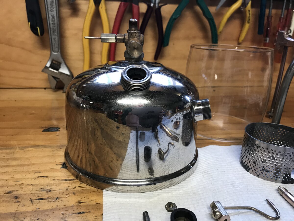

    The Fount (Tank)
    To preserve the original finish, the brass nickel plated fount was carefully cleaned with a hand detergent using a soft brush and then polished with Mothers Mag & Aluminium Cleaner. The gentle cleaning exposed the original nickel-plating work in quite good condition with just a few blemishes caused by age and use.

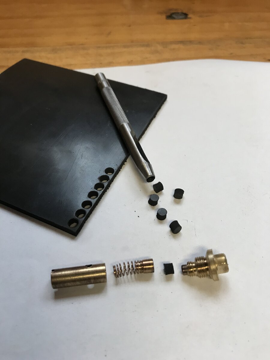

    NRV (Non-Return Valve)
    The sealing pip in the NRV was too hard and needed to be replaced. A new seal pip was punched out of 3mm thick Viton sheet and installed into the NRV.

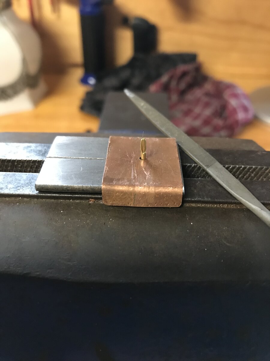

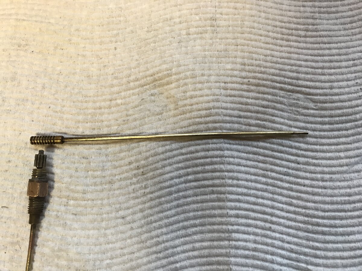

    Jet Pricker
    The jet’s pricker mechanism, although operational had the actual pricker wire missing.
    I manufactured a new pricker from 1/16” brass tube threading one end with a M2.0 die.
    The new 0.006” stainless steel pricker wire was crimped into the other end using my home-made for purpose crimping block.

    The various components were gathered together for final assembly.
    Assembly
    The HANDI lantern’s parts were reassembled into a lantern.

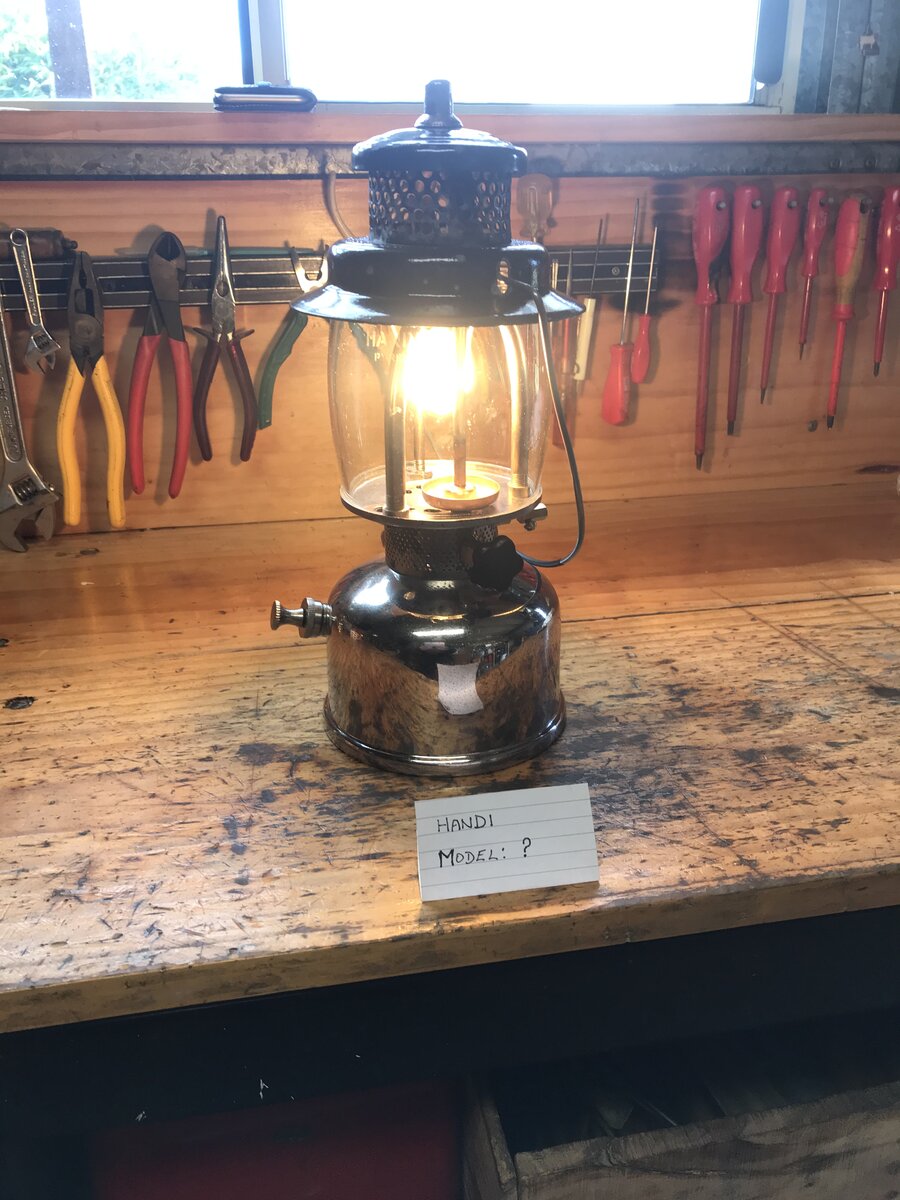

    The Money Shot
    The assembled HANDI lantern was preheated using methylated spirits in the preheat pan and lit.
    After the methylated spirits was almost consumed, about 12 or so pumps of air were applied until the mantle was lit and glowing.
    Pumping a further 60 strokes on a near full tank of kerosene, the lit lantern settled down and ran flawlessly for over an hour.
    After the hour’s test run the lantern was turned off by closing the control valve.

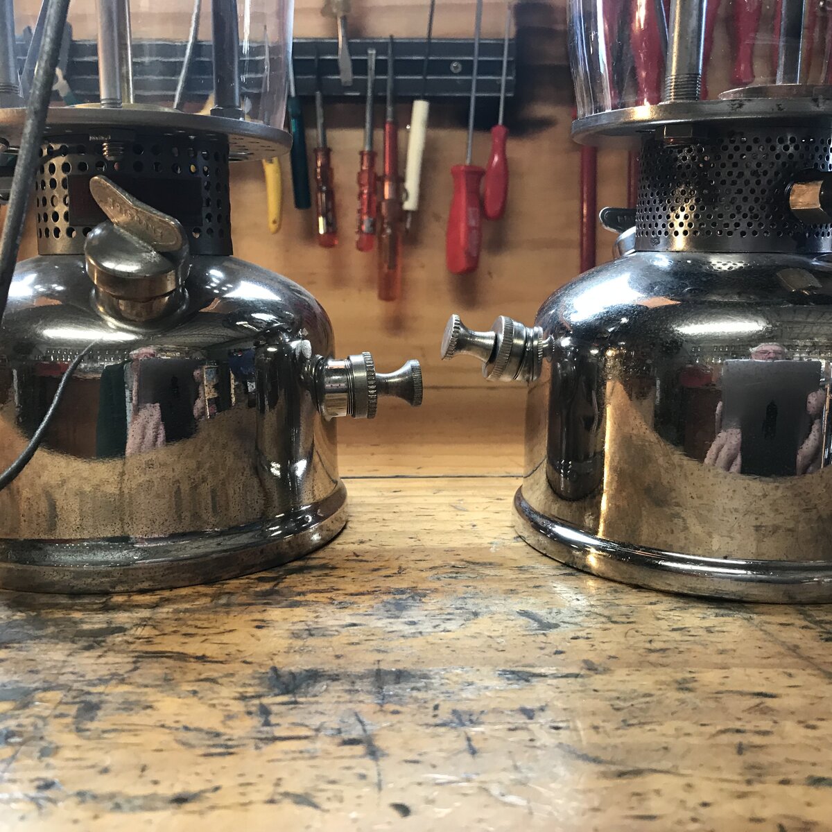

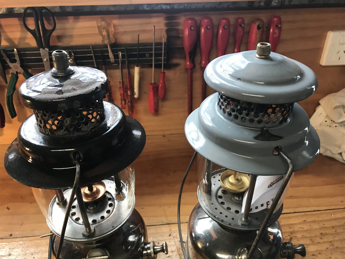

    I have a few HANDI Kero-Pet lanterns and this lantern has some parts that are different from the rest of my collection:
    The left-hand black topped lantern, perhaps the older version, has the following differences:
    In the earlier fount, shown on the right, the air pump tube is mounted slightly angled and nearer the fount’s top edge than the later fount version.
    The burner’s air tubes each have a threaded ferrule and nut to secure the tubes to the frame. The frame base has fewer air holes than the later versions.
    The frame to fount collar has the earlier micro holes allowing air flow.
    There is no hood locating pin on this lantern’s burner frame as in the later models.

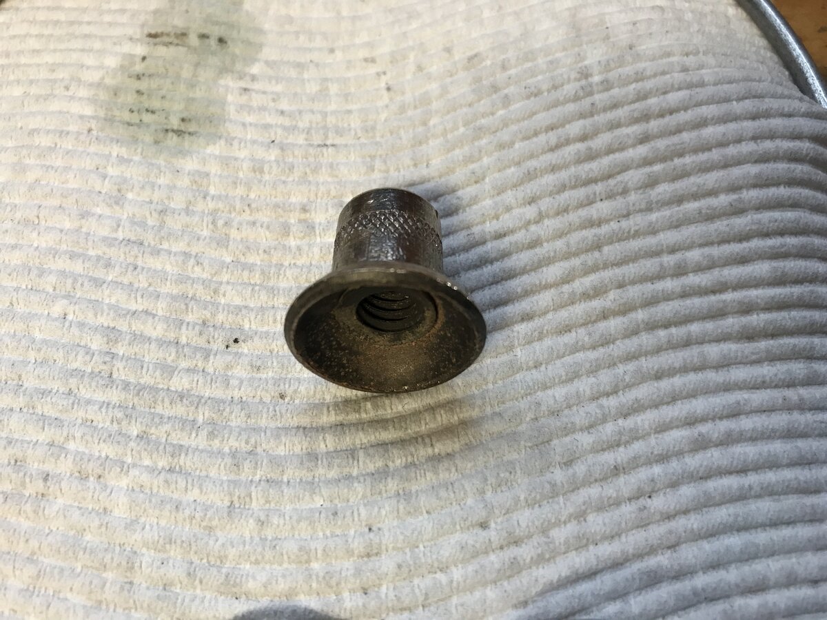

    The hood’s retaining nut, of a slightly larger diameter than the later versions, is nickel plated brass and is complete with a captured brass domed washer.
    The black enamelled hood has different dimensions to the later models.

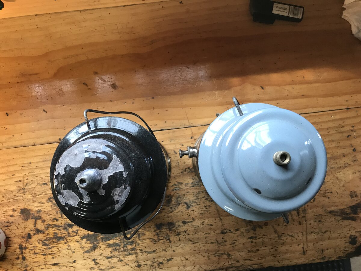

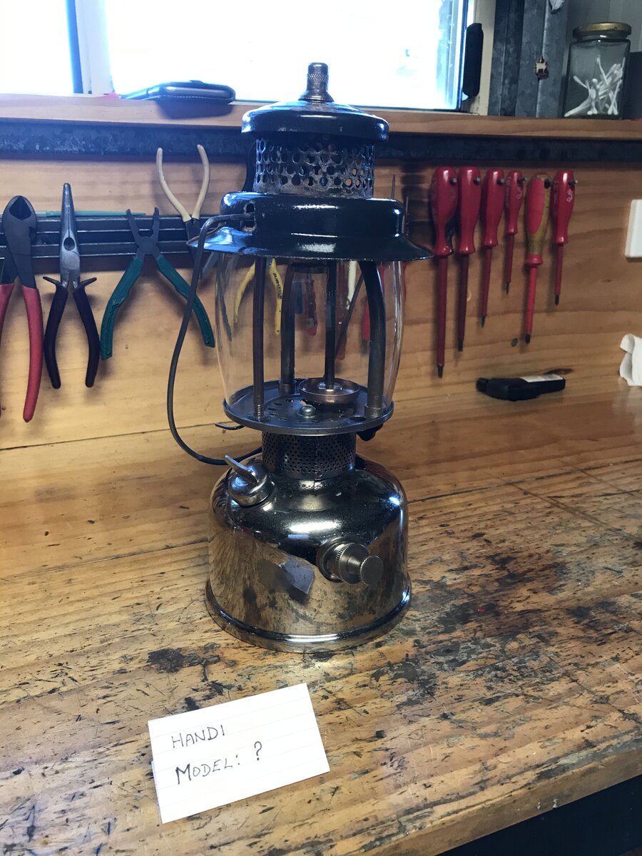

    QUESTION:
    What model is this HANDI lantern?

    That's a nice looking KeroPet model 3 you have. Quite an early version as well. The only thing missing to give a good date is what the flame spreader looks like and if there is any stamping in the burner casting. I've got the details at home, so it will have to wait until tonight (DK time).
  5. AussiePete
    3,368
    Hi @Nils Stephenson
    There are no stampings on the burner castings that I can determine.
    The flame spreader is a little unusual, the metal, steel?, mesh is recessed into the flame spreader’s housing about 6mm (1/4”).
    Hope this helps with identifying it’s appropriate age.

    Ok, now I have had a chance to look at my records. What you have is either a version 1 or version 2 KeroPet model 3. The biggest difference between the two is the flame spreader. Here are examples of a version 1 and version 2 flame spreader respectively.
    The version 1 had a ceramic flame spreader insert and the version 2 had a small diameter wire mesh insert. From your description I would guess it is version 2. Without going into details, some of the other features of yours points to a version 1 so this could be from the changeover period. V1 is from about 1940 to 1945 and V2 from 1945 to 1947. That would make your 1945.
    Edit: I've just had another look at your photos and can see there is a horizontal patent number in the burner casting. That confirms it is a version 2.
    BTW, the grey top one is probably a version 10 and from the mid 60s to mid 70s.
  9. AussiePete
    3,368
    Thanks @Nils Stephenson
    My burner is identical to the second or version 2 as shown in your pictures.
    Yes, I do now see the patent number on the burner manifold’s casting, I don’t know how I missed that, getting old I suppose.:shock:
    This would confirm that it’s a version 2 KeroPet model 3 built approximately 1945.

    @Nicholas Aslanides in this post @AussiePete has used 2mm brass tube so no need to drill. He then crimped the pricker wire into the end of the tube.
