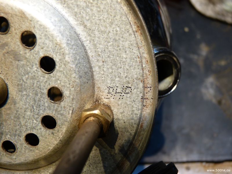

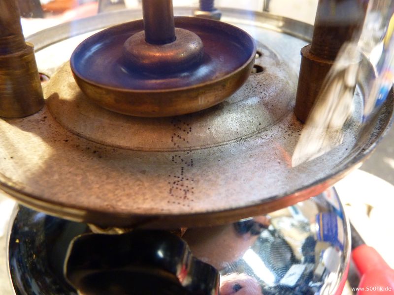

    A few years ago I got this lamp. I just cleaned it roughly, replaced the pump valve and tied up a mantle. I noticed that there are numbers printed on the bottom of the frame. Is this so original? It looks quite modern and I recognize "BHP Z..." and "JAN-200". The surface seems to be galvanized.

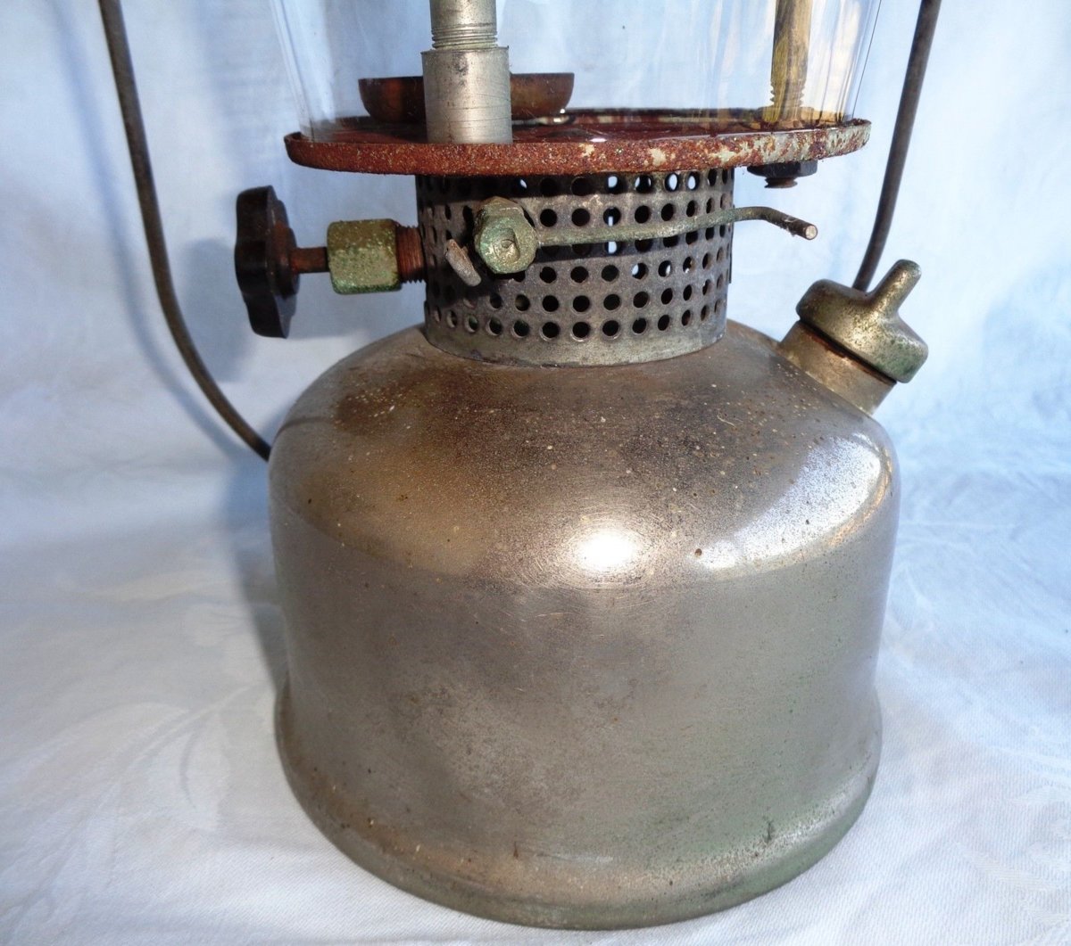

    That's an interesting globe cage base. What diameter is the glass? I am guessing that someone has made a new base so that standard size glasses can be used. The collar looks to be chrome plated as well. They were originally tin or zink plated.

    G'day Leo, I haven't seen one like it before. The hole pattern is very different and the pressed center looks more pronounced. Handi ceased production of new lanterns in 1990 . So it wouldn't have been originally on the lantern.
    When Handi Albert purchased the company in 2001 he was making some spare parts, maybe it was one of his plates?

    I agree to Nils: the base plate looks very much DIY. It is rolled, not pressed. And the small holes are drilled, not punched.

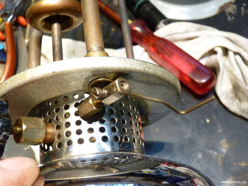

    I'm wondering why the handwheel is so near to the plate that it can hardly be operated. Maybe for the reason to hold a larger globe. So my guess ist that they just may just have used a piece of tinned steel sheet that was available to form the plate.

    Even though it’s rough, is the lettering hand drilled or stamped?
    BHP could be the mining company. ZI could be zinc?

    A few years ago (~2013) I got the lantern from the widow of an unfamilar collector from southern Germany together with some other lanterns. The supports, or air tubes, seem to be extended, the bushings on the support frame appear handmade.

    I agree with Tony - BHP zincalume (zinc coated steel sheet).

    If Pete and I are correct about the metal, it’s likely the modifications were down in Australia.

    That is close enough to be the standard Px (or clone) glass size. The standard Handi glass is 100mm in diameter (at base and top) and 110mm high. Obviously a different base made to fit the more common glass. I have an idea I have seen these bases at Albert's place the times I have visited him.
    This is actually the last style of bushing that was used from 1976 until they closed. The frame was usually plated, but that could have been removed during the modification process. Here is a picture I have borrowed from the net at some stage.
    My info is that they closed production in 1983. I know lamps were made from parts for some time afterwards, but whether they were official production or not I don't know.

    Just looking at it the made up pieces look rough base plate holes drilled and not cleaned up .
    If you drill holes you think they drill the other way rough edges hidden inside collar etc .:rage:
    Even the ext bushes look rough sawn burr around top edge.:rage:
