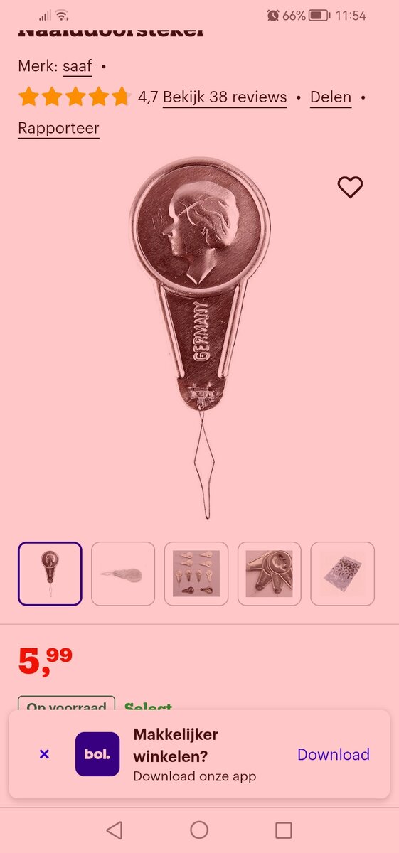

    I don't know your brand of lamp, but usually the picker can be loosened by unscrewing, it's a tiny, part,.
    I had a petromax lamp with the same issue, and I straightened the pricker, but after testing it, it was bent again, due to rough machining inside the jet, I smoothed the inside of the jet, and made a new pricker from a needle sewing treat thingy in my sewing kit

    That sewing item I showed you, is 0.15 mm thick.That item cost next to nothing

    Loe, thanks. I can source one of them, I am sure.

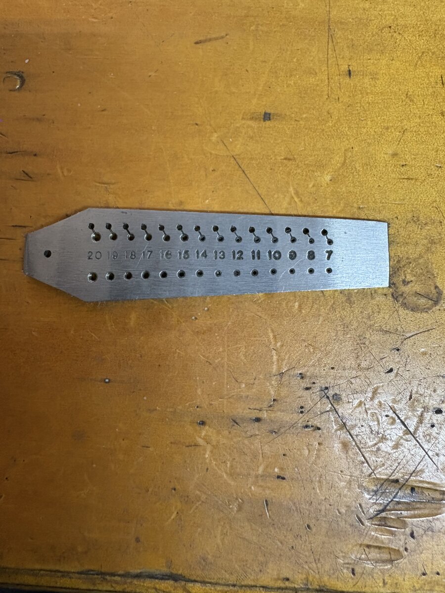

    hi there , if you can get one of these jewlers tap and die set from eBay. It will help with a lot of things.

    Darryl, thanks…a set just arrived in the post today, along with brass tubing…2mm and 1mm. The 1mm slides inside the 2mm tube, so I think I see how this can work. I assume I will need to file or grind down the diameter of the old rod to take the 2mm tube?
    can you recall what sizes apply to the inner and outer threads?
    I’m still waiting on hypo needles and some thin wire to arrive. I won’t start anything until I have wire that will fit into the jet. It is a tiny hole.
