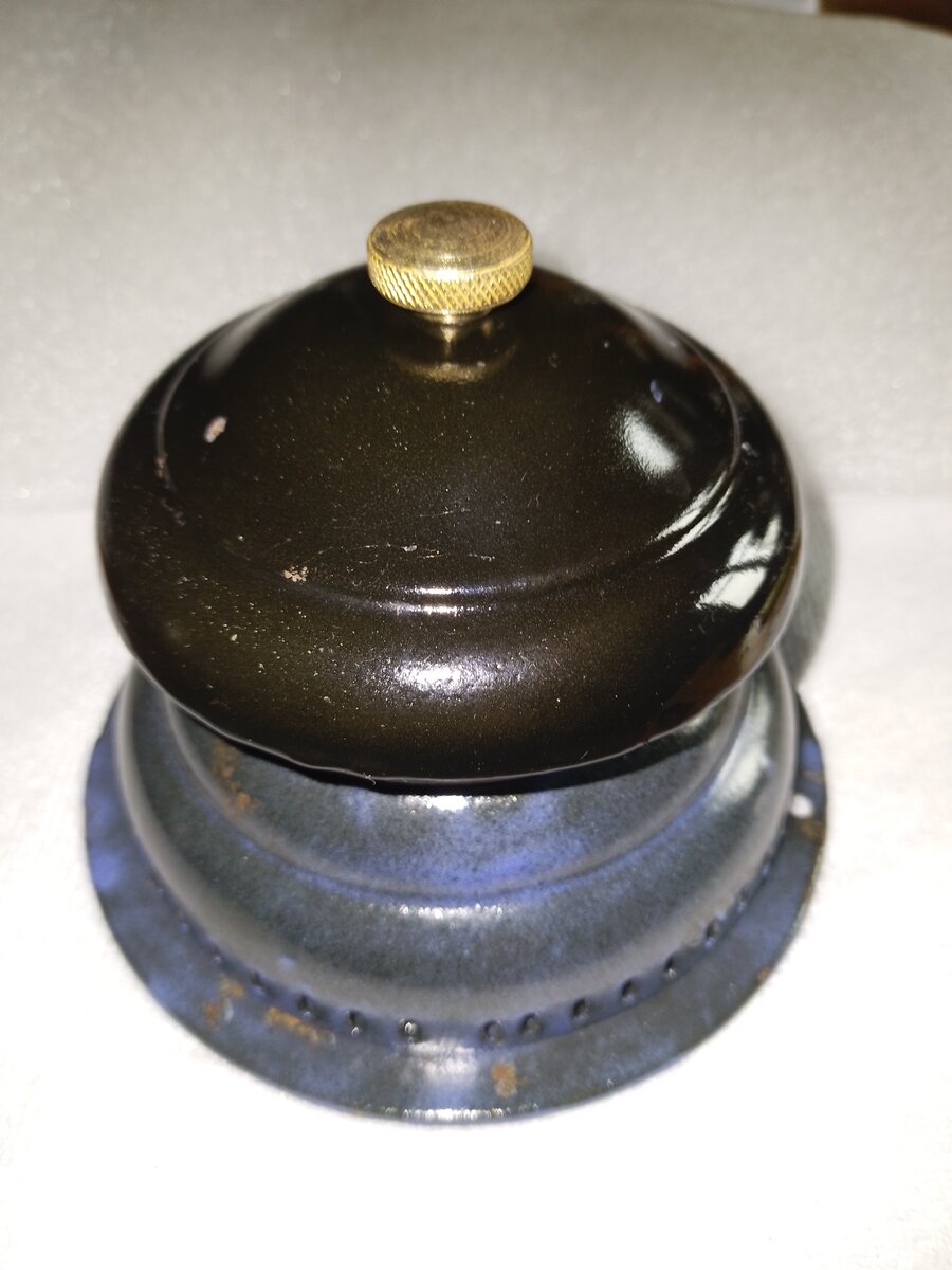

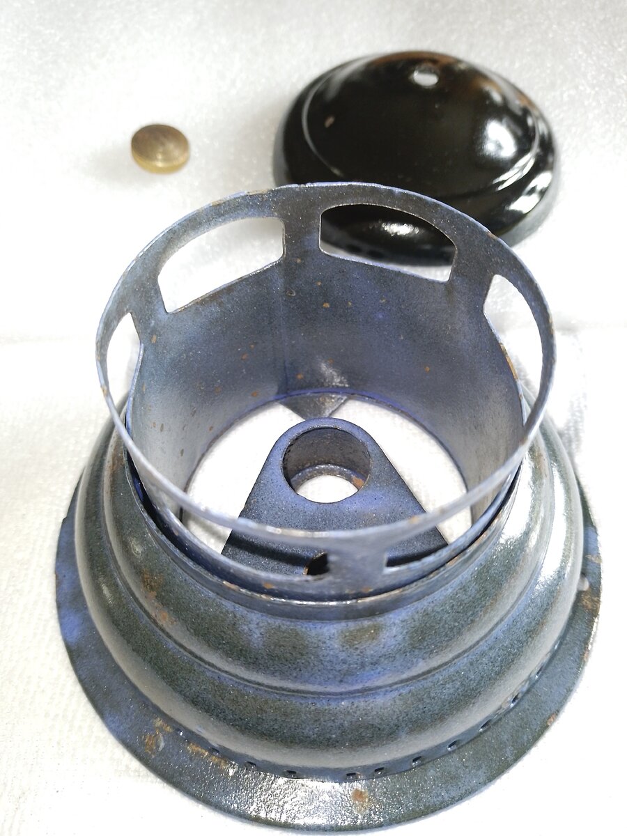

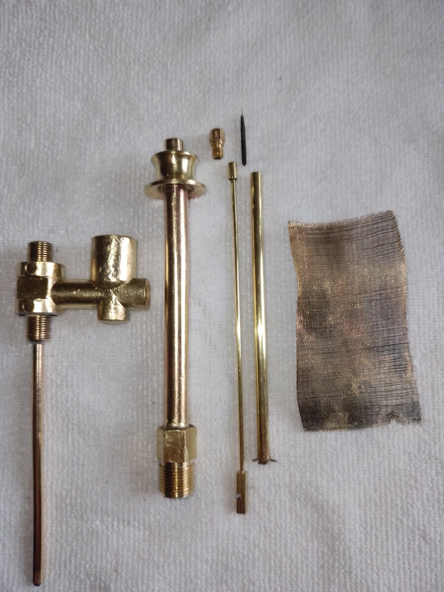

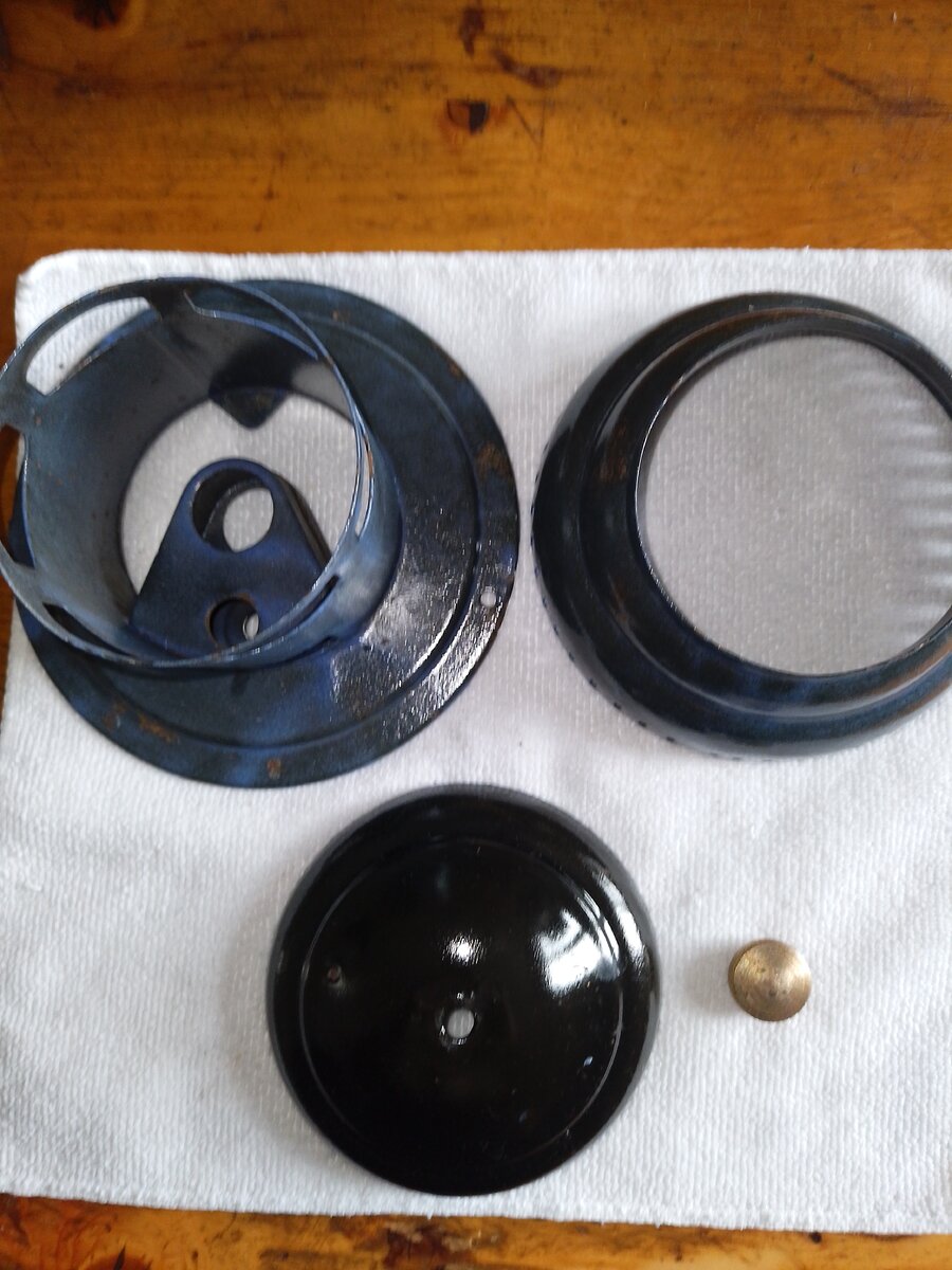

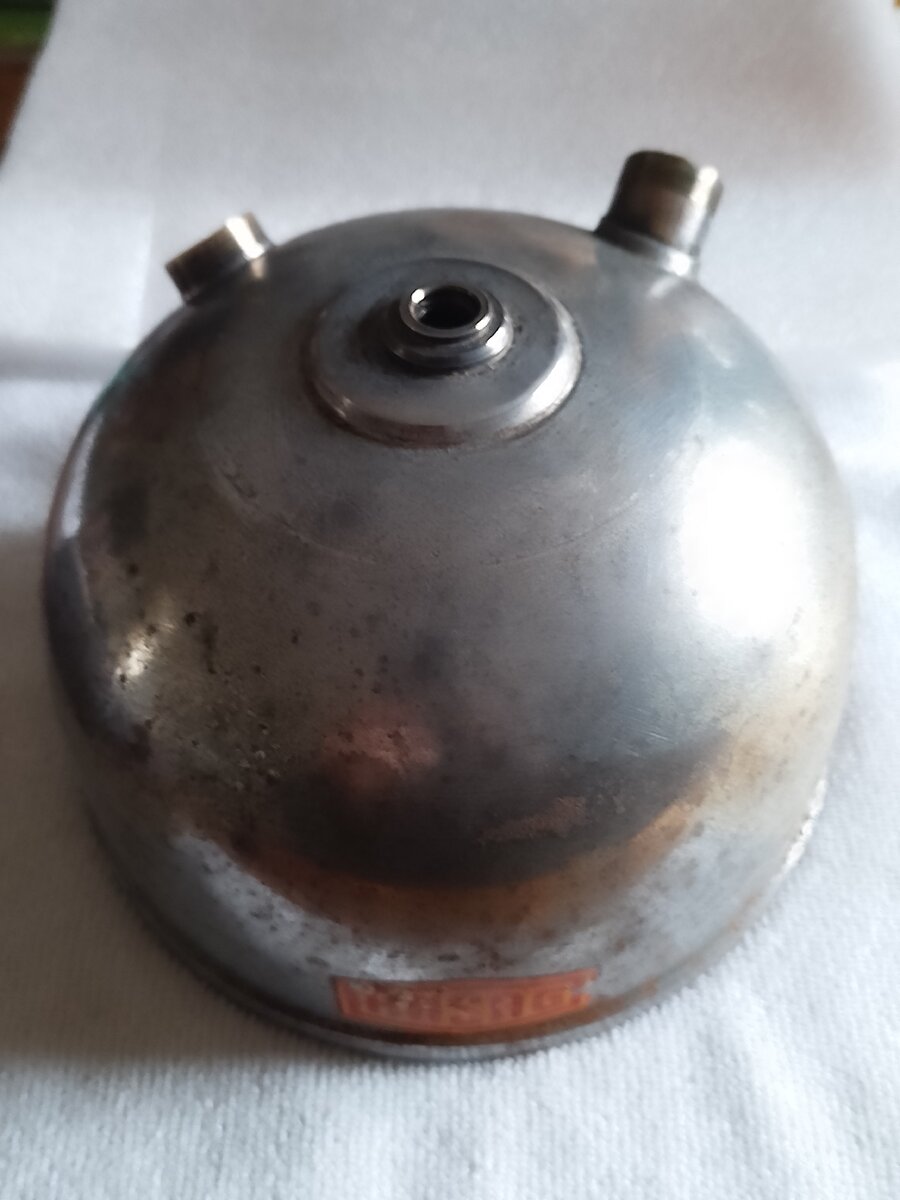

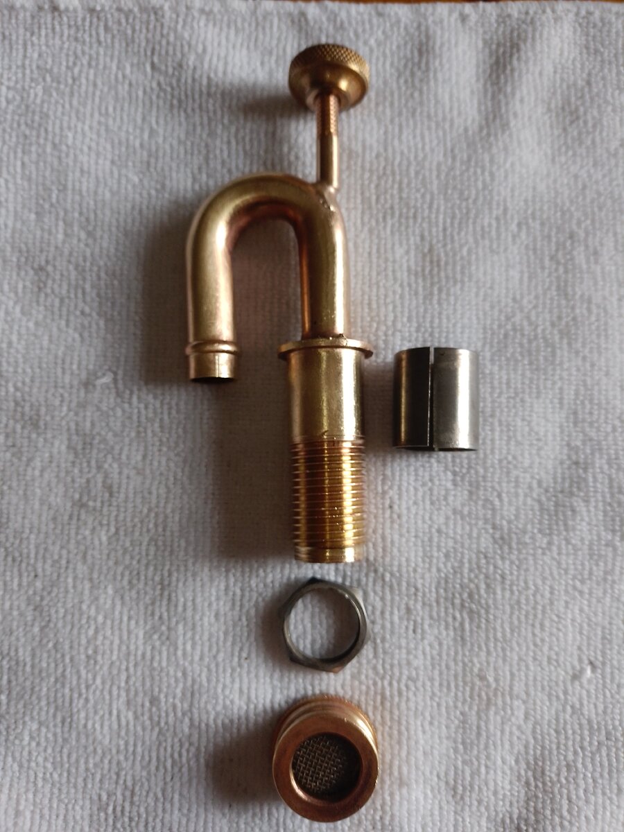

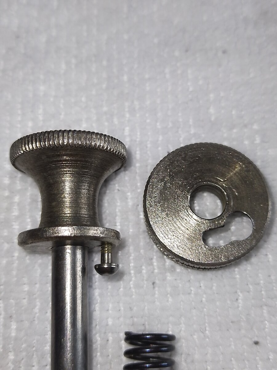

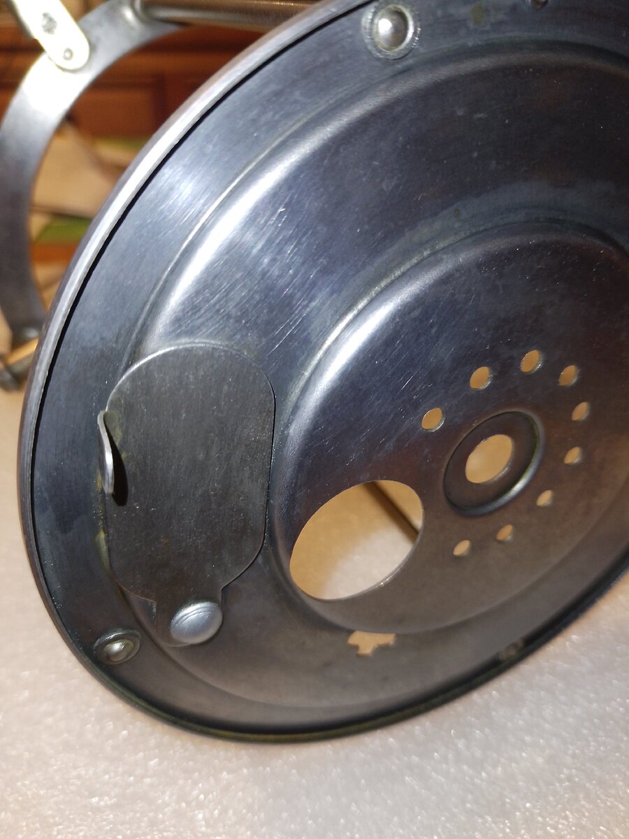

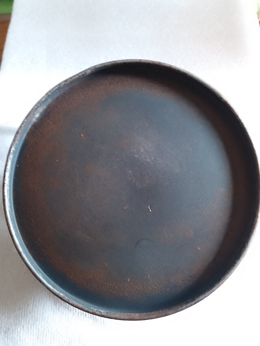

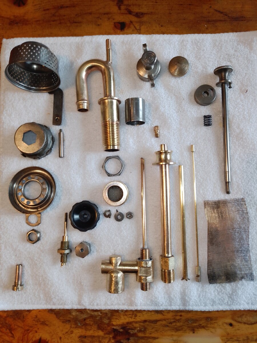

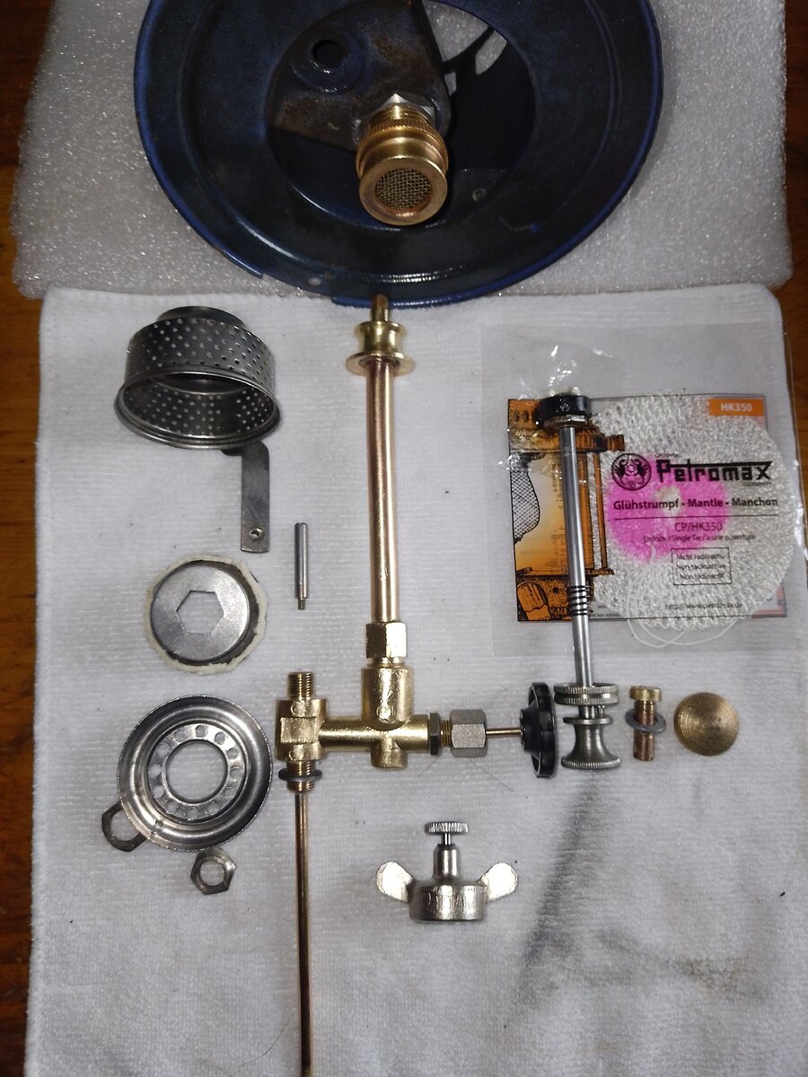

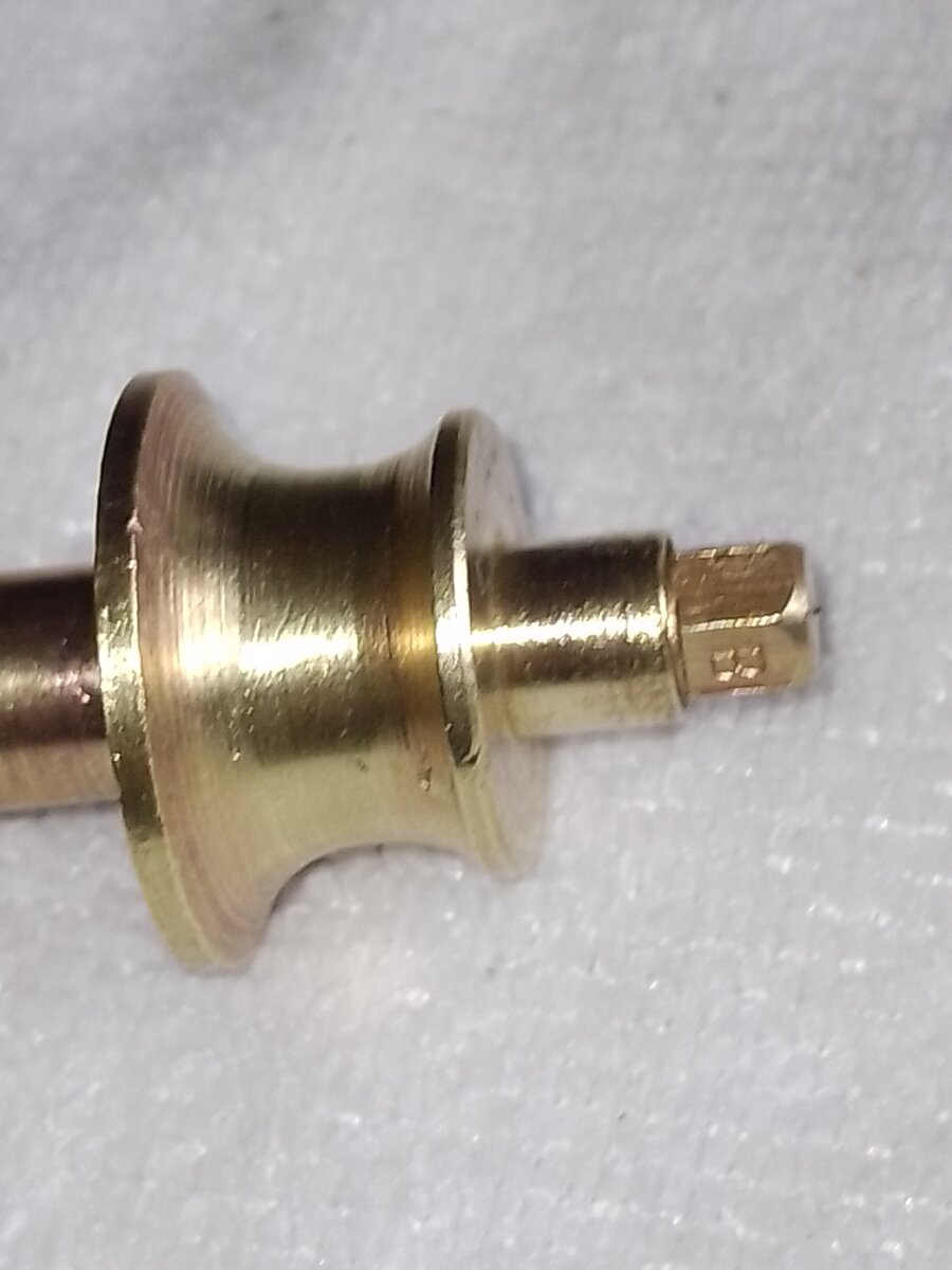

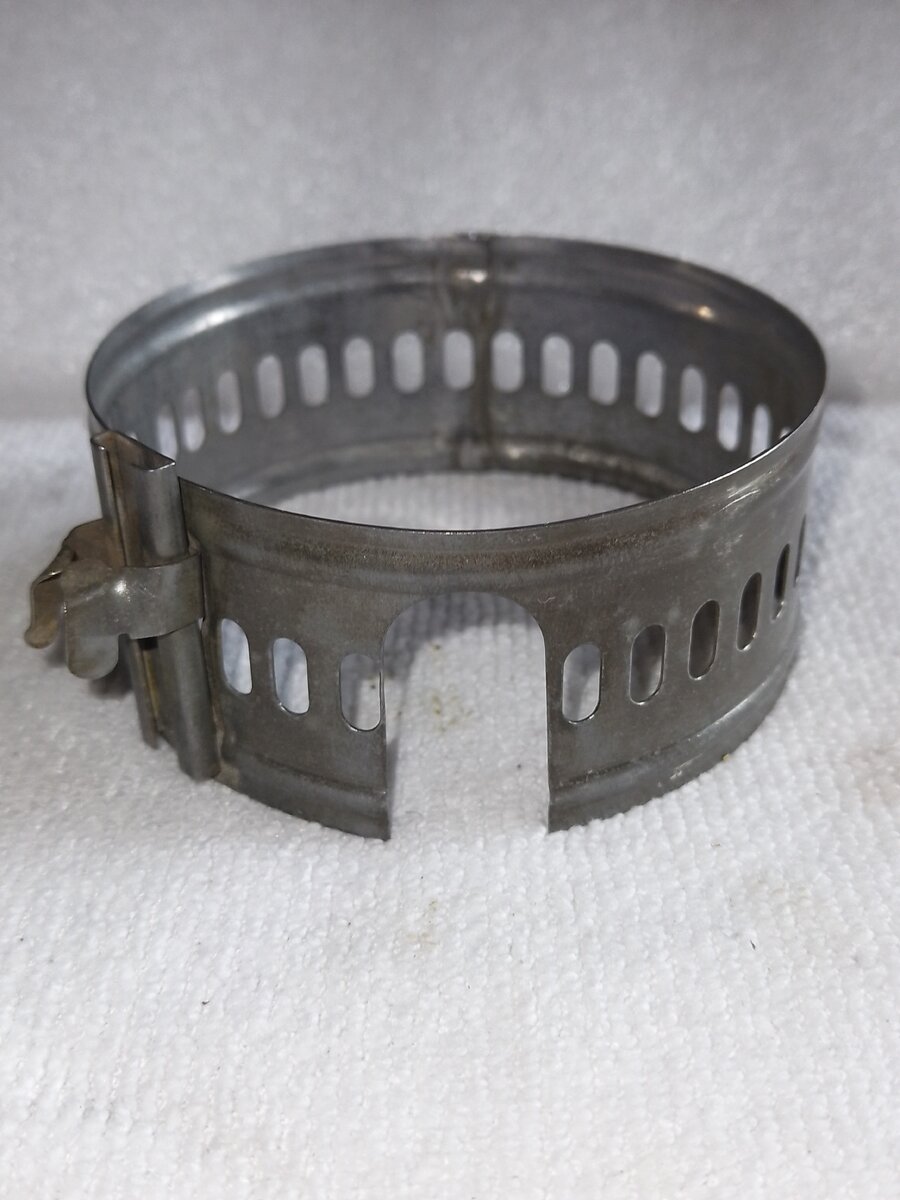

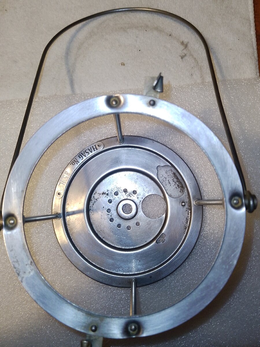

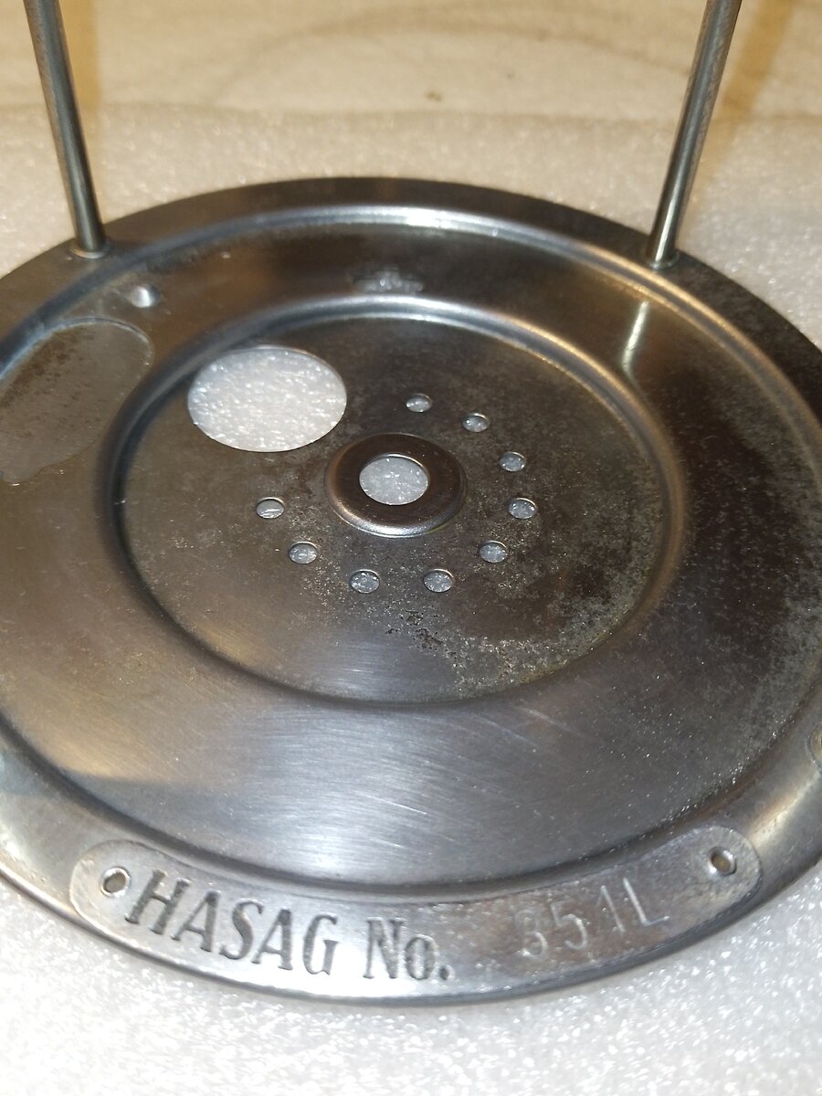

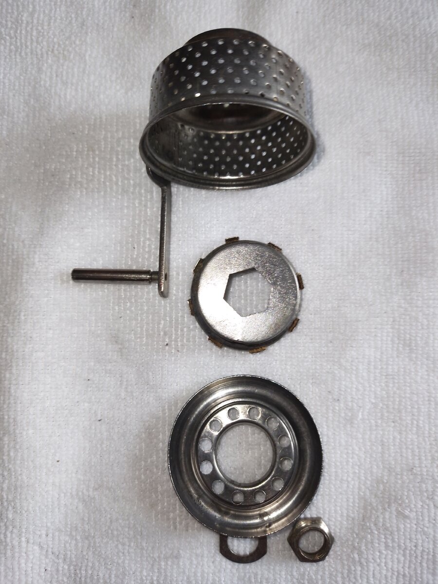

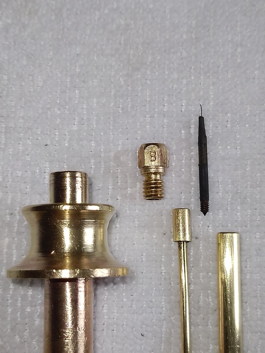

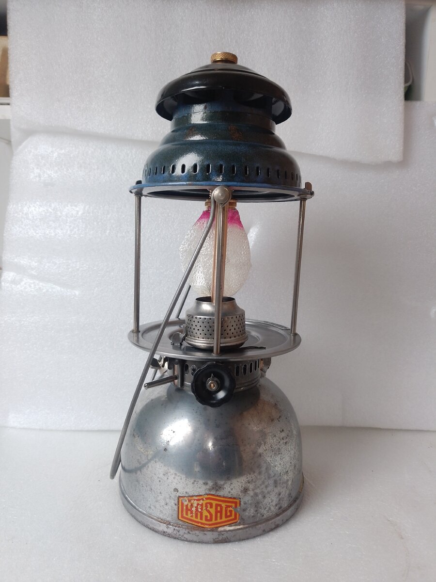

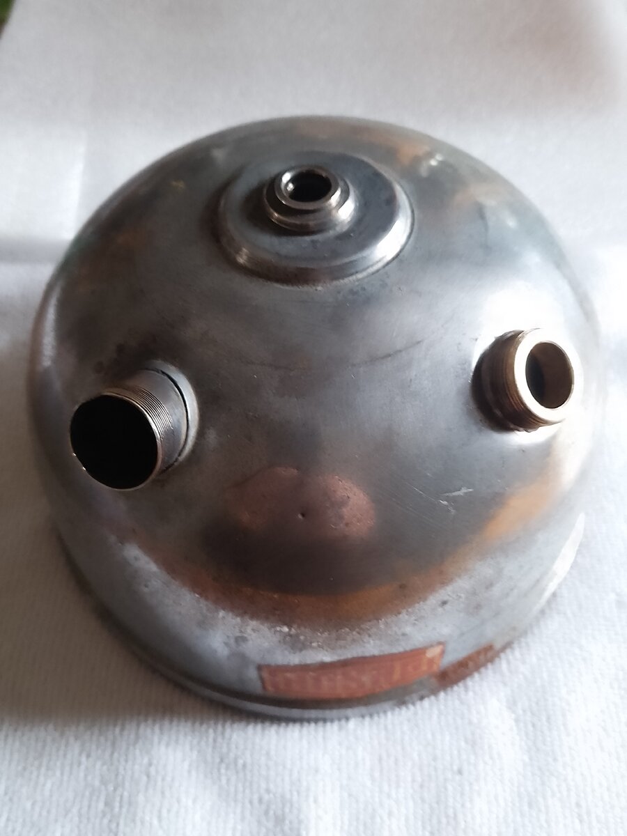

    Hasag 351 L 300 HK
    - old vaporizer type like Hasag 51 A or L made of brass.
    - the jet is marked with B = Benzin =gasoline/petrol
    - short ventilation slits in the collar
    - pressure vessel made of sheet steel
    - two yellow/red Hasag sticker front and back
    - only one nameplate on frame,stamped
    - All upper components are beautifully enamelled on both sides
    - cap without Hasag Logo
    - Unfotunately, the glass is missing.In one of the photos,I've placed a second Hasag 351 L next to it,which is identical in every detail . This one still has its original glass.

    A very attractive, economical, quiet, and highly reliable lamp!
    If I didn't have a lamp like this, I would definitely want one! Mine runs perfectly on both gasoline and kerosene, even though the nozzle is marked “B” for gasoline. I would be interested to know how large the different nozzle openings were.
    Thanks for the beautiful photos, Reinhard.
