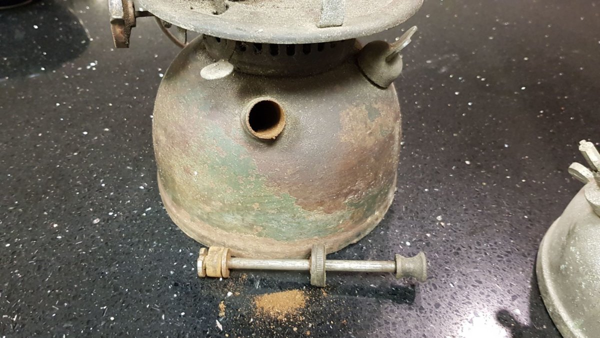

    Here are some pics of a lamp I found recently.
    Been hangjng a long time and badly beaten before it was put away.
    Looks like a 351L but there are no markings.
    Glass of course is long gone. Pricker wheel has been taken from somewhere else, ceramic burner is broken and the top filial also looks to be a replacement.
    Fount and cap appear to be painted steel as seen by layers of corrosion.
    I'm guessing it was a wartime build. The green paint suggests army. Found in Estonia.
    IMG-20180304-WA0002.jpg IMG-20180304-WA0003.jpg IMG-20180304-WA0007.jpg Was the handle replacement due to a war injury? The mind boggles
    IMG-20180304-WA0008.jpg IMG-20180304-WA0009.jpg IMG-20180304-WA0010.jpg IMG-20180304-WA0011.jpg IMG-20180304-WA0012.jpg IMG-20180304-WA0013.jpg
    This old soldier had a pretty girlfriend to keep him company over the last few decades. Found with a Hasag 42 IMG-20180304-WA0005.jpg

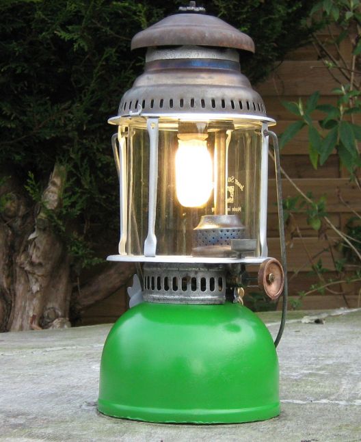

    This lantern is now in the U.K. and after a bit of fettling, it looks like this:
    Henry.

  18. Reinhard Germany
    Oct 15, 2018
    386
    @Henry Plews
    Congratulation ,the lamp has become beautiful.:thumbup::D/
    I can Identify some parts.
    1.)The tank comes from a 2nd generation MEWA. You can see it at the bad weld.
    2.)The collar comes from a HASAG 351L.From an older one.You can see it at the short slots (vents)
    3.)The design of the support frame I know only from Ditmar.
    4.)The preheater ist exceptional .
    Ecceptional because it's a mix of Ditmar and MEWA.
    5.)The larger sieve of the preheater still has the big diameter.As well as Hasag 351L or MEWA 1st generation.
    6.)The generator comes from a Hasag 351L or from a MEWA of the first generation.
    7.)The burner comes from a Mewa second generation.
    8.)The hood cap comes from a MEWA.
    Regards,Reinhard
