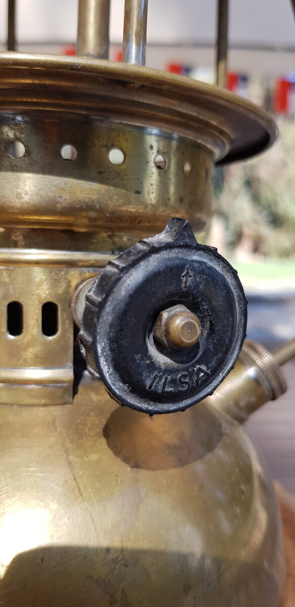

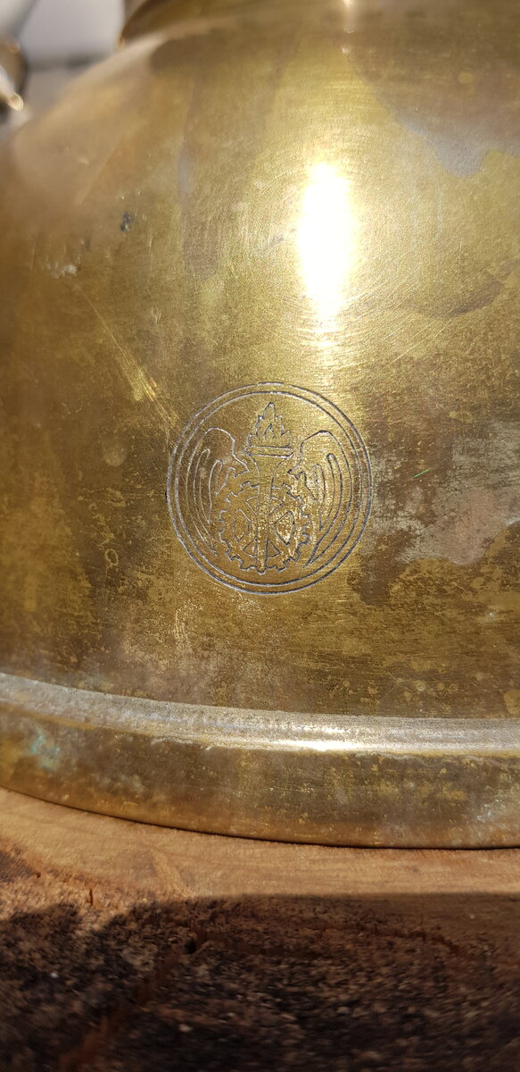

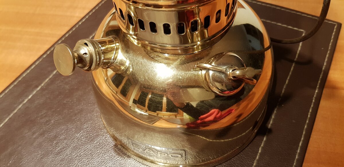

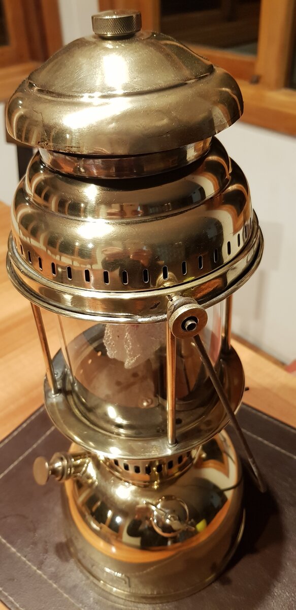

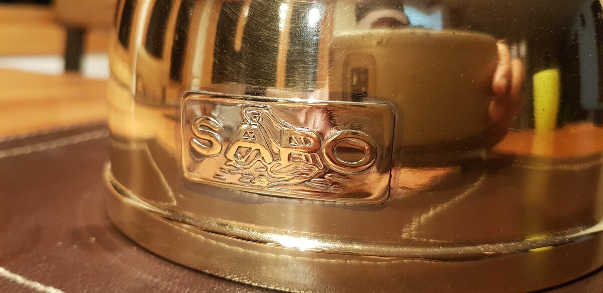

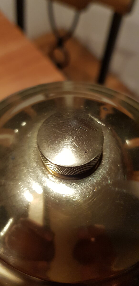

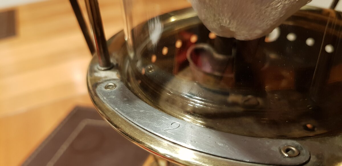

    20200920_112511.jpg 20200920_112431.jpg 20200920_112412.jpg 20200920_112335.jpg 20200920_112150.jpg 20200920_112630.jpg 20200920_112132.jpg 20200920_112554.jpg 20200920_112119.jpg 20200920_112533.jpg 20200920_112520.jpg 20200920_112324.jpg 20200920_112306.jpg 20200920_112912.jpg 20200920_112214.jpg 20200920_112106.jpg Hasag 52 Sapo, i share with you my latest finding, before they removed the chrome and apparently it will be easier to polish the surface and enjoy the color of the bronze, the lamp only has the old Hasag logo, the number 52 on the plate and a daring sheet of metal with an embossed frog and is glued or welded to the fountain. There is nothing written below the font and it does not have a Hasag logo in the highest part of the hat as I have seen in other Hasag 52s.
    I have the impression that it is a very old model, maybe from the early 20's, I want to know more about it.
    I want to disassemble and change the ruined parts, I do not know how to remove the valve from the bottom of the pump, and I do not know the dimensions of the rubber and seals of the other sections of the lantern, my experience is basically with Petromax lanterns. I would like to get the original knob, apparently it was black and with rounded edges, as it has one of ILSA lanterns that were made in Uruguay. The mystery of the SAPO was solved here. I have just got this lamp in Uruguay, the eastern country of South America, after investigating the origin of the frog stuck in the fountain, I discovered that it was a distributor in Montevideo, the capital of this country, which was dedicated to importing lamps and other related items with construction and agricultural machine parts called "SAPO", Variela Radio & Cia, Cerro Largo, Montevideo. (Source Neil Mc Ray).
    I would like to know more about this flashlight and I also appreciate your advice to bring it to life again.
    Cesar.

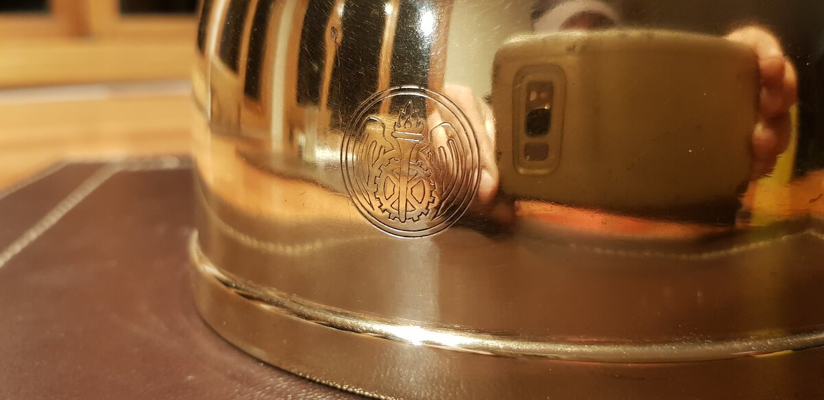

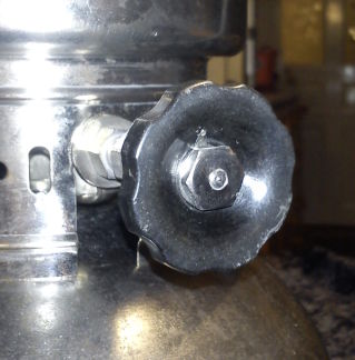

    Sapo in spanish means toad in english
    I had a sapo lamp

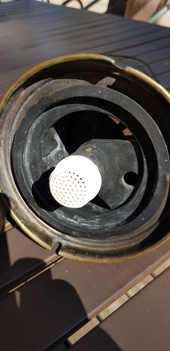

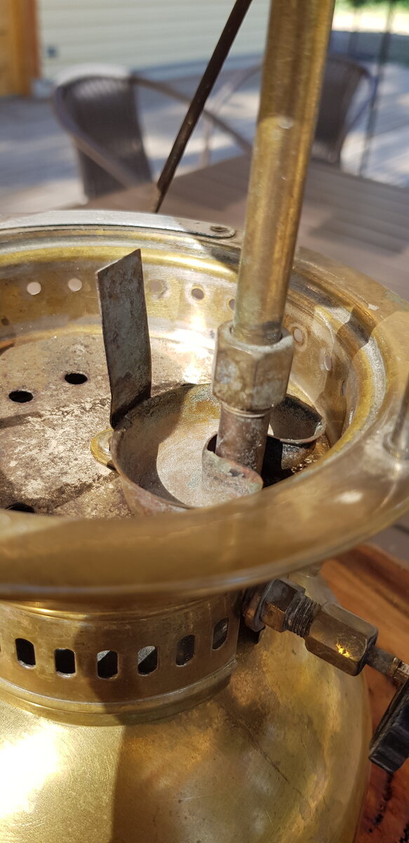

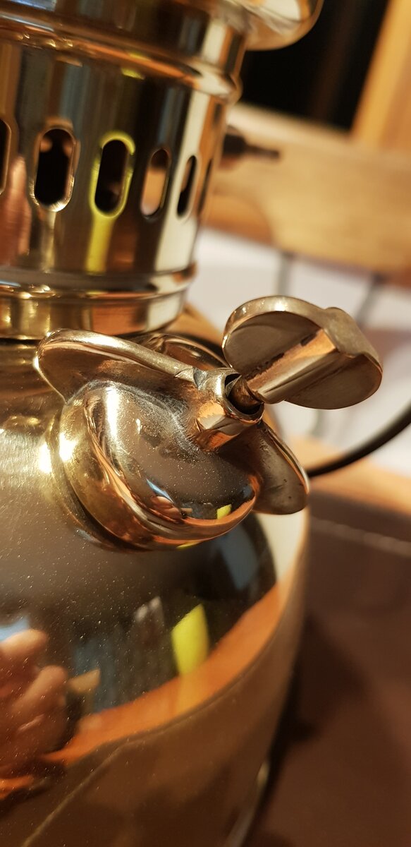

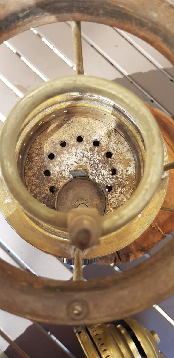

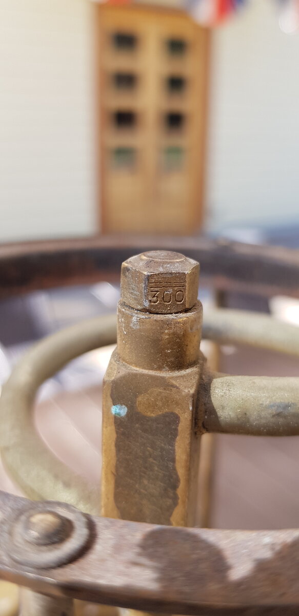

    Dear friends, today I started to disassemble the lamp with the intention of lighting the lamp but unfortunately it does not have the generator rod (K5212), needle (K5211), nut (K5213) and lower part (K5214) i don't know what its name is.
    Without these parts it will be impossible to light the lamp so I appreciate in advance any information on how to get them, I also need to get the knob, the washer and the nut from that section.
    I would also like to know how the mechanism works to prevent, when activating the pump, the paraffin rises from the fount, in the most modern Petromax lamps, there is a spring with a rubber that is activated by turning the knob allowing the paraffin to rise, In this lamp there is no valve submerged in the fount. I imagine that the lower part of the rod that is connected to the eccentric axis of the knob seals the passage of the paraffin, but for a good seal this part should be made of rubber ...
    Well, I hope you forgive my bad English and can guide me.
    Cesar

    Contemporary Petromax parts will almost certainly fit this lantern. However, minor modifications (e.g. length adjustments) may have to be made. The (upper part of the) vaporizer design is very similar, although the top part of the lantern with the mixing tube etc. is different. The most significant difference is that this lantern does not have a "straight" lower part of the vaporizer as you already noted. Therefore it lacks the fuel valve as Wim already mentioned, but it is not required because there is no torch preheater.
    Just use part no. 68 plus 104 (w/o part no. 191), seen on this site (scroll down a little bit for the better picture) as a replacement for the missing cleaning needle rod. The needle itself should be the 350HK type as the closest match to your lantern, and will probably be the hardest part to come by.

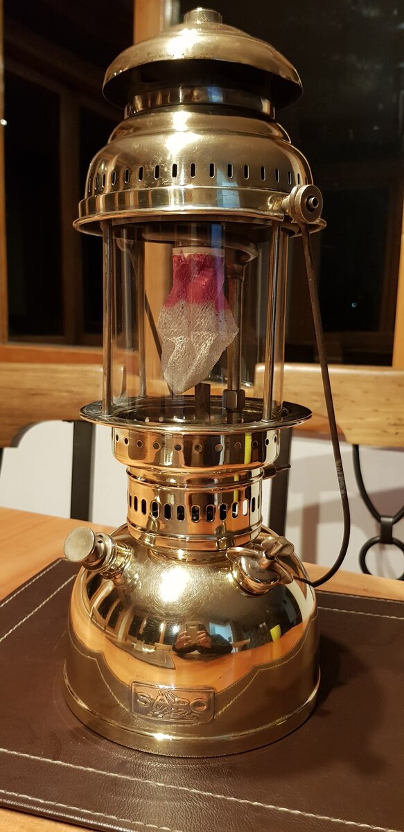

    20201007_210201.jpg 20201007_210308.jpg 20201007_205659.jpg 20201007_210124.jpg 20201007_205608.jpg 20201007_205614.jpg 20201007_205623.jpg 20201007_205628.jpg 20201007_205546.jpg 20201007_205556.jpg
    I have finally been able to light the Sapo lamp, I want to thank @Mackburner @WimVe and @Martin K. and all who were interested in my adventure. I comment that the rod, nut and the lower part where the eccentric shaft connects were donated by a Petromax 829 and only a small adjustment I had to make regarding the length, result, perfect.
    Then I dedicated myself to a general cleaning, with a bronze brush for all the pipes and thick bronze parts and with a cloth plus a chemical agent for the pond and other shells, brilliant result!
    Result for the soul, comfortable!
    It was really entertaining, after daily work I knew that a restoration session awaited me, that was an incentive.
    The original glass will be very difficult to get, although I would like to have some information on where to get some Schott Suprax, Jena Therm or another German that does not say Petromax so that it fits with this and other lamps that do not have it.
    I also want to get the corresponding knob and nut to finish this wonderful process with this lamp that is almost 100 years old and that looks and works as if it were 20 ...
