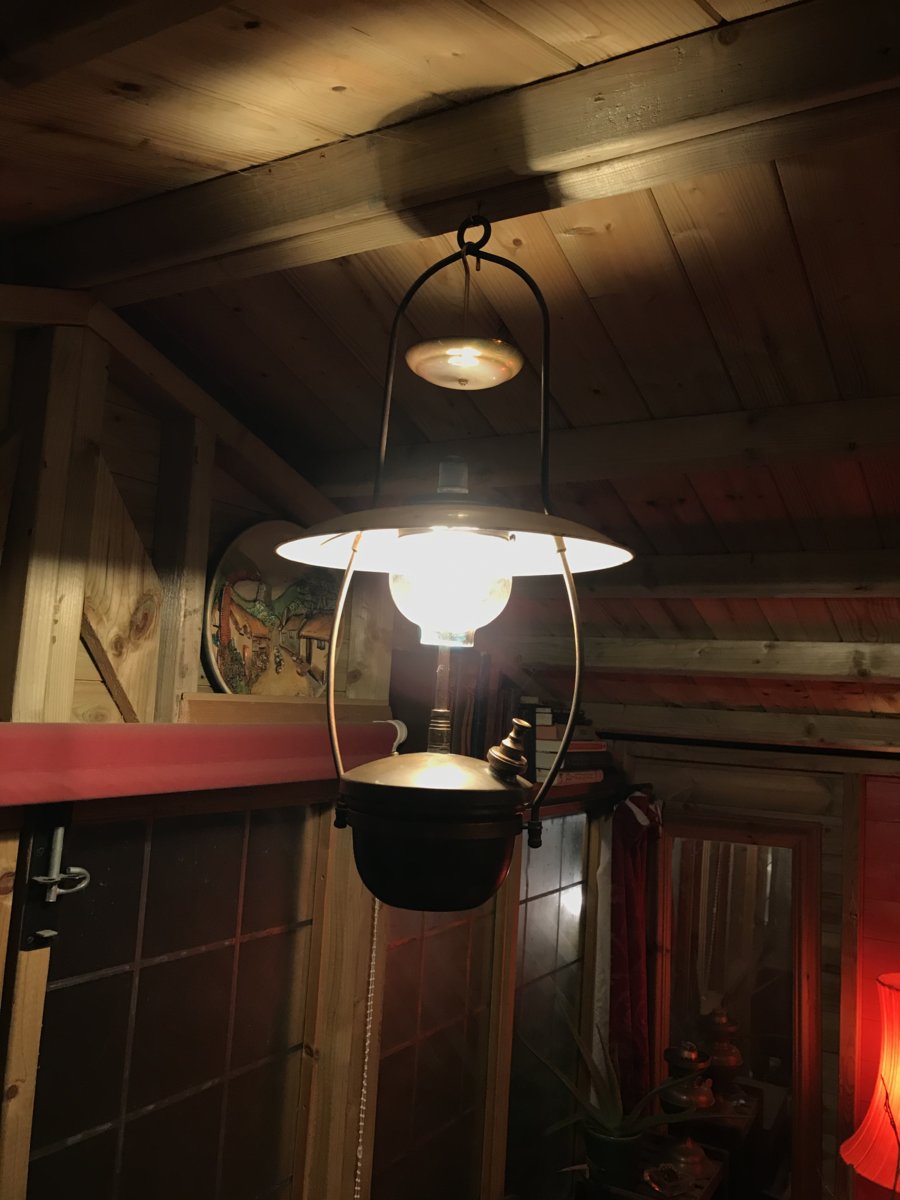

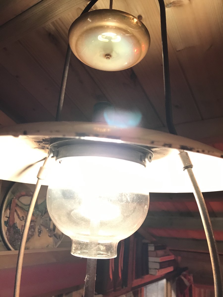

    E9158ACC-5329-422B-89D4-150D29F7825F.jpeg 1A2313BE-B6E2-4478-9248-F820EBAB5410.jpeg Hello fellow lampies,
    I’m writing this from the summerhouse in the garden where I’m enjoying a beer with the stove lit and reading a good book under the light of a KL80. I bought a repro heat spreader for it from eBay. It arrived from Taiwan within 4 days, which I thought was quite amazing. Anyway does anyone know how good these reprise are? It seems to do the job for now but it would be nice to get an original. Also what’s the difference between the round disc and the crinkle type I see in old photos? Is it just down to aesthetic preference? Regards
    9,057
    If I recall correctly, the heat deflector which you are using was introduced in the 1950's, but the disc is the same moulding as the enamelled steel heat deflector on the first X-246 lanterns.
    The crinkly ones are older, but they both do the same job.
    A fine light up!:thumbup:

    The new repro heat deflector has now tarnished after 3 hours of heat...
