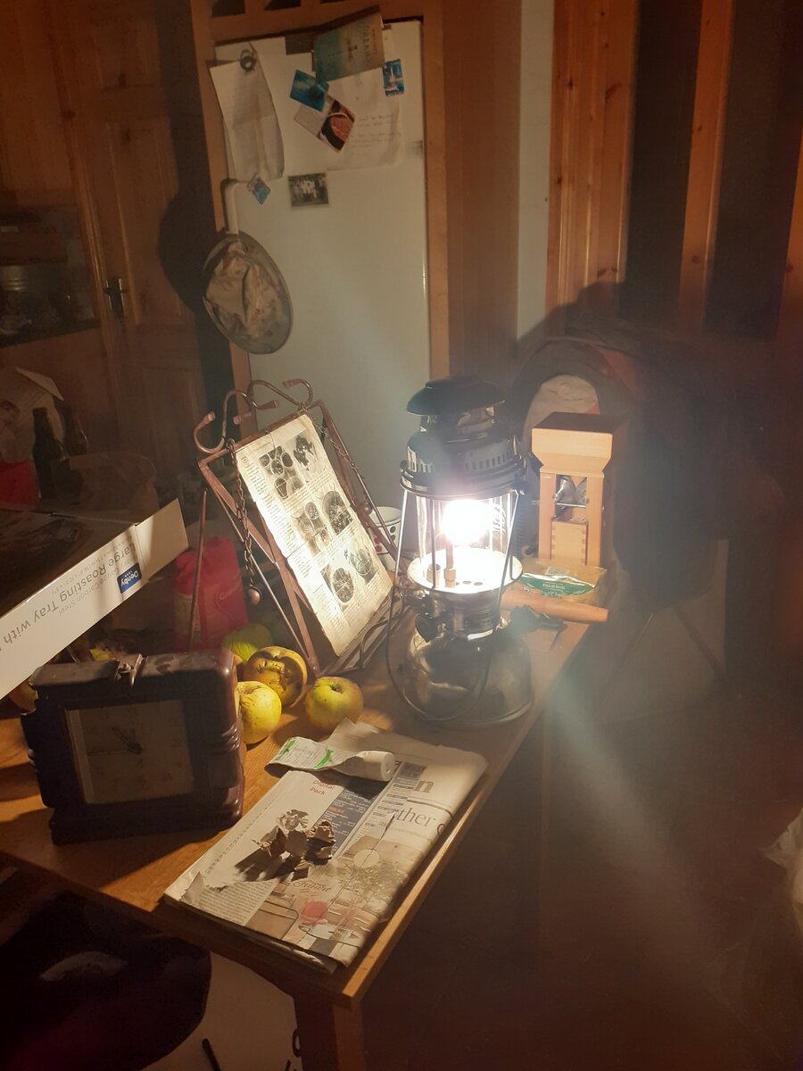

    Hello all,
    I am new to this site and relatively new to pressure lamps.
    I have been lighting my Petromax Rapid lamp and my Tilley lamp every morning and evening off the past few weeks.
    Roger,the man I bought my Tilley lamp from has helped me a lot and Bommels notes.
    I would love to find someone here in Ireland to help.
    My Petromax HK 250 lamp was working great but I want to check the vaporiser for a possible leak and the Rapid preheater may need to be cleaned.

    My Petromax hk250 rapid lamp was working great but I think there is a leak from the vaporiser and the Rapid preheater may need to be cleaned.
    I could do with some help with this.

    Hi Fiona. Regarding your assumed leak, remove all fuel and pressurise the tank. Submerge in water. Any leak if present it should be obvious.
    Preheater is a simple service, disassemble, clean it ensuring that all vent/fuel holes are clear. You may need a replacement crush lead washer for this task.
    By the way, your lantern looks large for a 250HK. It may just be the angle at which the photograph was taken. Also always remember to ventilate the space in which the lantern is being used for obvious reasons.

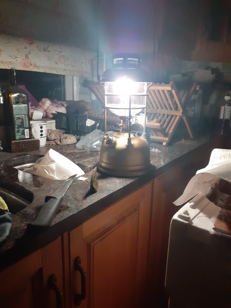

    I don't know much about petromax lamps but your tilley looks great and nice to see it burning brightly.
    Slightly concerned about the large knife in the foreground - do you have threaten it first before lighting?

    Thanks so much Keith,that knife I got in the meat factory I work in as a temporary veterinary inspector.
    I do a lot of cooking!!
    Have a lovely evening
