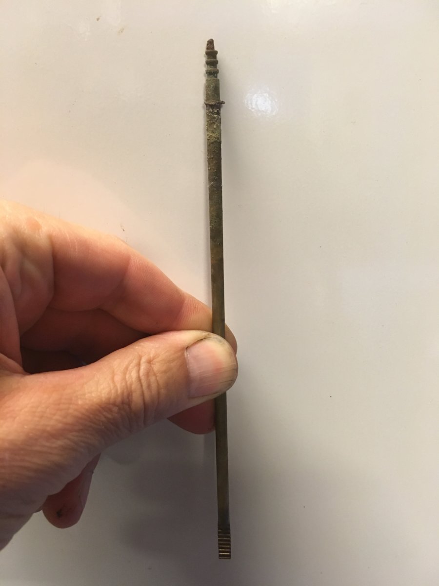

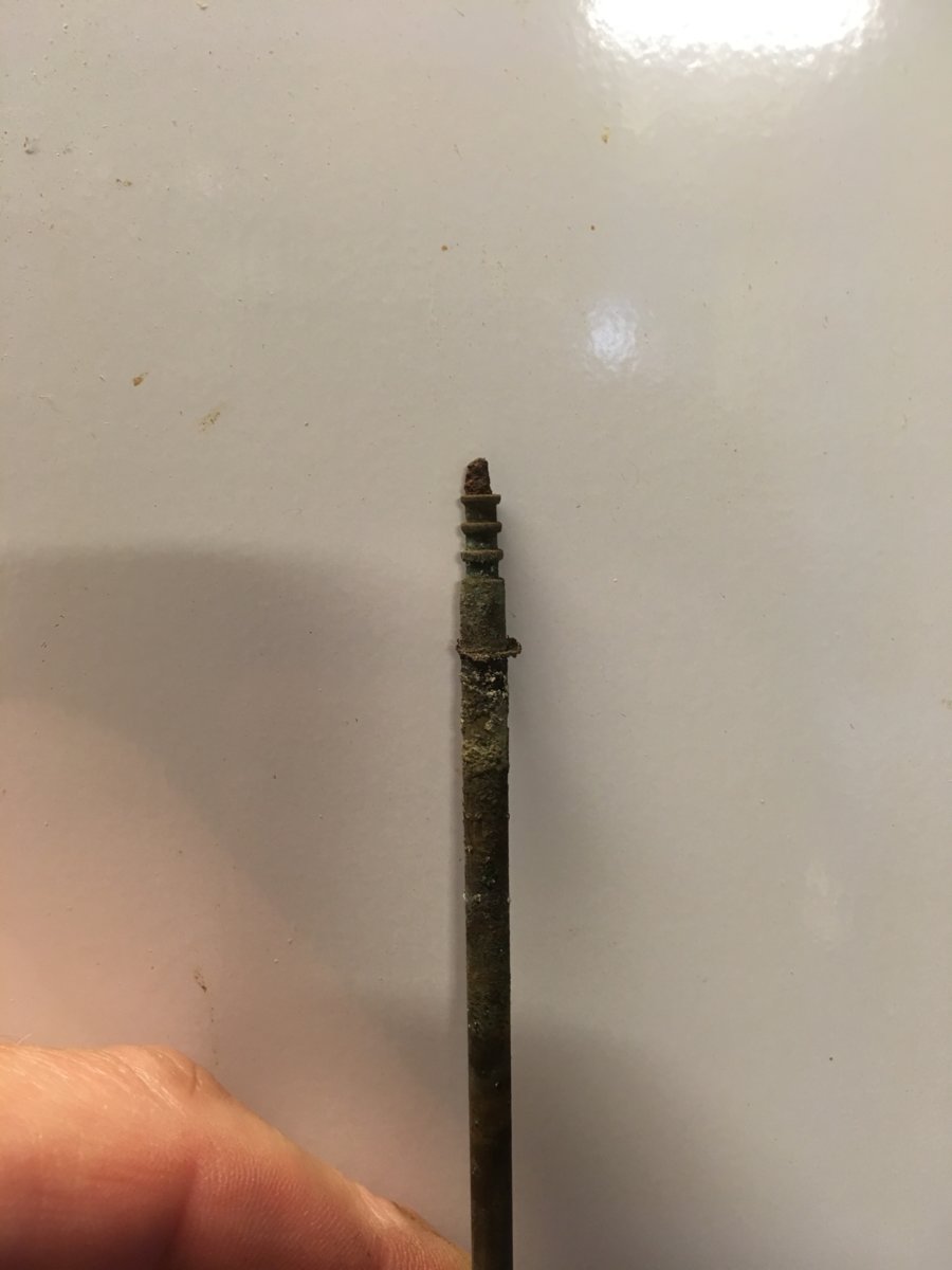

    I am now the lucky owner of an OK looking Primus 1320 (alcohol/meth lantern).
    I have dissambled it and overall it looks nice. BUT - as you can see on the pic - the jet pricker have seen better days.
    My questions are now:
    Is it possible to find a new/used one?
    Anything in particular I need to be aware of with a alcohol/meth stove?
    Thanks

    Harder, I do not see the alcohol needle or jet there under resevdelar fotogen as it is obviously not fotogen, but if you remove the air restrictor you can fit the fotogen needle and jet 6131 & 6145 and then you have a 1020 in all but name. The advantage is longer run-time. The 1020 is a brilliant design; it can run reliably from very low pressure and output all the way up to beyond its rated 300cp if you pump it up nice and hard. Use a 500cp sock type mantle for best results.

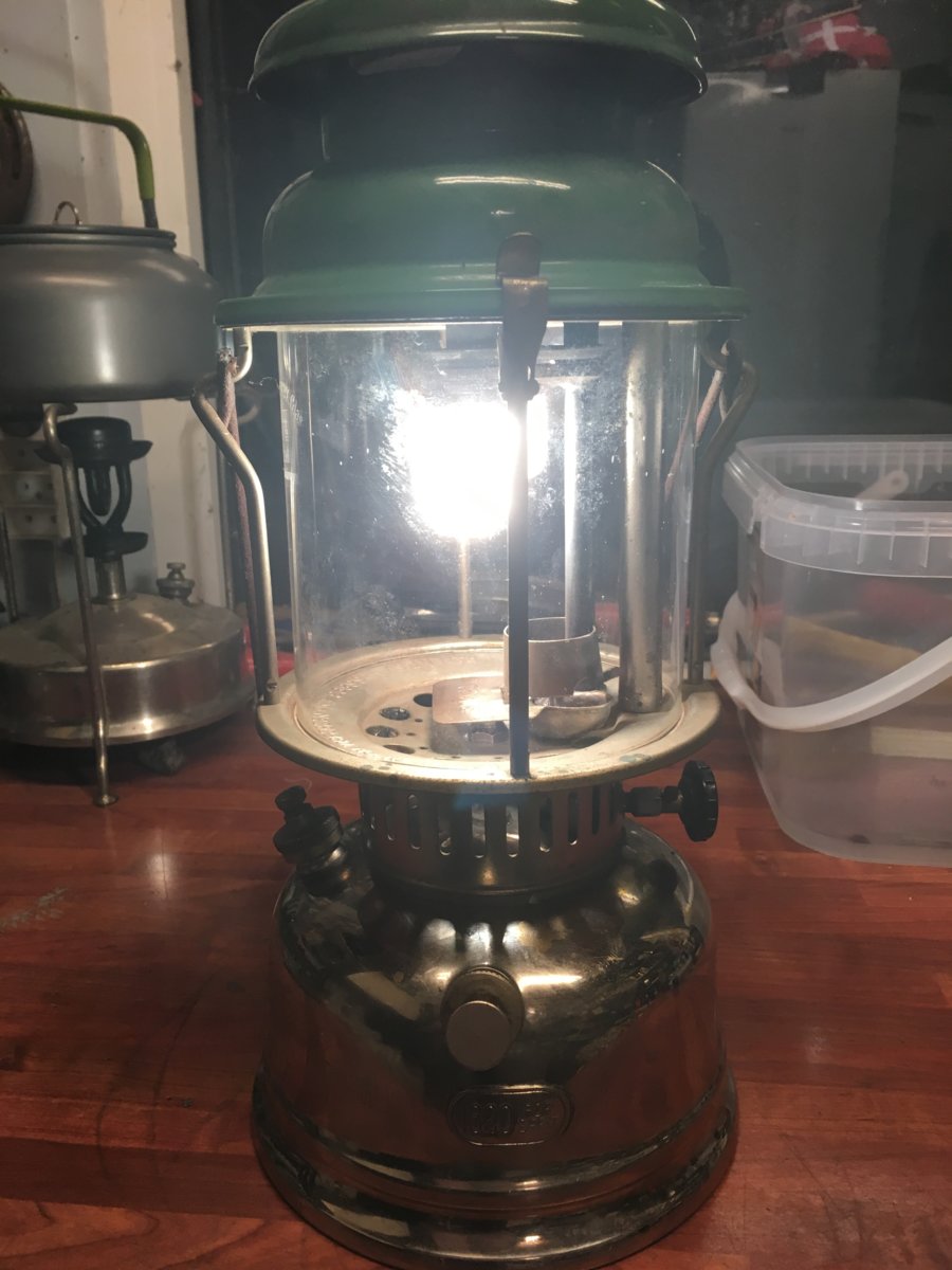

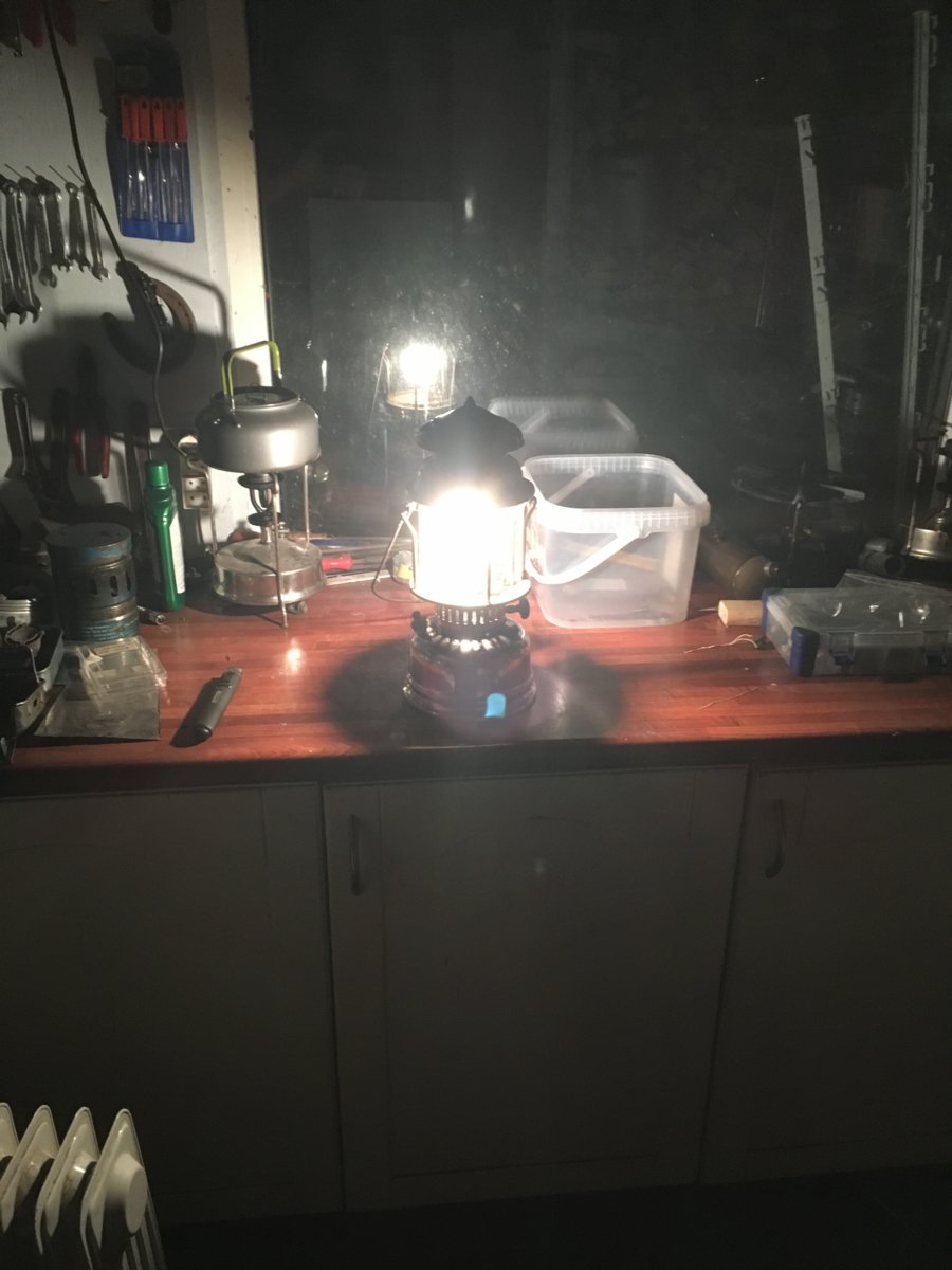

    DDE552FC-BBB3-4239-907B-EA4CF420FD1B.jpeg C6B5AD6E-2E7F-4297-A051-3058C52768E4.jpeg Thanks to @Nils Stephenson Flemming and Henning (two Danish stovies) I now have a nice working 1320 on Meth.
    Nils helped get the stuck NRV loose, Flemming brazed the broken hollow spindle-nut back to life with help from his lathe and repaired the top needle pricker while Henning was kind enough to supply me the tiny jet pricker itself.

  10. Nils Stephenson
    2,108
    Good to see it living again. :) I'm quite fond of the alcohol burning models.
    The mantle should be the same size as you would use for a 1020. The lamp is rated at 300cp, so any 300 to 350 cp mantle (of the bulb shaped type) will work.
