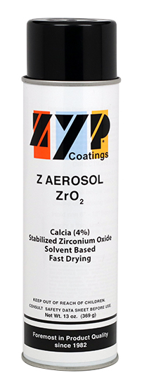

  19. MYN
    2,024
    Hi all,
    The following aerosol paint isn't going to be what you'd find from your regular shopping sprees.
    Here's one of the speciallized industrial-type paints that I'd believe would fare without problems on a lantern hood. I might consider this to be the real VHT paint.
    Colour is cream. Technical datasheet as attached:-
  20. David Shouksmith
    7,975
    :-k Apart from the safety information saying it's for industrial use only and that the cream colour will "gray out" after the first heating, is it a gloss finish?
  21. MYN
    2,024
    From my previous excursions into similar inorganic high-temp coatings with organic carrier liquids, those gray outs seemed to go away with subsequent heatings once the carbon traces burn off.
    It does not say anything about gloss finish but I suspect it won't be.
    I'd guess it'll be matte unless some glassy components get fused over it upon firing.
