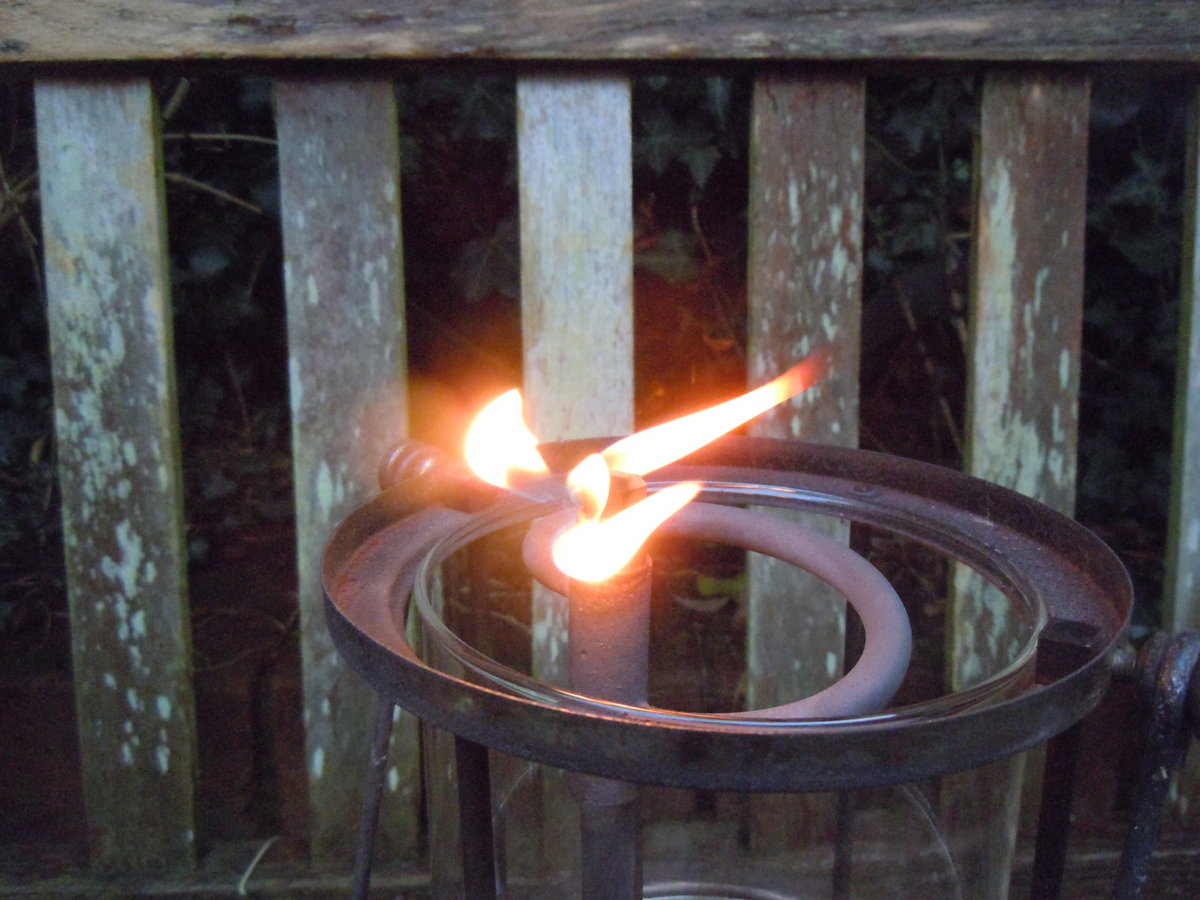

    Mine was behaving very well for some years but then started to blacken the mantle and show signs of rich running.
    Eventually I proved it was down to a bad leak between nipple and burner - like this....
    I preheated it - ran until it started to misbehave and then shut down using the valve and quickly removed the hood by using welding gloves.
    I lit the vapours which were remaining.
    All that flame is spare fuel burning. Picture is taken with main orifice closed by pricker...
    Tighten the nipple was all that was needed.

    @JonD , your Hipolito does not have a fuel valve, only a pricker control. The pricker is not intended to block the jet, it will only restrict it somewhat.
    The flames you got were not residual vapour but fuel under pressure from the fount.
    In any event, the cure was to tighten the jet.
