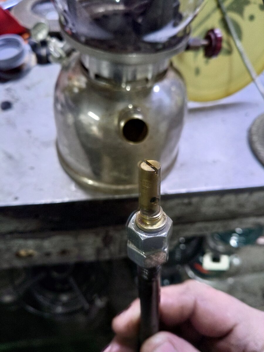

    Built this this evening out of a 3/8" diameter bolt along with a couple of nuts and a lock washer with the OD taken down just a smidge to fit in the pump tube. I already have tools to remove Coleman check valves along with AGM and Akron. It's a little bit crude but it seems to work just fine. KIMG5845.JPG KIMG5846.JPG KIMG5847.JPG

    Simple and effective. I like the spacer at the top to center the shaft.:thumbup:

    What did you make the spacer of?

    It is just a lock washer with the outside diameter ground down a little bit to fit the pump tube snuggly

    Very good! I built a nearly similar tool out of a square bar…so I can also drive it easily with a wrench

    Gave it a test this evening on my Optimus 930 and it works a treat! KIMG5851.JPG
