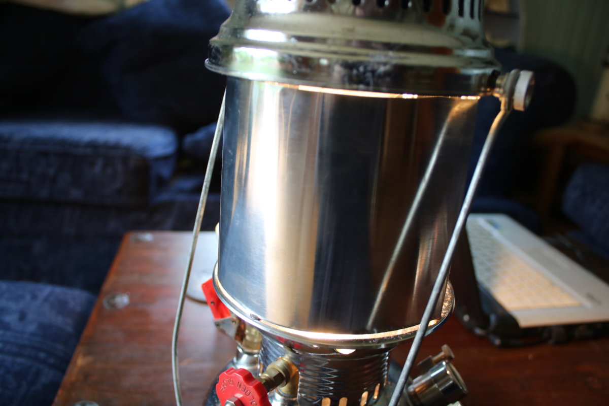

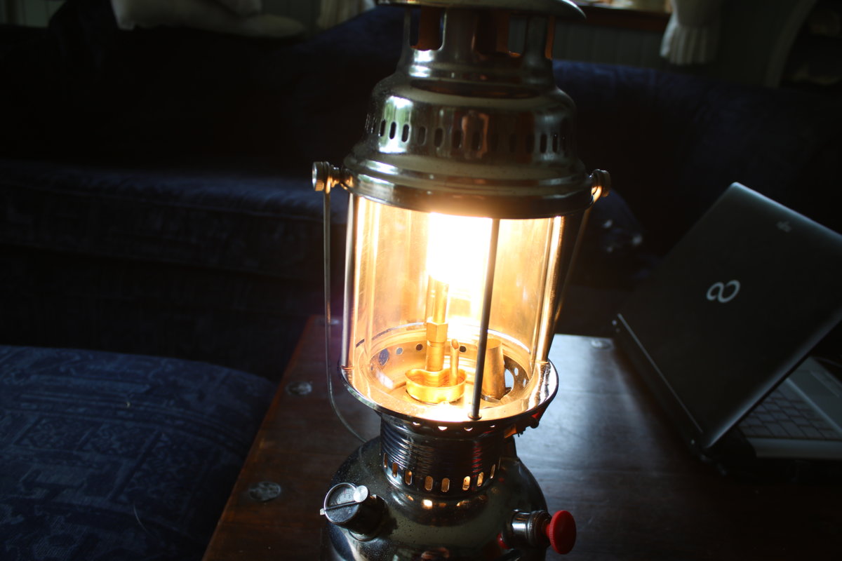

    I used mine on my new Golden Globe but I'd guess it would work on any similar lantern. BTW, the unrolled length of the tin is exactly the right distance to span three frame rods.

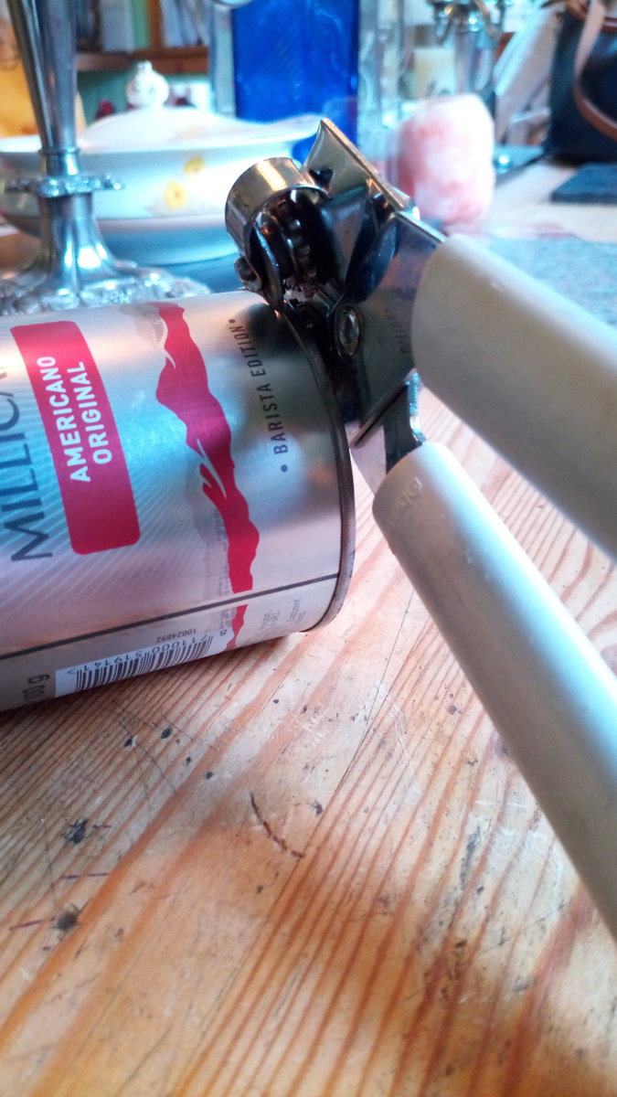

    When you cut the top and bottom away, used the can opener sideways.
  13. ColinG
    1,964
    Like this, but make sure you remove the printing first. I cut along the seam when I'm opening out the tube.

    Nice job. Can you put up a picture of the edge detail where it attaches to the frame uprights?
  15. ColinG
    1,964
    Here's what it looks like. 2019-07-09 14.54.59.jpg 2019-07-09 14.55.33.jpg 2019-07-09 14.56.10.jpg

    Another close-up of the finished reflector in place.

    I've made one for three of my Chinese p'max clones and they really make a huge difference! With the reflector I honestly think it doubles the brightness being thrown forwards.
