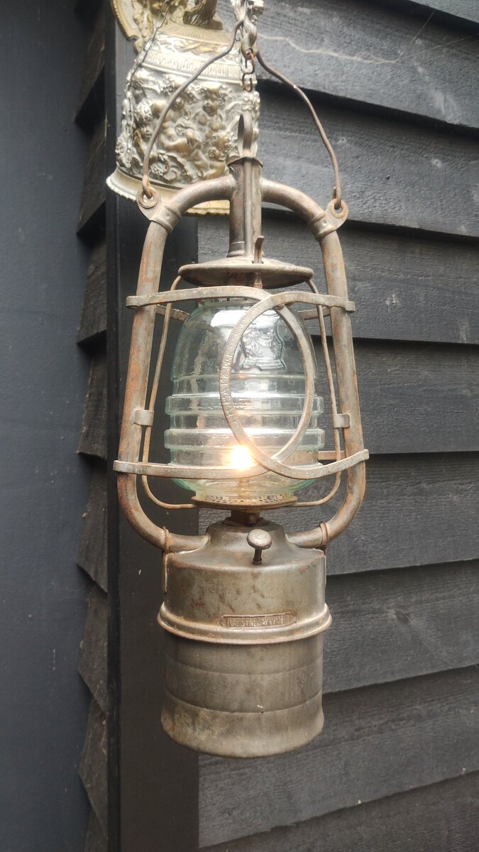

    Dear All,

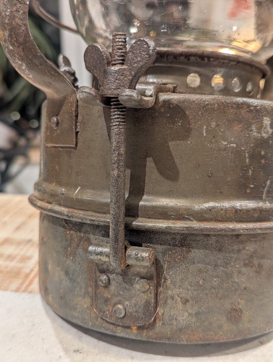

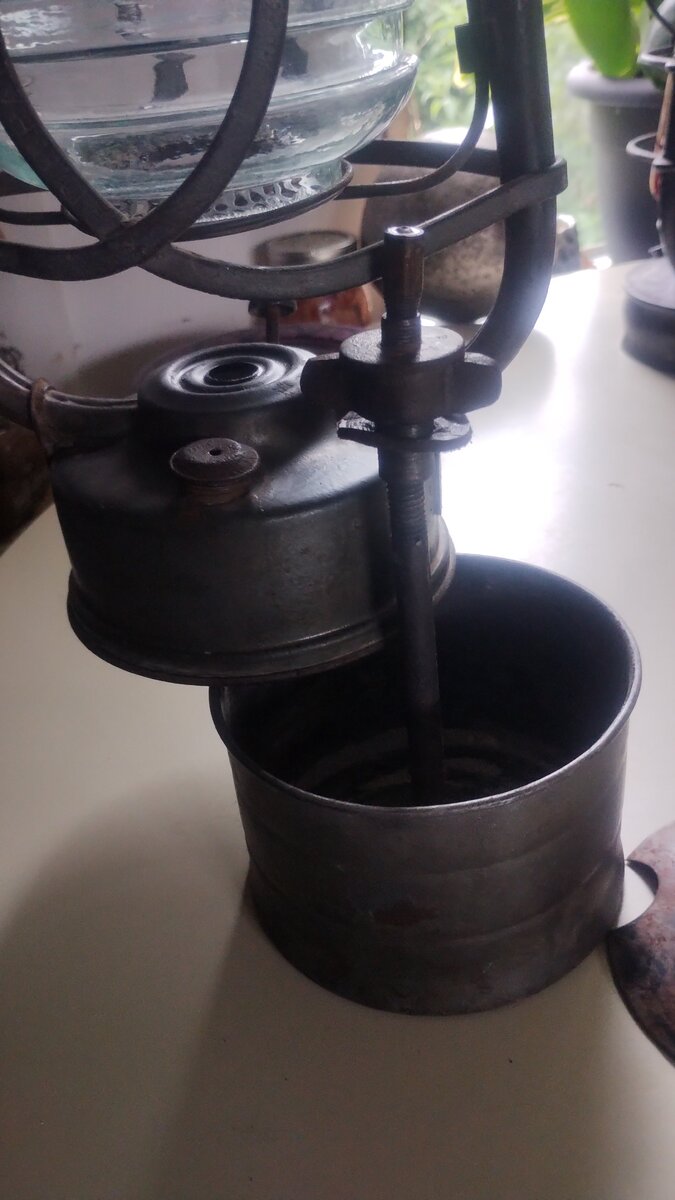

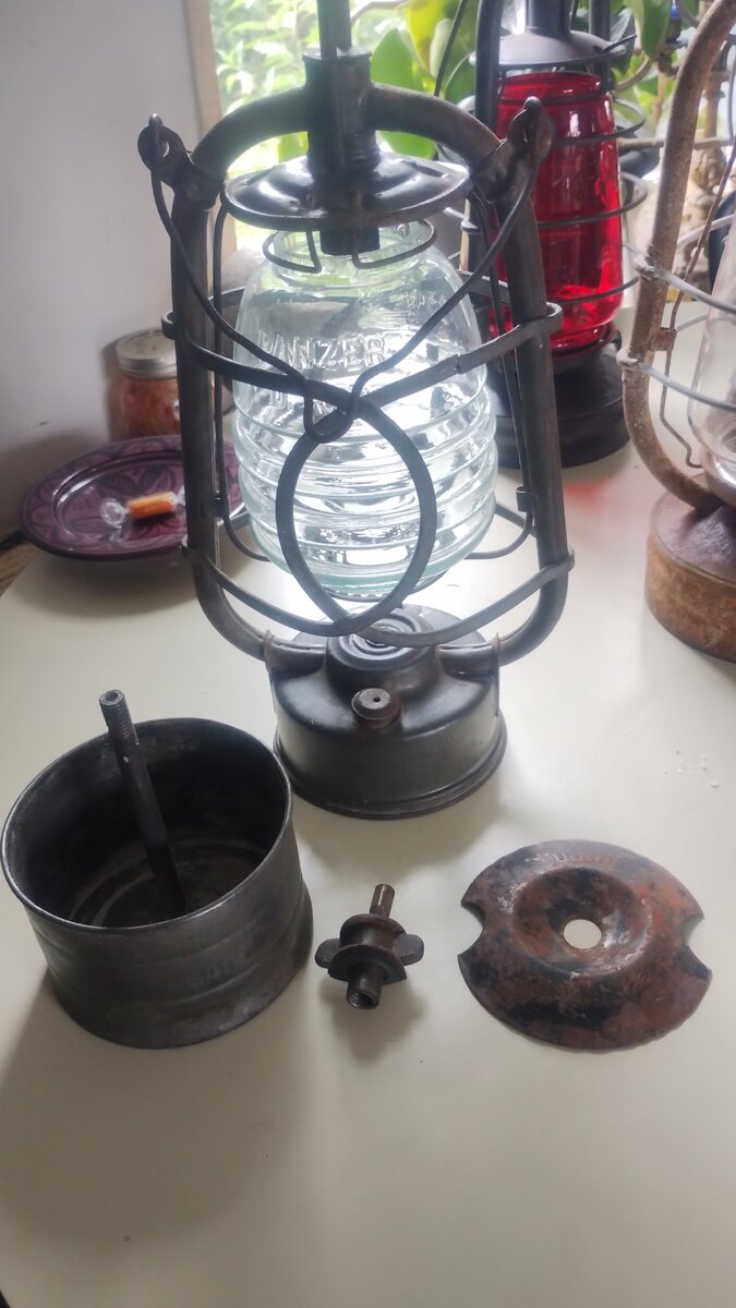

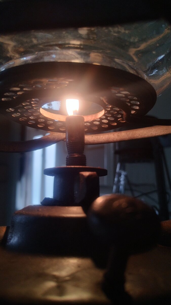

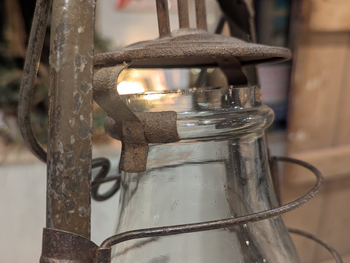

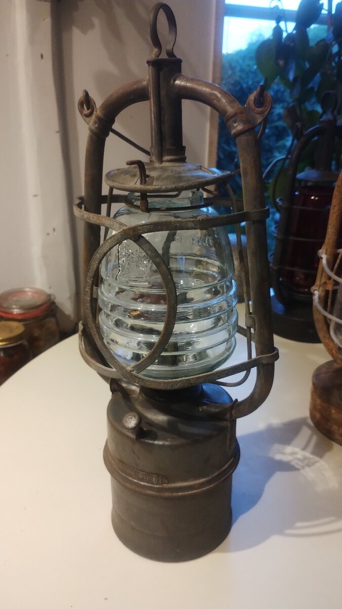

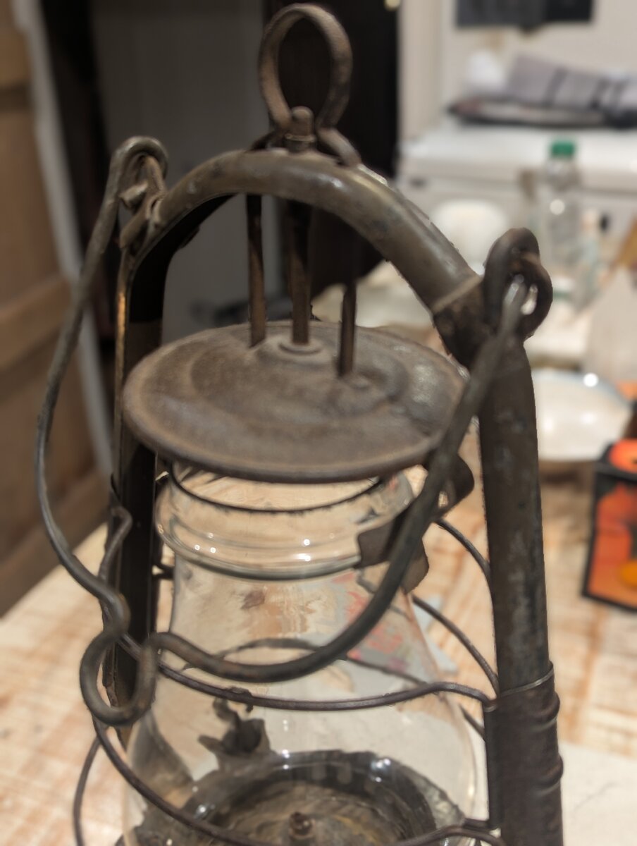

    I picked this up online as I've got into Kaestner and Toebelmann lanterns of late, understood not pressure lamps but there are various other posts of wick lamps and the like on here and I know we have crossover knowledge. It's gas, but not pressurised.
    I'd hoped it was a big tank hurricane, like some Feuerhand or Frowo that I've seen but I have to be honest, my heart sank a little when I opened up the parcel to discover a carbide lamp......
    The tech scares me a bit as it produces colourless, odourless gas but with this one I just had to seek out some carbide to try it, especially as the parts were not rusted stiff and all in v good order.
    So pics are attached, my question is this..... Does anyone have more extensive knowledge of the conversion process, it looks as if metalworking shops or factories got the kero lanterns and added tanks and tubes for carbide use as kero was banned in Germany for domestic use during the war. Just wondered how widespread this was an an industry? Any info greatly appreciated, I love the innovation and practical thinking to use an existing but useless (at the time) bit of kit and making it work with another more abundant fuel.
    IMG_20230630_184839381.jpg IMG_20230630_184752302.jpg IMG_20230630_184615609.jpg IMG_20230630_184507070.jpg IMG_20230630_181813143.jpg IMG_20230630_173533691.jpg IMG_20230630_173506391.jpg IMG_20230630_173729186.jpg IMG_20230630_173216196.jpg IMG_20230629_212235483.jpg IMG_20230629_212206960.jpg IMG_20230630_173212769.jpg IMG_20230630_173621730_HDR.jpg

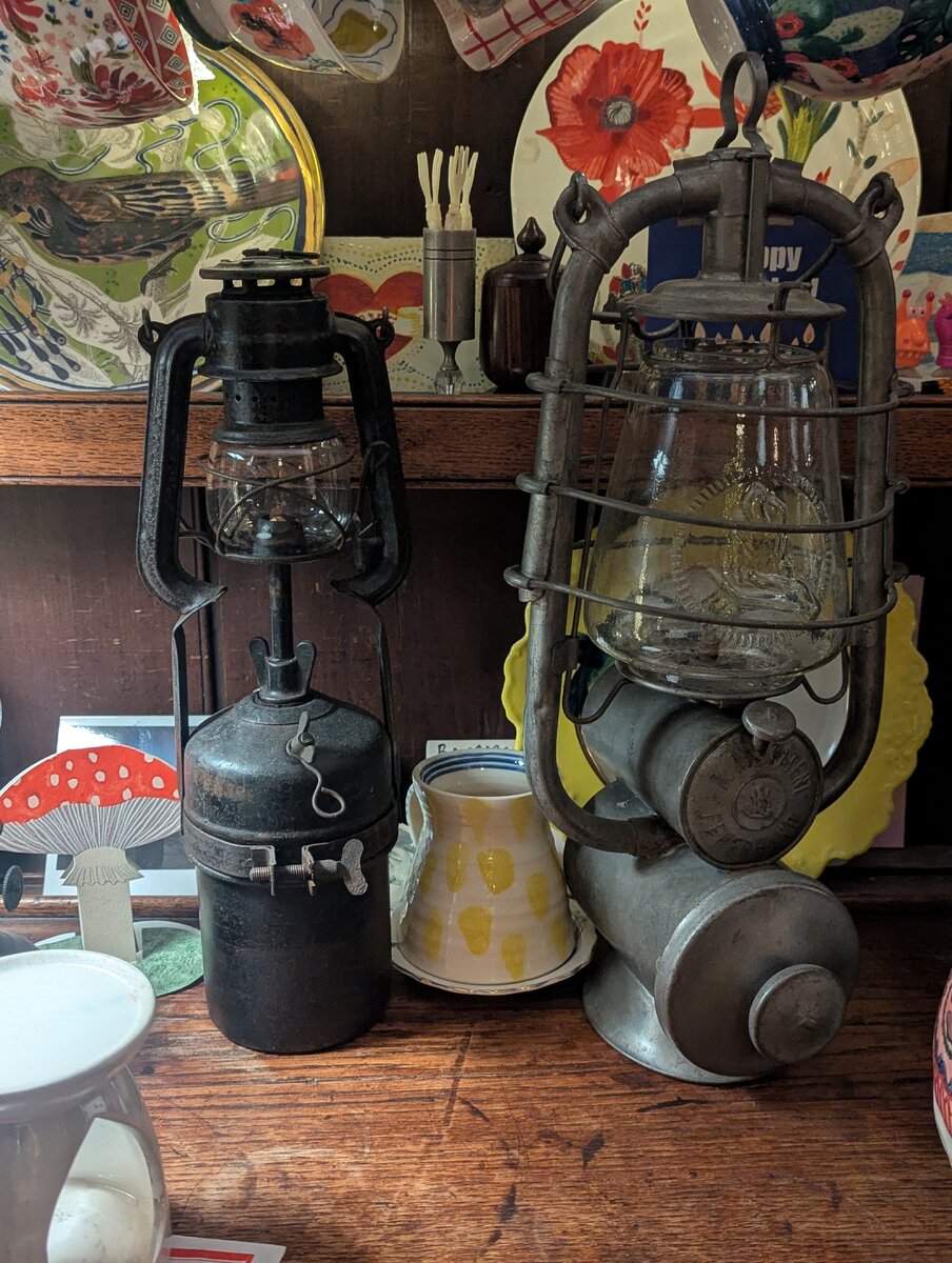

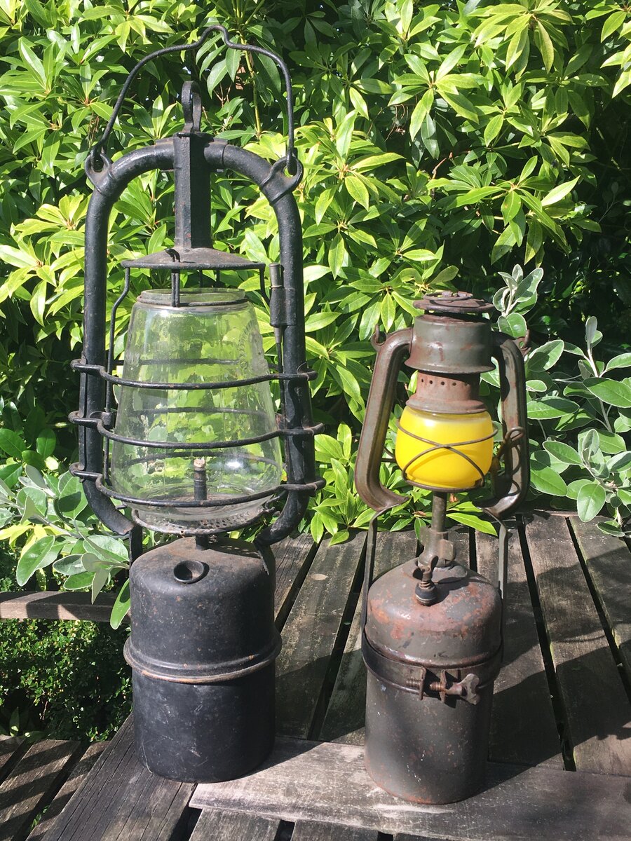

    As here in the UK, carbide lighting was well-established in the inter-war years so although your hypothesis referring to the unavailability of kero for some civilian populations is true enough, carbide lamps wouldn’t have been made especially to fill the gap. They pre-existed.
    A Reimann on the left (has a Feuerhand globe) and a Frowo on the right.
    Designed from the outset for carbide but utilising paraffin lamp superstructures.
    A detail on the Reimann, a burner brush in a clip on the frame.
    Wire brush cleans the burner of any accumulated carbon deposits (usually only form if the lamp is run on reduced output - water drip slowed right down).

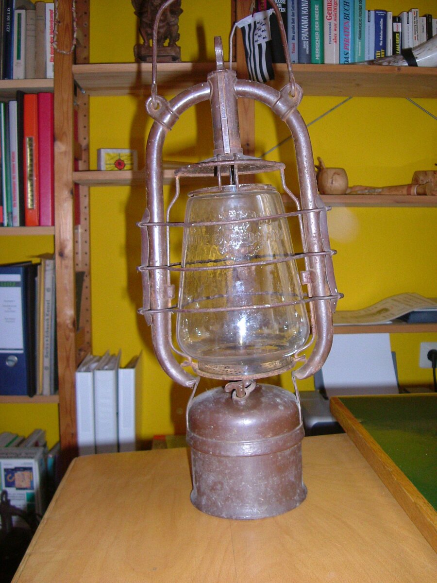

    A Feuerhand Nr. 305 lantern converted to a carbide lantern by the company Hermann Riemann, Chemnitz.
    The Riemann company produced for many years cars- and especially bicycle carbide lanterns.
    During WWII it was forbidden in the German Reich to use kerosene for private use.
    A Kästner & Töbelmann hurricane lantern in 1928.
    The Frowo hurricane lantern in the post of Presscall was produced after WWII.

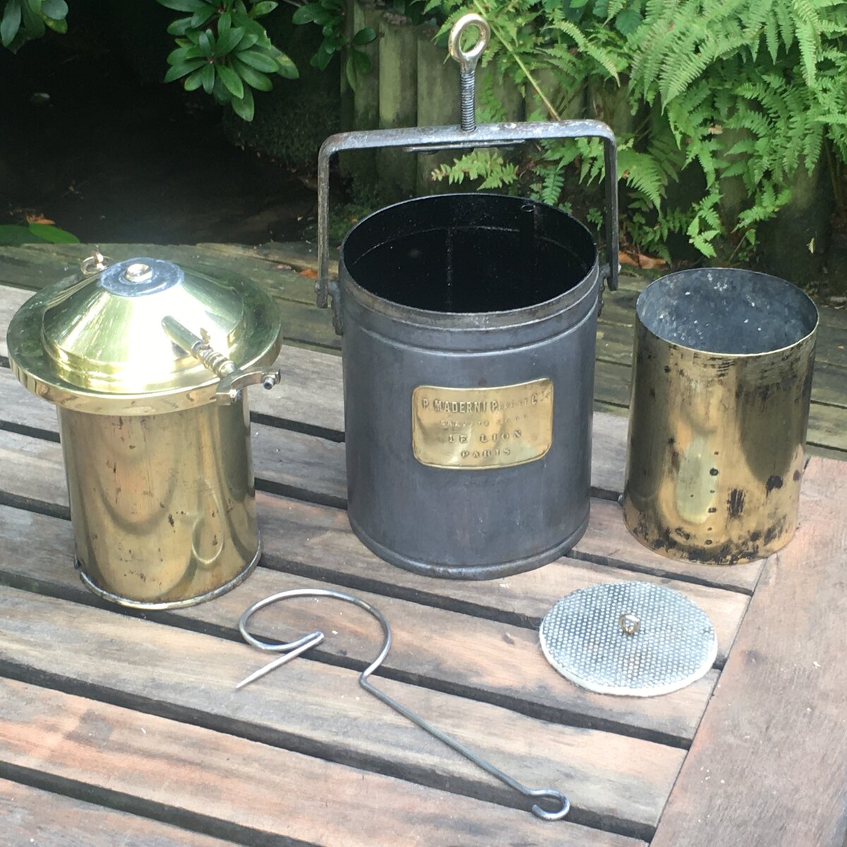

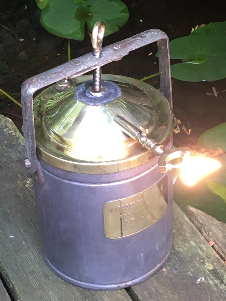

    Probably the favourite is this rather versatile (as a light source) French railway lantern.
  10. nicky boy
    nicky boy United Kingdom Subscriber
    Jan 19, 2022
    113
    uk
    @presscall, loving that, abs mint. would like to see the workings tbh, tanks, dropper etc.
  11. presscall
    1,738
    Lancashire, UK

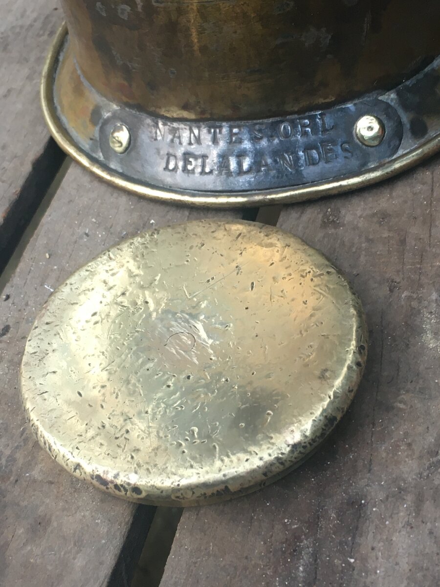

    @nicky boy

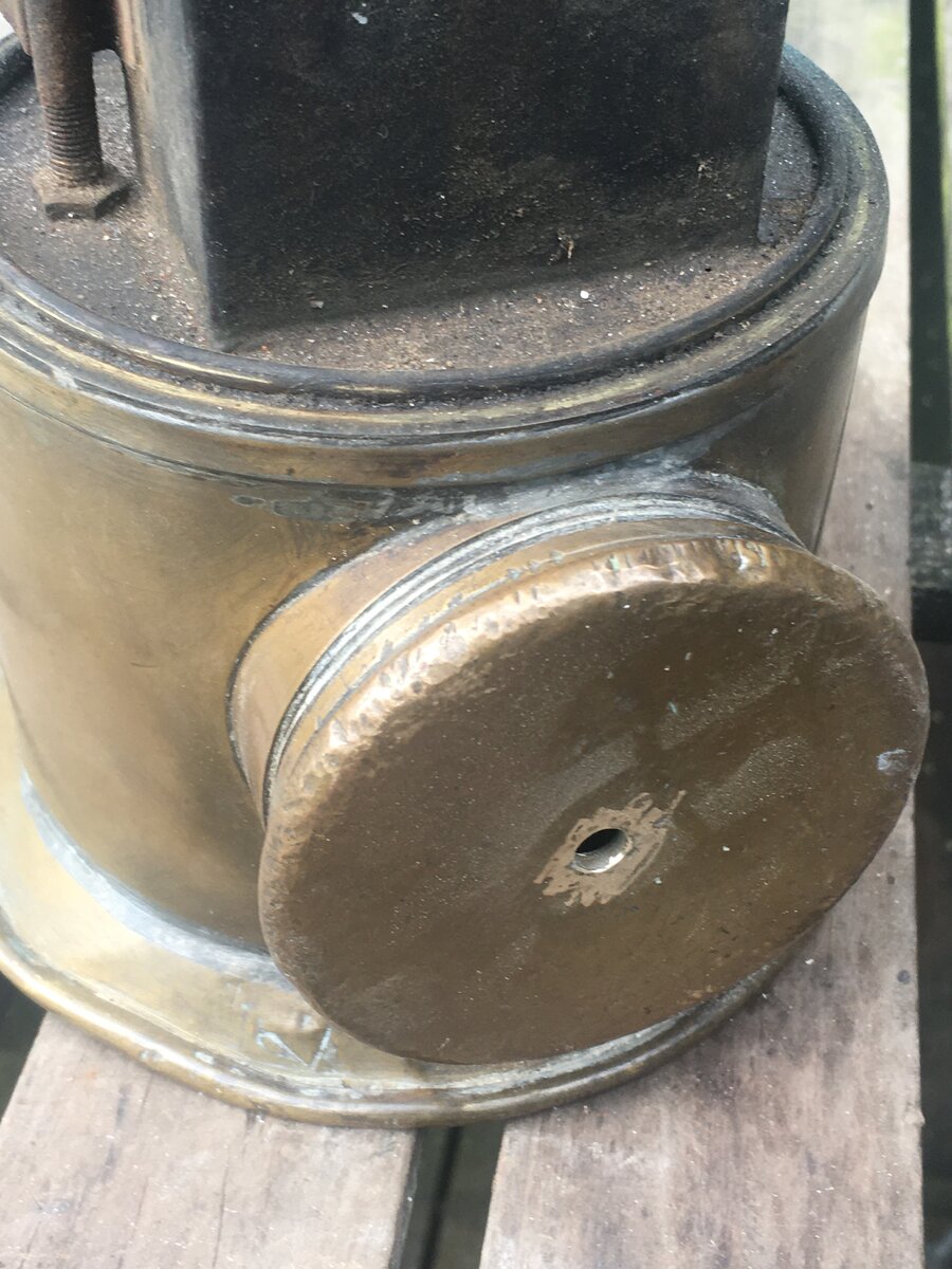

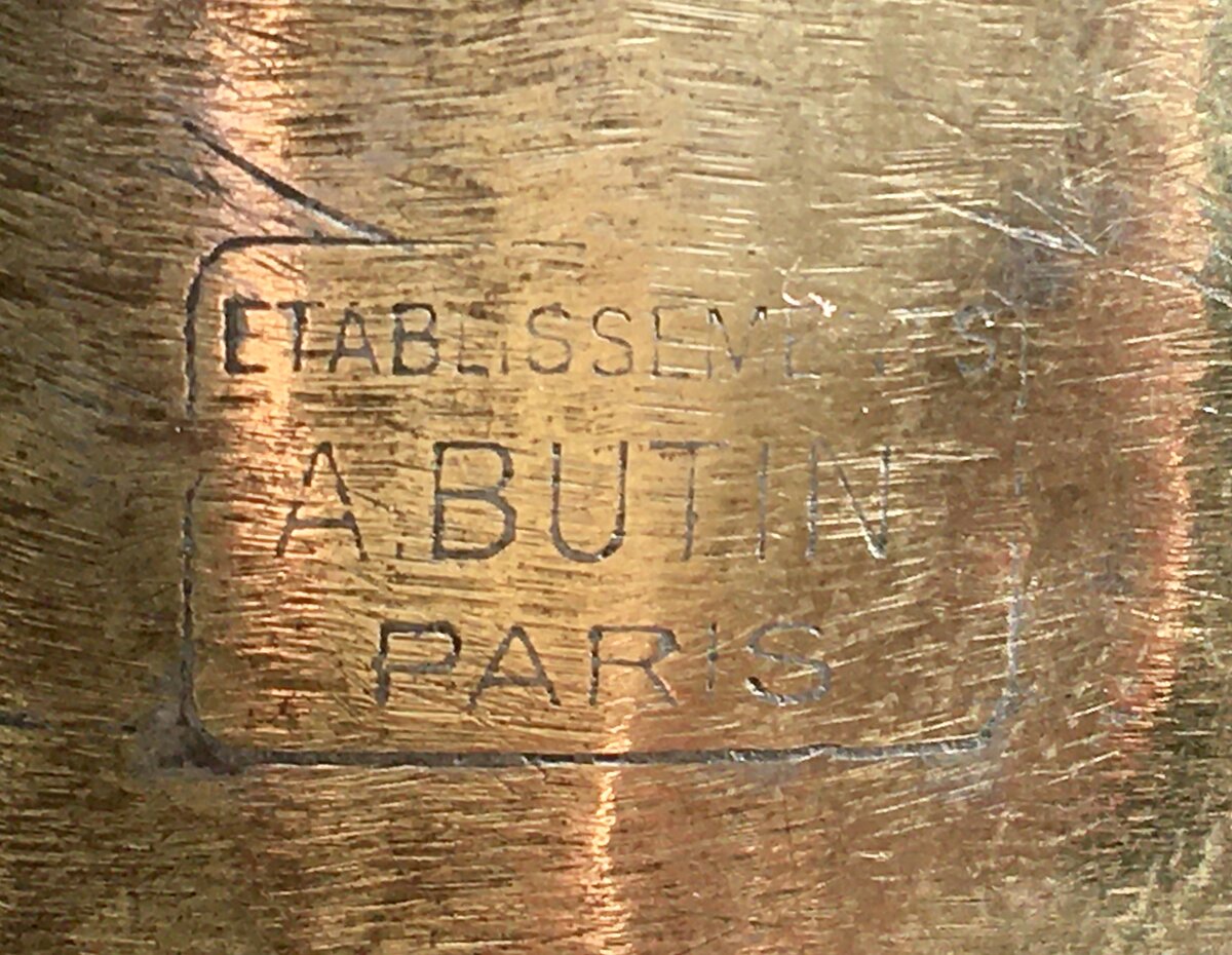

    Manufacturer A. Butin of Paris, 1920’s, assigned to Nantes-Orleans Railway, Delalandes (a surname) - name of user?
    Some fettling was called for. It had been electrified, a hole drilled in the carbide chamber lid to take a flex …
    … and the carbide burner riser ripped out to mount a light bulb.
    Brass plug silver soldered in the hole in the lid.
    A tubular burner riser soldered in place.
    Angled to place the burner near to the centre of the reflector.

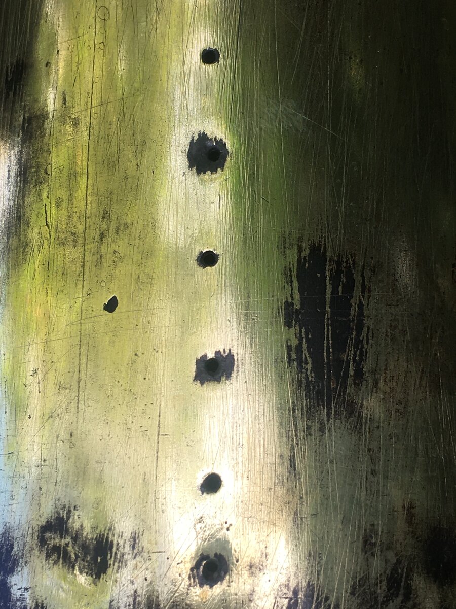

    Another type has a carbide container inside a float in a water tank, a pin-hole in the float allowing water to reach the carbide in a metered way.
    This lamp has a carbide container (right) - with a closed base and open top - that is a clearance fit in the brass cylinder with the domed top (left). A circular felt pad sandwiched between two perforated metal discs (bottom right, photo) goes above the carbide in the innermost container as a filter to prevent water droplets and carbide dust from reaching and blocking the burner jet mounted on the outlet pipe on the dome.
    There’s a twist-bayonet connection between the two and the assembly is dunked in the water in the outer container/tub (centre, photo) and is held down by the screw clamp.
    The inner carbide container has this vertical run of pin-holes in the cylinder wall.
    The water percolates through to the carbide by penetrating the joint between the close-fitting cylinders and entering the carbide cell through those holes. Depending on the surrounding water level, some control of gas generation and burner output is achieved. The gravitational force of a greater ‘head’ of water results in water getting through to the carbide more quickly, with a greater generation of acetylene gas.
    Water is poured into the tank here.
    The scale of the lamp, alongside a Veritas Superb paraffin pressure lantern.
    Carbide charge.
    Ignition!

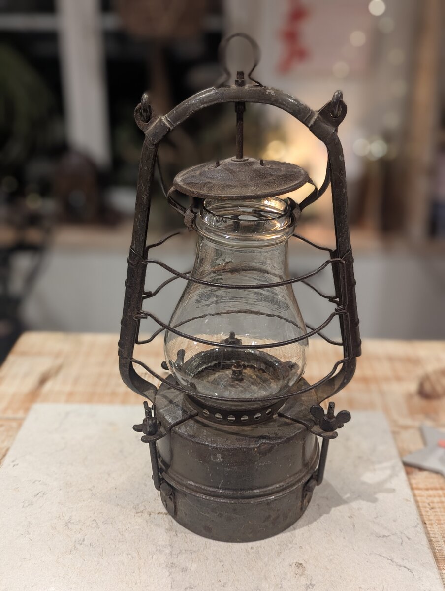

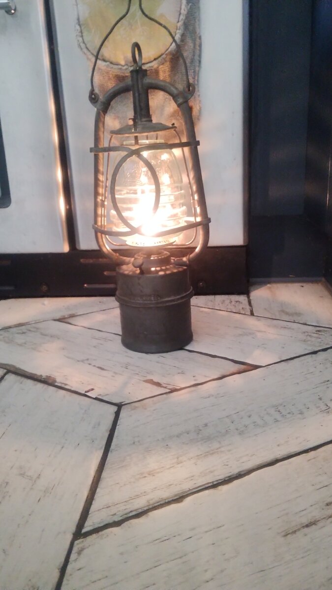

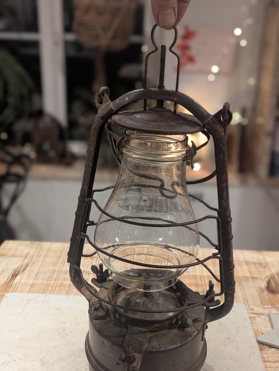

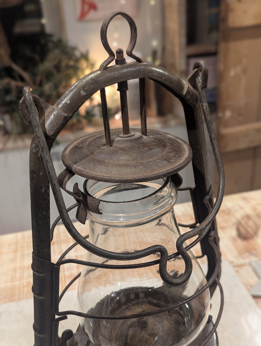

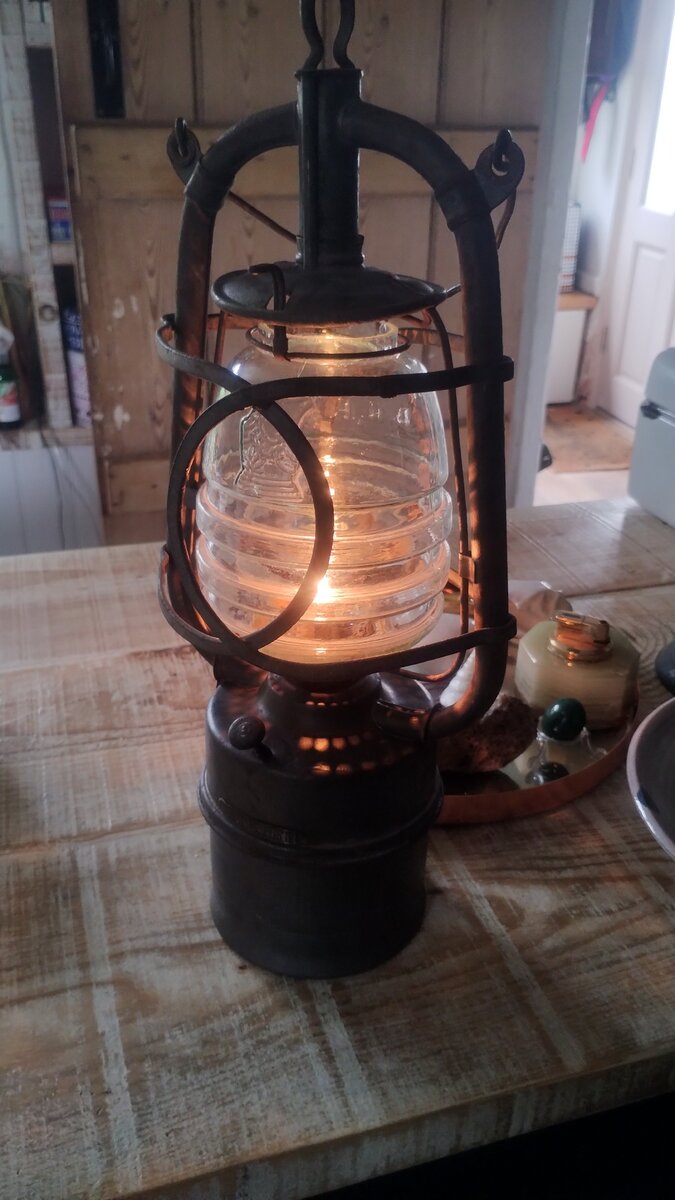

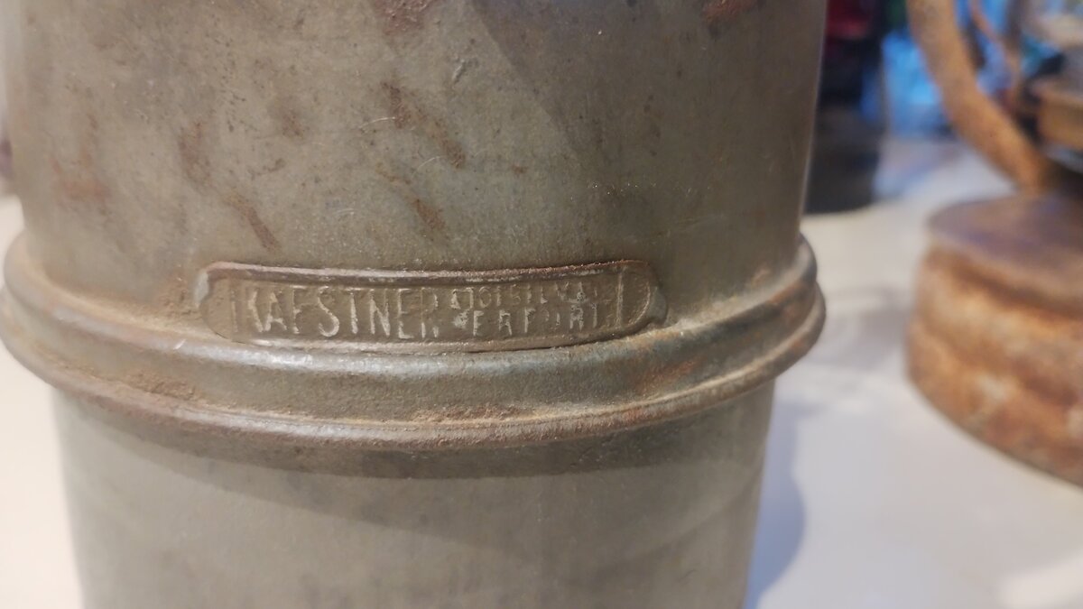

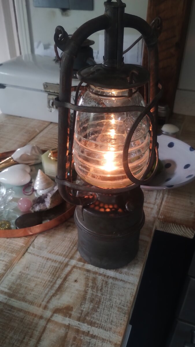

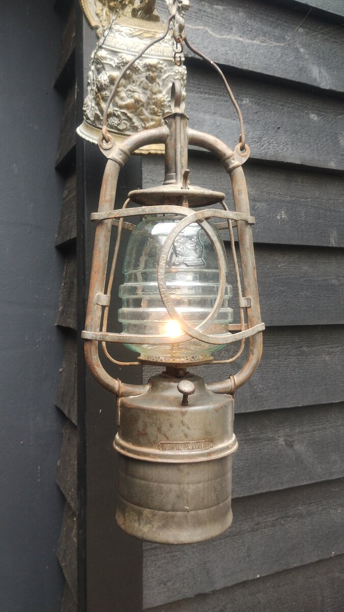

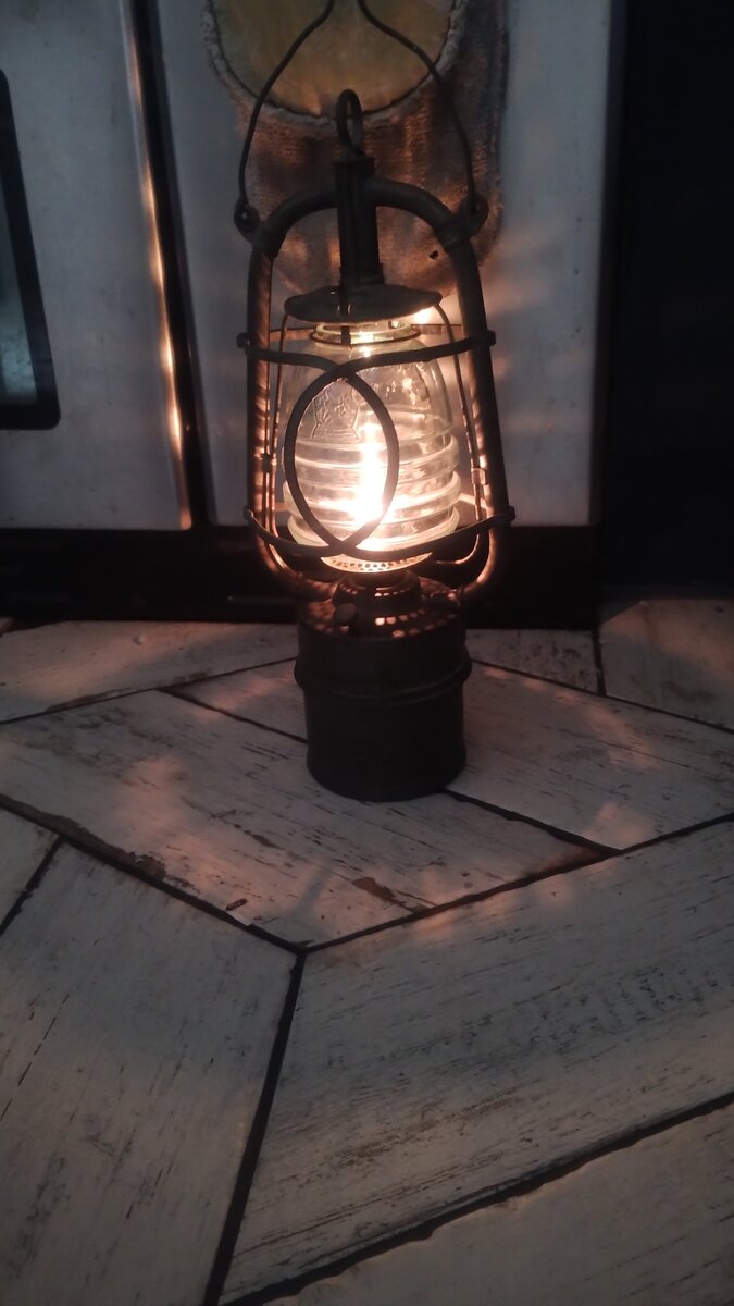

    Hi all and @Jörg Wekenmann as you have obviously researched this subject. I found a real anomaly a few months ago.
    It's hurricane/ tubular in shape but created that way, not a conversion. It has some familiar but also novel elements, such as the globe retainers.
    The innards are knackered sadly but it seems to wear original green paint.
    I have no idea of anything regarding this lamp apart from its basic form and function. If anyone knows anything please don't hesitate to add to this thread, no makers or markings spotted as yet. PXL_20260109_220058870.PORTRAIT.jpg PXL_20260109_220105283.PORTRAIT.jpg PXL_20260109_220117242.PORTRAIT.jpg PXL_20260109_220144004.PORTRAIT.jpg PXL_20260109_220231674.PORTRAIT.ORIGINAL.jpg PXL_20260109_220253222.PORTRAIT.jpg PXL_20260109_220319654.PORTRAIT.jpg
    A couple more have joined the crew. PXL_20260109_220515035.PORTRAIT.ORIGINAL.jpg

    This is a Frankonia carbide storm lantern from the 1920s. The first model still had real air pipes, but these no longer served any purpose. For this reason, it was decided to use only strips of sheet metal that looked similar to the air pipes. This saved on materials and made it possible to offer the carbide storm lantern at a lower price.
    Best regards,
    Jörg
