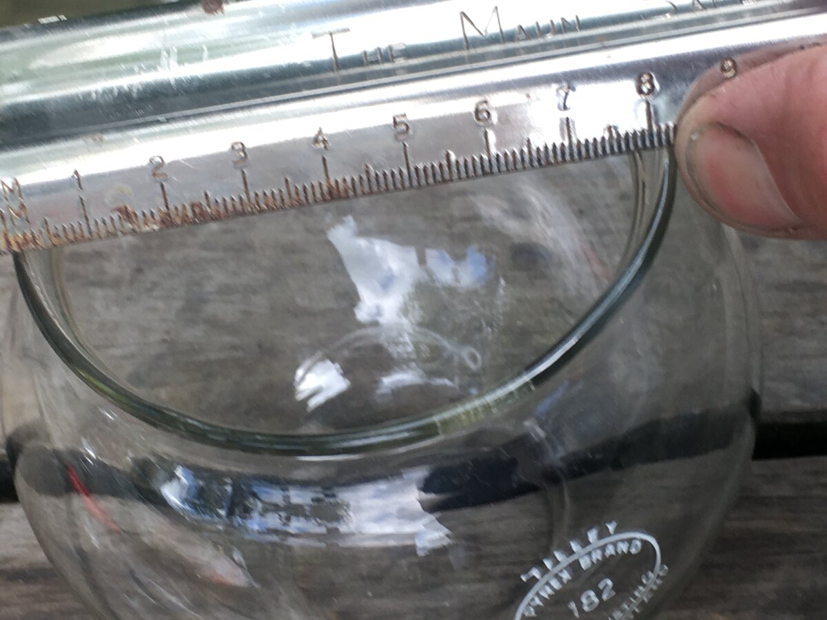

  5. presscall
    292
    UK
    This pattern eh?
    Matter of interest, would a Tilley 182 globe fit?
    John
  6. Carlsson
    3,567
    No, a Tilley onion globe is much larger than the one this little tiny Radius use.
    Also, it doesn't have the three little tabs that are needed to fit the globe to the holder.
    Hytta, as Nils suggested, is probably the easiest choice. I think the "knaggenglass" for the Marla lamp of this kind might be the same size as Radius, but I'm not sure. It needs to be verified by someone who knows.

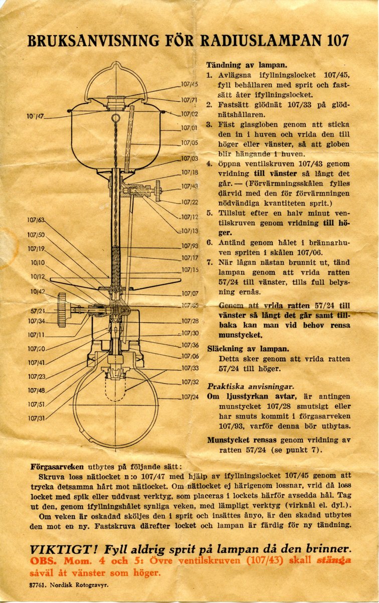

  8. Carlsson
    3,567
    That one is also similar to the shape most Radius 107 seems to have used. Atleast I more often see that type compared to the larger spherical globe seen in the illustration from the instructions sheet above.
    But those do of course also pop up now and then.

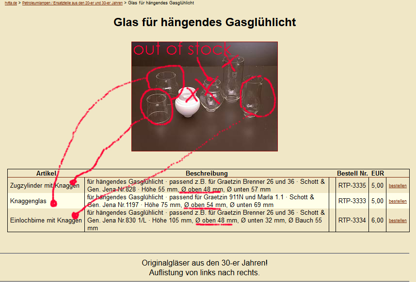

  12. Assel
    Assel Subscriber
    Nov 12, 2014
    5
    Thanks you for your sympathy,
    I will call Jürgen from hytta, but I am afraid I will have no success.
  13. Nils Stephenson
    2,586
    Sorry about that. I didn't see that the correct glass was not in the list. If Hytta doesn't have them, I don't know where to look. Maybe Jürgen has an idea.
