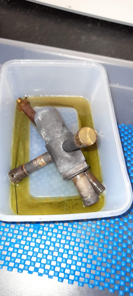

    Without a blowtorch, I must say that the Rounded type Vapalux/Bialaddin air screws are a pain to remove, but I managed, with a small vice, several size pliers and some gripping rubber. The old hands are aching a bit now! Just soaking in some cleaner!

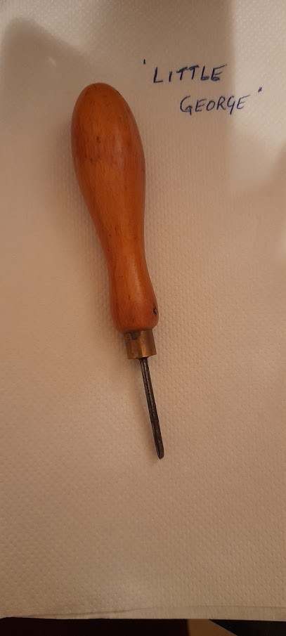

    I took it off because the ventilator was a complete wreck. I found a small bradall which is very strong and works well.
  5. David Shouksmith
    7,908
    Yes, that would do it - good thought... :thumbup:
