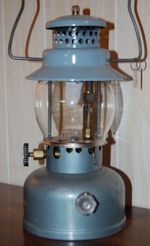

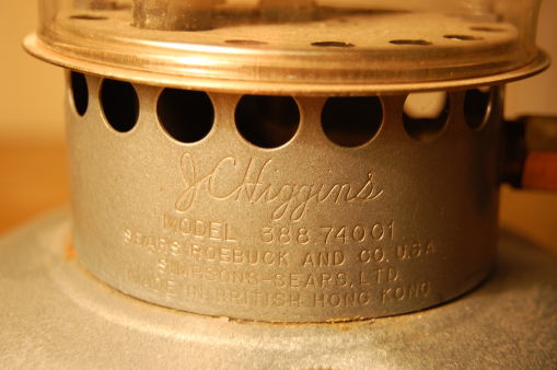

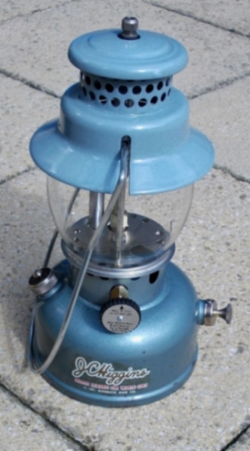

    Greetings all,
    Here is a J C Higgins model 388.74001 lantern. the globe base rest is clearly marked "J C HIGGINS" "MODEL 388.74001" "SEARS ROEBUCK AND CO. U.S.A." "SIMPSON-SEARS, LTD." "MADE IN BRITISH HONG KONG". This Lantern operates properly, and is quite possibly the loudest gas pressure object in my collection! Very loud.
    Would anyone might know the years of production for this particular model of lantern?

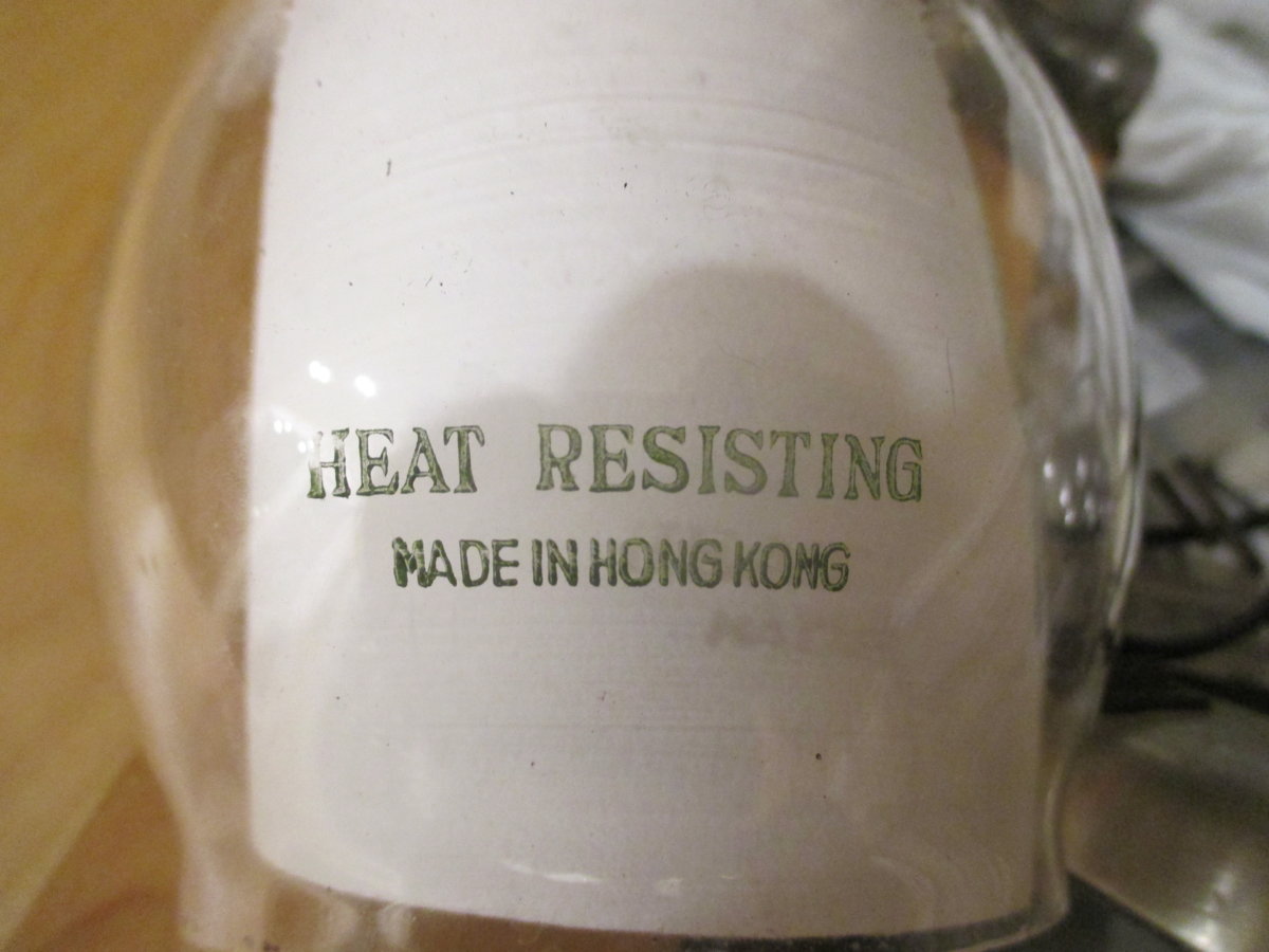

    It is presently fitted with a non-original, non-Coleman globe, which is faintly stenciled in block letters "HEAT RESISTING". It exibits linear flaws (lines of bubbles) in the glass which run at angles to the circumfrence of the globe, which may indicate a less than quality production run.
    Has anybody ever seen such a globe before? What company would have manufactured them and in what years?
    For now, the globe and lantern seem to get along nicely together, so I won't separate them yet.
    Cheers,
    Chris W - Winnipeg Canada

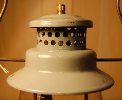

  2. Chris W
    Jan 26, 2011
    112

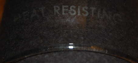

    Here is a close-up of the globe in question. It was found by itself at a flea market.
    Chris W - Winnipeg, Canada
  3. Mackburner
    6,884
    I have no ideas about he globe but the lantern is made by Union Metal Works in HK. These are confusing as some Unimet product like this are very like AGM lamps. Date is a hard call. Probably 1950s at a guess. ::Neil::

  10. campinut64
    Feb 17, 2011
    1
    Hello Chris, in answer to your question to the HEAT RESISTING globe, My 1950's Kooklite cooking/lantern came farm fresh with the same globe as your's. It was the first time I have encountered a bulge globe like this. As far as I know this was a factory globe for the AGM KING SEELEY brand lanterns. I hope this helps and if it fits who's going to know, but you...campinut...

    Thank you for your reply. Since this post was started, I have been examining lanterns for sale on Ebay. the practice has helped me over the last few years to identify the various models and manufacturers for a wide range of lamps and lanterns. About 2 weeks ago, I saw a J C Higgins Model 710.74011 up for sale. This model sported a larger, straight-sided globe. the globe was marked in White lettering "HEAT RESISTING MADE IN USA". Coincidence? I really have no idea, but I sure did a double take on that one! I am glad you have a pristine example of this globe, attached to its rightful lantern. Sometimes you never know what you will see for sale on ebay.

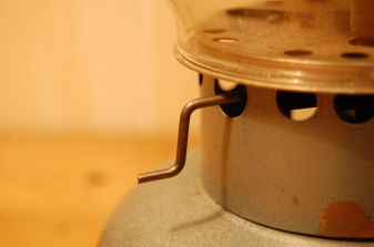

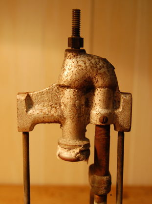

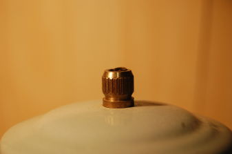

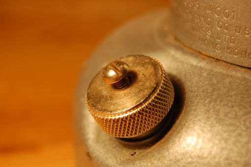

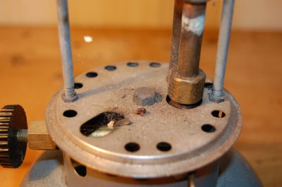

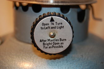

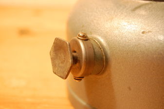

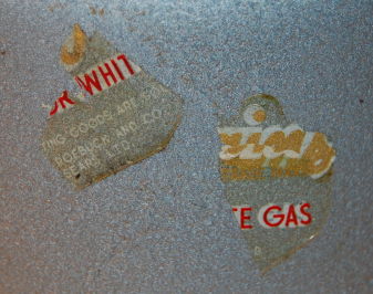

    Here are images taken prior to restoration. I hope that these close-ups can be of benifit to the forum menbers for identification. Aside from the Coleman globe that was on the lantern when it was purchased, all of the lantern is original, with no obvious signs of prior maintenance.
    With Best Regards,
    Chris W - Pressure Lantern Enthusiast,
    Winnipeg, Manitoba, Canada
    1300210504-JC_H_Base_Rest.jpg 1300210540-JC_H_Burner.jpg 1300210627-JC_H_Cleaner.jpg 1300210654-JC_H_Control.jpg 1300210683-JC_H_Filler_Cap.jpg 1300210729-JC_H_Fount.jpg 1300210762-JC_H_Globe_Rest.jpg 1300210794-JC_H_Pump.jpg 1300210834-JC_H_Vent.jpg 1300210866-JC_H_Vent_nut.jpg 1300210900-JG_H_Label.jpg
  13. Mackburner
    6,884
    I now have a date range for these. First issued in Fall 1953 and last Fall 1961. Another Sears lamp with a model number difference. In the catalogues this is model 7400 but the lamps are clearly marked 74001. ::Neil::
  14. AGM
    Apr 4, 2013
    28
    These were late in the run. Likely 1960-1961.
    Tooling did eventually show up again in Unimet lanterns. AGM products lived on.
  15. AGM
    Apr 4, 2013
    28
    Oh, and just to be clear, this is the correct globe for this lantern.
    It was not made by Coleman.
    This is the rebranded Kamplite LRL-21 that was sold by Sears for their JC Higgins line.

    Hello all. My brother just found one of these jc higgins 388.74001 lanterns. Can anyone tell me what would be a replacement globe for this unit. Seems to work well. Thank you in advance
  19. jonathan fairbank
    Jul 17, 2013
    238
    Hiya Ron,
    Ya got lucky then, it must be because of crimbo . . . . . :oops: . . . but the J.C. Higgins you need the new globe for (not dependant on years of manufacture & which part of the world it was made, the US or Asia) can be sourced in the 'here & now', by shopping for it within ebay UK.
    There's a seller from S.Korea turning them out, I.D (kkn4602) I found them very presentable & sturdy & though it's a long haul for the wait, the cost of & shipping, wasn't that disagreeable.
    Bang in a search for Tilley Globes & you should be able to find his/ her shop ! Also selling windscreen novelty blinds, ect, pooch's & cats, ect . . . . ya should find it easily.
    The first J.C.Higg's I bought, arrived with a completely blank globe, I ain't knowledgeable enough to say it is its own factory original,it was just great to get it all in one piece & without any scorch marks. It'll take you longer (in the UK) to find the stipulated "Heat Resistant, Made in USA" varieties :D

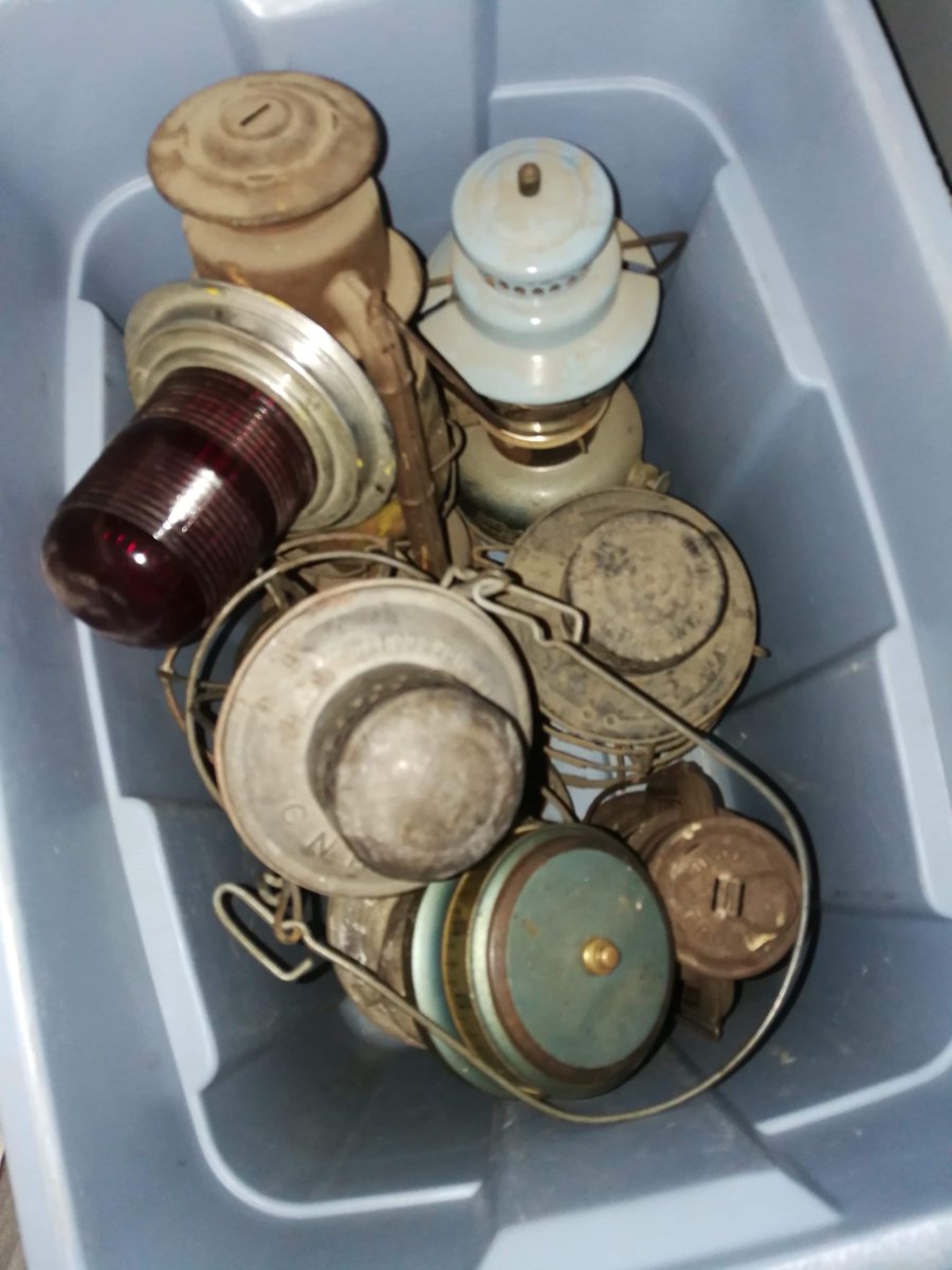

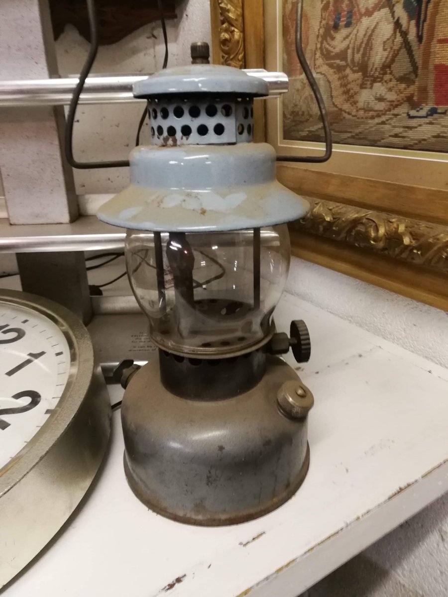

    I was rummaging through a box in the basement of an antique shop and found this bin of lanterns. Mostly hurricane lamps and found this lantern. I’m so happy with this find. It’s in great shape,
  22. JEFF JOHNSON
    15,766
    A fine restoration project!:thumbup:

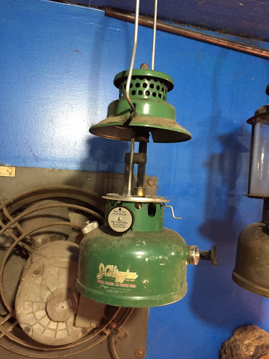

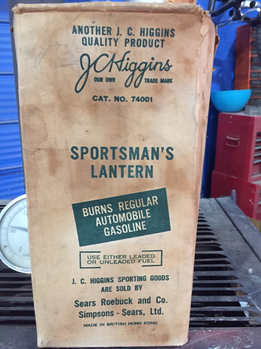

    This just showed up today unexpectedly
  26. Tony Press
    10,433
    @Chris1256
    When you’ve got this lantern sorted it would be good to post detailed photos in a separate thread in the Reference Gallery.

    ok I’ll keep that in mind. There are a few here that could use the elbow grease and a photo shoot.. I had never heard of this lantern before it showed up today.. until now I’ve only had the Coleman’s.. but am certainly intrigued by the amount of volume it should apparently have...
