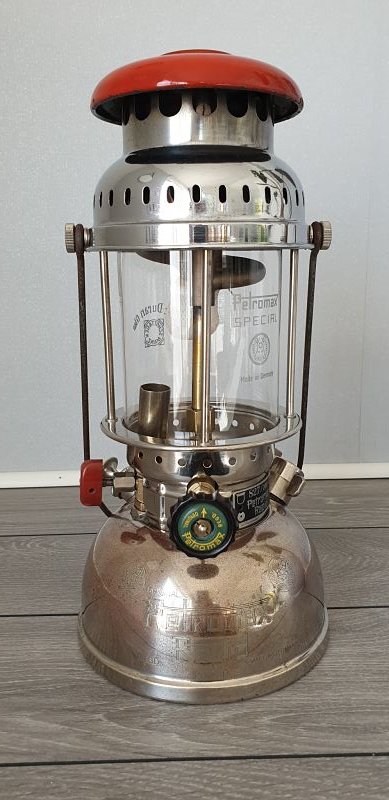

    Hello,
    This one came to me from Finland, i believe it was manufactured back in June 1939, going by the scratches in the bottom.
    827 Front.jpg 827 left.jpg 827 Rear.jpg 827 Right.jpg 827 Wheel assembled.jpg 827 Wheel appart.jpg 827 Gauge appart.jpg 827  Date.jpg 827 layout.jpg 827 inner hood.jpg 827 labeling.jpg 827 Gauge assembled.jpg 827 air valve.jpg 827 glass cylinder.jpg
    Struggling to light this one with the Rapid heater, but appart from that it runs real nice and bright.
    Regards / Frederik

    It's in fine condition!:thumbup:
  3. george
    1,825
    @Tive Beautiful! It looks like my 821 Nov 1939. But it should since the only difference is the rapid lighter and the red top. Very nice find!
    :D/

    Very nice :thumbup::thumbup:
    The Petromax 827 with a rotary preheater was the first Petromax of the 827 type.
    It has become very rare.
    Regards Reinhard

    Lovely Lantern.
  6. bp4willi
    458
    Wow. Incredible good condition
    For this make and age.
    Congrats.
    Pls show it lit.

    Congrats to this beautiful find!
    According to most of the documents that I have got it would even be more likely that it is from Sep. 1936. This 827 with the red enamel cap model can be found, for example, in catalogue numbers 151d, 170p, 524, and several others from that year. We (Neil, Jörg W. and I) did extensive research in December 2019 and in January 2020 and found many documents that can confirm this. Unfortunately we have only a few documents from 1939, and this model could not be found in them.

    Hello Guys,
    On the date, maybe it could be one from 36, but i doubt it, i do have one marked 6 7 here 1936 827 Rapid The thread states 1936, as i posted this one before i knew about the scratches. anyways, the one marked 6 7 has the model number imprinted on the fount, nickel hood, fibre wheel and much darker (bakelite ) rapid heater turning knob.
    therefore i lean more towards 1939, i actually have two of these red tops, and they both have considerable worse nickel plating, than the older one, which make sense as the war efforts starts to come in to effect on rare metalls.
    Fred
