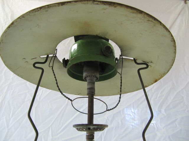

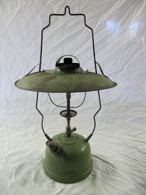

    Here are some photos of a steel AP2 with it's shade. Hopefully this can help to determine whether the steel versions were made by Kopsen or Nettlefold, or maybe both. So far, my thoughts are kopsen.

    It's hard to distinguish between these, as you mentioned can't go by pumps. There is a difference on some with the threads but the only sure way is the decal.
    Its only an observation but all T S Nettlefolds I have seen have the metal hanger. Not much to go on but it's a start.
    Colin

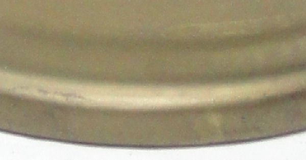

    I thought I'd show the remnant of the label there is on one of my steel AP2s. Not much, but at least it shows it was there.

    Looks like yours has been overpressurised like mine. Rocks around like a top !!!!
  8. Nils Stephenson
    2,453
    No it's fine. Sits nicely on the rim. The paint loss is probably because of something else. I've got one with a big solder repair in the base where it must have rusted out at some time.

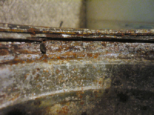

    Kayen brass are the same as the Aladdin 1a. ie insert in the top lip and then soldered. Dish down.
    The steel are incorporated in the lower lip. Inserted and then rolled over to incorporate the outer lip of fount and the edge of the insert.
    You can see the 2 layers of the internal lip.
    I was very reluctant to " attack " this steel fount but it was unusable as is.
    The Tilley all Steel that I have is an EX 100. This appears to be a 3 piece fount. There is the insert in the bottom. Although it is hard to tell but there appears to be a solder line there. Then there is a section that incorporates the lip and inserted in this is the rest of the fount. Looking at the picture just above the upper lip there is a line . This is where the top is fitted.
